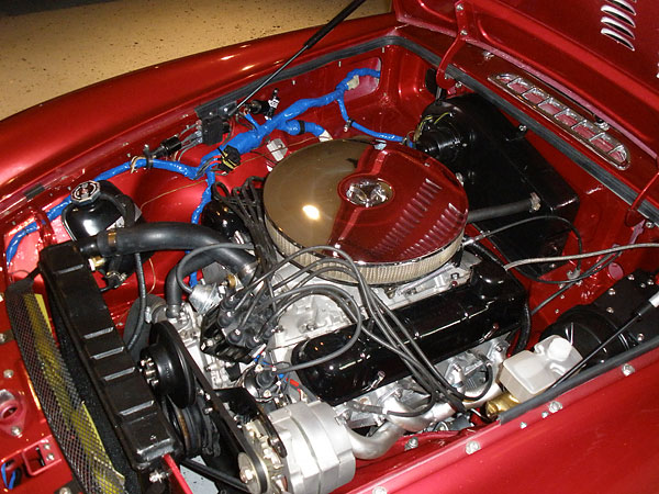

Engine: Buick 215 rebuilt (balanced and blueprinted) with 10.5:1 compression pistons. Buick four barrel intake manifold with Edelbrock 500cfm carburetor. Pertronix Ignitor ignition. 270/451 cam.
Cooling: MGB V8 radiator.
Exhaust: ceramic-coated block-hugger headers, MagnaFlow mufflers, Anza dual exhaust tips.

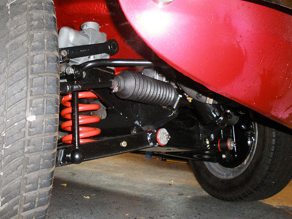

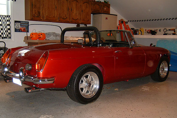

Front Susp.: 2" lowered 550lb springs. Stock shocks with up-rated valves. Poly bushings.

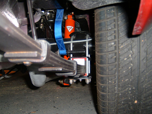

Rear Susp.: 1.5" lowering blocks. Koni tube-shock conversion. Frame connectors added.

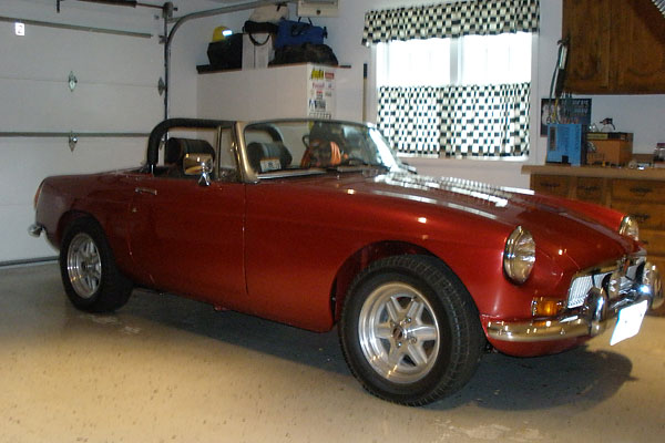

Wheels/Tires: American Racing 14" wheels with M&S 205/60 tires.

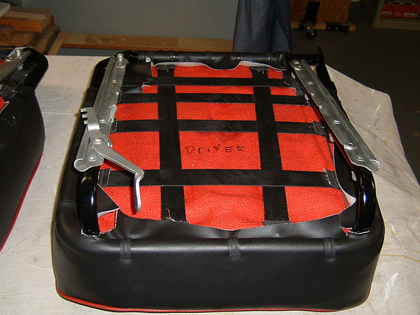

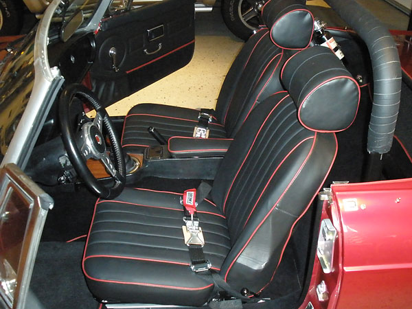

Interior: Prestige leather interior in black with red piping. Black wool carpet with red piping.

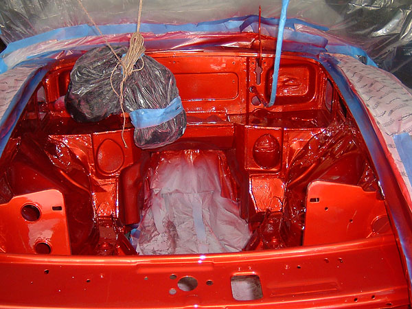

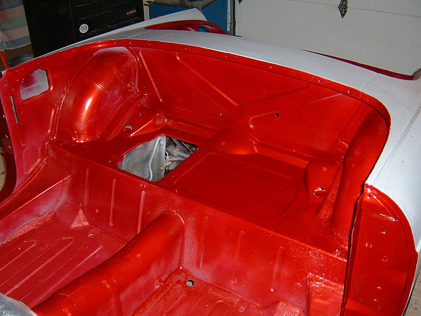

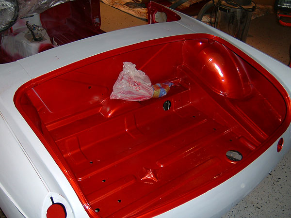

Comments: Car started as a rust free example from the west coast. It was totally disassembled brought to bare metal, sealed, primed, and painted Toyota "Impulse" red with six coats of base color and six coats of clear. Chrome bumper conversion. The engine was rebuild, balanced and blueprinted with new internals and 10.5:1 compression. The transmission was inspected and resealed, as was the rear end. All systems were gone through and all parts replaced with new as necessary. Prestige interior was used: leather seats upper door panels, wool rugs, etc. Gas tank was moved 2" to the left so (dual) exhaust could be run on either side. Frame connectors from Fast Cars Inc. were added from the front leaf-spring hangers forward under the floorboard to stiffen the chassis. This car runs and handles great and is a blast to drive!
balanced and blueprinted Buick 215
Toyota Impulse Red basecoat/clearcoat paint
base coat (six coats) and clear coat (six coats)
rust free California car
rebuilt but basically stock front suspension
Koni shocks and lowering blocks
rebuilt seats
Prestige interior trim
American Racing wheels
