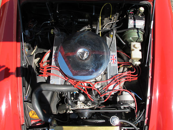

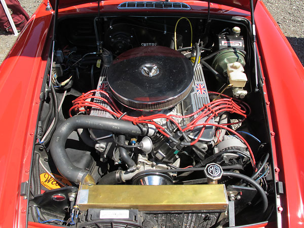

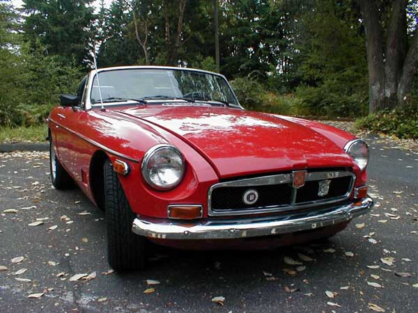

Ken Bottini's MGB with Rover 3.5L V8

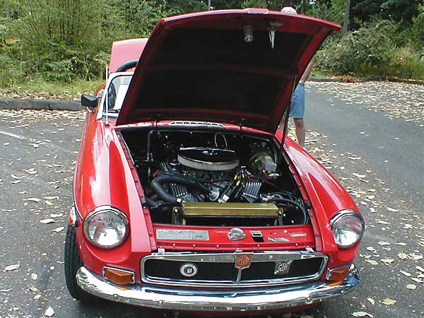

(Photo by Larry Embrey, 2003.)

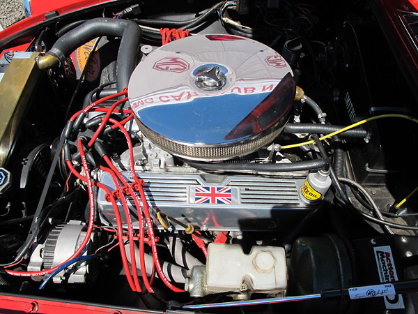

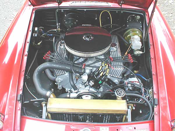

Rover 3.5L aluminum V8 engine.
Electric cooling fans - both pushing and pooling - plus a large brass radiator.

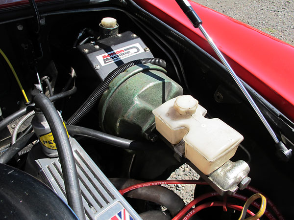

MGB master cylinder, plus brake booster.

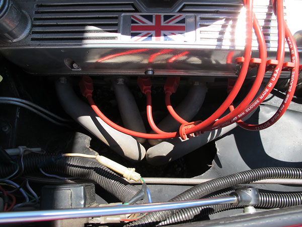

MG RV8-style through-the-wing four into one exhaust headers.

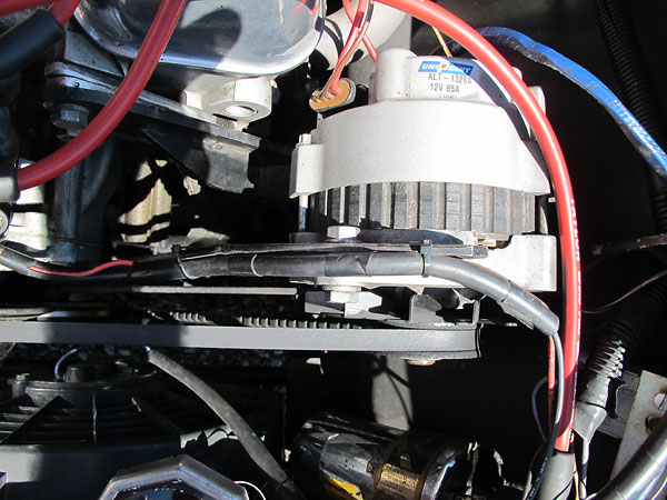

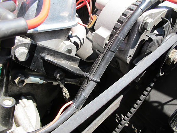

UniPoint 85 amp alternator.
Stiff and robust alternator bracket.

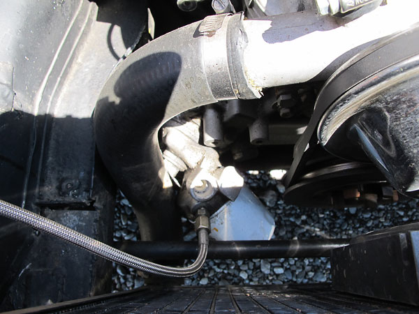

Swiveling oil filter base.
Ken Bottini's MGB: Rover V8
Some years ago, Ken had Offenhauser aluminum valve covers. (Photo by Larry Embrey, 2003.)
Ken Bottini's MGB: custom brass radiator
Rover engine and custom brass radiator. (Photo by Larry Embrey, 2003.)

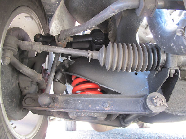

Front Suspension
Stock MGB front suspension, except for lowering springs and heavier duty bushings.

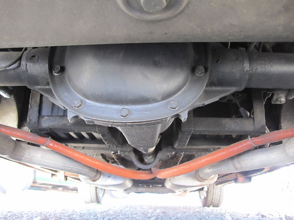

Rear Suspension
Salisbury axle.
Salisbury axle. Dual mufflers, with crossover pipe.

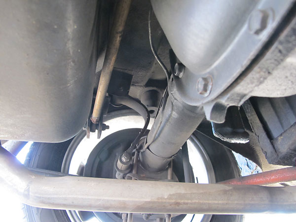

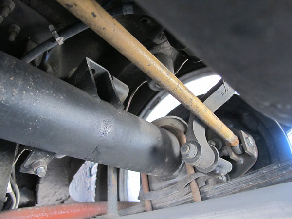

Home-made Panhard rod keeps the rear axle centered under the car's body.
(Note also that knee-action shock absorbers are employed.)
The Panhard rod mounts to the body at one end, and the axle at the other.

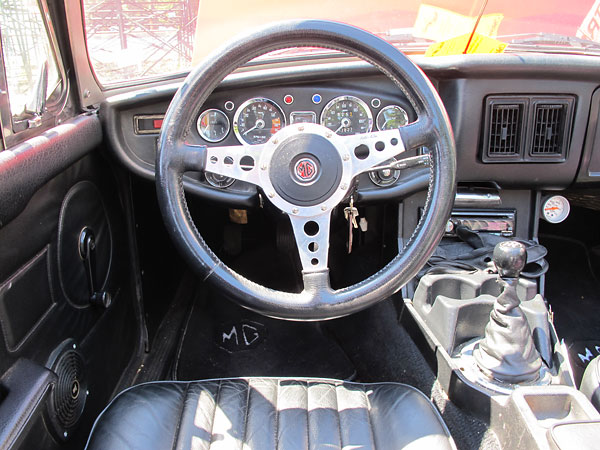

Interior Trim
Moto-Lita steering wheel.

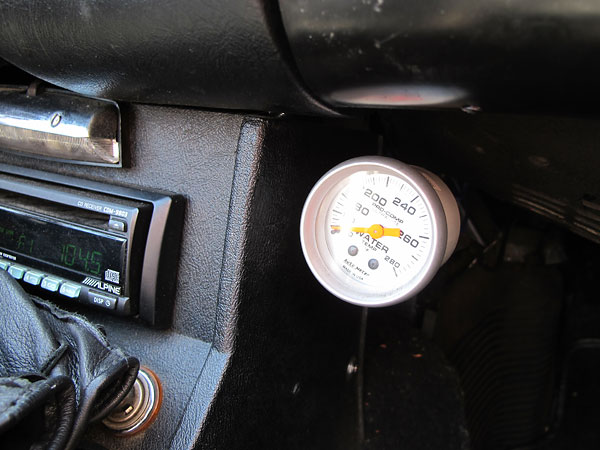

AutoMeter Pro Comp coolant temperature gauge (140-280F).

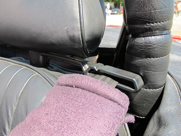

Shoulder harness stand-off brackets: highly recommended!

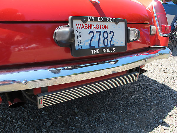

This Edelbrock Fuel Cooler is good for about 25 extra horsepower.
This Edelbrock Fuel Cooler is good for about 25 extra horsepower plus three MPG!

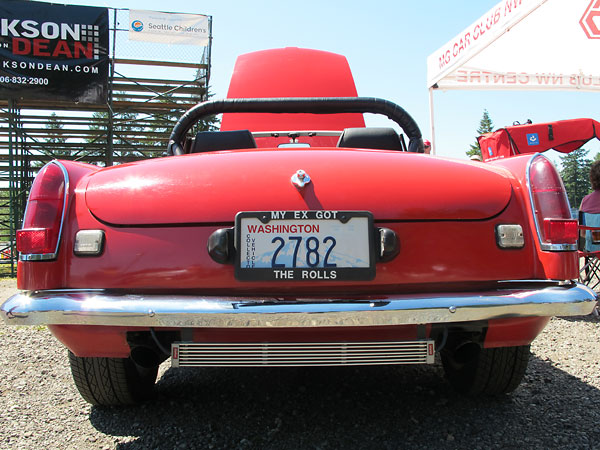

My Ex Got the Rolls
"My Ex Got the Rolls"

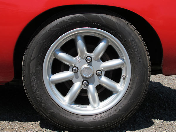

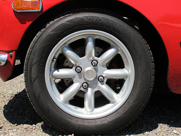

Compomotive 8-spoke aluminum wheels.

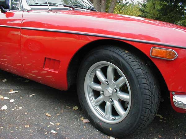

Yokohama YK420 tires (P195/60/R15 87H).
