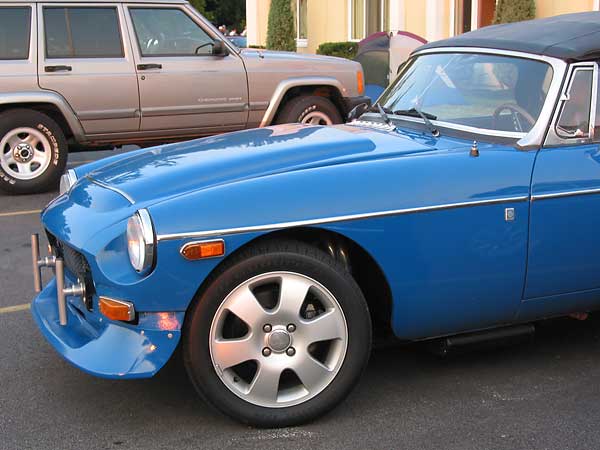

Body: MGC-style fiberglass hood from "morSpeed Performance Products".
Removed rubber bumpers in lieu of nerf bars.

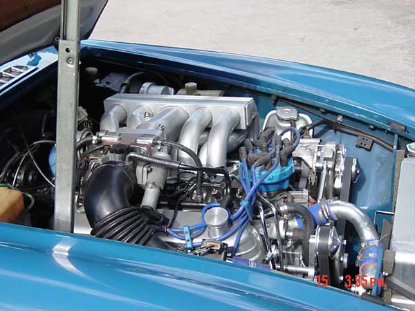

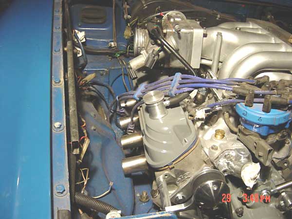

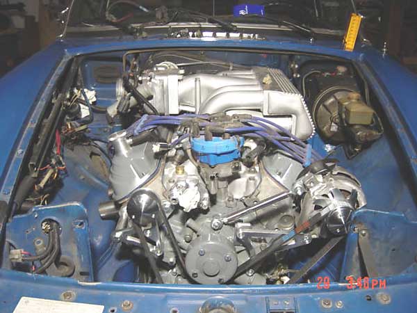

Ford 5.0 Trial Installation
Ford 5.0 trial installation.

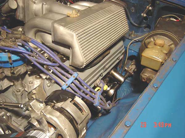

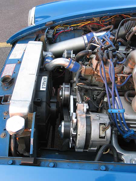

alternator mounting

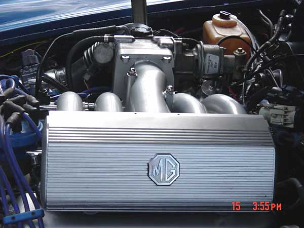

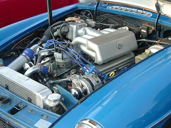

Ford GT40 Induction System
Ford GT40 induction system.

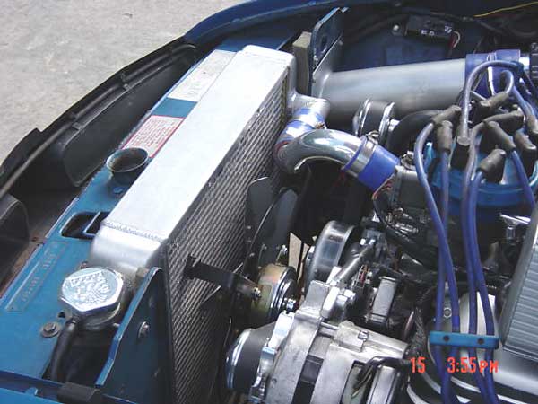

Ford 5.0L V8 EFI intake manifold fits neatly under MGC hood

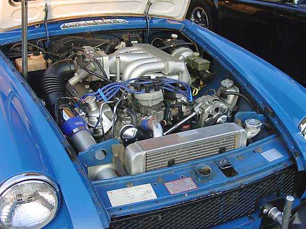

radiator

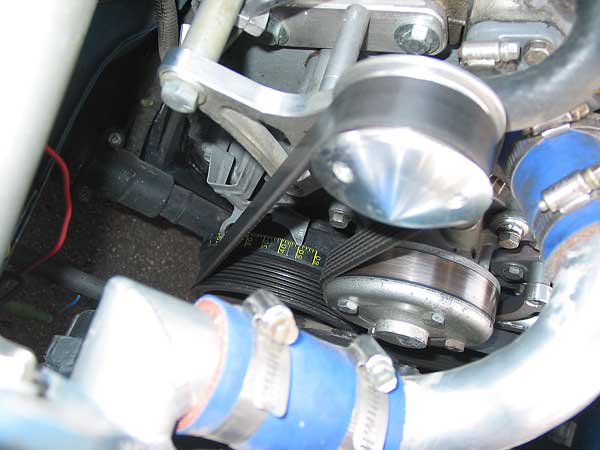

alternator and tensioning mechanism
serpentine belt system
timing marks on harmonic balancer

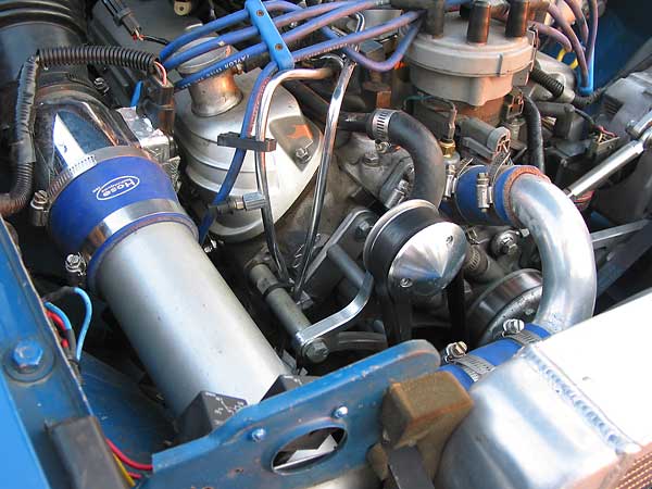

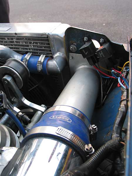

cold air induction tubing

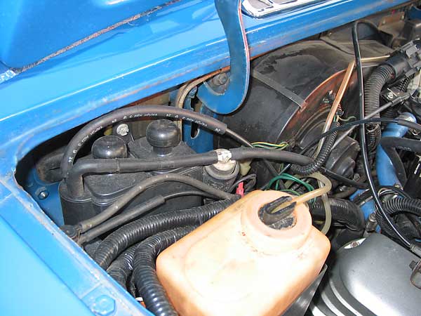

Ford fuel vapor reclamation cannisters

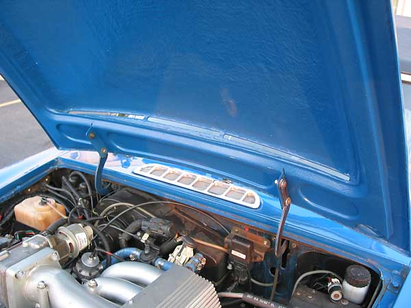

note hood vent holes and clearance hole for clutch master cylinder reservoir
Hood vent holes, and also a clearance hole cut for the clutch slave cylinder reservoir.

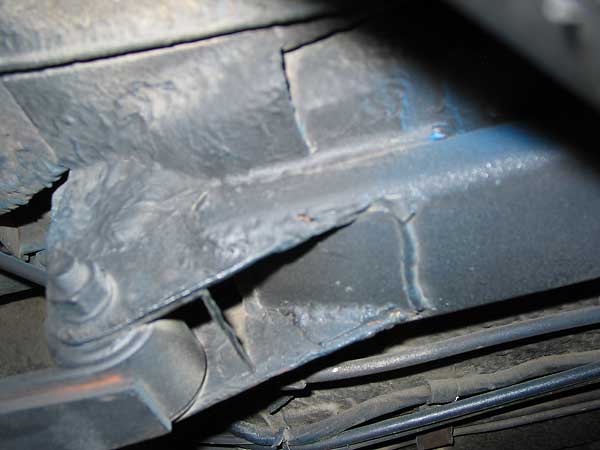

fabricated rear spring mount reinforcements, made from box tubing
Fabricated rear spring mount reinforcement, made from box tubing.

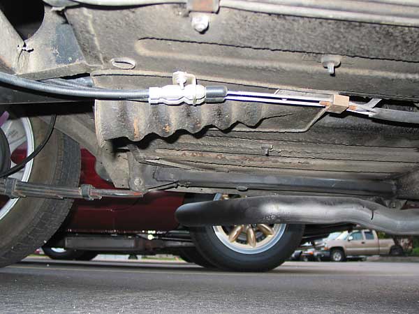

Lokar parking brake cables
Lokar parking brake cables.
