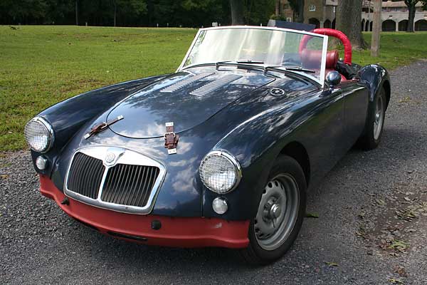

Model: 1960 MGA Twin Cam

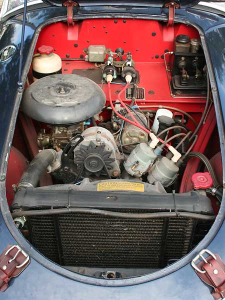

Engine: Mazda 12A Wankel Rotary Engine
Conversion performed by: Previous Owners (unknown)

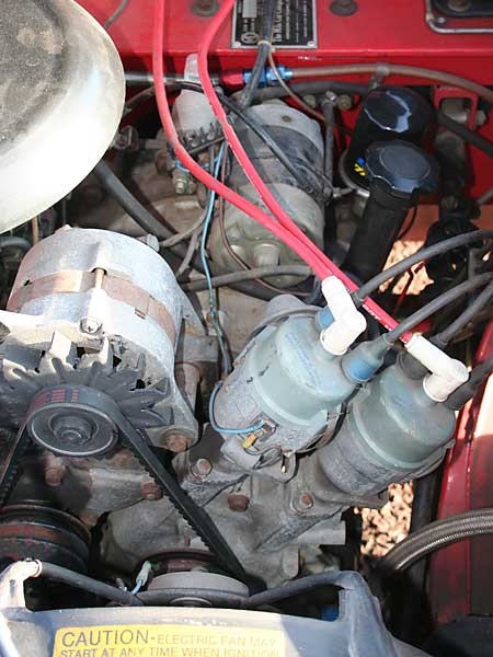

Engine: Mazda 12A (late 70's) with street porting, Racing Beat Manifold with four barrel carb, Racing Beat headers, stock electricals.
Transmission: stock Mazda 4-speed (late 70's). Custom driveshaft from "Driveline Service of Alexandria".

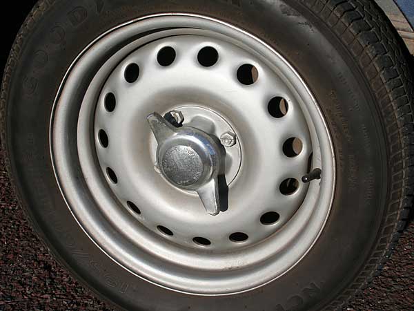

Wheels/Tires: stock MGA Twin Cam wheels, except with 7" chevy rims welded on to accommodate wider tires.

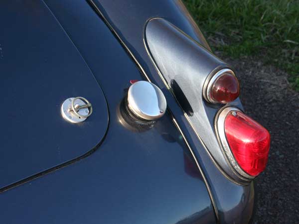

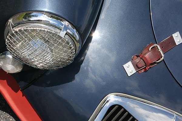

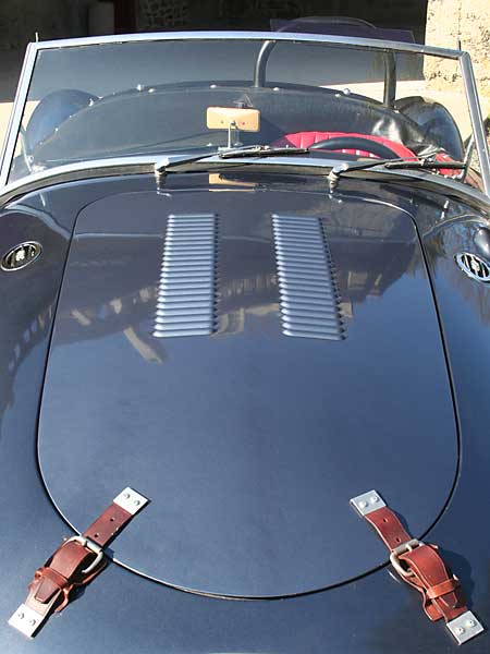

Body: louvered bonnet with leather hold-down straps. All badges removed. Trunk lid secured with hood pins (see photo). Original plywood floorboards have been replaced with stainless steel. (This definitely tightened up the chassis!) A driver's side roll-hoop was installed. Headlight stone guards were fitted.

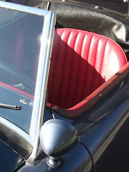

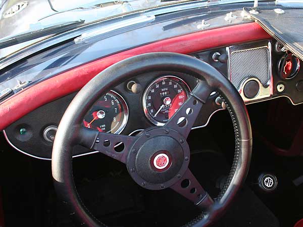

Interior: completely reupholstered in red leather, with black carpeting and aluminum scuff plates installed on rocker panels, lower door panel and floor frame. Leather wrapped steering wheel.

Future plans: I will be adding the racing style front apron, with cut-outs for air intake and for driving and/or fog lamps. Am considering replacing the dashboard with engine-turned stainless steel, and adding a few gauges (amp-meter, pyrometer, etc), plus push-button start.
Mazda 12A Wankel rotary engine in an MGA

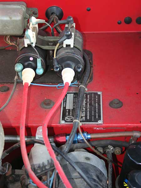

Mazda twin distributors
Mazda twin coil ignition system
leather steering wheel
Talbot mirror
louvered MGA hood
boot lid pins
widened MGA twin-cam wheels

MGA retro racer
MGA leather bonnet straps
