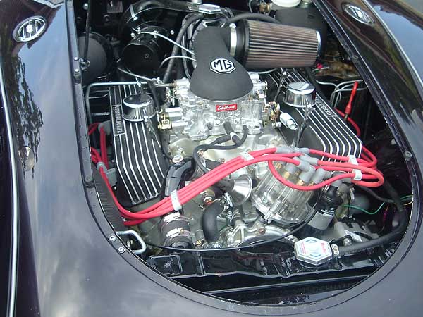

Engine: Buick 215
Conversion performed by: John Mangles ("The MG Doc")

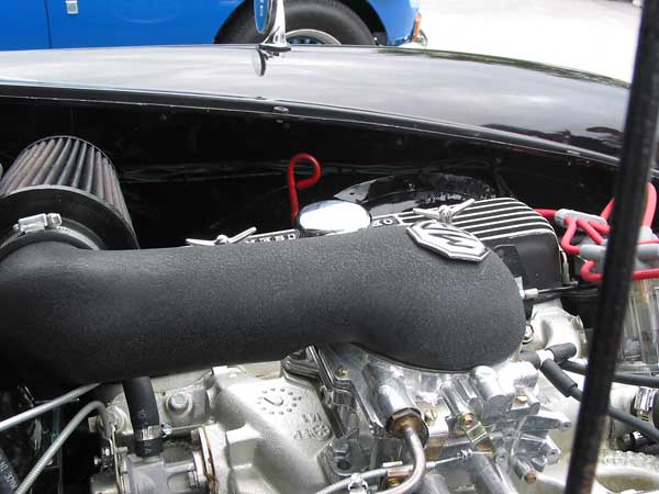

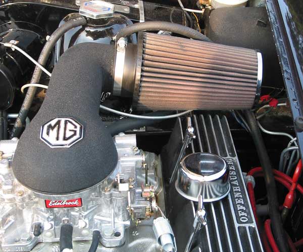

Intake: stock Buick manifold, Edelbrock 500cfm carburetor, custom ductwork to K&N filter.

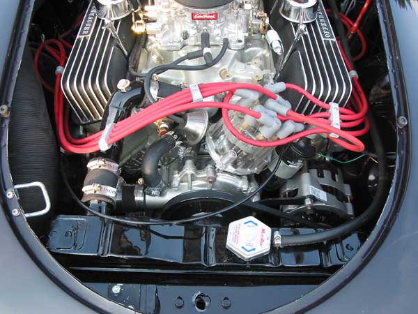

Engine Electrical: Delco-Remy alternator (from a GMC Astro van), stock Buick ignition and starter systems.
Cooling: MGB radiator, with replaced (high efficiency) core, over-sized ports, etc.
Exhaust: block hugger headers and custom exhaust.
Transmission: Borg Warner T5 5-speed, with GM hydraulic slave cylinder.

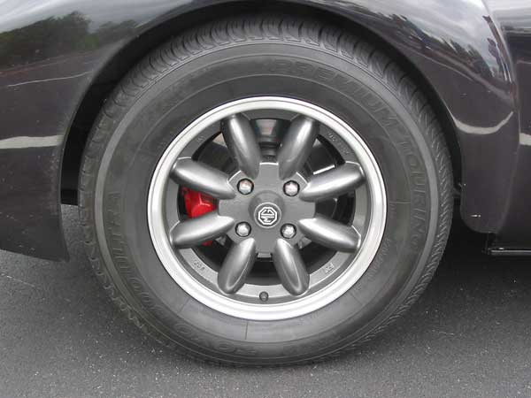

Brakes: MGB brake/clutch master cylinder assembly, MGB disc brakes (front), Volvo disc brakes (rear).
Wheels/Tires: Minilite (15" x5.5") with Toyo 300 Ultra tires.

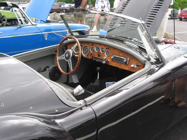

Other: custom made wire harness, MGB gauges, MGB windshield wipers (with two speed motor, cleverly controlled by an MGA headlamp switch and a relay!), louvered hood, stainless steel mesh grille, heated seats, lumbar supports, cruise control, Offenhauser aluminum valve covers.

John Mangles's 1958 MGA with Buick 215 V8 Engine

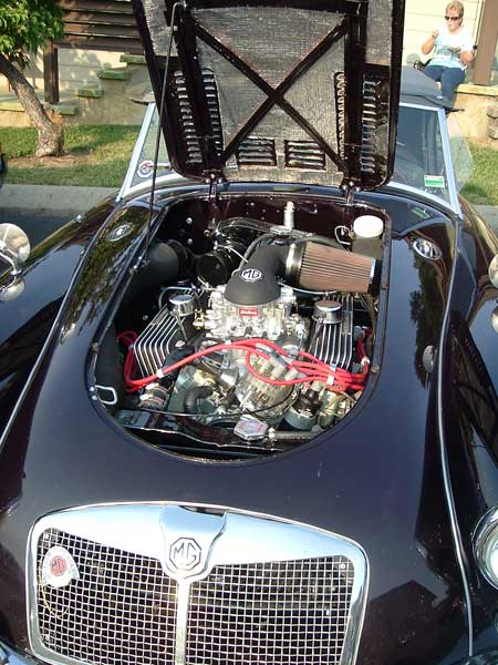

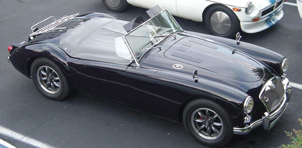

Hood louvers and stainless steel mesh grille
Custom Hood Louvers and Stainless Steel Mesh Grille
Bleeder port for purging air from cooling system.
Rigid Copper Pipe in lieu of Radiator Hoses -
Bleeder in Upper Pipe for Purging Air from Cooling System
John hammer-formed this intake duct out of thin steel.
John Hammer-Formed this Intake Duct out of Thin Steel

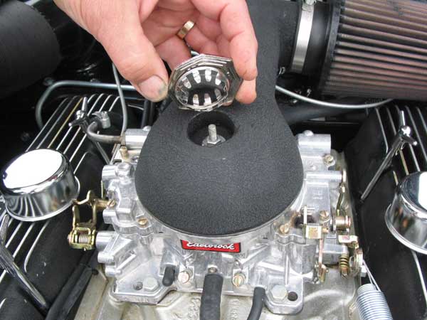

John shows how an MG badge hides the air cleaner removal nut.
John Shows how an MG Badge Hides the Air Cleaner Removal Nut

Custom dash board...
Custom Dashboard
Volvo disc brakes can be spotted behind John's Minilite 8-spoke wheels.
Volvo Disc Brakes can be Spotted Behind John's Minilite 8-spoke Wheels
