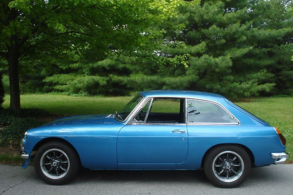

Model: 1972 MG MGB GT
Engine: Rover V8
Built by: Josh Strohm. (Finished by John Maas.)

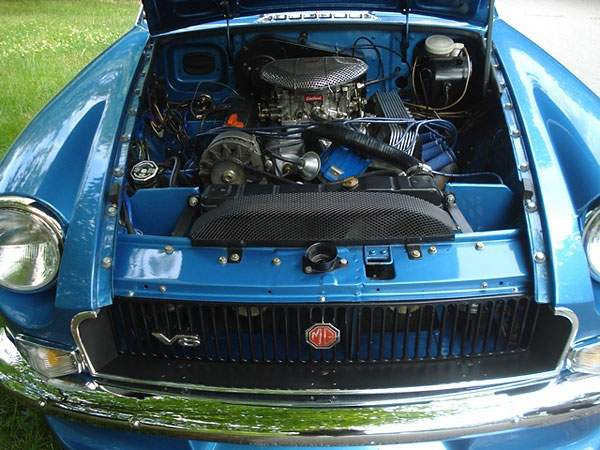

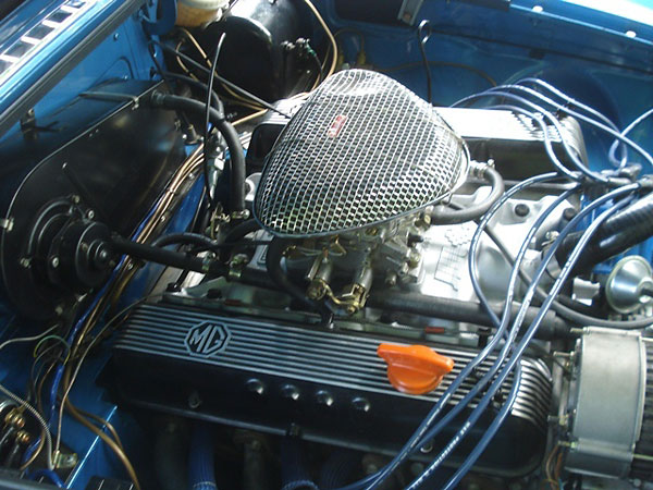

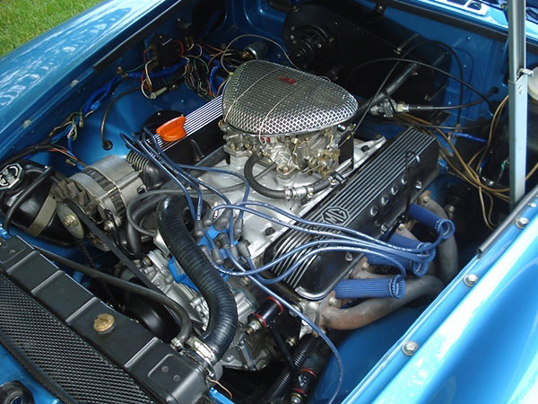

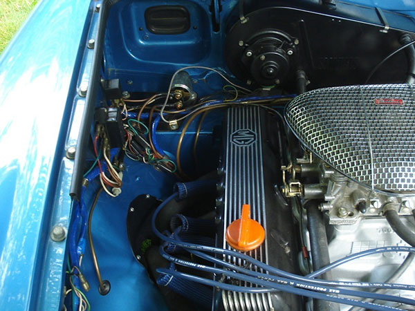

Engine: Rover 3.9L aluminum V8, stroked to 4.9L. Engine block bored 0.020" oversize. Buick 300 crankshaft (provides 3.40" stroke instead of 2.8" stroke). Buick 215 connecting rods (with wrist pin holes honed from 0.875" to 0.912"). Ford 255cid V8 pistons (with 3.68" nominal bore plus 0.040" oversize). Iskenderian 262 camshaft (Buick 300 spec., 0.445" lift, 262° duration, 110° lobe center). Buick 300 cylinder heads (with 54cc chambers and large valves). Offenhauser John Woolf Racing intake manifold. Edelbrock 500cfm carburetor. Edelbrock foam air cleaner. Lucas electronic distributor. Engine steady rod.
Cooling: MGB GT V8 radiator. Late-model MGB electric cooling fans.
Exhaust: MG RV8 style four-into-one headers. Custom dual exhaust system. Dual chrome exhaust tips.
Transmission: Rover LT77 five speed transmission.
Rear End: stock MGB.
Front Susp.: stock, except for tube shock conversion featuring Bilstein shock absorbers.
Rear Susp.: stock, except for tube shock conversion.
Brakes: stock MGB master cylinder. Drilled and slotted front rotors. Stock MGB calipers. Stock MGB rear (drum) brakes.

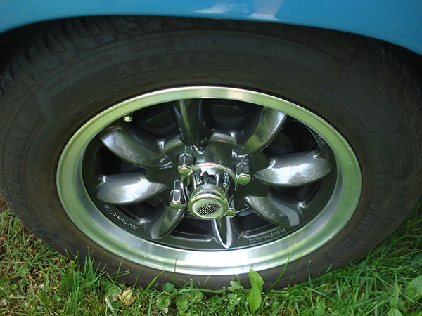

Wheels/Tires: Superlite eight-spoke aluminum wheels (15x5). General Altimax HP 185/65R15 tires.
Body: Special Tuning style fiberglass air dam.
Electrical: single 12 volt battery. JVC KD-PDR80 Stereo with 4 Pioneer 3-way speakers.
Instruments: Smiths gauges, including combination water temp and oil pressure gauge. Electric oil pressure gauge opening welded over.

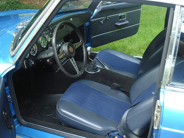

Interior: Abingdon-pillow style dashboard, stripped down to bare steel. Glove box was custom cut into the passenger side and two vents added in the center. Wrinkle finish paint applied to the dashboard. A custom center console in matching wrinkle finish was added to hold the stereo, map light, and cigarette lighter.
Completed: 2011. (Driven ~10,000 miles as of June 2013.)

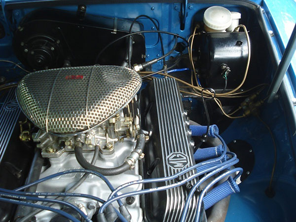

Rover 3.9L engine, bored and stroked to 5.0L, utilizing Buick 300 cylinder heads.
Rover 3.9L engine, bored and stroked to 4.9L, utilizing Buick 300 cylinder heads.

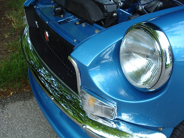

MGB GT V8 style (inverted, extended core) radiator and dual electric cooling fans.

Edelbrock 500cfm carburetor and Edelbrock foam air cleaner.
MG RV8 style (through the fender apron) four-into-one headers.
Padding has been removed from the Abingdon pillow style dashboard.
Padding has been removed from the "Abingdon pillow" style dashboard. Louvered vents and
a glove box were added, and then the assembly was finished with wrinkled paint.

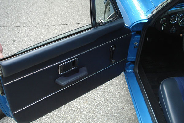

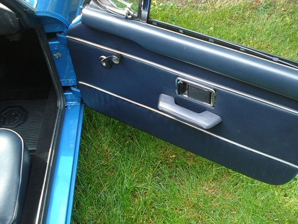

Driver side door trim.
Passenger side door trim.

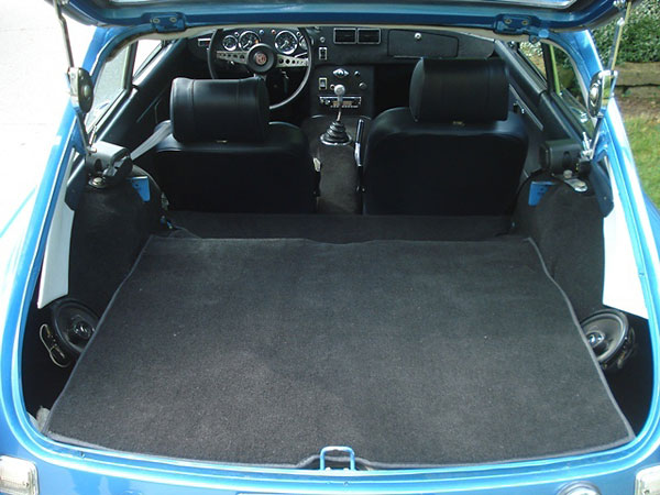

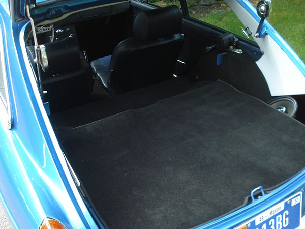

MGB GT cargo area.
MGB GT cargo area.
This shelf lifts up to reveal the spare tire and additional storage.

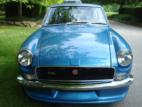

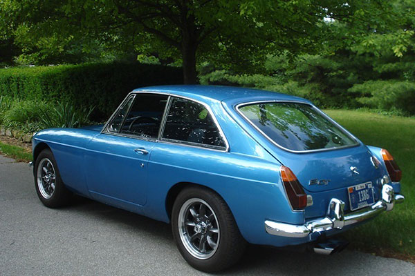

MGB GT went into production in 1965.
MG contracted the famous Italian stylist Pinin Farina to design a GT variant based on their
existing MGB roadster. The resulting design went into production in 1965. A similar but less
refined roof styling treatment may be seen in the Maserati Mexico model of 1966.
MGB GT: Pinin Farina's greatest masterpiece.
A growing number of enthusiasts are coming to recognize the MGB GT as Pinin Farina's masterpiece.
Pinin Farina's sublime masterpiece.

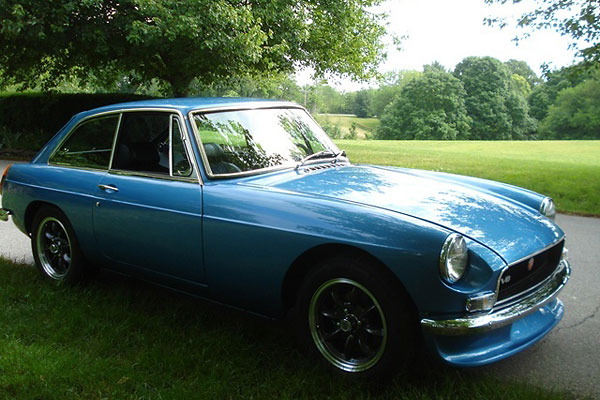

Pinin Farina's Practical Classic
With Rover V8 engine installed, the MGB GT really comes into its own as a practical classic.

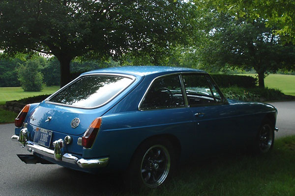

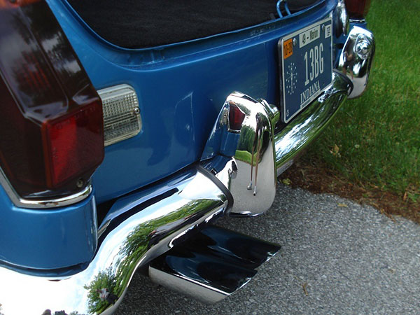

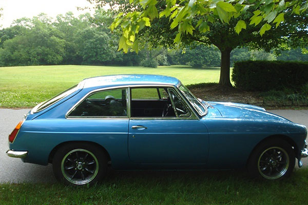

Superlite eight spoke aluminum wheels (15x5). General Altimax HP 185/65R15 tires.
