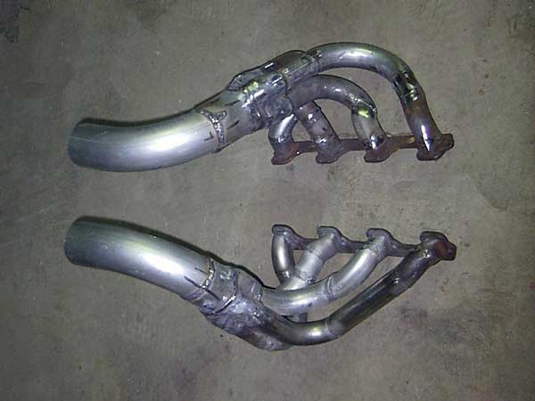

Exhaust: custom built through-the-fender headers with 3" collectors into 2.5" glass-pack mufflers exiting in front of the rear wheels (i.e. side pipes).

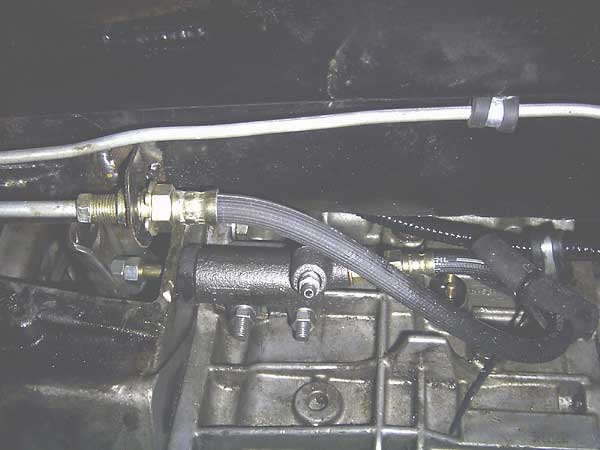

Clutch: stock Mustang clutch with a Toyota pickup truck slave cylinder and stock MGB Master Cylinder.

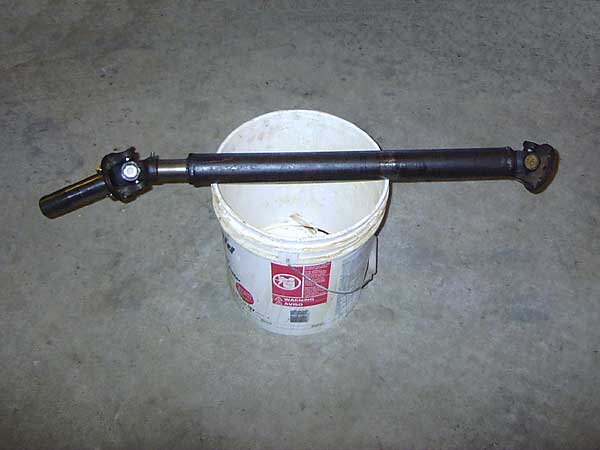

Driveshaft: a custom built adapter to the T5 slip-yoke is attached to the stock MGB driveshaft for now.

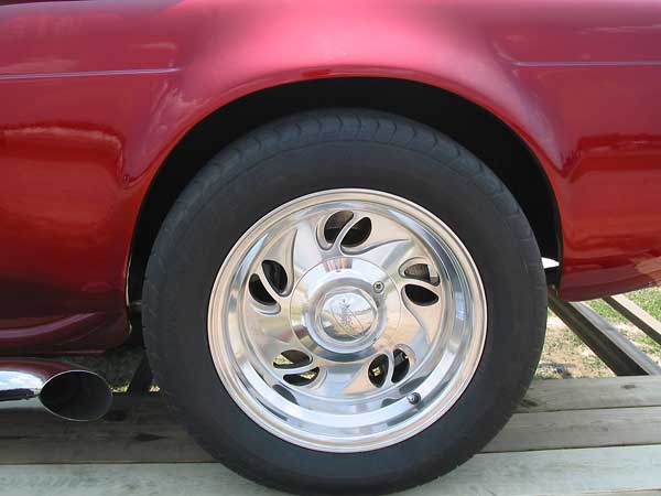

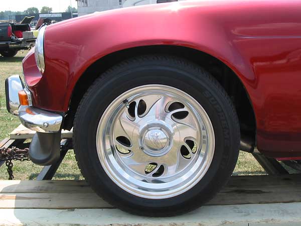

Wheels/Tires: 15 x 8 aluminum Eagles with the 4-on-4.5 bolt pattern all four. 225-50-R15 (front) and 245-50-R15 (rear).

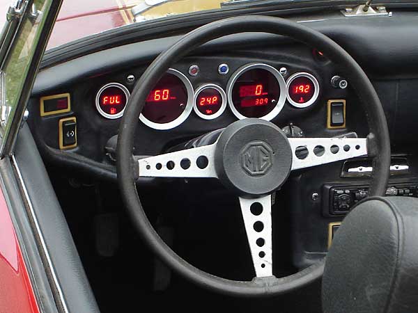

Instruments: Cyberdine Digital Gauges (which display 0-60mph time, quarter-mile time, quarter mile ultimate speed, and RPM recall). The gauges are installed in the factory dashboard, as shown below.

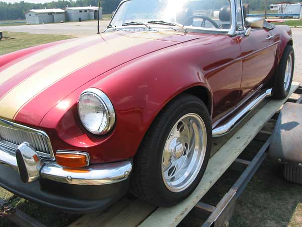

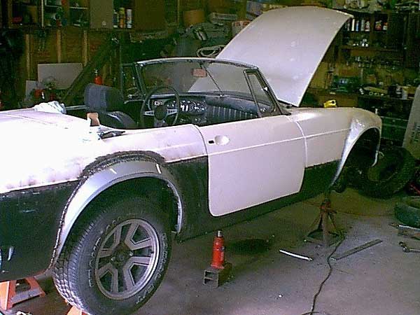

Body/Interior: New MGB body panels from the molding down (to repair rust). Steel fender flares from a Dodge Omni were grafted-in. Candy apple PPG paint (red over gold) with skunk stripes.

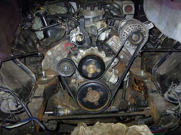

Other: reinforced floor pans and frame members. Extra thick rear spring pockets and lowering perches on rear axle. A centered torque bar on the rear axle eliminates axle wrap (i.e. restricts pinion movement.) Lowered front steering rack, and modified front crossmember to fit the 302 engine's small front sump.

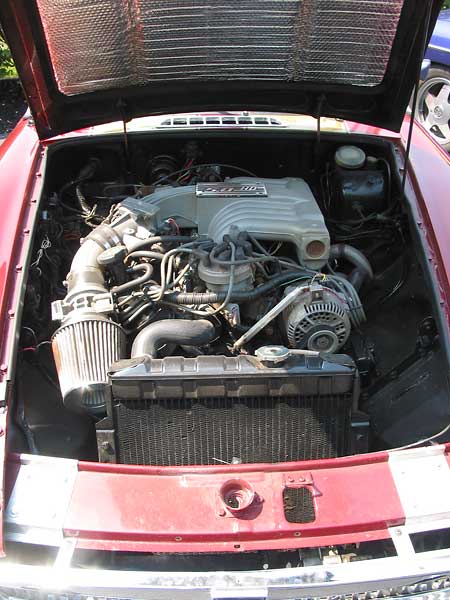

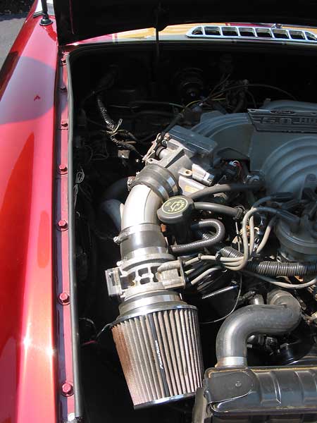

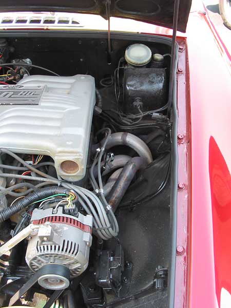

Ford 5.0 (302cid) high-output fuel-injected V8

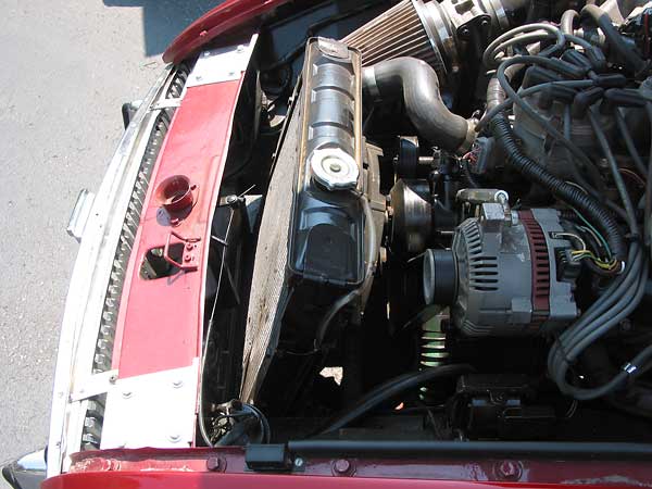

Tilted Ford Mustang Radiator
Ford Mustang radiator (tilted to facilitate mounting further forward than usual).
Joe Built His Own Headers
Joe built his own headers.
Ford Mass Air Flow (MAF) Sensor
Ford mass air flow (MAF) sensor

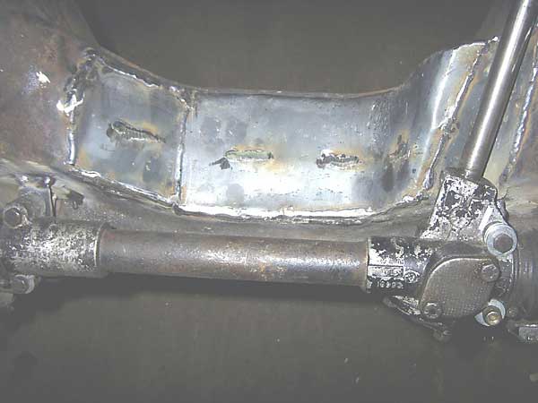

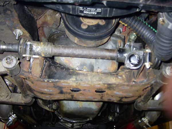

Modified front crossmember (for oil pan clearance)
Modified front crossmember (for oil pan clearance).
Relationship of Ford engine to MGB crossmember
Relationship of Ford engine to MGB crossmember.
Motor mounts, engine pulleys and fan belt
Motor mounts, engine pulleys, and fan belt.

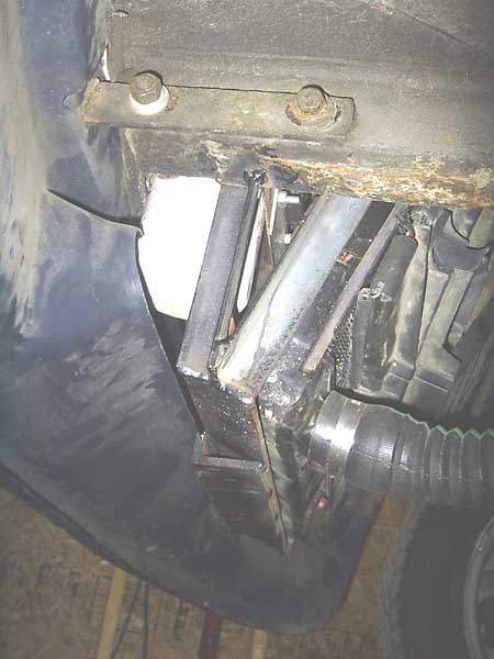

Lower radiator mounting bracketry
Lower radiator mounting bracketry.
Homemade, through-the-fender, four-into-one headers
Homemade, through-the-fender, four-into-one headers.
Easily serviceable external clutch slave cylinder
Easily serviceable external clutch slave cylinder.
Stock MGB driveshaft, with an adapter to mate to the new transmission
Stock MGB driveshaft, with an adapter to mate to the new transmission.

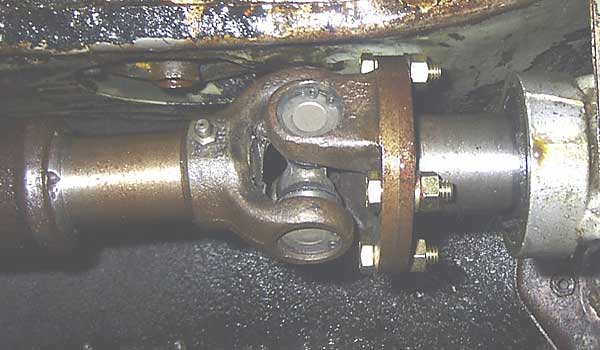

Custom built adapter to the T-5 slip yoke
Custom built adapter to the T-5 slip yoke.

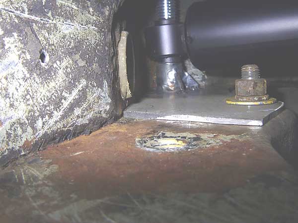

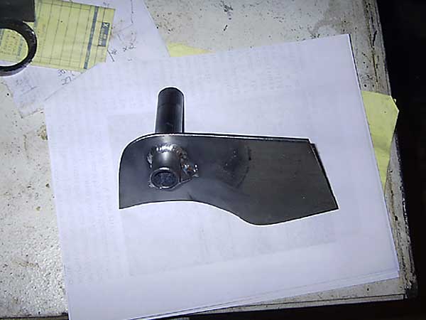

Custom adapter for telescoping rear shock absorbers
Custom adapter for telescoping rear shock absorbers.

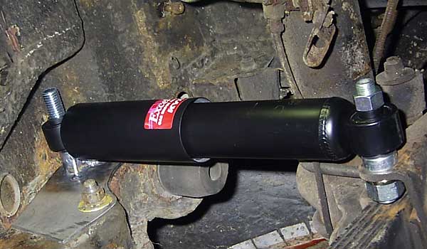

KYB shock absorbers for the rear suspension
KYB shock absorbers for the rear suspension.
Installing Dodge Omni fender flares
Installing Dodge Omni fender flares.

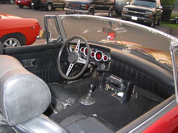

Cyberdine digital gauges
Beyond the usual data, Joe's digital gauges also display 0-60mph times, quarter-mile times, etc.
Dodge Omni Fender Flares
15 x 8 aluminum Eagle wheels (on a 4-on-4.5 bolt pattern)
