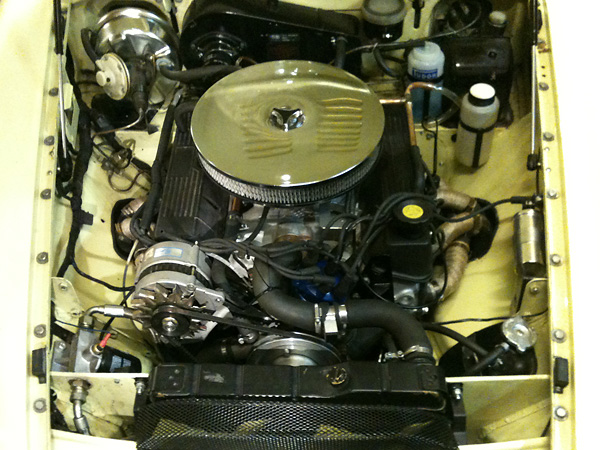

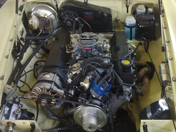

Engine: TVR (Rover) 4.3L aluminum V8. Offenhauser "John Woolf Racing" 7001-DP dual-plane intake manifold. Edelbrock four barrel carburetor (model 1404). Stock camshaft and valvetrain. Ignition DML8.
Cooling: original MGB V8 cooling system. Dual electric cooling fans.

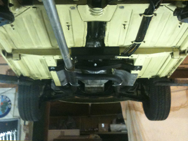

Exhaust: RV8-style four-into-one tubular exhaust manifolds. Single muffler.

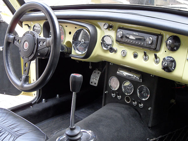

Interior: stock steel dashboard, stripped and repainted primrose yellow. Pioneer 77 classic looking radio with Pioneer compo speaker set. Moto-Lita steering wheel. MG RV8 seats in black leather. Everything else is upholstered in black Alcantara, including the ceiling trim panel.

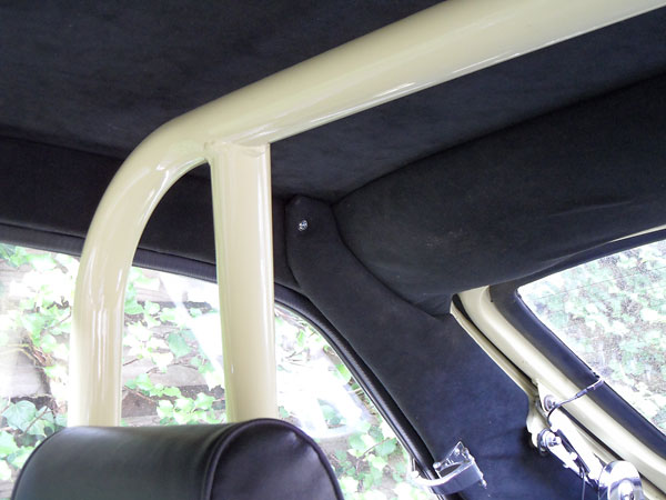

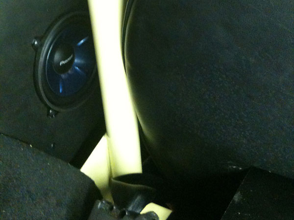

A roll hoop has been installed, painted primrose yellow to match.
Instruments: (left to right) Smiths tachometer, speedometer, dual purpose oil pressure / water temperature gauge, oil temperature gauge, clock, and voltmeter.

Comments: On the first test drive, fuel percolated in the carburetor. This was solved by adding an spacer between intake manifold and carb mounting. The original rear axle ratio wasn't so good - very short gears - so I ordered a "V8" ring and pinion gear set which will be installed shortly. I haven't had any problems yet. Water and oil temperatures look well. The engine is running very nicely!
TVR 4.3L V8 with Offenhauser John Woolf Racing manifold and Edelbrock four barrel carburetor.
TVR 4.3L V8 with Offenhauser "John Woolf Racing" manifold and Edelbrock four barrel carburetor.

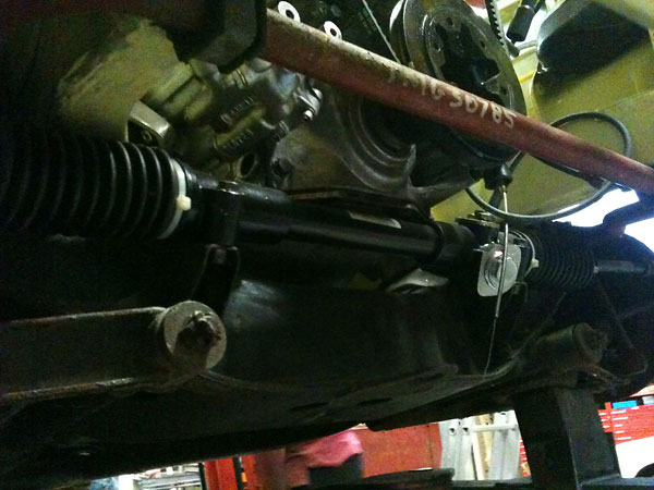

Steering rack clearance.

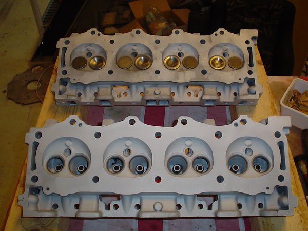

Rebuilding the cylinder heads
Exhaust routing.
Exhaust routing.
Stock steel dashboard, stripped and repainted primrose yellow.

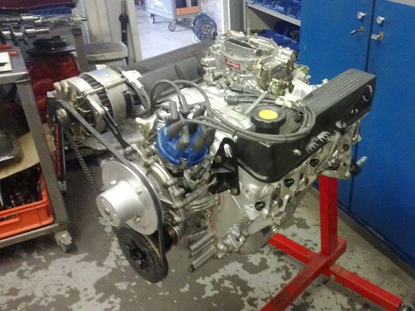

Updates as of November 2013:

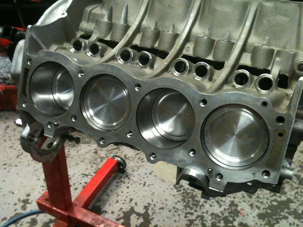

Completely overhauled Rover 4.0L V8 with cross bolted main bearing caps.
Piper 275 camshaft. Intake and exhaust ports polished.
Inside: Piper 275 camshaft. Intake and exhaust ports have been polished.

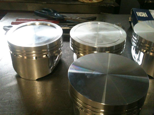

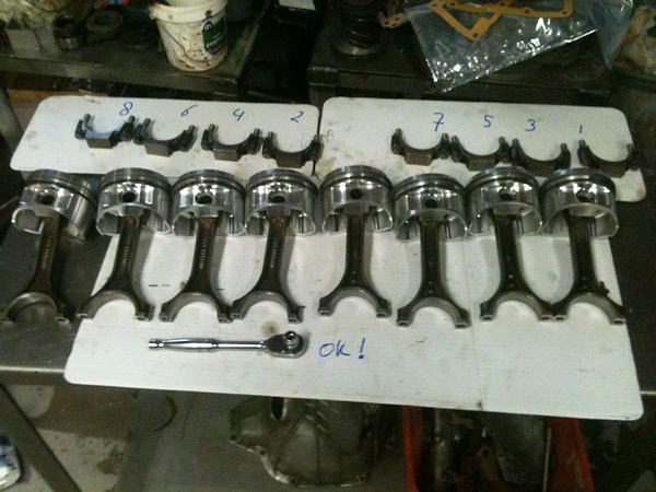

Custom pistons from JE Pistons.
Custom made pistons from JE Pistons. Dishes have been cut to achieve the desired compression ratio.
10.5:1 compression ratio.
With dish as shown at left: 10.5:1 static compression ratio.

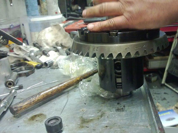

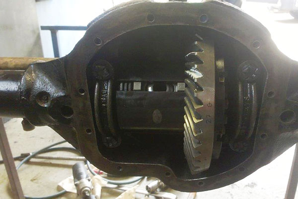

Quaiffe limited slip differential.
3:07:1 ring and pinion.
