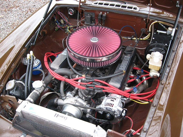

Engine: Rover 3.5L V8 engine bored 0.020" over and balanced. Crower camshaft (level 1). Ported cylinder heads. Buick 4-barrel intake manifold. Edelbrock 500cfm carburetor. Lucas distributor. Pertronix Ignitor electronic igntion module. Pertronix Flamethrower ignition coil. Remote oil filter.
Cooling: Howe aluminum radiator. Stock electric fans, pushing.
Exhaust: RV8-style four-into-one headers. Two-into-one out the back.

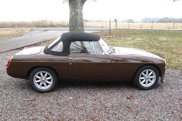

Wheels/Tires: VTO 15x6 8-spoke aluminum wheels. 195/60R15 tires.

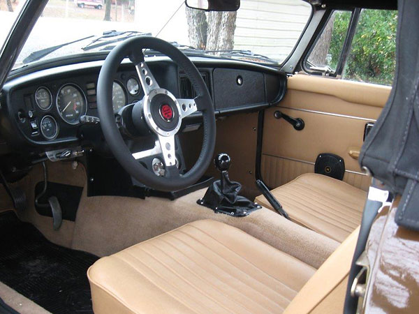

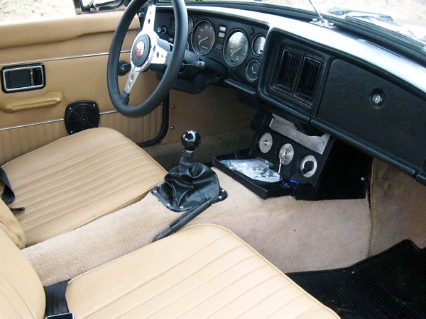

Interior: restored beige interior.

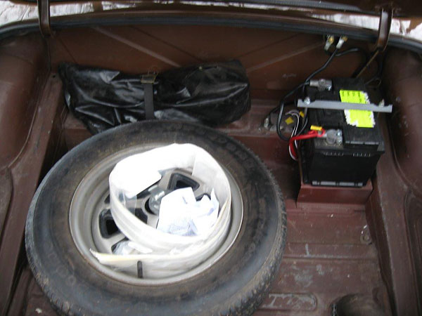

Electrical: battery relocated to trunk. Nippondenso alternator.
Instruments: stock MGB. (Tachometer rebuilt for V8 use.)

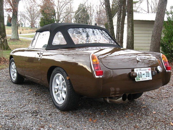

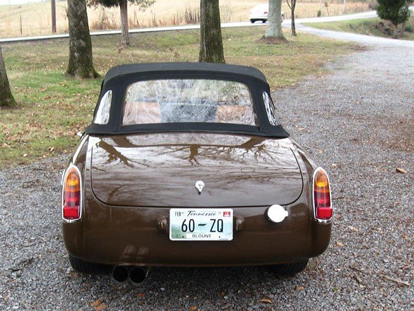

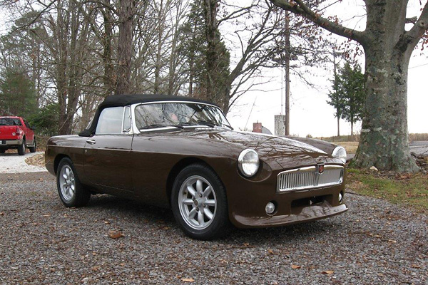

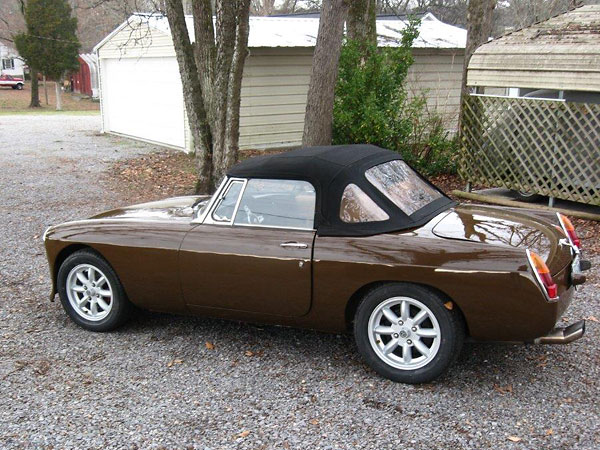

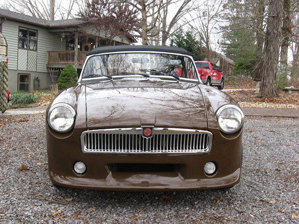

Body: removed front and rear bumpers. Preform Resources front and rear valances. Austin-Healey front turn signals/marker lights. Shaved side trim. Shaved side marker lights. Shaved back-up lights. Body-color license plate lamps. Russet Brown paint.

Rover 3.5L aluminum V8 engine.
Stock MGB instruments and dashboard.
Beige interior.
Battery relocated to trunk.
Preform Resources fiberglass front valance, with Austin Healey turn signals.
VTO eight spoke aluminum wheels.
VTO 15" eight spoke aluminum wheels.
Shaved side trim and marker lights.
Preform Resources fiberglass rear valance.
Shaved back-up lights. License plate lamps painted body color.
