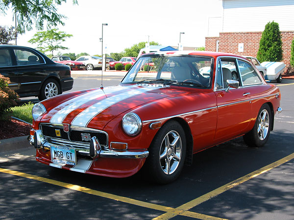

Jim Ohnstad's 1974 MGB-GT with GM 3.4L V6
Owner: Jim Ohnstad
City: Fargo, ND
Model: 1974 MGB-GT
Engine: GM 3.4L V6
Conversion by: Brian McCullough
(as photographed at British V8 2008 in Port Washington, WI)
Brian McCullough at BMC does MGB V6 conversions and sells the parts so you can do them yourself

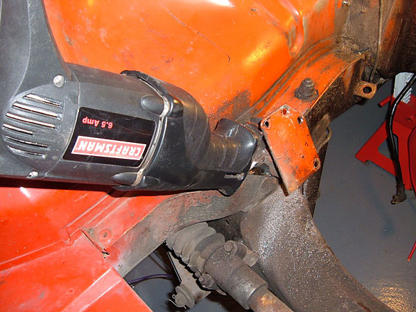

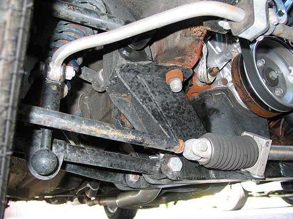

removal of MG motor mounts
Removal of the original MG motor mounts on early rectangle mounting system.
(This isn't required with the later engine mounts.)
hammer work for the cylinder head clearance
A little hammer work makes room for the cylinder head and exhaust.
In the foreground: a Classic Conversions Engineering bolt-in motor mount.

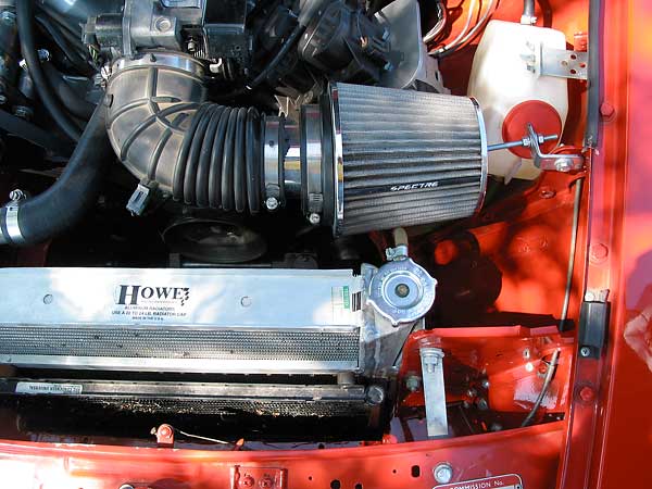

New radiator brackets.
New radiator brackets have been installed about six inches forward of original.

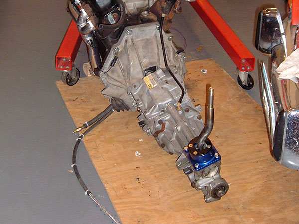

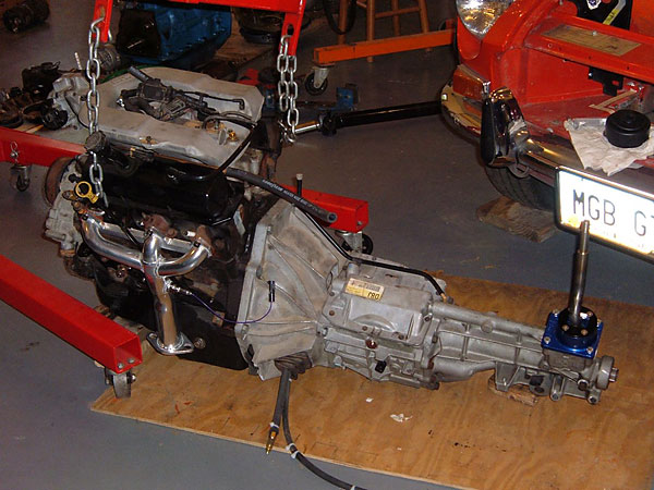

crate engine with camaro bellhousing and transmission
t5 transmission and bellhousing

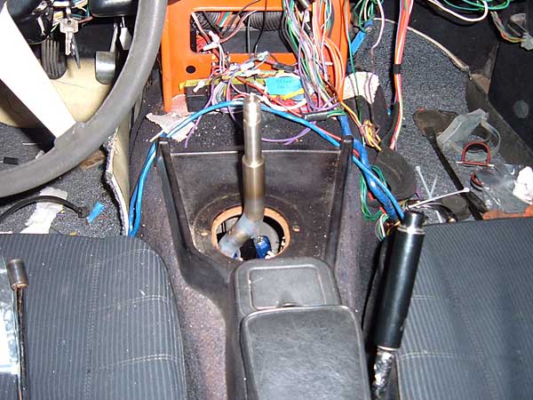

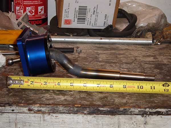

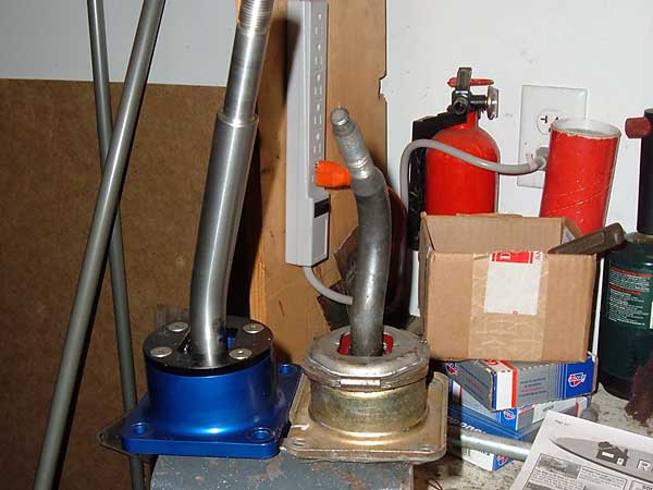

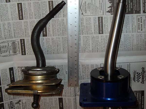

aftermarket S10 shifter vs stock Camaro shifter
Left: this aftermarket shifter was made for a Chevrolet Camaro. It requires modification,
but will provide the desired feel and short throw.
Right: Difficult-to-find short-throw S10 shifter. Note that the pivot point on this S10 shifter
is about twice the height off the bolting plate as most S10 and stock Camaro shifters. Both
shifters have to be reshaped to fit the MGB. Usually this is done with heat or welding.
aftermarket shifter for Chevrolet S10 pickup truck

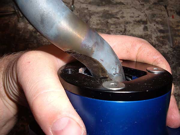

bent shifter lever
The S10-style shifter lever needed to be bent two places...
finesse
It also needed to be finessed a little with a grinder.
shifter alignment with console
Now the shifter is perfectly aligned with the tunnel and console.

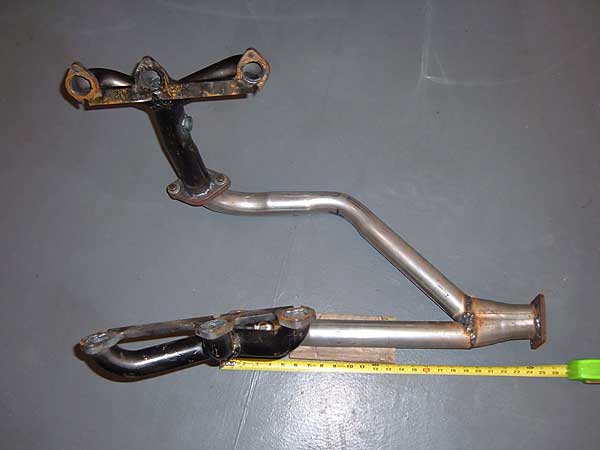

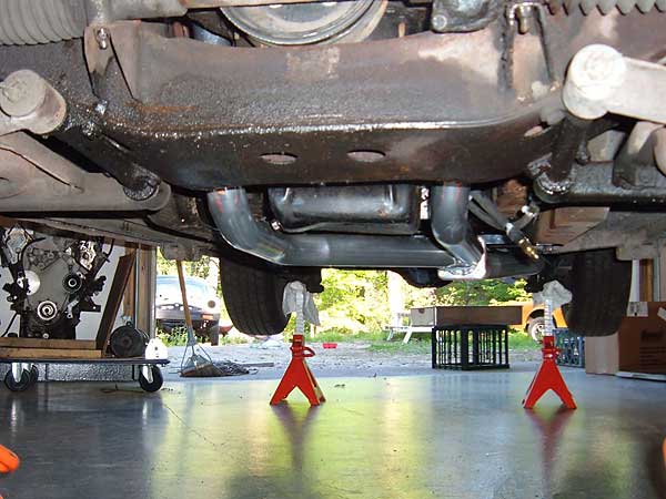

Classic Conversions headers
First generation Classic Conversions headers, fitted to a purpose-built y-pipe.

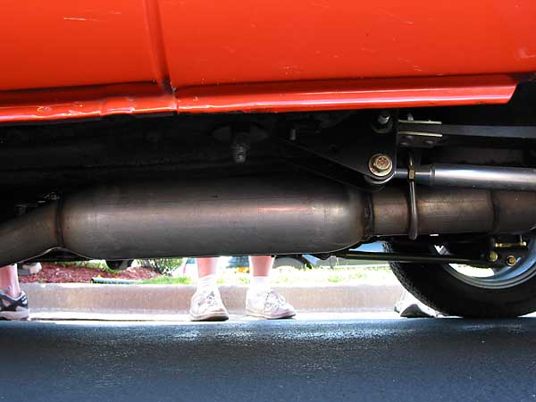

exhaust system

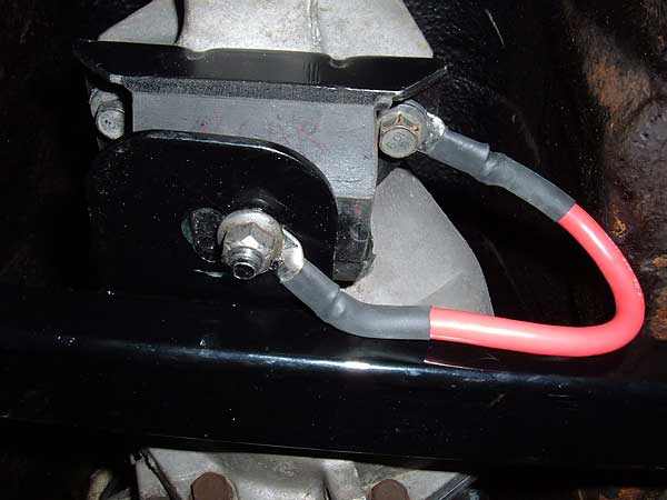

transmission ground strap
Transmission ground strap.

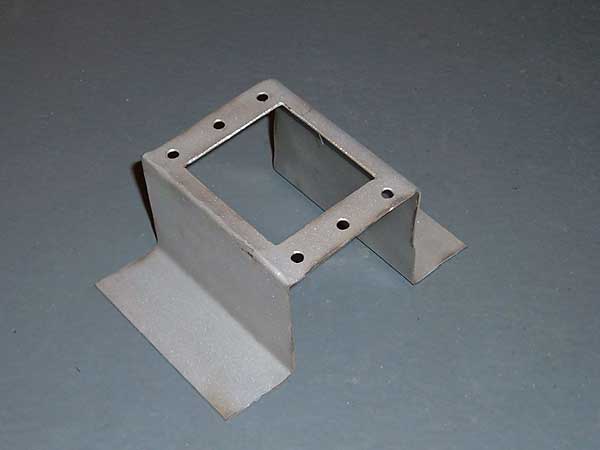

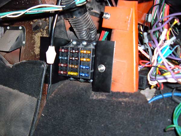

fuse block bracket
fuse block
installed fuse block

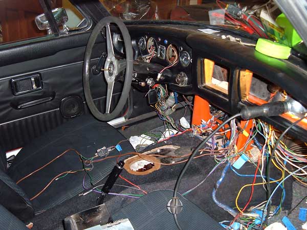

installing the dashboard wiring

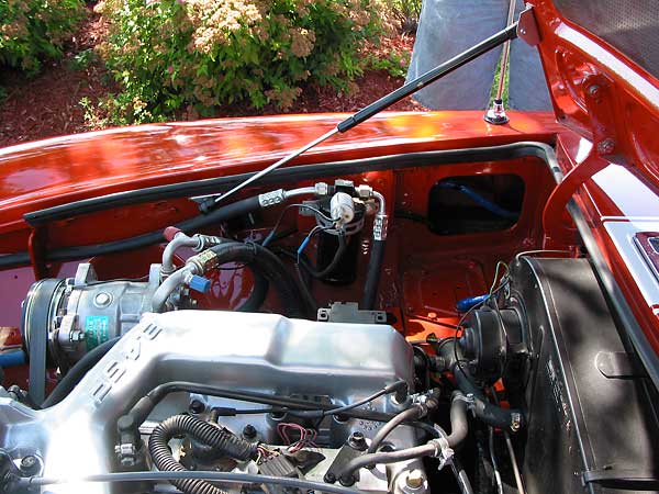

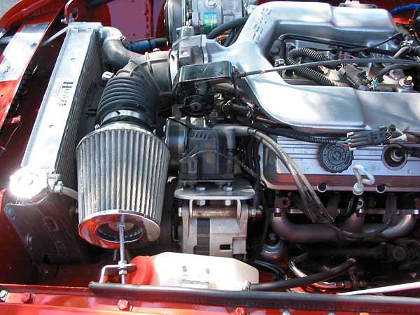

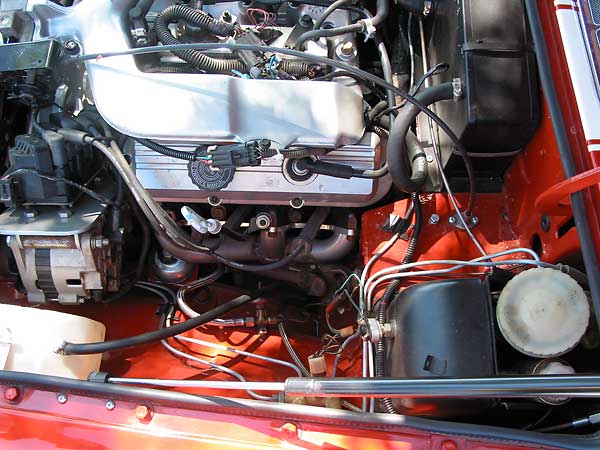

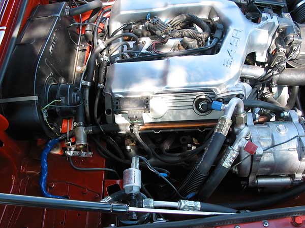

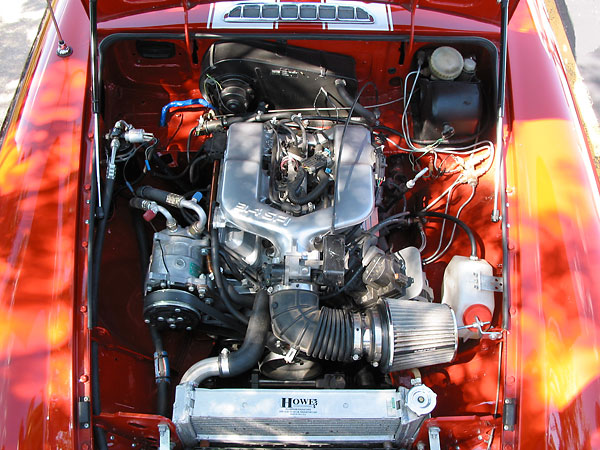

side view of engine compartment
Classic Conversions motor mount

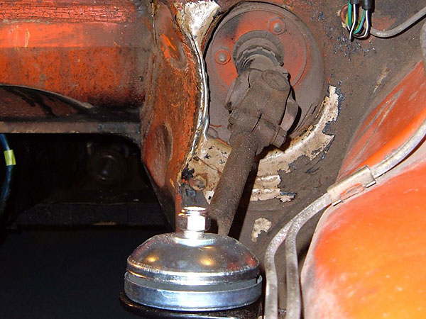

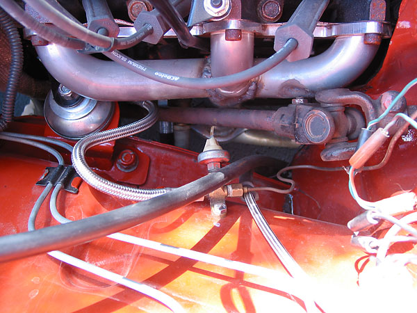

interference with steering u-joint?

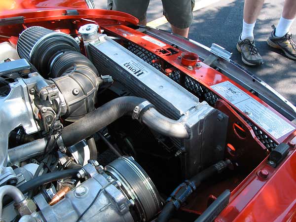

ignition coils
Spectre air cleaner?

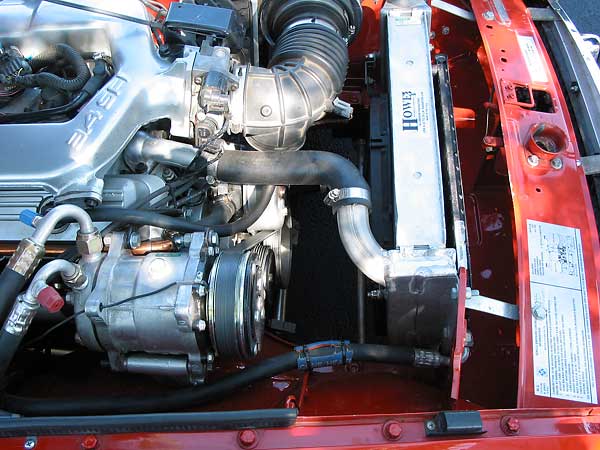

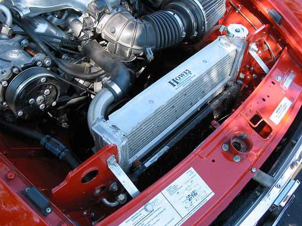

Howe aluminum radiator

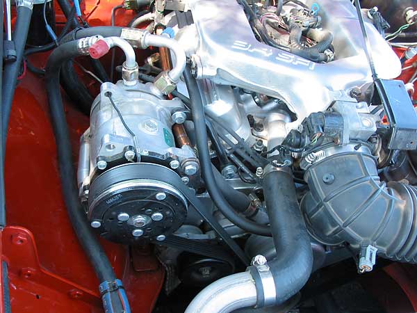

Sanden air conditioning compressor
throttle body
air conditioning clutch

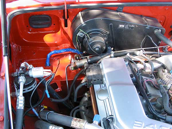

receiver dryer
heater valve

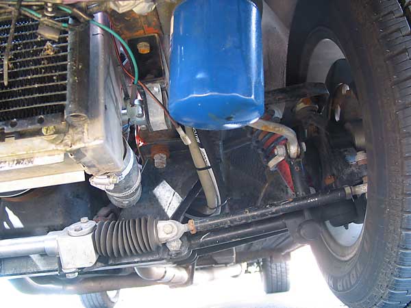

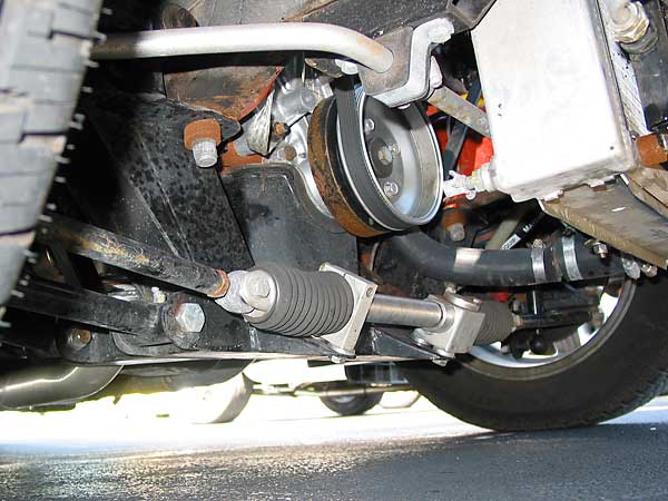

Fast Cars front suspension
front antisway bar
oil filter location
muffler

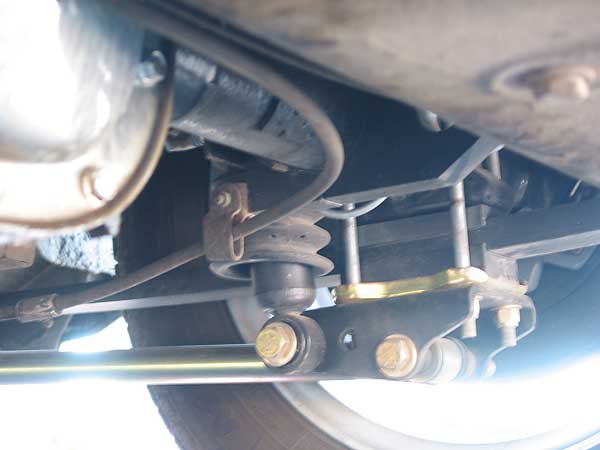

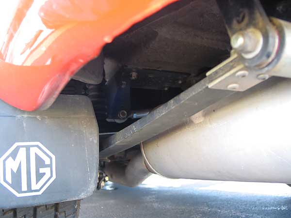

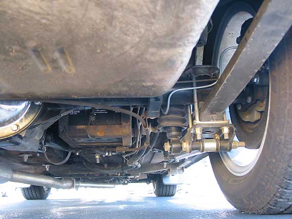

fiberglass leaf springs, supplemented with anti-tramp bars
telescoping shock absorbers

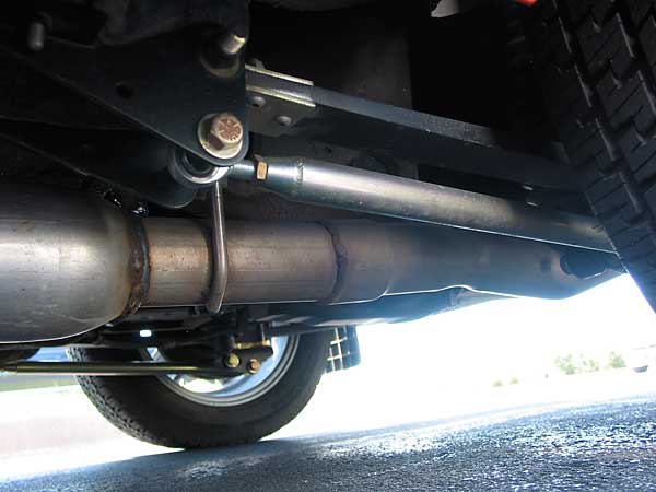

clamp-on Panhard bar bracket connection to rear axle
Panhard bar bracket to body

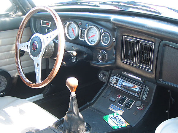

MotoLita steering wheel?
gauges

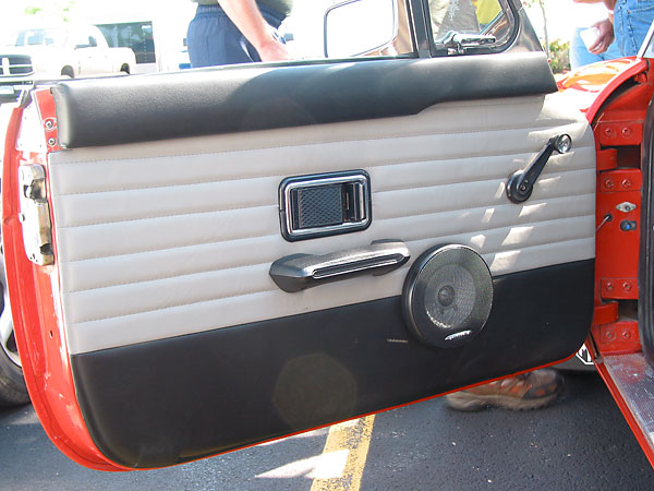

custom door trim panel

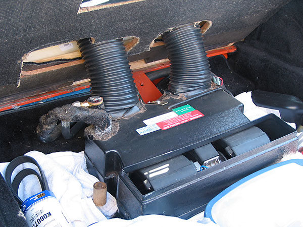

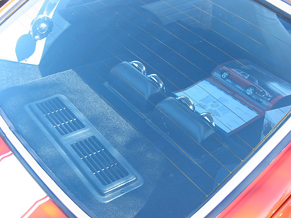

air conditioning evaporator/blower...
...takes up the whole luggage and spare tire compartment

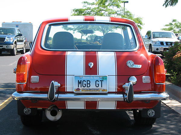

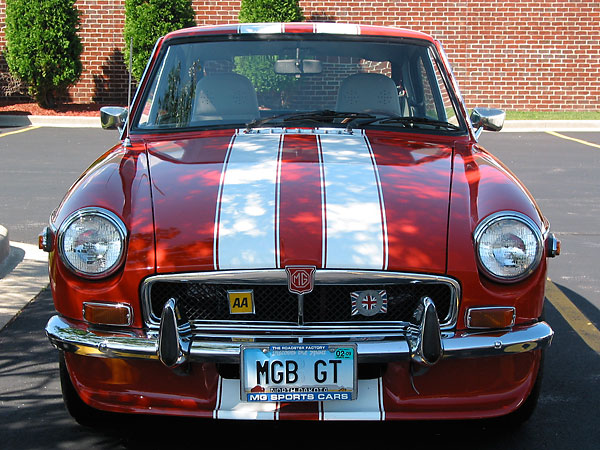

Chevy Camaro inpired paint scheme
front

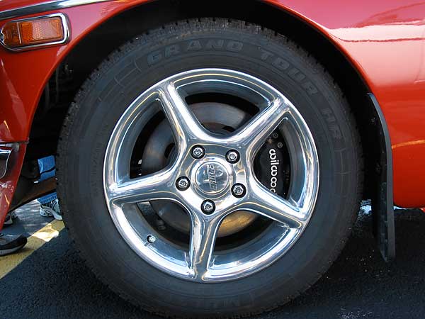

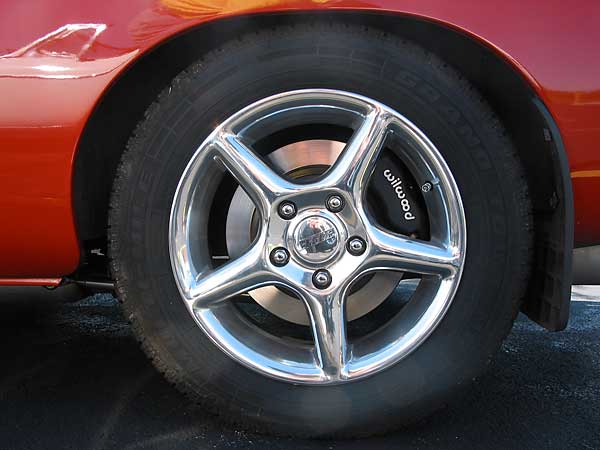

front wheel and tire
rear wheel and tire
