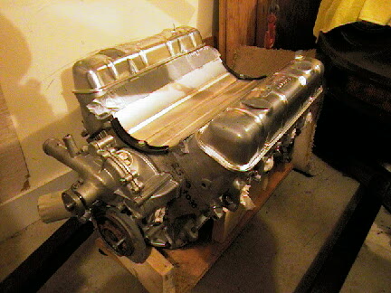

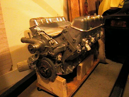

Engine: Buick 215 V8
Conversion by: owner

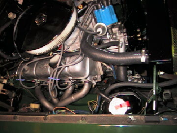

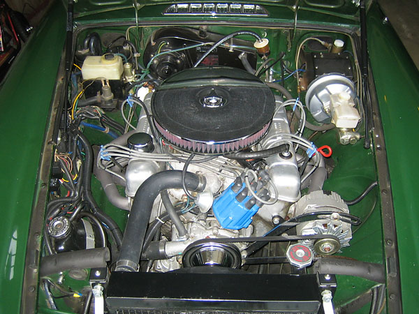

Engine: Buick 215 V8 with stock Buick intake manifold. Carter 500 CFM carburetor, with stock metering rods and 0.083" (part number 14244) primary jets. Stock cam. Pertronix Ignitor ignition and FlameThrower coil. D&D swivel oil filter adapter. The stock SU fuel pump worked for a few months. I switched to a Facet style pump mounted on rubber grommets to keep it quiet.

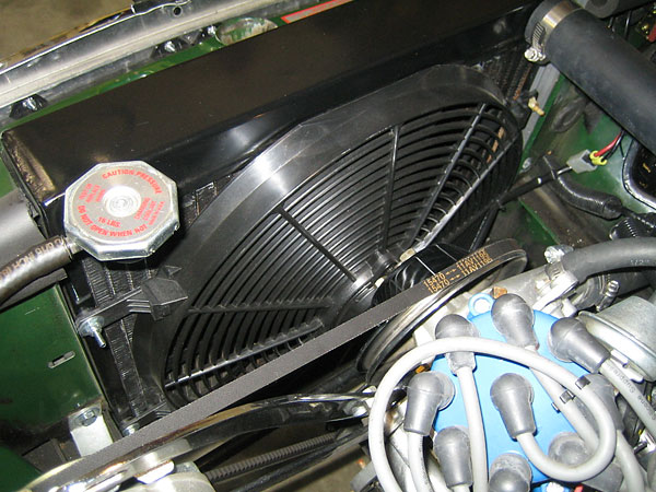

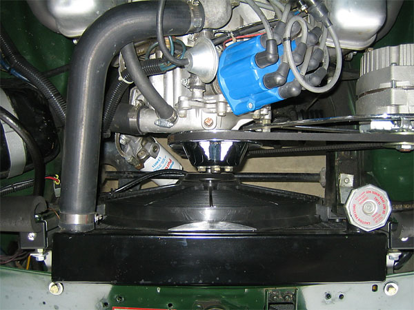

Cooling: 4-row radiator from D&D Fabrications. I originally used an engine driven fan, but it didn't provide adequate cooling for extended idling on hot days, so I switched to a 16", 3000cfm electric fan and solved the problem. I had to move the radiator forward about 1.5" to fit the fan. I'm using a 180 degree thermostat because I found that a 160 degree thermostat ran too cold.

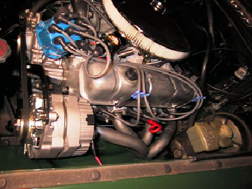

Exhaust: RV8-style headers into dual 2" exhaust, with ($20) turbo mufflers.

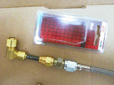

Transmission: Borg Warner T5 5-speed with 0.63:1 5th gear and D&D shifter. Stock master cylinder. Weber hydraulic throw-out bearing type slave cylinder. Note: a 1.5" pedal-stop block was mounted on the interior of the firewall to limit pedal travel and protect the hydraulic throw-out bearing from over-extension.

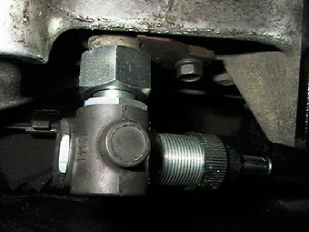

Electrical: homemade wiring harness with relays for the radiator fan and headlights. AutoPal "E-code" (European beam pattern) headlights. Recalibrated MGB tachometer, using Leon Zak's 100K pot method. Stock speedometer with right-angle ratio adapter from "ACI Engineering". An Audiovox cruise control system has been installed - mounted in the passenger-side upper footwell with its controls hidden in the ashtray.

4-row radiator

SPAL fan
Jim Miller's Buick 215   Jim Miller's Buick 215
Jim Miller's long block   Jim Miller's long block
speedometer cable   hydraulic throw-out bearing coupling
Speedometer cable (left) and the hydraulic throw-out bearing coupling for the clutch.
