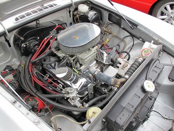

Engine: GM 3.4L 60-degree V6 engine. Comp Cams Magnum rocker arms. Classic Conversions Engineering motor mounts. Edelbrock lower intake manifold with Classic Conversions Engineering upper manifold (CC-105). Holley 390cfm carburetor. Custom fabricated air cleaner. Carter electric fuel pump. Taylor Spiro-Pro 8mm spark plug wires. MSD Blaster 2 ignition coil.

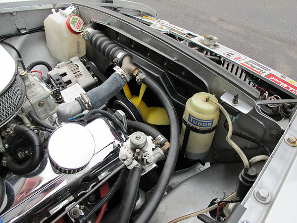

Cooling: stock MGB radiator. One electric fan (pushing) and one mechanical fan (pulling). Flex-a-lite adjustable electronic fan controller.

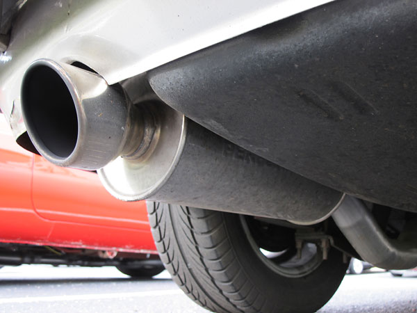

Exhaust: Classic Conversions Engineering headers. Single glass-pack muffler (mounted driver-side, by battery box). Single Magnaflow muffer (mounted next to fuel tank).

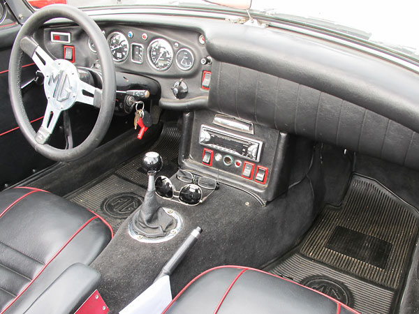

Interior: Mountney steering wheel on custom hub. Transparent plastic sunvisors. Two-stage (top up or top down) roll hoop. First Alert fire extinguisher. JVC 180W stereo. Dual audio system amplifiers, mounted in the truck. Dynamat sound deadening insulation. New carpet throughout cockpit and boot.
Instruments: AutoMeter tachometer (0-7000rpm) and speedometer (0-120mph). Smiths fuel level, oil pressure, and coolant temperature gages.

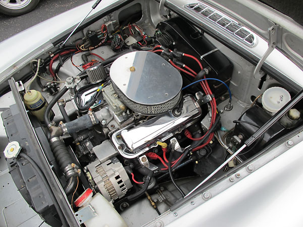

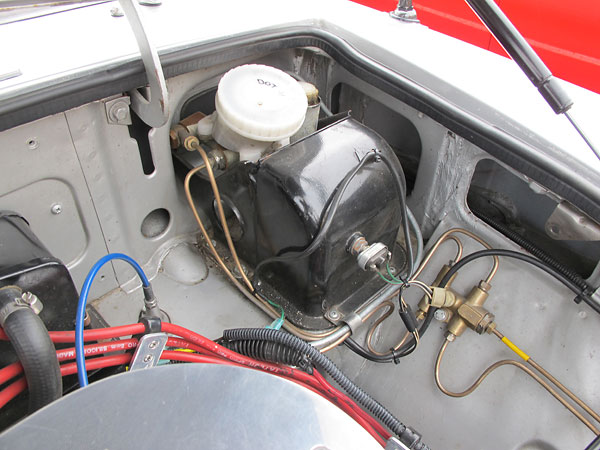

Stock MGB brake and clutch master cylinders.

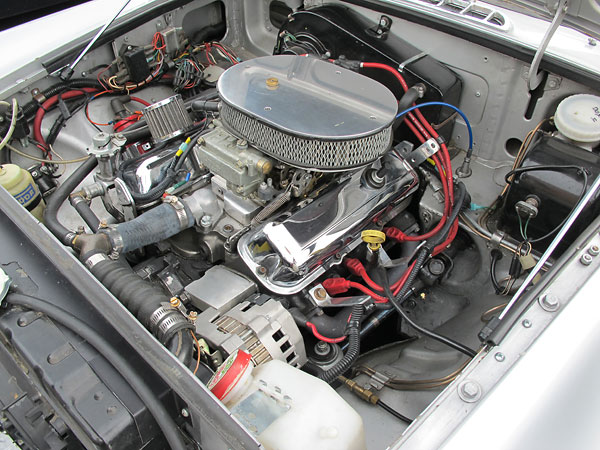

Edelbrock lower intake manifold.

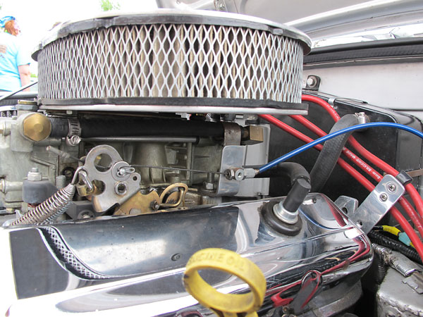

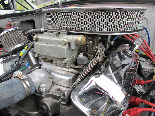

Classic Conversions Engineering upper intake manifold (CC-105).

Stock MGB radiator. One electric fan, pushing.
Mechanical engine cooling fan.

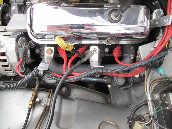

Both cooling fans can be seen in this view.

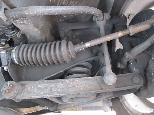

Negative-camber (extended) lower control arms.

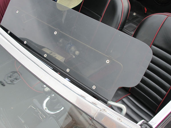

This roll hoop will provide a convenient place to mount a wind blocker.

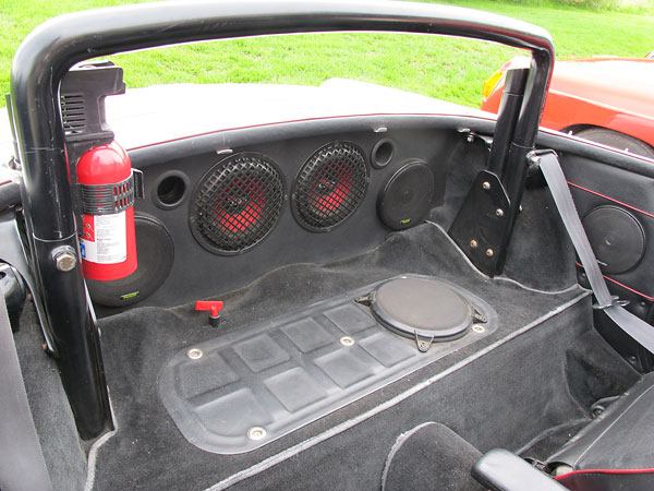

Whole bunch of speakers!

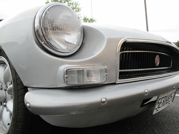

Powder coated front bumper.

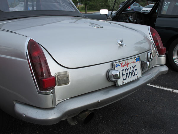

Powder coated rear bumper. Bumper over-riders removed. MGB MkI taillamps.
