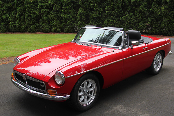

Jim Durham's 1980 MGB with stroked Ford 302cid V8 Engine
Jim Durham's 1980 MGB with Ford 302cid V8 Engine

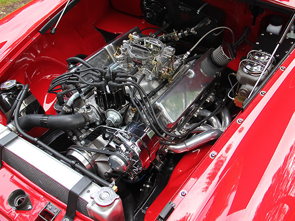

Engine: Ford 302
Conversion by: owner

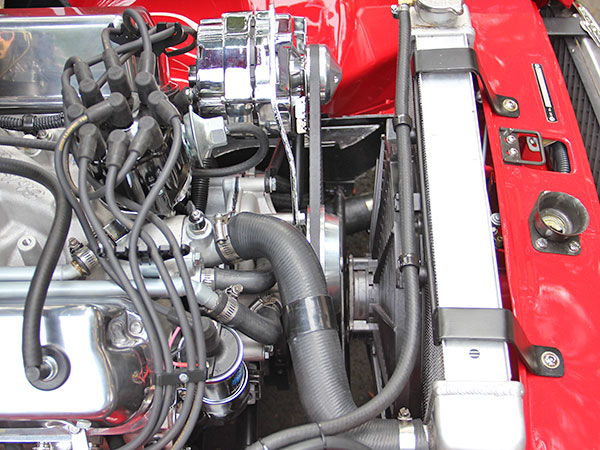

How It Was Done

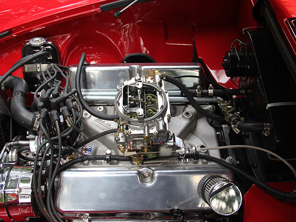

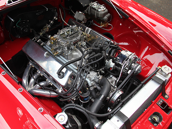

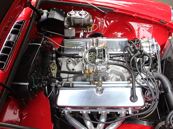

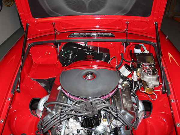

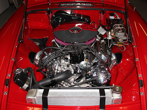

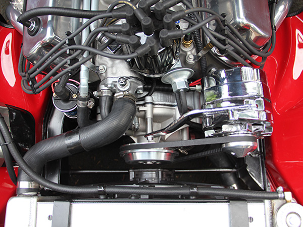

Engine: Ford 302, bored 0.020" over and balanced. Edelbrock E-Street aluminum cylinder heads. Edelbrock Performer camshaft. Scorpion roller rockers. Edelbrock Performer #2121 (satin finish, non-EGR) intake manifold. Edelbrock Performer 600cfm carburetor. Facet Bendix-style electric fuel pump. Pertronix Flame-Thrower Ignitor III distributor. Pertronix Flame-Thrower ignition coil. Moroso spark plug wires. CVF Racing pulleys. Remote mounted oil filter.

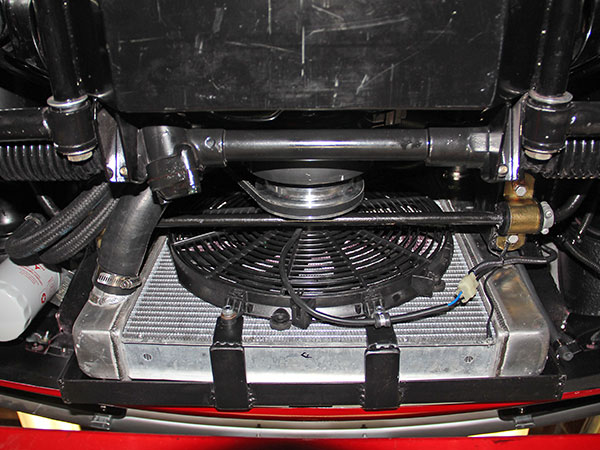

Cooling: 22" wide aluminum crossflow radiator. Ford short water pump. Maradyne 16" electric (puller) fan.

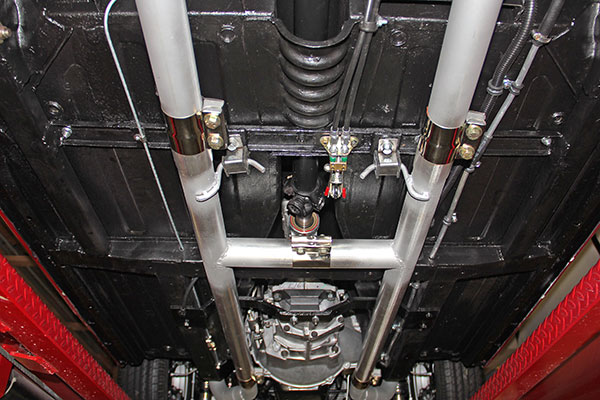

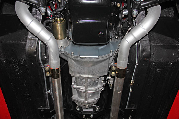

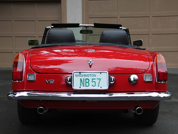

Exhaust: ceramic coated RV8-style four-into-one headers, specially modified for suspension clearance. "H" pipe. 2.25" dual exhaust. Jones Exhaust Systems mufflers: one glass pack and one straight through truck muffler on each side.

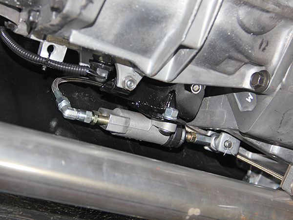

Transmission: Ford Racing T-5Z w/0.63:1 fifth gear. Ford King Cobra clutch. Modified Ford Mustang shifter. Tilton master cylinder. Nissan slave cylinder.

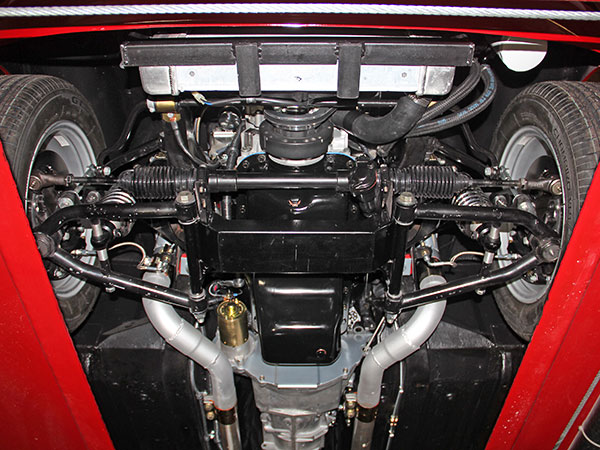

Front Suspension: Classic Conversions Engineering (CCE) adjustable coil-over front suspension.

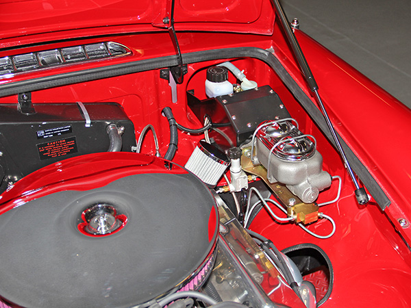

Brakes: (master) Corvette master cylinder and automatic proportioning valve. Lokar parking brake cable kit.

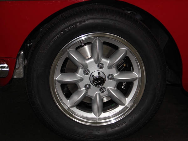

Wheels/Tires: VTO 8-spoke aluminum wheels, size 15x6. Champiro VP1 tires, size 195/60R15.

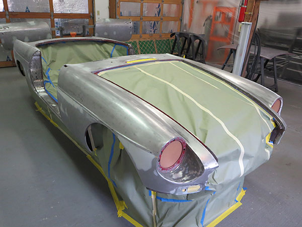

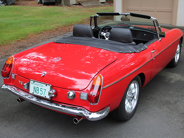

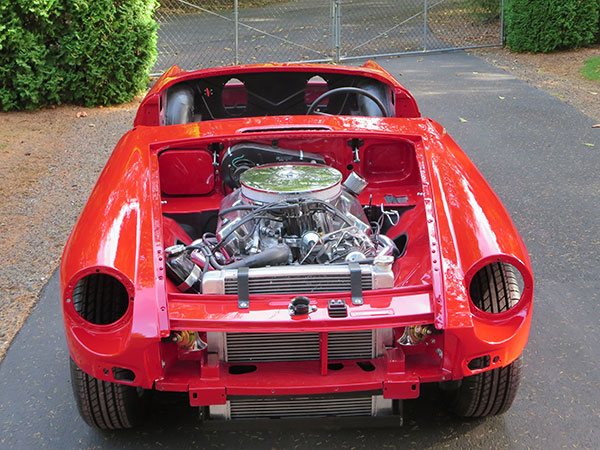

Body: chrome bumper conversion. Removed side marker lamps. Removed middle windshield wiper. Removed fender beads. Filled all seams. Filled firewall and engine bay apertures and holes. Custom fabricated rear bumper fill pieces, welded in place and painted body color. Polished windshield frame. Centered fuel tank. Underside of car and complete interior and trunk coated with bedliner.

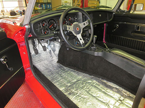

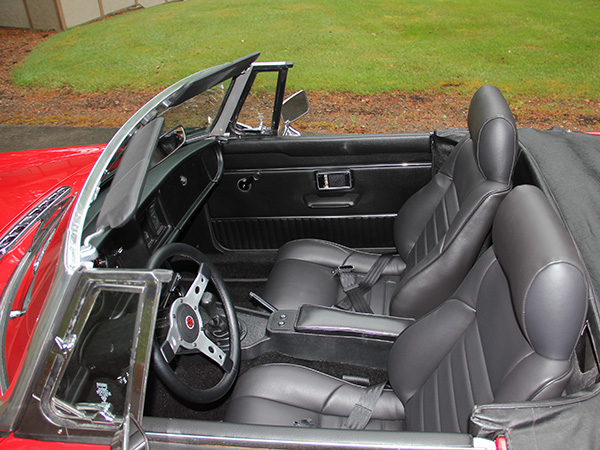

Interior: Fiero seats with Mr. Mikes covers. Electric seat heaters. Kenwood sound system with 6 speakers and high power amplifier (model KAC-744). Dynamat sound deadener on interior side of firewall. Thermo-tec insulation on floorboards.

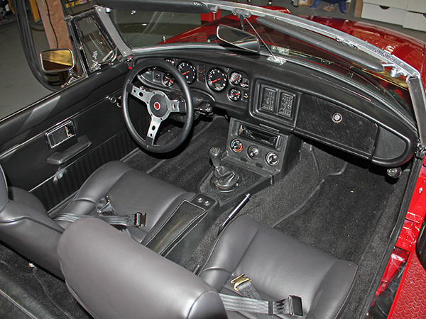

Instruments: Speedhut gauges. GPS speedometer.

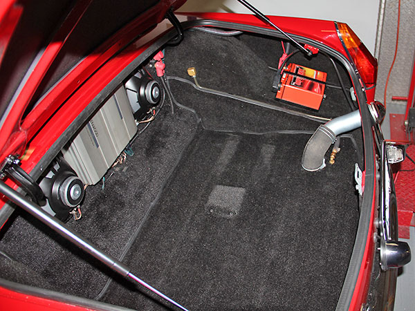

Electrical: custom made wiring harness using 10 relays. Delco 110-amp alternator. Gear reduction (mini) starter. Odyssey lightweight battery, located in the trunk. Battery disconnect switch.
Completed: 4-1-2016.
Jim's Comments: I do all my own work including body and paint. The only thing farmed out was the machine work on the engine block. My goal in building this car was to have the finished product look like a stock MGB to the casual observer. With the exception of the dual exhaust and two small V8 emblems, nobody notices the modifications until the engine is started.
Ford 302, bored 0.020 over and balanced.
Corvette master cylinder and automatic (4-way) brake proportioning valve.
Corvette master cylinder and automatic ("4-way") brake proportioning valve, plus Wilwood
manual proportioning valve on rear circuit. Tilton clutch master cylinder.

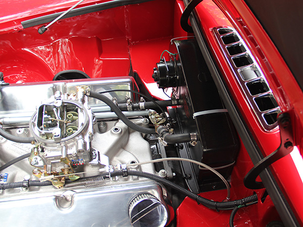

CVF Racing pulleys.
CVF Racing pulleys.

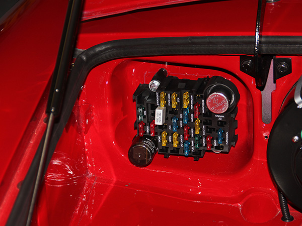

Cover for fuse and relay center.
Cover for fuse block. Note also that engine bay apertures have been filled in.
Fuse and relay center.
Fuse block. Note how completely wiring has been hidden.
(Note: relays are mounted under the dashboard.)

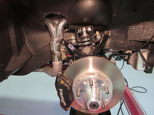

Wilwood brake calipers and rotors.
Maradyne 16 inch electric (puller) fan.
Ford Racing T-5Z gearbox w/0.63:1 fifth gear.
Ford Racing T-5Z transmission w/0.63:1 fifth gear.
Nissan clutch slave cylinder.

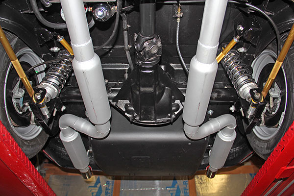

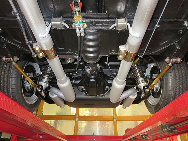

Exhaust H-pipe.

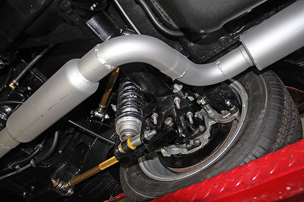

"I made the exhaust system using a universal kit. I used four small mufflers and an H-pipe
to keep noise down and facilitate not having the mufflers under the passenger compartment,
to reduce cabin heat and increase ground clearance."
CCE 4-link adjustable coil-over rear suspension.

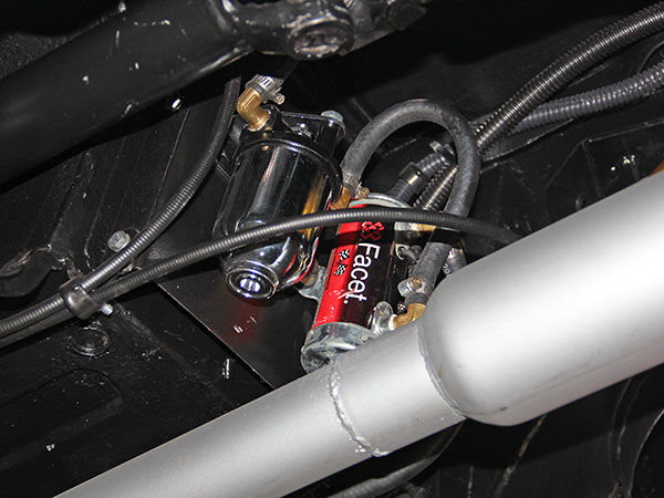

Jones Exhaust mufflers: one glass pack and one straight through truck muffler on each side.

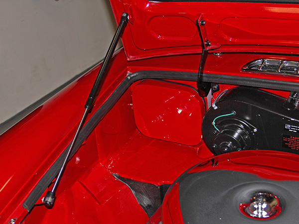

Centered fuel tank facilitates symmetry.

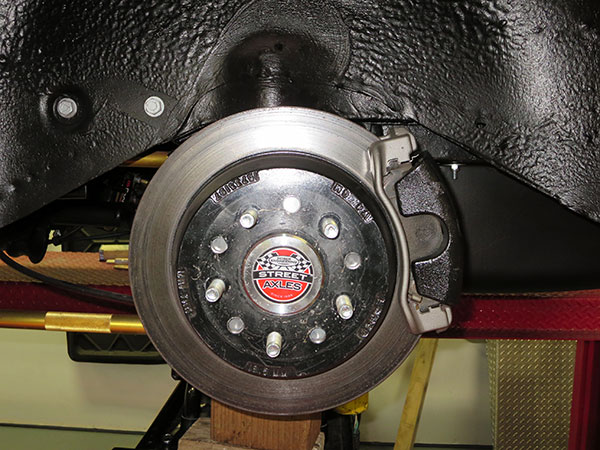

GM rear disc brakes, with parking brake drums inside the rotors.
Moser Engineering Street Axles.

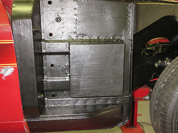

Moser Engineering Street Axles. Note also: the underside of the car and the complete
interior and trunk were coated with bedliner.

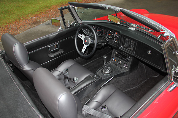

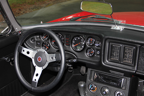

MGB interior trim, in classic all-black color scheme.
Speedhut gauges, including a GPS speedometer.
Carpet was purchased in bulk, then cut to size. Jim's wife sewed edging on it.
Sunvisors.
Sunvisors.

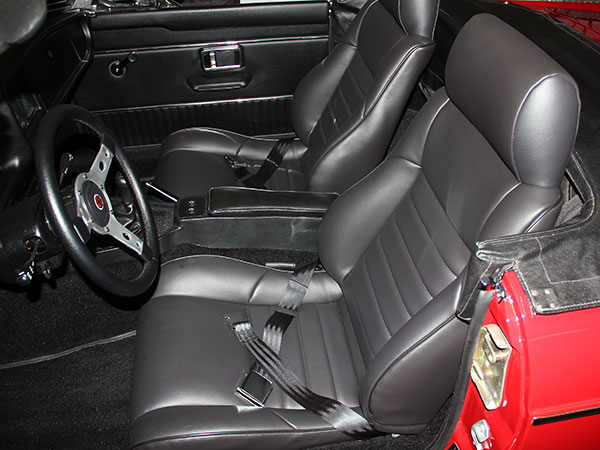

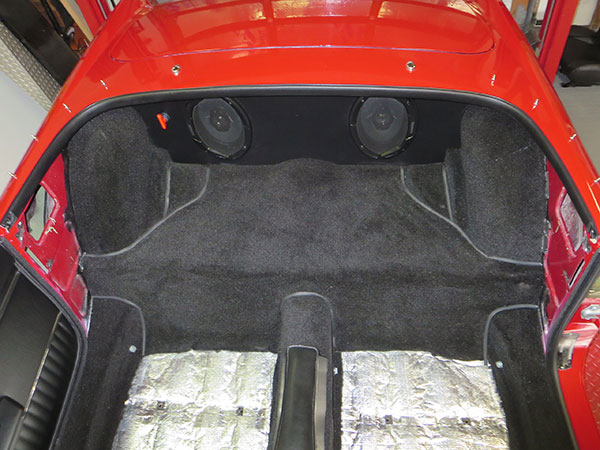

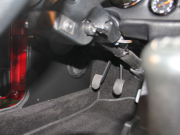

Footwell mounted speakers.
Metal speaker enclosures were built between the front fenders and kick panels.
Metal speaker enclosures were built between the front fenders and kick panels and
welded in place to weatherproof the front speakers and increase bass response.

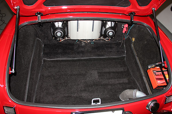

Kenwood 6x9 speakers and model KAC-744 amplifier.
Odyssey lightweight battery.

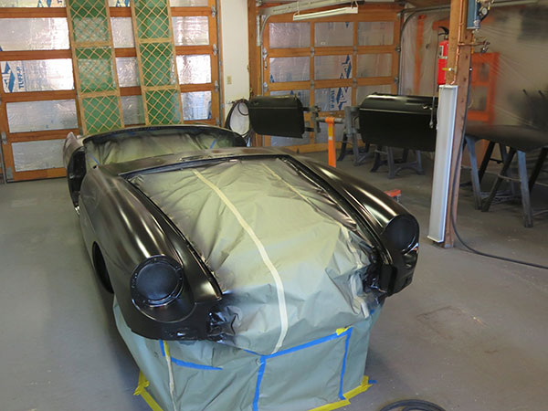

Bodywork

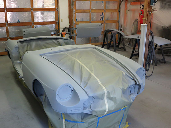

Stripped.
Stripped.
Primer.
Primer.
Sealer.
Sealer.

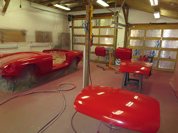

Base coat.
Base coat.
Clear coat. (Still needs cut and buff.)

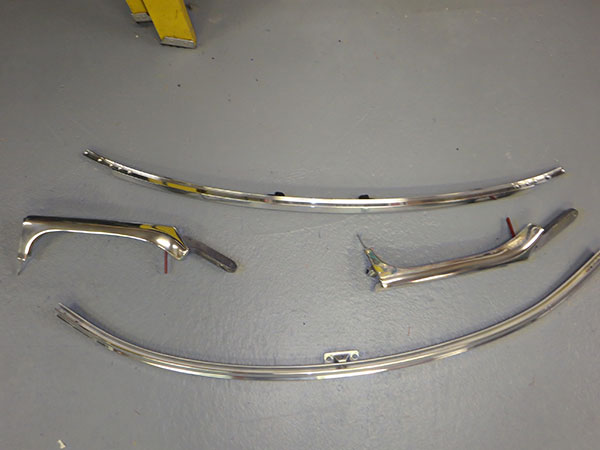

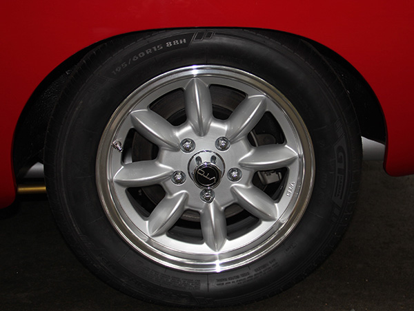

1973-1974.5 MGB grille (with black insert) and apron (with two oil cooler holes.)

Rear bumper fillers were fabricated, welded in place and painted body color.
Later model MGB (rubber bumper style) license plate lamps.
This MGB has been converted to chromed steel bumpers, but without bumper overriders.
It retains later model (rubber bumper style) license plate lamps.
