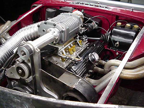

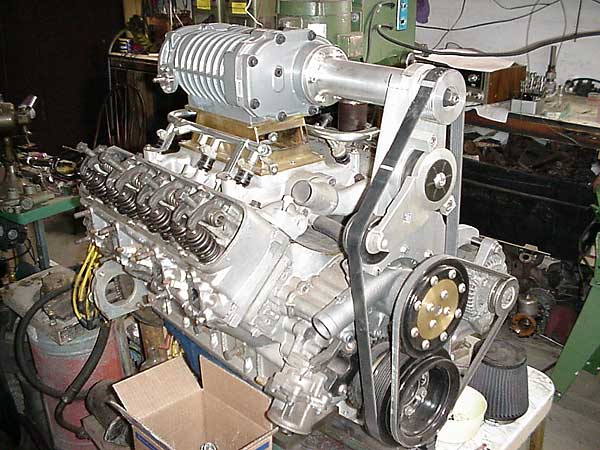

Current EFI (Enderle-style intake & MegaSquirt controls)
Oldsmobile 215 valve cover
K&N filter for crankcase vent

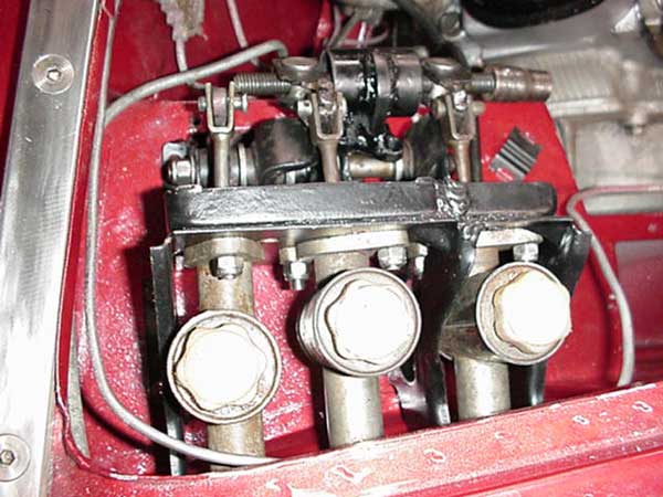

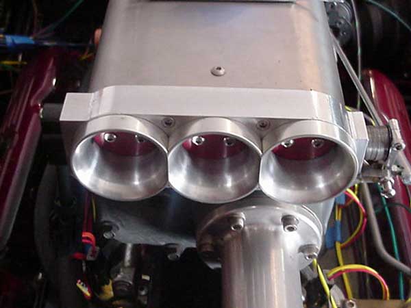

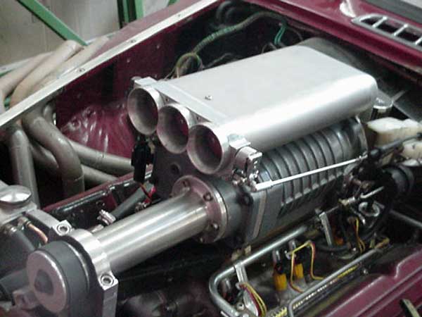

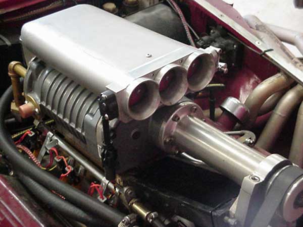

custom triple throttle body

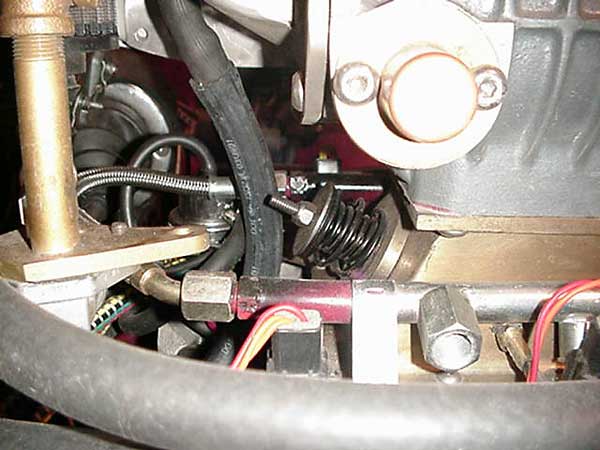

throttle linkage
throttle linkage
throttle position sensor

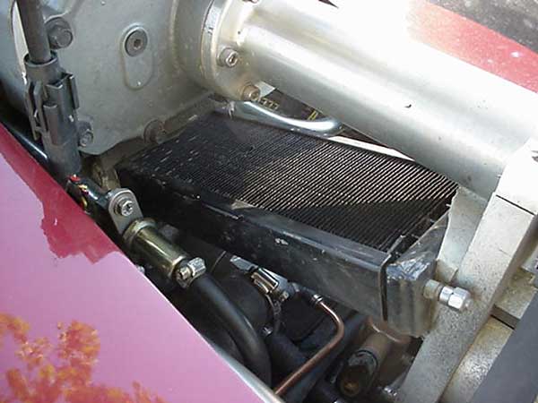

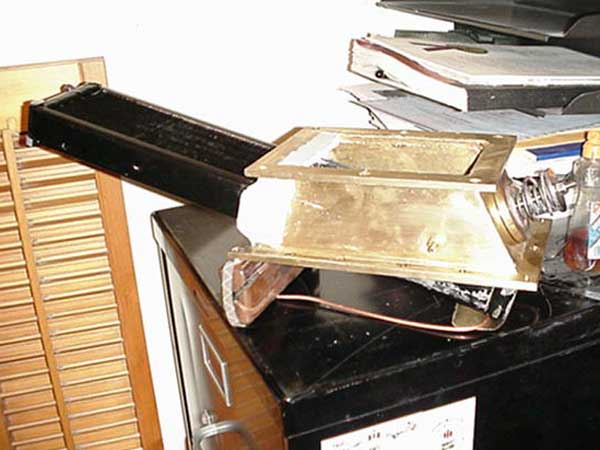

ethanol vapor intercooler

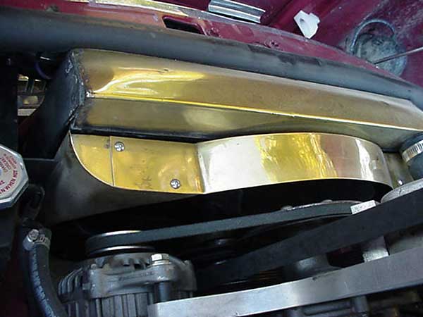

home-made plenum
home-made plenum (fabricated in brass)
sneeze valve
sneeze valve

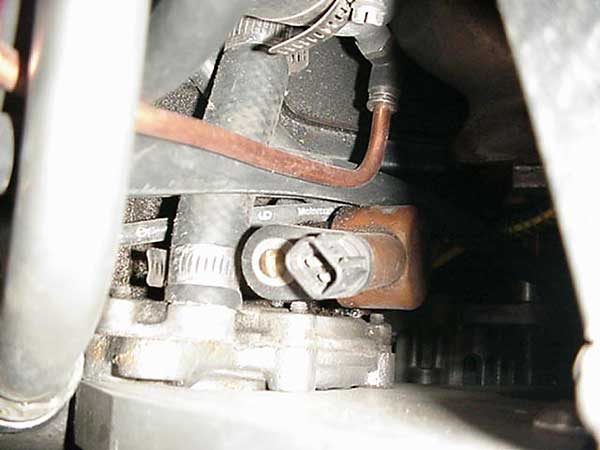

cam position sensor
cam position sensor
custom radiator and fan shroud

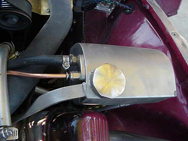

surge tank
surge tank

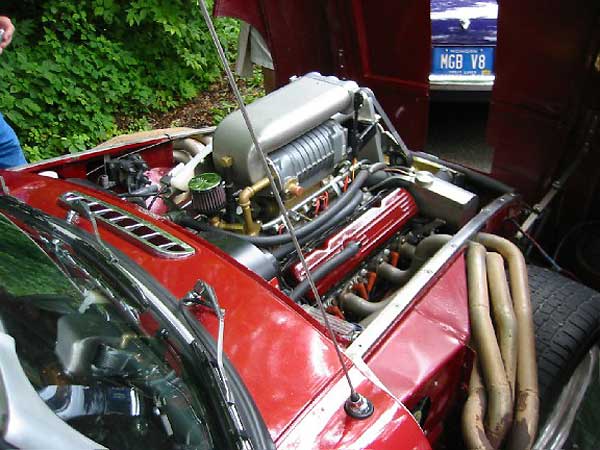

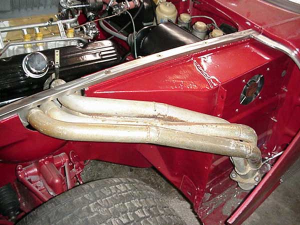

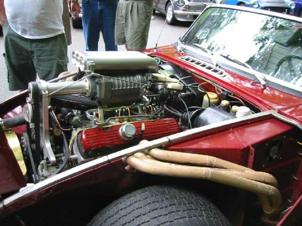

custom headers and fender vent fan

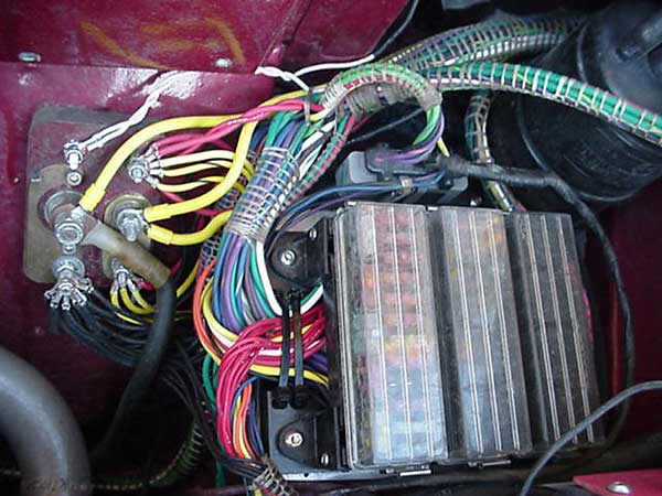

wiring, relays, and circuit protection

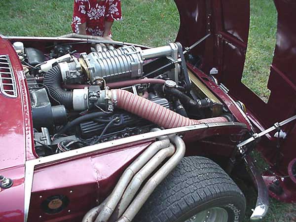

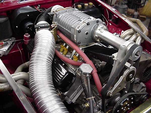

Eaton M90 (Generation 4) Supercharger

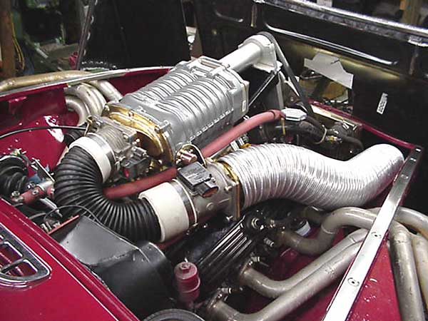

Previous EFI (Mass-Air, Ford EEC-IV SEFI / TwEEcer controls)
fog lights and modified ST spoiler
cold air intake ductwork
throttle body and mass air flow (MAF) sensor
mass flow sensor
Rover fuel rail

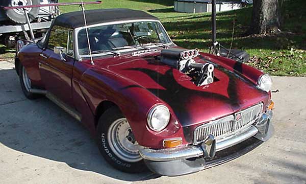

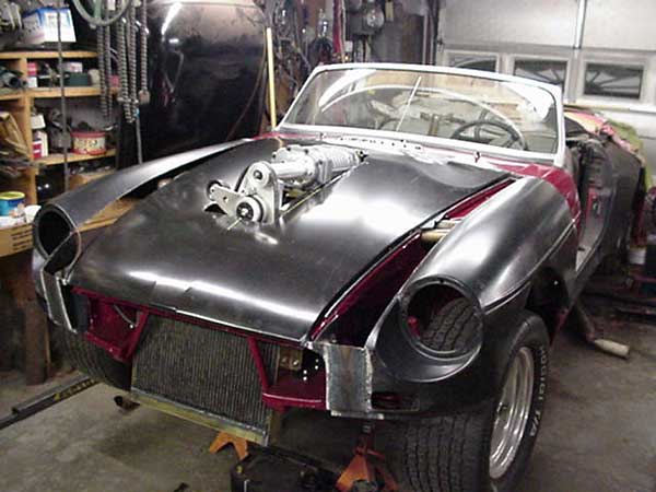

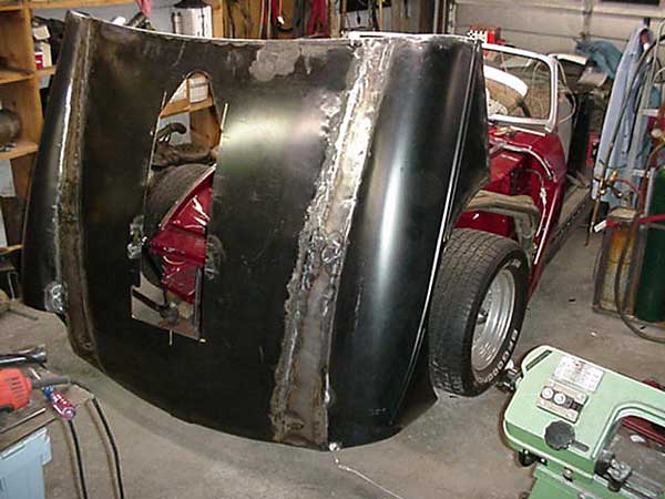

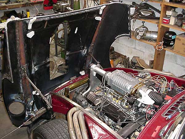

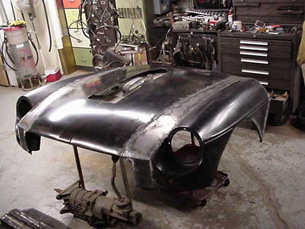

Hood

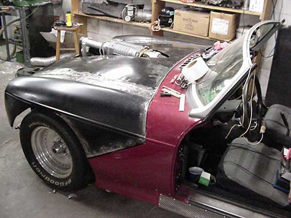

hood welding
supercharger thru hood
forward tilt hood
fitting of hood

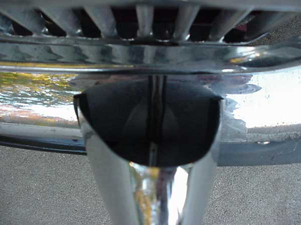

bumper splice hidden under over-rider
double hinge

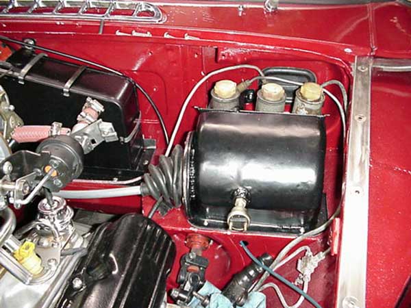

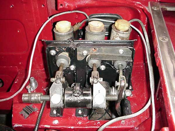

Brakes
mechanically adjustable brake bias mechanism
pedal hangs between master cylinders, pivoting on a spherical bearing on a threaded rod
pedal hangs between master cylinders, pivoting on a spherical bearing on a threaded rod...
side-to-side location of the pivot point determines relative piston travel and thus brake bias
side-to-side location of the pivot point determines relative piston travel and thus brake bias.
brake bias adjustment knob
the large wooden knob is for brake bias adjustment

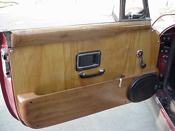

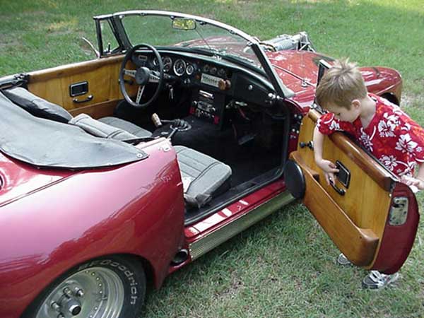

handcrafted wooden door trim

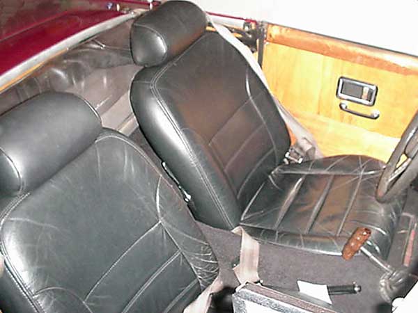

Mercury Marauder seats
leather Mercury Marauder seats (seat-backs grafted to MGB bases and swapped-out lower cushions)
MGB door panel and map pocket

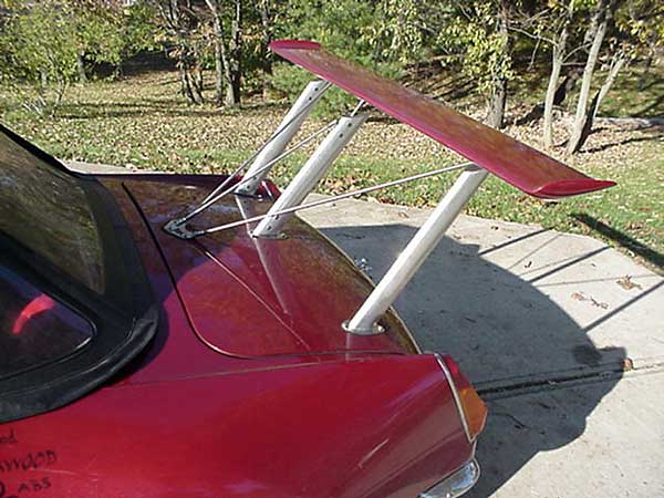

Wing
Oldmobile 442 wing
Oldsmobile 442 wing produces down-force for cornering
trim linkage (to reduce drag at speed)
trim linkage automatically reduces aerodynamic drag at speed
(please also notice the back-up light and space-saver spare tire)

Engine: 1963 Olds 215 from an F-85. Extensively modified with Olds factory turbocharger.

Exhaust: owner fabricated 8 into 4 into 1 heavy wall turbo headers. No muffler or catalytic converter. 2" exhaust.
Brakes: 1975 Mach 1 Mustang ventilated rotors and calipers on front, stock drums on rear. Dual master brake cylinders with balance bar, adjustable from dash.

Recommendations: I like the close-ratio Warner T-50 transmission. Use a hydraulic throw-out bearing set-up. Learn to gas weld and make your own headers - it's not that hard. I had 80 hours in a set of equal length (within 1/8") over-the-tire fenderwell headers dumping into glass-packs inside the rocker panels. That's about a months worth of spare time. Also, it's possible to use the stock starter by rotating the nose and an aluminum starter nose does exist. Some welding, grinding, and drilling required. Geo Metro alternator is small, works well, and is easily mounted.
