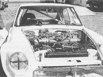

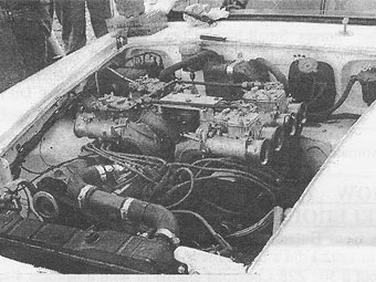

I have owned the car for 9 years. One of approximately 2,500 factory MG's based on the Rover motor. I still have all the original parts, engine, trans., rear axle, etc. Twelve rears ago I built the car to run in the MG BCV8 Championship in England. I first stripped it down to a bare shell, replacing the inner and outer sills and installing a 6-point cage. The car now has a motor by John Eals in England with 4 side draught 48 Webers and a cross-bolted block.

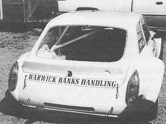

When I moved to the U.S. 6 years ago, I loaned the car to Warwick Banks, a well known racer who sorted the car. Warwick seam-welded the tub and put in a Ford T-5 transmission, had special exhaust made which come out through the inner wings and performed a lot of suspension modifications. Warwick won many races in the car and set track records for MG at several racing tracks. In 1999, he set fastest lap of the day at Silverstone race track. Not bad for a 60 year old driver!

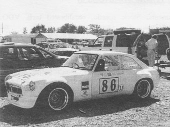

A similar car at Zolder was clocked by speed trap at 184 mph. My car is an easy 160 mph at most tracks. Best rev range is 4,400 to 5,600 rpm but will go to 7,000 easy. At its first race in the U.S., Warwick won the 1999 Collier Cup championship race at Watkins Glen.

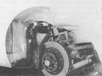

Brakes: Wilwood 4-pot calipers and 11" vented discs on the front, stock MG drums on the rear.
Tires/Wheels: Compomotive 3 piece (16x10 on the front, 16x11 on the rear. Wheels for racing in the wet are Revolution 15x10.
Suspension: telescopic shocks front and rear. (Not an off-the-shelf kit!) Lower "A" arms modified to give required camber each side. 1" sway bar on the front. Nylatron bushings on all mounting points. Lots of strengthening.

Body: MG Sebring wings. Rear wings extended. Fiberglass wings, door, bonnet and tailgate. (What are the rear lights? London taxi!!!) Front spoiler is extended factory styIe.
Conversion by:   original modification done by me, then the car was sorted out by Warwick. 5-speed trans, exhaust through the wings, seam welded front to back, twin fuel pumps and lightened. Car weighs around 1,850 lbs.
Advice: if I were to do it again, I would use down draught carbs instead of side-draft. The side-drafts give great torque but not such good horsepower. (They're great for standing starts.) This car pretty much has it all! Also, get lots of advice from the people that know . Buy a second hand, ready to go car, which is much cheaper.

Being prepared to dust a few more Corvettes.   Massive vented disc barkes and custom exhaust.
Being prepared to dust a few more Corvettes.    /    Massive vented disc brakes and custom exhaust.
Jerry Richards' MG looks fast from any angle.
