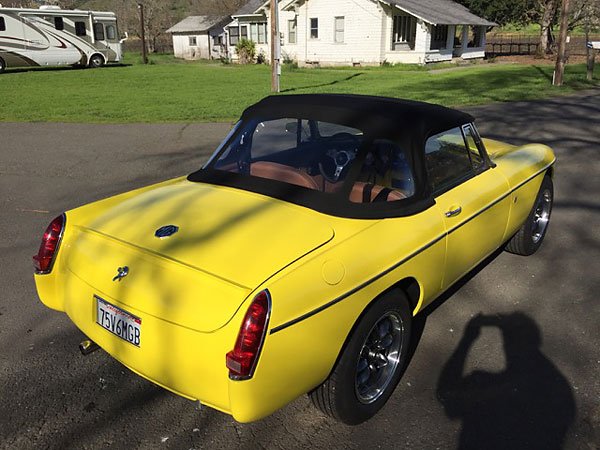

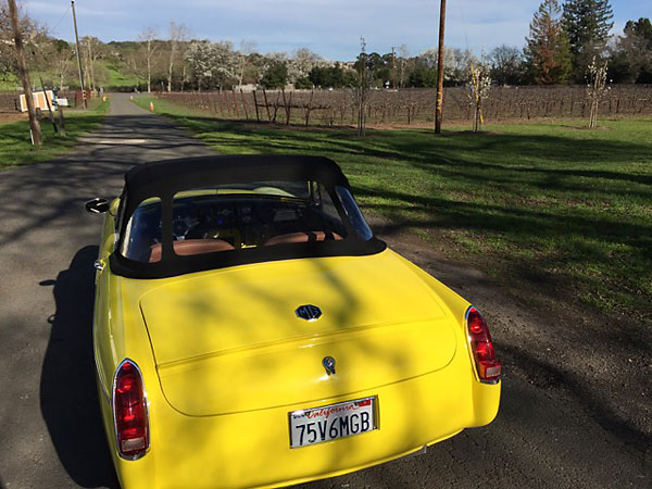

Jerry LeMasters' 1975 MGB with Chevrolet Camaro 3.4L V6

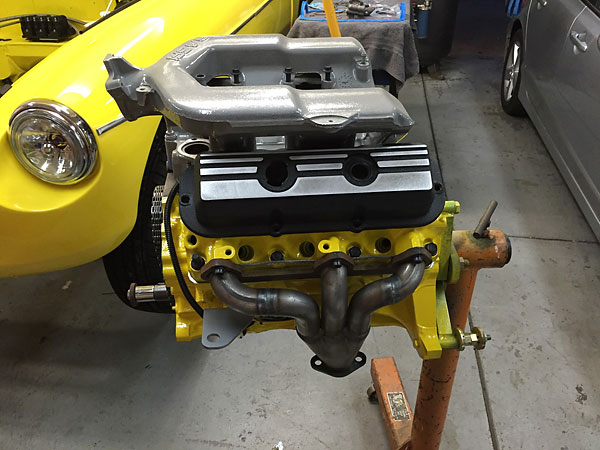

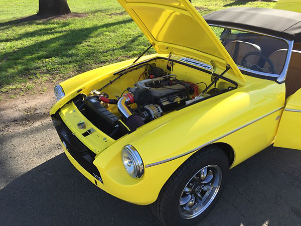

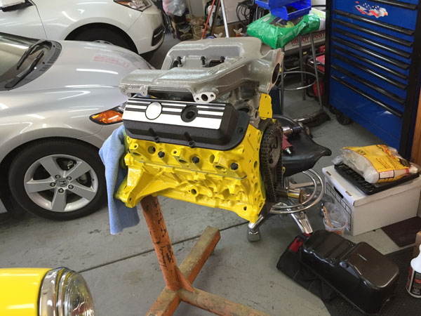

Engine: 1995 Chevrolet Camaro 3.4L V6. Stock GM camshaft. Stock electronic fuel injection. BMC engine controls. CCE pulley system. CCE engine mount system. Pontiac Fiero valve covers. Aluminum fuel tank.
Cooling: stock MGB radiator. Electrical fan control through PCM.
Exhaust: CCE headers. Custom exhaust pipes. Magnaflow Y-connector and resonator. Dynomax muffler.

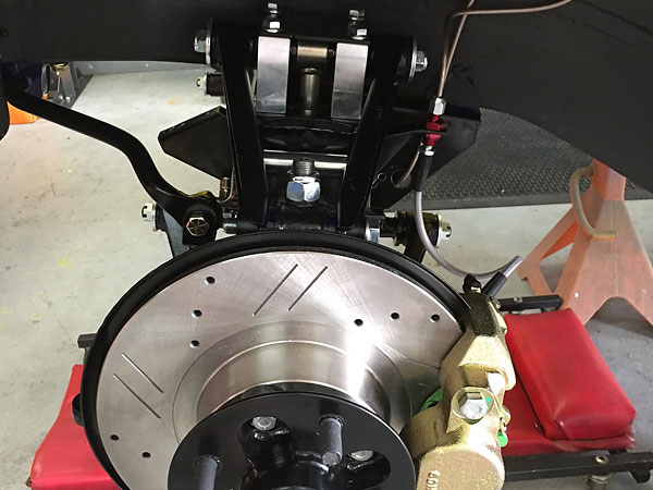

Front Susp.: Moss coil-over conversion. New (Moss) MGB steering rack.
Rear Susp.: telescoping shock absorber conversion. Stock MGB leaf springs.
Brakes: stock brakes. Slotted front rotors. EBC brake pads.

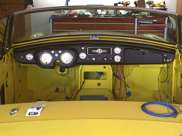

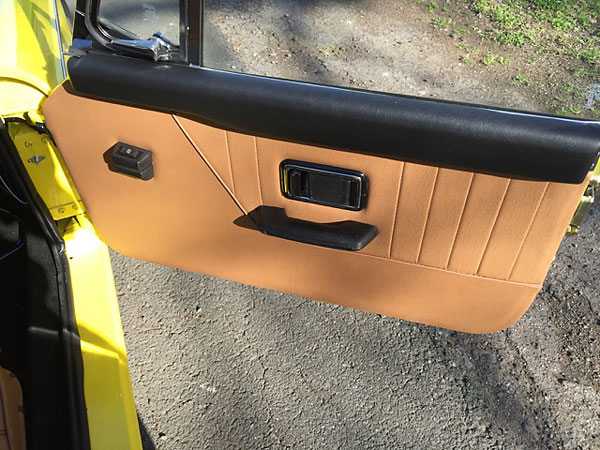

Interior: MGB Mk1 (steel) dashboard conversion. Moss leather seat upholstery. Moss vintage style seatbelts. Removed headrests. 1977-80 style door cards.
Electrical: Advance Auto-Wire wire harness. Digital Guard Dawg keyless ignition. Interstate battery. GM CS130 alternator. Bluetooth audio. HALO Headlights. LED front turn signals. Modified 1967 taillamps, featuring specially built-in back up lights.
Instruments: Autometer Custom Shop gauges with yellow rimmed white faces and blue illumination.

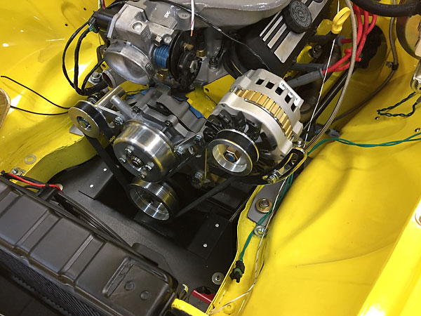

GM CS130 alternator. CCE pulley system.

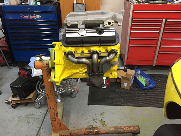

CCE headers.
CCE headers.
Timing chain and gears.

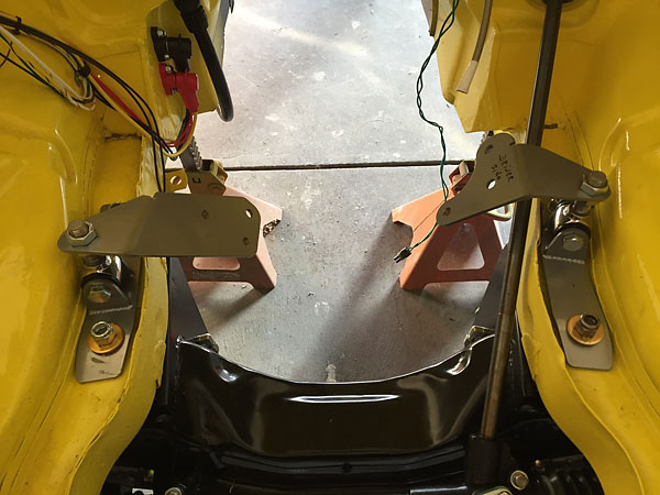

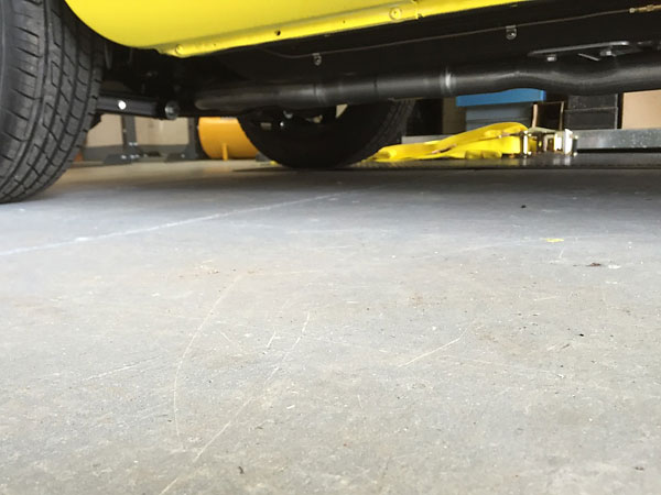

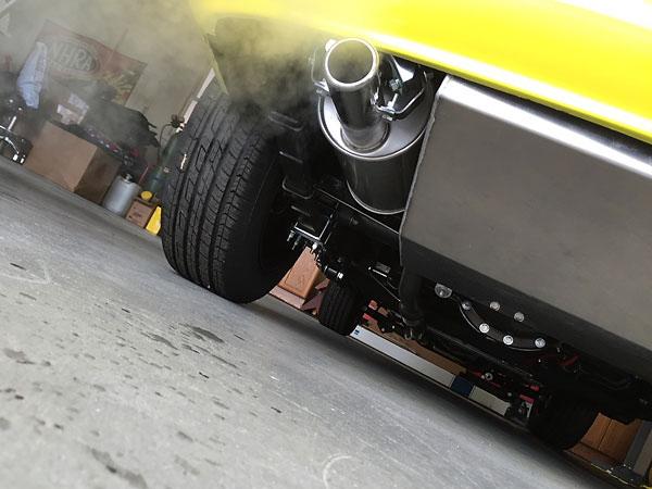

Custom exhaust pipes by ABC Muffler of Benicia, California.
Magnaflow Y-connector and resonator. Dynomax muffler. Aluminum fuel tank.
Suspension and Brakes
Moss coil-over conversion. Slotted rotors.

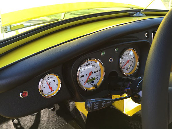

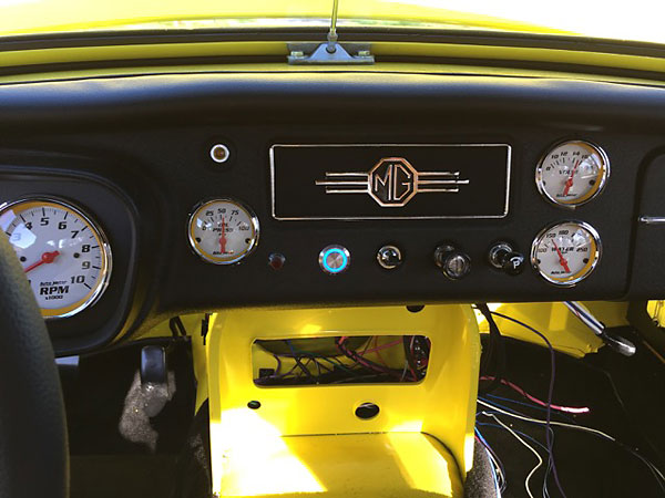

Autometer Custom Shop gauges.
These gauges feature yellow rimmed white faces and blue illumination.

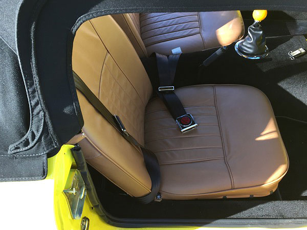

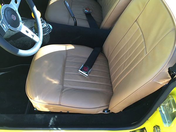

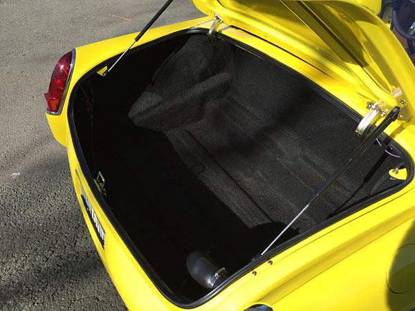

Gas springs.
Gas springs.

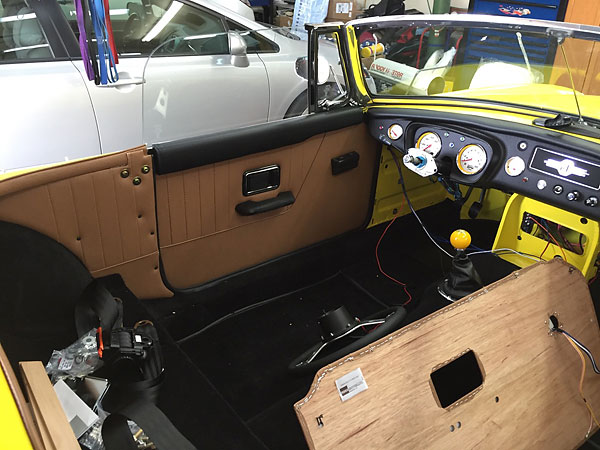

MGB Mk1 (steel) dashboard conversion. Two extra gauges added by the glovebox.

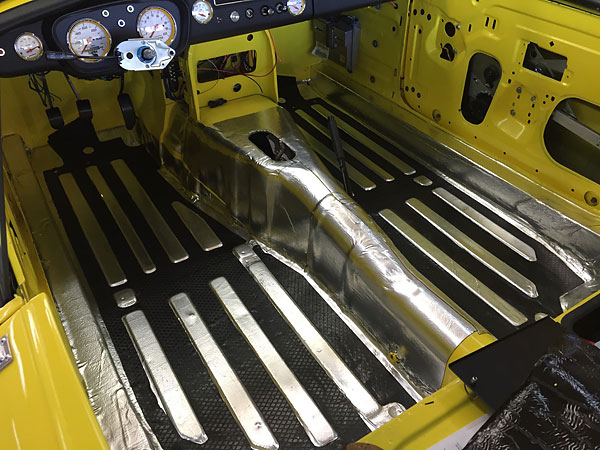

Sound deadening mastic.
Plastic vapor barrier.

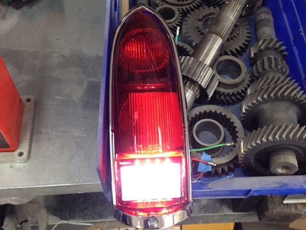

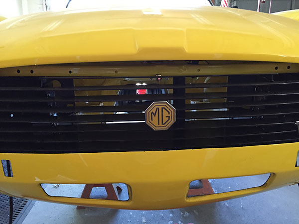

Customized grille-mounted MG insignia.

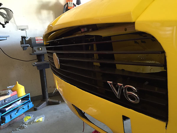

Custom fabricated grille.

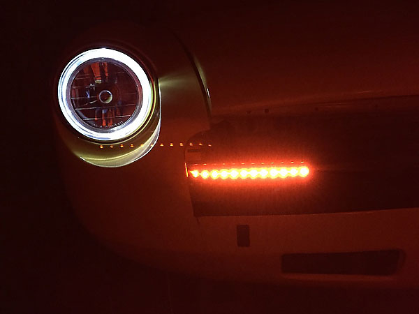

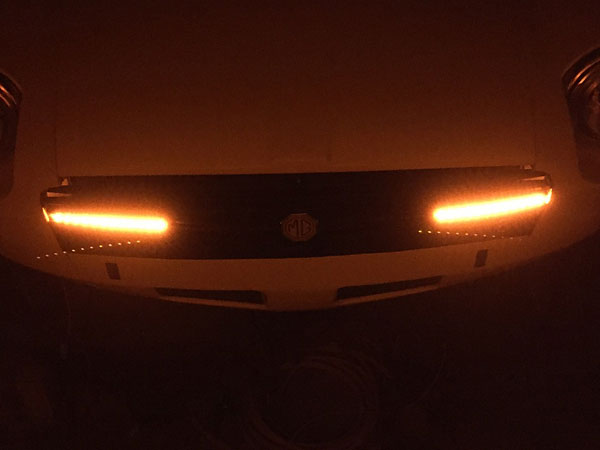

HALO Headlights.
HALO Headlights.

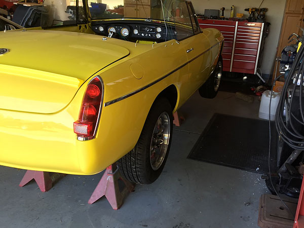

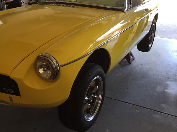

Nice, straight side molding.

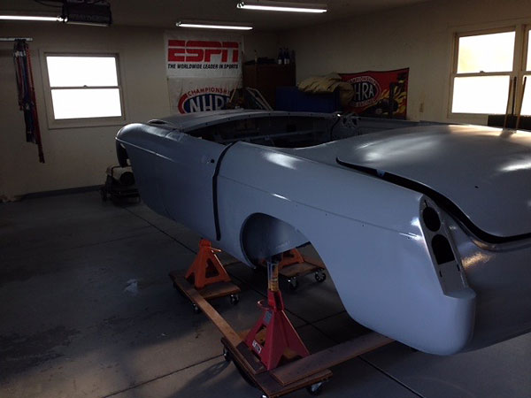

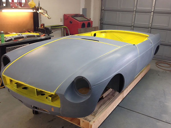

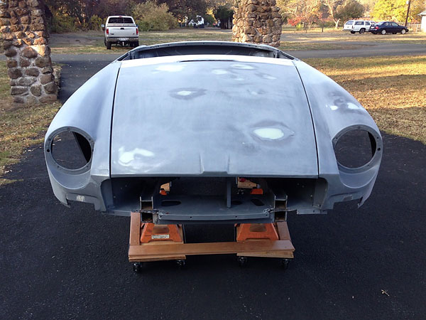

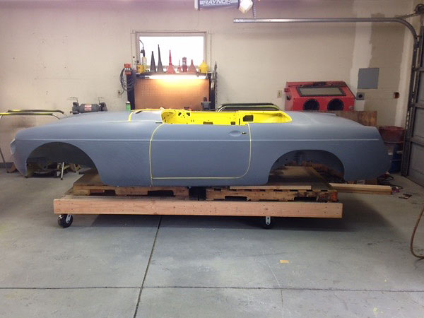

All exterior body surfaces get painted together to help ensure even finish application.

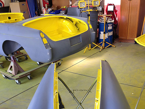

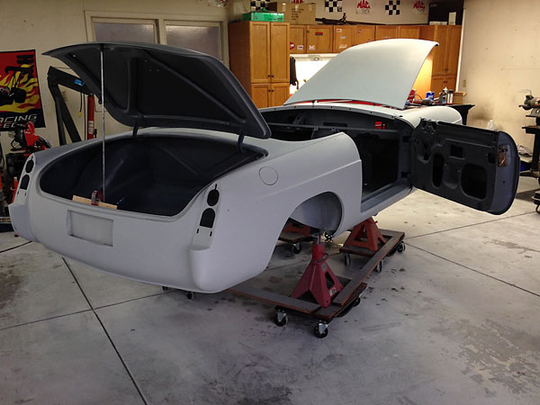

Door jams and inside surfaces of the doors were painted before their reinstallation.
The engine-side of the bonnet was painted before its reinstallation.
Inside surfaces of the front fenders were painted before their reinstallation.

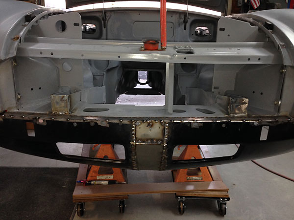

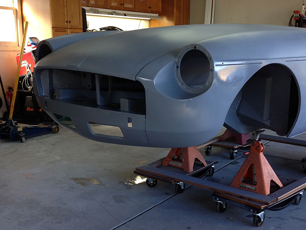

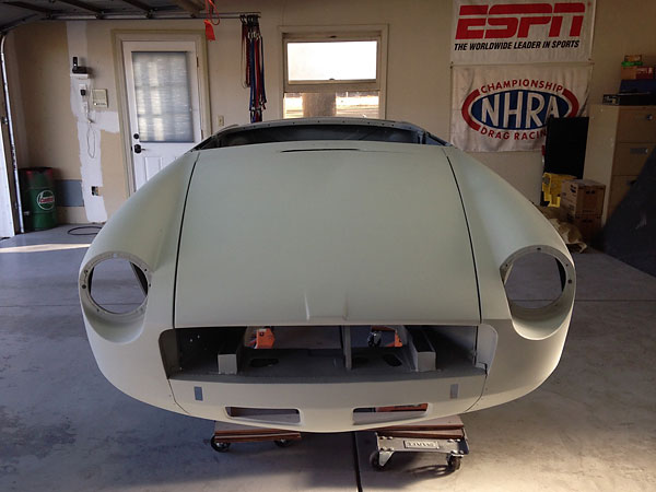

Before beginning to fabricate his custom front valance, Jerry fit bonnet and fenders just right.

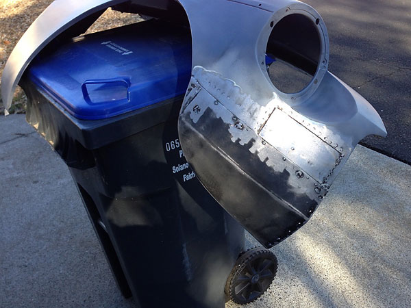

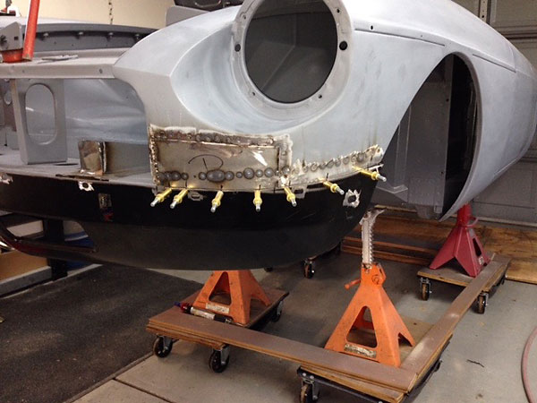

Late MGB (1973-1974.5) front valance, sectioned and widened.
Jerry sourced a late MGB (1973-1974.5) front valance, but sectioned and widened it to fit
on the plane of the front fenders instead recessed (as MG used it, under chrome bumpers.)
Filled-in turn signal holes. Cleco Fasteners are handy clamps for trial installations.
A center/filler panel has been spliced-in.
The ends of the valance have been cut off, and then grafted onto the front fenders.
Modeling the completed, totally custom, and unique front valance.

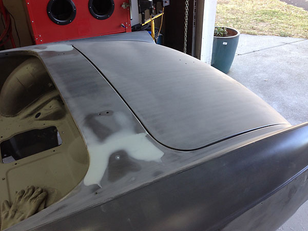

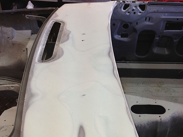

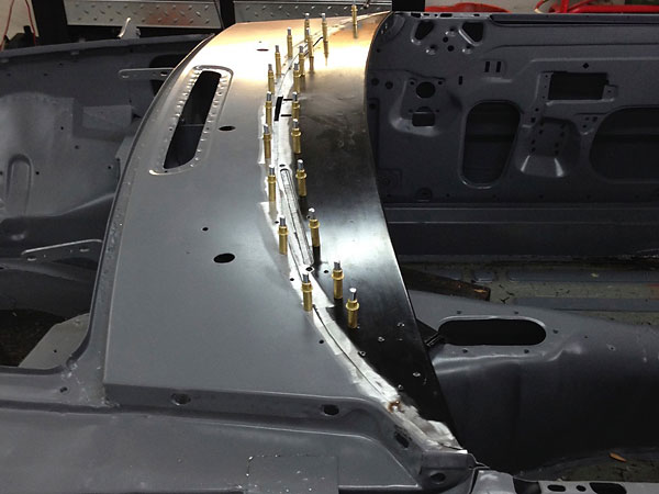

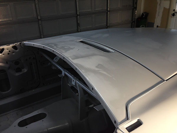

Relocating the cowl rearward to suit the early-model MGB steed dashboard.
Smoothed and refined cowl, ready for primer.
Primed.
Primed.

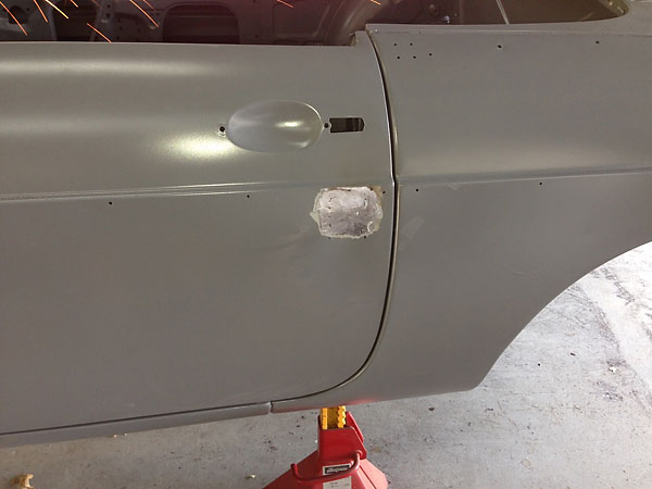

Shaved exterior door locks.

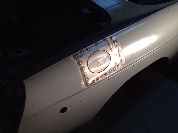

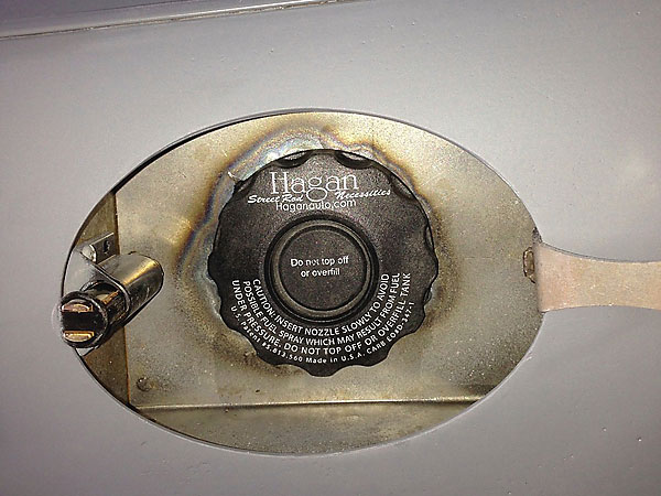

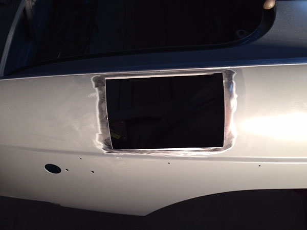

Preparation for installing a fuel door.
Hagen 90 Series oval curved fuel door.
Hagen fill through gas cap.
Hagen recessed/lidded fuel filler.

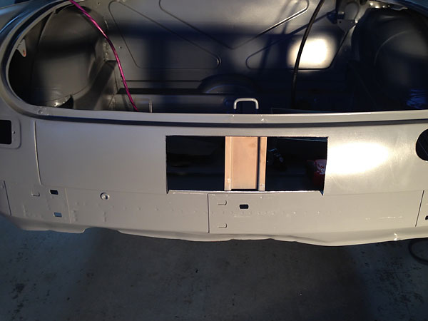

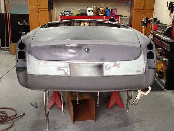

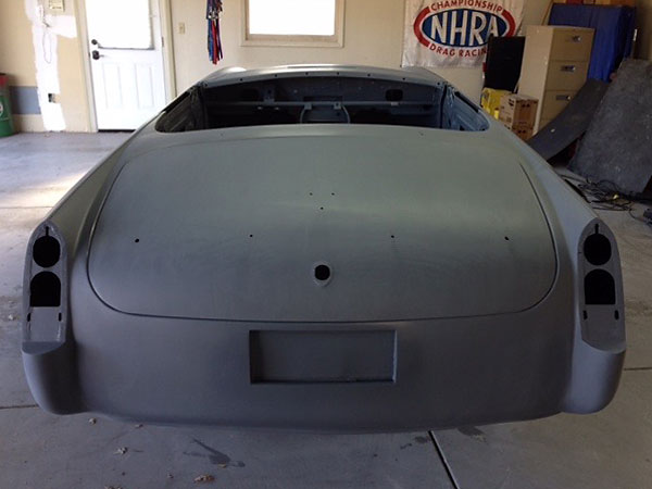

Preparation for installing a license plate pocket.

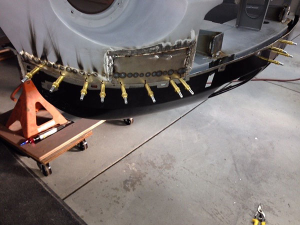

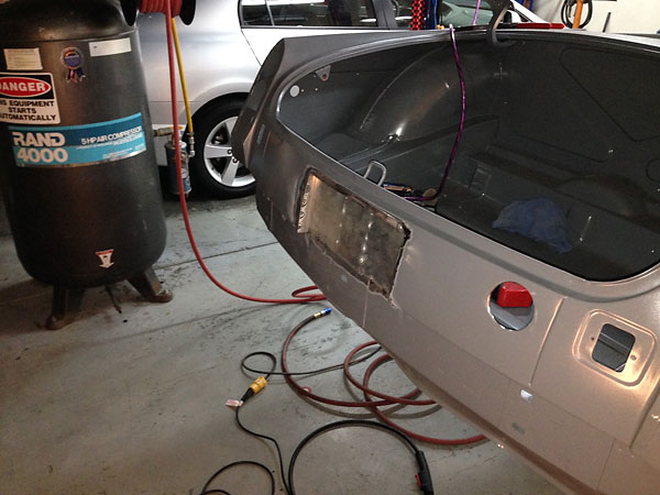

Welding in the license plate pocket.

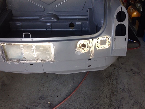

Blanking the old fuel filler hole and back-up light holes.

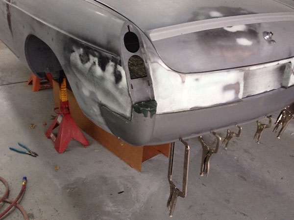

Installing Preform Resources' fiberglass rear valance.
Molded-in LED license plate lights.

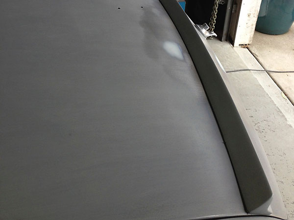

Custom made boot lid mounted spoiler.

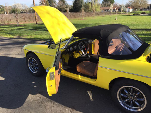

Rota RB 15X7 wheels, in Royal Gun Metal finish with polished rims.
