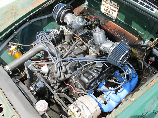

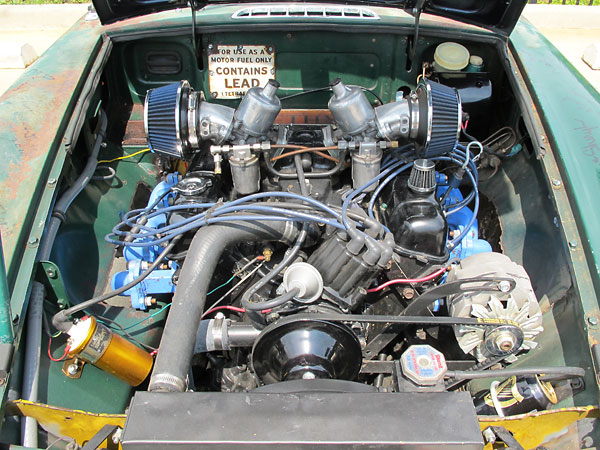

Engine: Rover 3.9L engine. Rover 3500 intake manifold and dual S.U. HS carburetors. Spectre gauze air filters. Buick 215 timing cover and water pump. Buick (Delco-Remy) distributor with Pertronix Ignitor module. Lucas Sport gold ignition coil. Buick 215 stamped steel valve covers.
Cooling: custom copper/brass radiator. Guinness beer can for radiator overflow.
Exhaust: custom exhaust port extensions. Rover 3500 cast iron exhaust manifolds. Dual glass pack mufflers.

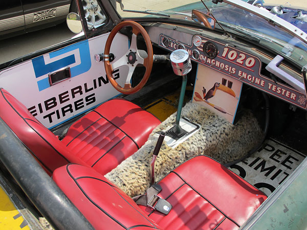

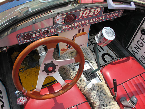

Interior Mods: highly customized. (See photos.) High-grade leopard skin patterned synthetic shag carpeting covering the transmission tunnel. Door panels from road signs, some with original bullet holes. (The windows are in place and will crank up and down.)

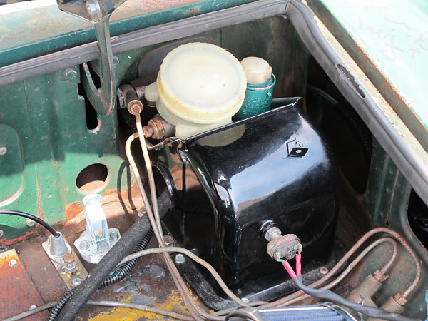

The heater box was removed and high-quality signage was used to cover firewall openings.

The brake system is entirely stock; MGBs came with excellent brakes as standard equipment.
Intake manifold and S.U. carburetors are from a late sixties Rover 3500.
This intake manifold and dual S.U. carburetor arrangement is from a late 1960s Rover 3500.

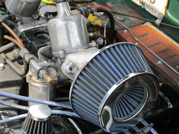

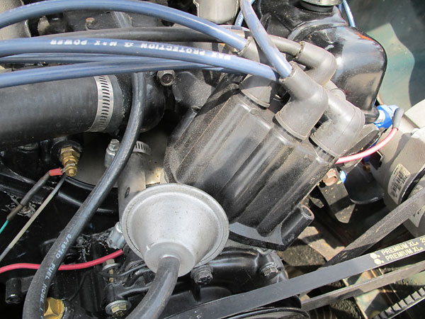

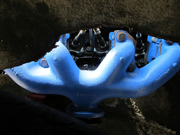

Rover 3500 cast iron exhaust manifolds. (Note DARCAST casting mark.)
Rover 3500 cast iron exhaust manifolds. (Note "DARCAST" casting mark.)

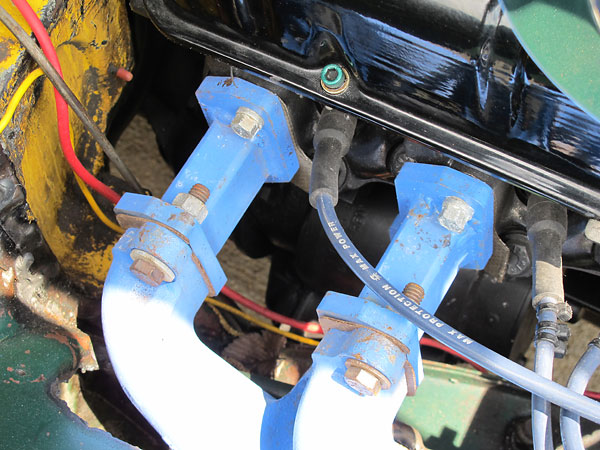

Fabricated exhaust port extensions.
The manifolds wouldn't fit inside the frame rails, so exhaust port extensions were fabricated to
space them outboard. The exhaust port shape was modeled in CAD and 3/8" flanges were CNC
laser-cut to suit. Box tubing similar to the profile of the ports was welded in between the
flanges. Two sets of exhaust gaskets and high temperature exhaust paint completed the job.

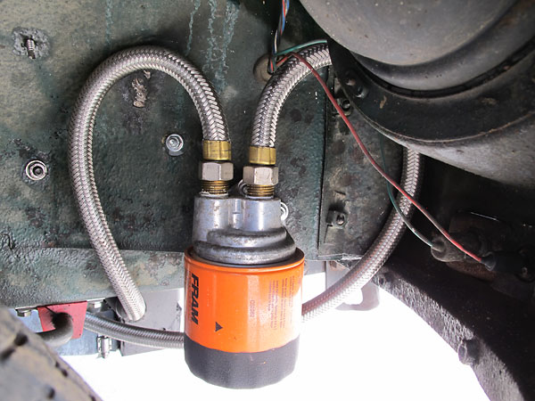

Remote oil filter mount.

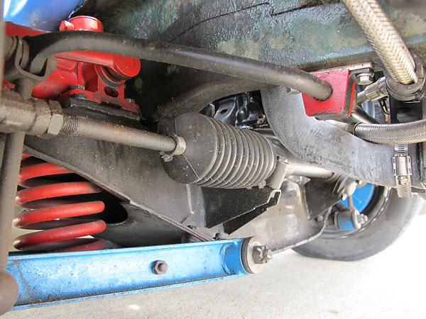

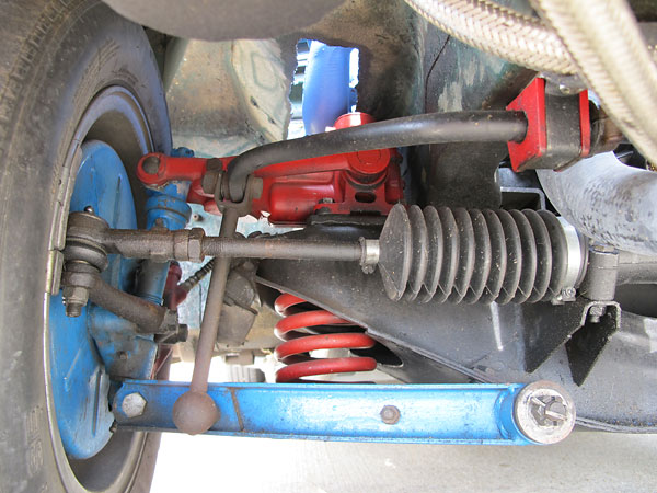

Suspension
Persistent bad idea.
A later model "rubber-bumper" MGB front crossmember has been installed in lieu
of the original 1965 crossmember. The rationale for this is that it lifts the
body to provide clearance between the steering shaft and the exhaust manifold.
Stock MGB suspension parts were painted to accentuate the different components.

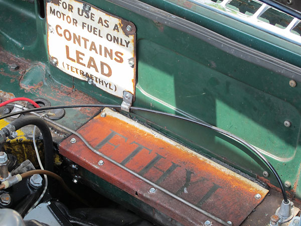

Floors were rusted through, so high-quality signage was used for the repairs.

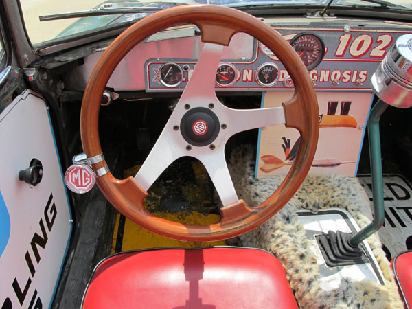

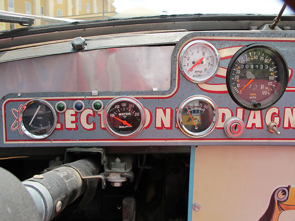

VDO electronic speedometer (0-120mph).
Smiths fuel gauge, AutoMeter coolant temperature gauge (100-250F) and tachometer (0-8000rpm),
MW oil pressure gauge (0-100psi), and VDO electronic speedometer (0-120mph).

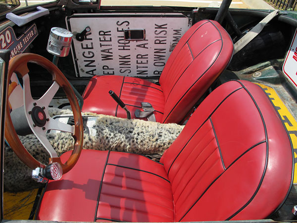

Earlier model MGB seats.
1964 Mercury Comet steering shaft.
The shifter lever was originally a 1964 Mercury Comet steering shaft,
but it was custom bent and shortened to fit the MGB perfectly.

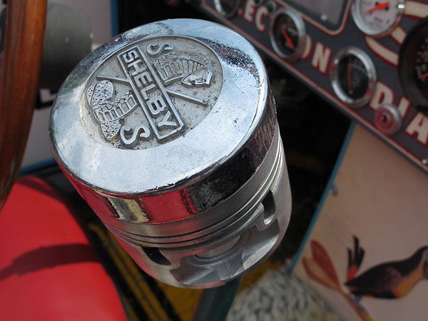

The shifter knob is a piston from an MGB 1800cc 4 cylinder.
The shifter knob is a piston from an MGB 1800cc 4 cylinder with a Shelby Cobra (Mustang) hub cap
that happened to be the same diameter as the piston. A custom aluminium gudgeon pin was turned
to the appropriate diameter, then drilled and tapped to match the top of the shifter.

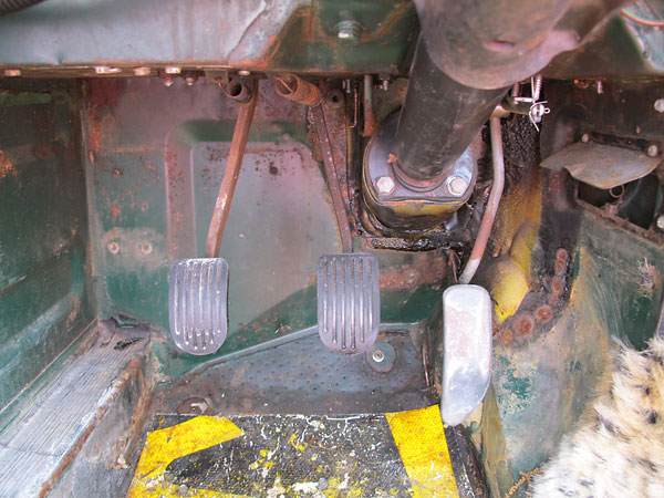

Lots of foot room.
Lots of foot room.

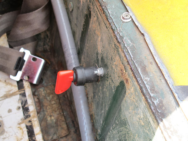

Battery disconnect switch within convenient reach of the driver even when he's seated.

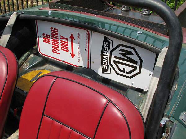

MG Parking Only: all others will be towed.
"MG Parking Only: all others will be towed." and "MG Service" signs.

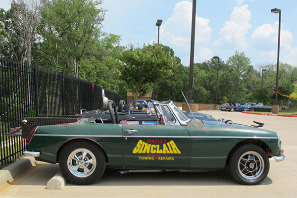

Finzio's Sinclair - Passaic, NJ - Towing & Repairs
"Finzio's Sinclair - Passaic, NJ - Towing & Repairs" - Author Burt Levy
and his character Buddy Palumbo inspired various aspects of this car.

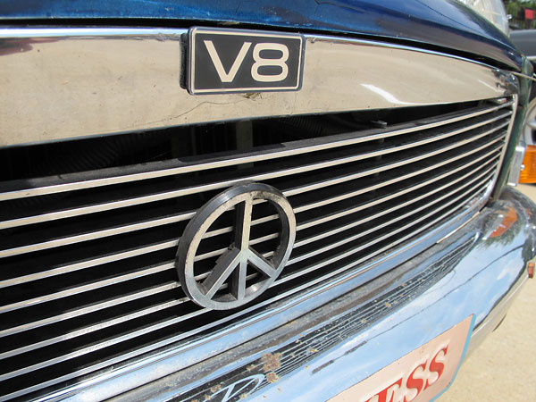

Billet grille is from a late model Ford truck, cut to fit.
Peace, brother!
Peace, brother!

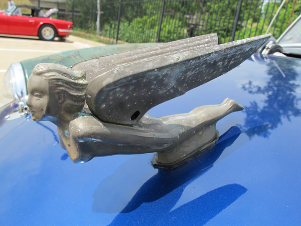

Hood ornament sourced from eBay; unknown age/car.

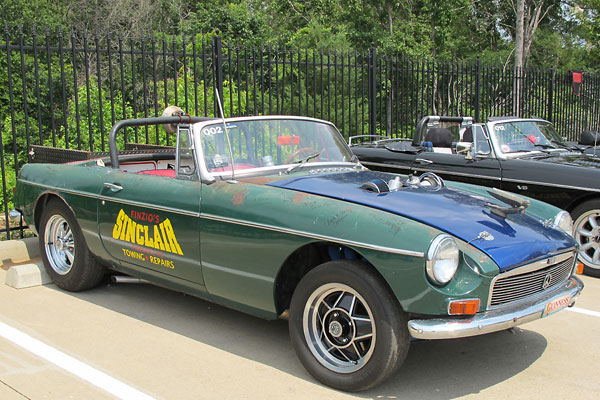

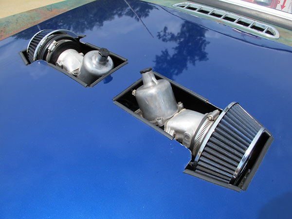

Bonnet modifications to provide carburetor and air filter clearance.

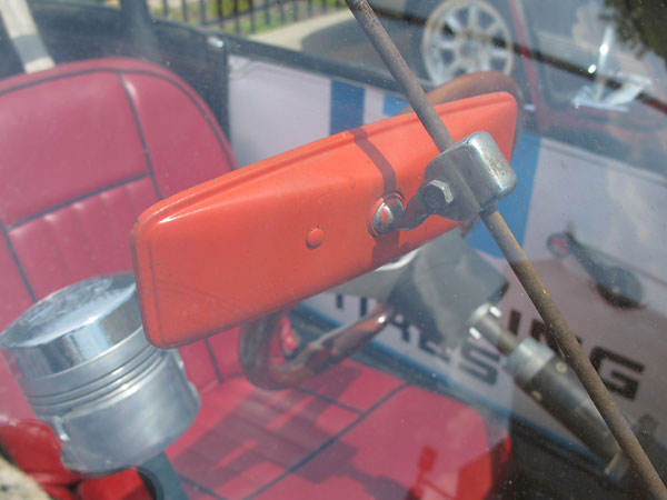

Rear view mirror.
Rear view mirror.

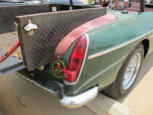

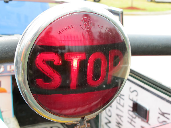

Fully functional third brake light from a 1930s farm truck.

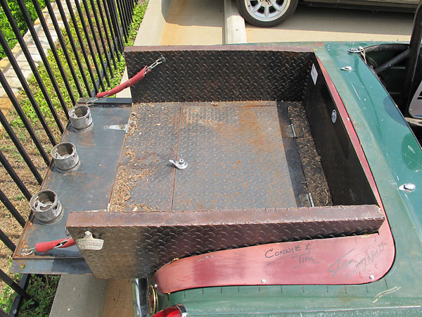

Small pickup truck bed made from steel diamond plate.

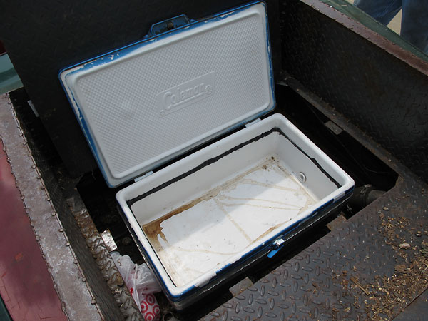

The pickup truck bed features a built-in drink cooler!

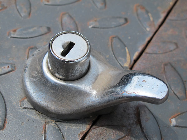

The drink cooler has a lock, and it's keyed to match the MGB's doors.

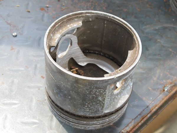

MGB cup-holders.
Cup-holders are so important these days. This car has three cup-holders, all fashioned
from Buick 215 pistons and positioned for use during tailgate parties.
Bürgermeister Beer bottle opener.

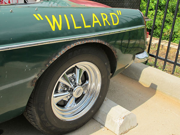

Willard was a social misfit with an affinity for rats.
The car's name - "Willard" - comes from a movie of the same name.

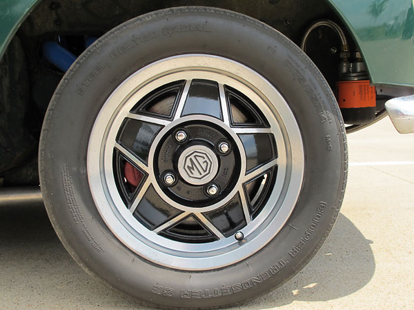

These MGB LE wheels have been powder-coated black and silver.
These MGB LE wheels have been powder-coated black and silver, with clear powder coating
overtop the base colors. Something on the car had to look nice and shiny...

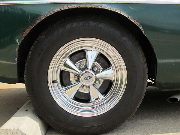

These Cragar S/S 14 inch 5-lug wheels had previously been installed on a 1966 Mustang GT.
These Cragar S/S 14" 5-lug wheels had previously been installed on a 1966 Mustang GT.
