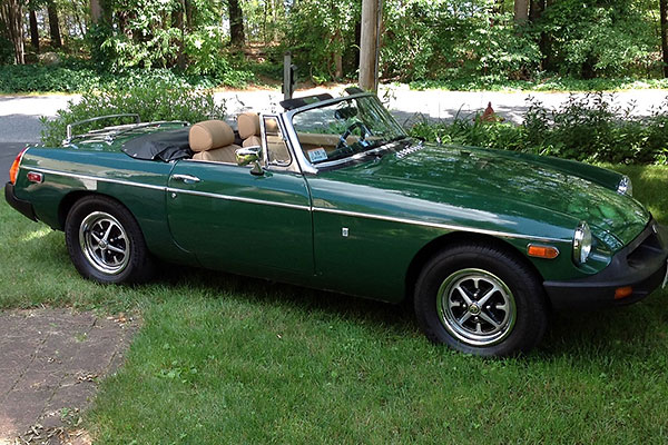

Jeff Neal's 1975 MGB with Rover 3.5L V8 Engine, from a Triumph TR8
Owner: Jeff Neal
City: Boston, Mass.
Model: 1975 MG MGB
Engine: Rover 3.5L V8
Conversion by: father (Roger) and son
How It Was Done

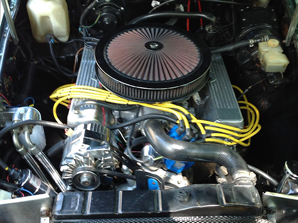

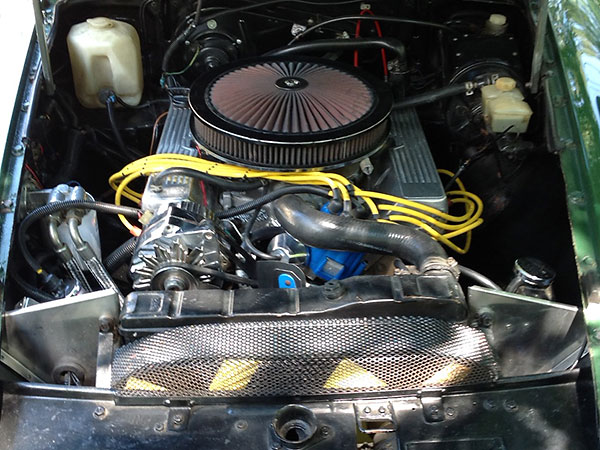

Engine: Rover 3.5L V8 from a Triumph TR-8. Crane 260 H hydraulic camshaft. Buick 4-barrel intake manifold. Edelbrock 500cfm carburetor. K&N air cleaner and filter. Buick (Delco-Remy) distributor, upgraded with Pertronix Ignitor breakerless ignition module. Pertronix ignition coil. Remotely mounted oil filter.
Cooling: MGB GT V8 style copper/brass radiator. Engine driven Flexolite fan. Two stock MGB (auxiliary) thermostatically-controlled electric fans.

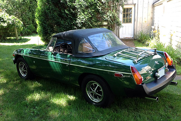

Exhaust: custom. Dual glasspack style mufflers. Dual chrome exhaust tips.

Wheels/Tires: stock Rostyle 14" steel wheels, with trim rings. Radial tires.

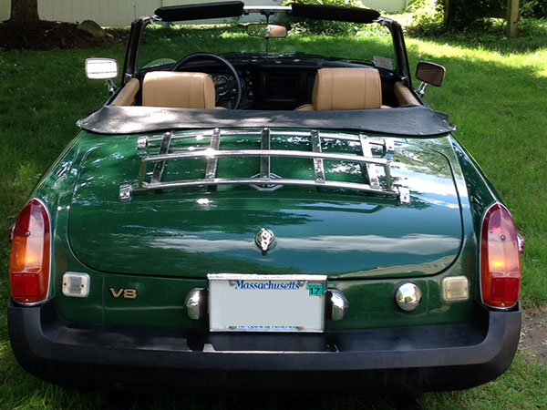

Body: centered fuel tank. Aftermarket luggage rack.

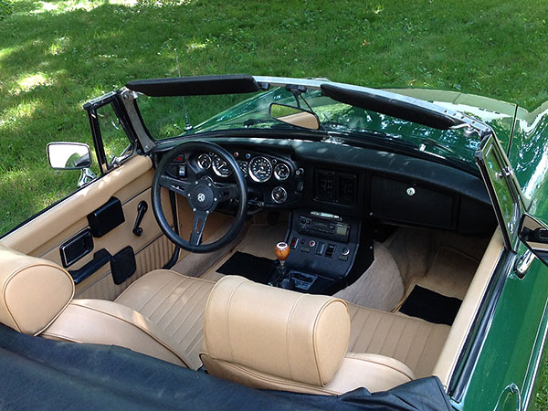

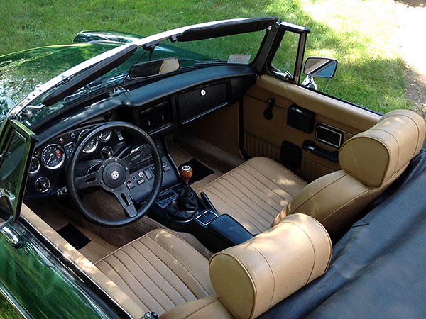

Interior: stock appearance upholstery and dashboard. DIN mount stereo radio in center console. Door mounted speakers. Dashboard mounted switch for over-riding thermostat on the electric cooling fan circuit.
Instruments: stock, except with tachometer modified for V8 signal.
MGB GT V8 style radiator. Flexolite fan, plus MG dual thermostatically-controlled electric fans.
Stock appearance upholstery from 1992 restoration project.

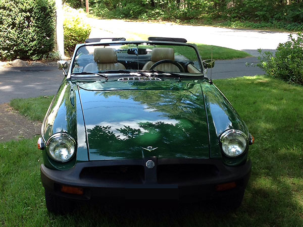

British racing green paint.
Luggage rack.
Luggage rack.
Rostyle wheels with trim rings.

Modifications: complete rebuild. 3 angle valve job. Heads milled to true surfaces. Valve stems shimmed to proper height. Ports modified to match gaskets. Oil passages drilled to increase flow. Oil pump uprated. Larger oil pickup tube. Edelbrock 500cfm 4-barrel carburetor. Stock Buick 215 aluminum intake manifold. Custom dual exhaust with 1-3/4" ID pipes.

Cooling: MGB V8 3-tube core radiator. 1977 MGB expansion tank and cooling fans to assist mechanical blade on engine. Aftermarket electric controls to turn on fans at 180 degrees (worked beautifully all summer). Audi 1986 4000 heater (hot water) control valve.

Conversion Recommendations: use Glen Towery's advice and use him for whatever parts are required. He is clever and experienced. He also knows how to use many existing parts just by making a few changes and modifications. This saves time and money. Also, with little modification you can use 70's-80's Buick/Olds/Pontiac non-A/C alternator bracket and G.M. alternator. It's a good idea to install another fuel filter before the fuel pump. I am going to do another conversion with my youngest son when he gets a little older. I will change nothing since this conversion was relatively easy and VERY rewarding. Moreover, the car looks completely stock in that the hood has no scoops or cut-outs. In addition, the shifter stayed in the same position as stock.
