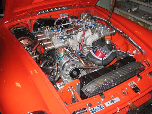

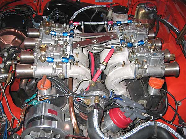

Cylinder heads: 41.4mm (1.63") intake valve, 35.56mm (1.4") exhaust valve, flowed, polished and lightly sandblasted ports. Bronze valve guides. Balanced chambers (10:1 CR).
Fuel system: 4 Weber DCOE45 carburetors, Eurocarb UK manifold. Home made throttle linkage.
Camshaft: Crower #50532, 0.488" lift, 276 degree intake, 281 degree exhaust duration, 112 degree lobe separation.
Modifications: hardened and balanced crankshaft, stock con-rods and new stock pistons. Upgraded oil pump and tadpole relief valve (see RPIV8... a must). Rhoads Hi-Rev lifters, adjustable pushrods, Cloyes steel timing gear set, and an ARP main stud kit, upgraded oil return and breather. Thin cylinder head gaskets. Mallory dual point distributor. #29217 Mallory Performance coil, condenser and ballast. NGK BP6ES Spark Plugs. Oil filter adaptor and oil pump base plate. Mitsuba fuel pump (an inexpensive must, regulator and filter are included in the pump).

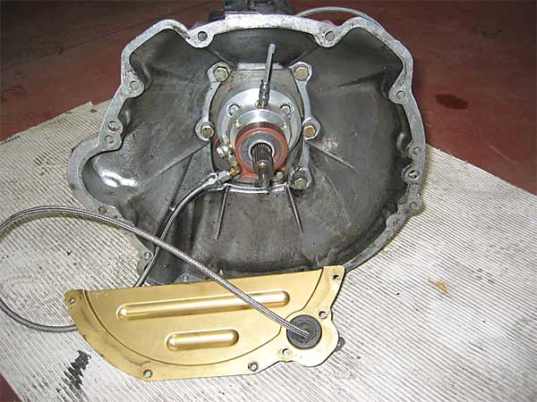

Transmission: Rover LT77 SDI 5-speed (heavy duty / "D-suffix").
Flywheel: lightened (to 24lbs)
Bellhousing: stock SD1.

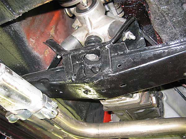

Other: Special gear ratio kit and cable from MGOC to speedometer. Home made gearbox support crossmember. The stock MGB crossmember is modified to receive the modified stock SD1 support and to retain the stock bolts holes. Modified propshaft.

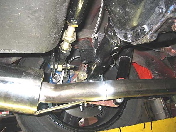

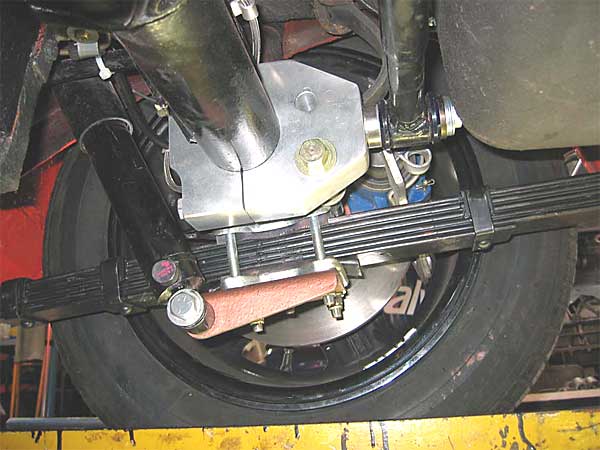

Rear suspension: 6 leaf rear springs, lowered, AVO shock-absorbers. Home-made Panhard rod. Anti-roll bar (stock 1974 on). Superflex fast road bushes all-round. Shorter check straps to clear exhaust, made from V-belts (turned inside out) Optibelt #VB A487a/13V457LI A18, 2 each sides.
Brakes-Front: BMW 635 (1981 model) CSI 4 pot calipers (HP E24), with ATE #609031 13.0460-9031-2 19mm pads. Rotors: Honda vented disks
Brakes-Rear: Saab 900 turbo (1986 model front brakes) non-vented rotors and calipers, HP #55404 OEM 8941981 Seal kit OEM: #8993255 with ATE #602904 13.0460-2904.2 16.3mm pads. (Note: the Saab brakes include an integral parking brake.)

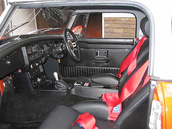

Interior: stock, except B.F. Torino (of Italy) fully reclinable bucket seats with black upholstery. (Note: handbrake lever position was modified to accommodate the seats.)

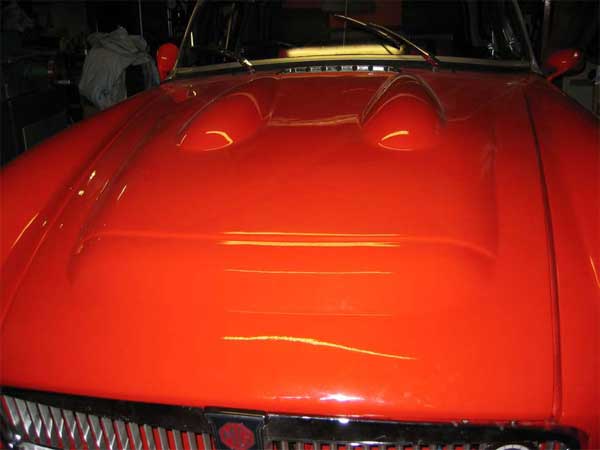

Body modifications: transmission tunnel modified to receive the Rover gearbox. Reinforced weldings on new outer sills, inner sills and castle sections. GRP (fiberglass) front wings and GRP front bonnet. Using the stock engine brackets we were obliged to go to a modified MGC-type bonnet and we added two bosses (molded-on TR5) to clear the 4 Weber carburetors.

Rover 4.0L V8 Engine with Weber carbs
Close-up of custom throttle linkage
Rover 5-Speed bellhousing showing blanking plate and hydraulic throw-out bearing
Rover 5-Speed bellhousing showing blanking plate and hydraulic throw-out bearing.
Custom rear cross-member for Rover 5-Spd
Panhard rod, disk brake, caliper and gas shock
Panhard rod, disk brake, caliper and gas shock.
Custom Italian racing seats
Two TR-5 hood bumps grafted onto a MGC hood to clear the carburetors and intake manifold
Two TR-5 hood bumps grafted onto a MGC hood to clear the carburetors and intake manifold.
