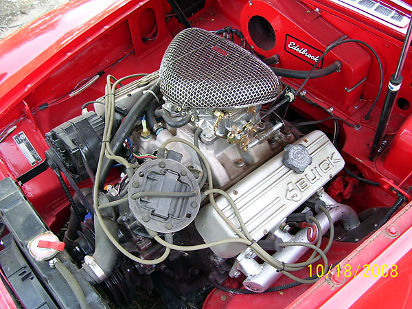

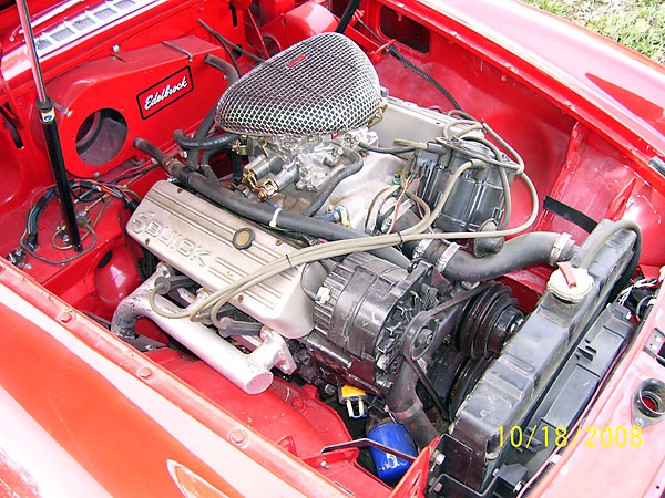

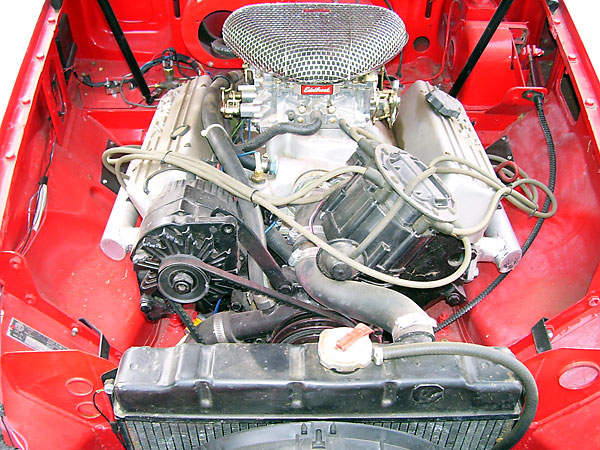

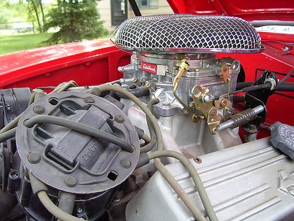

Engine: Buick 231cid (90 degree) V6, with a rated output of about 140hp. Edelbrock "Performer" high rise intake manifold with Edelbrock 650cfm 4 barrel carburetor. Stock cam. Delco-Remy H.E.I (high energy ignition) distributor. All new wiring.

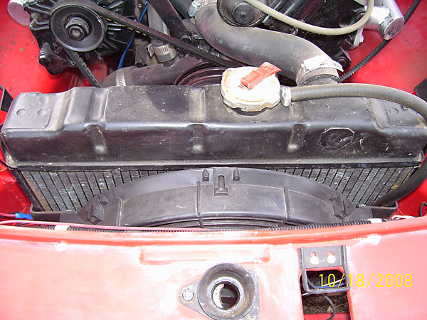

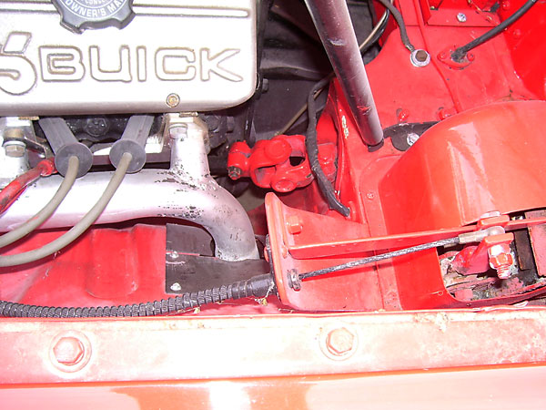

Cooling: stock radiator except lengthened 3 inches with a new core, relocated and enlarged ports, and the whole assembly has been relocated forward. Single electric cooling fan (pushing).

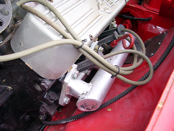

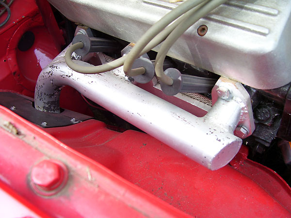

Exhaust: custom built exhaust manifolds with a rear dump leading into side pipes with Harley Davidson motorcycle mufflers.

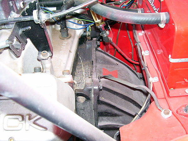

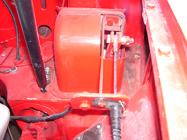

Transmission: Borg Warner T-50 5-speed transmission. Cable operated clutch, utilizing the Buick cable, operated by a modified MGB pedal on custom modified brackets. Stock MG driveshaft, except rebuilt with a GM front yoke.

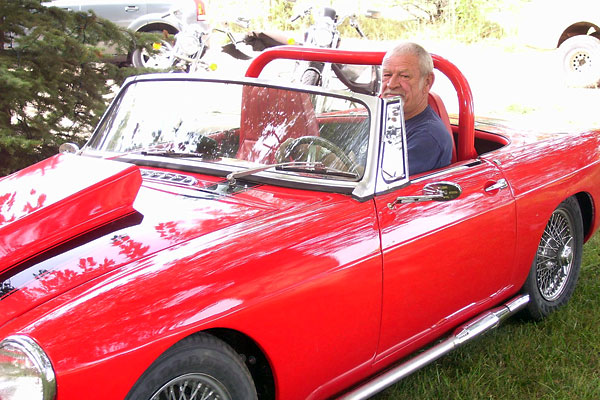

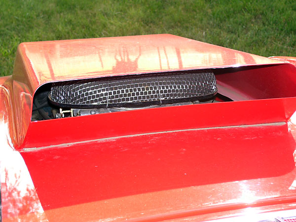

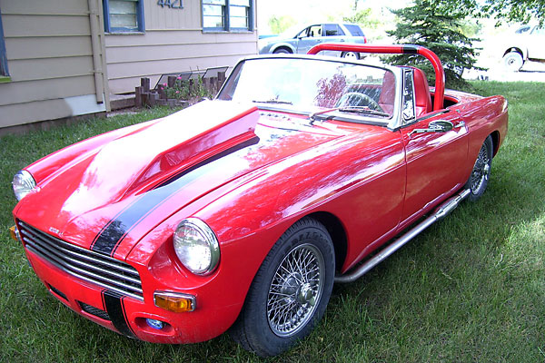

Body: "pull-handle doors" (from a 1963 MGB), fiberglass "Sebring" valances, front and rear. Custom fabricated grille. The aluminum hood was replaced with a steel hood and a fabricated steel cowl-induction hood scoop was added. PPG acrylic urethane base coat ("Porsche red" with a a black racing stripe) with 2 coats of PPG clearcoat.

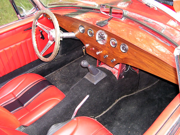

Interior: custom walnut dashboard. AM/FM/CD stereo. (Unidentified seats.) Custom upholstery by Keith Hall of University Upholstery in Eaton CO.

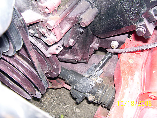

Comments: this conversion took 2 years from start to finish. To minimize firewall modifications, and get clearance at the cylinder heads, the (90 degree V6 motor) was mounted rather far forward. The crank pulley sits just in front of the MG steering rack. The passenger-side subframe was sectioned and boxed back in to clear the starter motor and oil filter.

hood scoop

fabricated exhaust manifold
log type exhaust manifold
clutch release cable
cable operated clutch
bellhousing for 3.8L Buick V6
motor mount for 3.8L Buick V6
