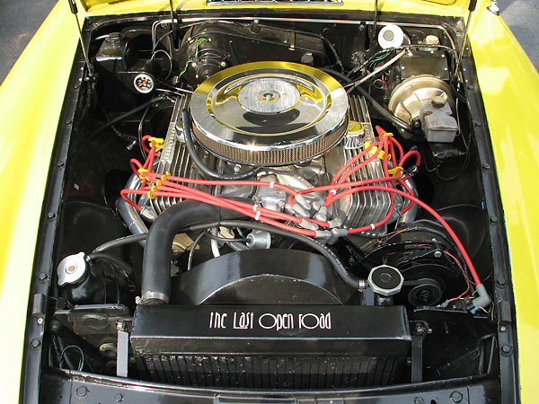

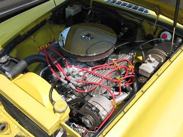

Jack Renaud's 1980 MGB-LE with Rover 4.6L V8 Engine
Jack Renaud's 1980 MGB-LE with Rover 4.6 V8
Owner: Jack Renaud
BritishV8 UserID: kayakjack
City: Dearborn, MI
Model: 1980 MGB-LE
Engine: Rover 4.6 aluminum V8
Conversion by: owner

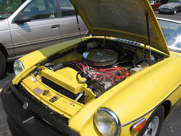

Engine: Rover 4.6L aluminum V8, built by Woody Cooper at The Wedge Shop in Raynham MA. Ported and polished cylinder heads. Erson camshaft (285° duration, 0.504" lift @ 220°.) Cloyes double roller timing chain. Chevy valve springs. Edelbrock Performer 2198 intake manifold and 500cfm carburetor. D&D swivel oil filter mount. Pertronix ignition. Rover 3.9L timing cover.

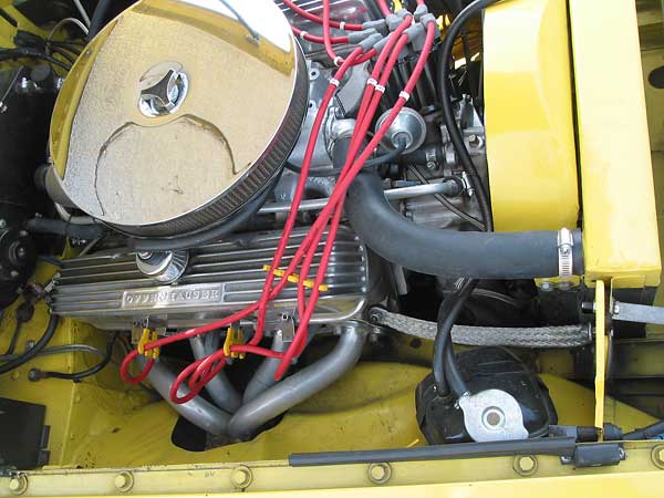

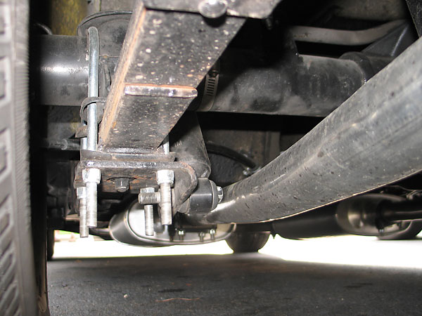

Exhaust: through-the-fender headers from TS Imported Automotive, Jet Hot coated (through Exotic Coatings, Romulus, MI.) Dual DynoMax mufflers. Jack constructed dual, 304 stainless 2" OD exhaust pipes with an "H" crossover, routed on either side of the centered fuel tank.

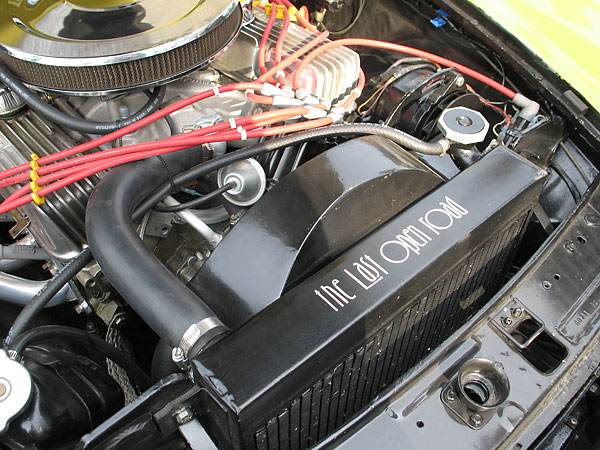

Cooling: 18" wide by 15" tall 4-row brass radiator from D&D Fabrications, with metal shroud (fabricated by Jack) and engine-mounted fan.

Rear Susp.: standard rear leaf springs with 1" lowering blocks. Monroe tube shocks. 0.44" anti-sway bar.

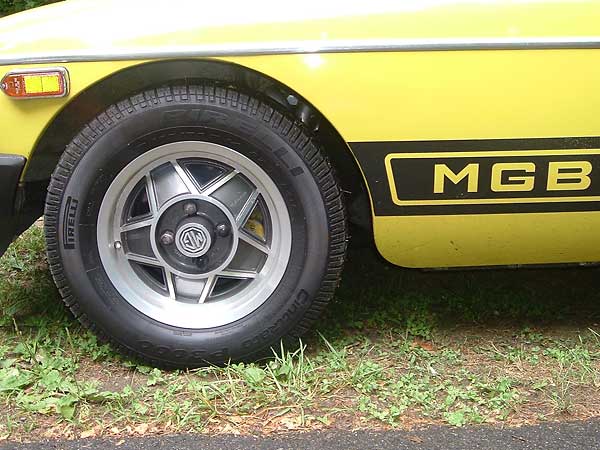

Wheels/Tires: MGB LE wheels from Victoria British. Pirelli Cinturato 185-70x14 tires.

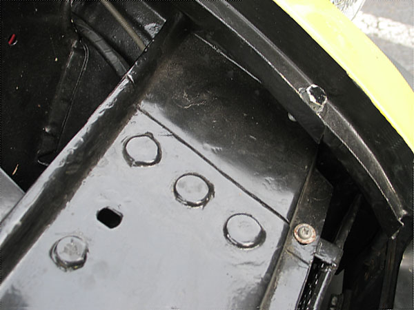

Comments: longitudinal hat-section members were installed from the rear spring mounts to the jacking crossmember. Fuel, vapor and brake lines are all stainless. The lines and underbody wiring have been routed away from the righthand exhaust, vertically stacked along the inboard side of the rh longitudinal member. The jacking crossmember has a removable center section.
Rover 4.6L aluminum V8 engine.
D&D Fabrications brass MGB V8 radiator.
D&D Fabrications brass MGB V8 radiator. Jack fabricated the custom fan shroud.

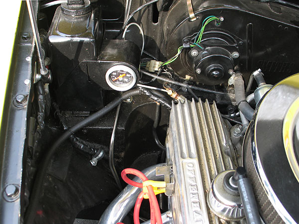

An AutoMeter oil pressure gauge has been incorporated into the windshield washer box.

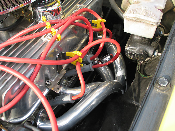

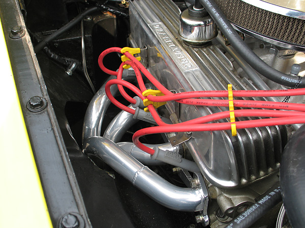

Four-into-One RV8 style headers.
Four-into-One "RV8 style" headers.
The headers are Jet Hot coated.

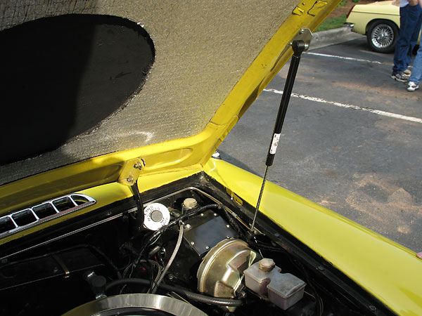

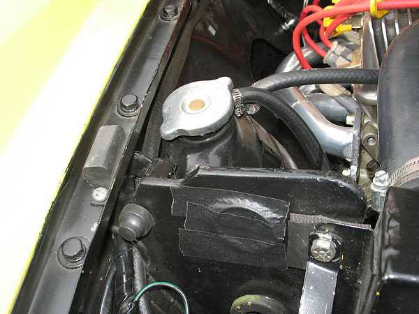

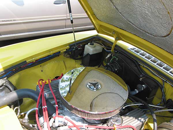

Bonnet supports are from Eclectic Motors.
Bonnet supports are from Eclectic Motors, but the prescribed mounting points weren't used.
Instead, Jack installed them with improved geometry to keep the bonnet from twisting when
closing and still makes for easy access to the engine.

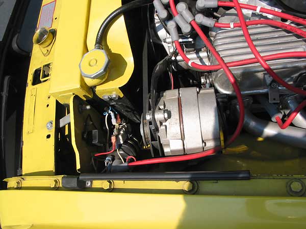

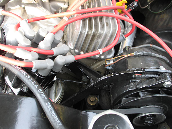

alternator mounting
Accessory bosses on the Rover cylinder heads are located differently, compared to the bosses
on earlier versions of the aluminum V8, so a new set of alternator brackets was needed.

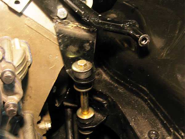

The upper engine stabilizer bracket was combined into the alternator bracket.
The upper engine stabilizer bracket was combined into the alternator bracket. A lower angle bracket
was welded to the lefthand frame rail. The engine torque required that angle reinforcements be added
(not shown). The link between engine and chassis is an aftermarket sway bar link (4" long).

Lower tube shock holes moved rearward to slightly soften ride.  DynoMax mufflers.

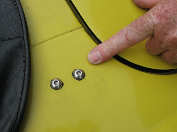

Custom brackets attach to specially reinforced mounting points...

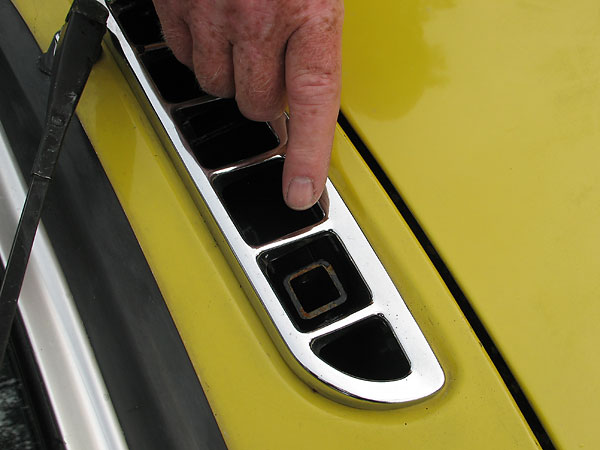

Jack is very enthusiastic about kayaking, so he has modified his MGB to include provisions
for transporting his Nigel Dennis kayak over land. Custom brackets attach to specially
reinforced mounting points here (in the cowl vent grille) and...
... for transporting a kayak.
...on the rear deck. There is a C shaped brkt between this panel and the top of the wheel well.

Pirelli tires on MGB-LE wheels
