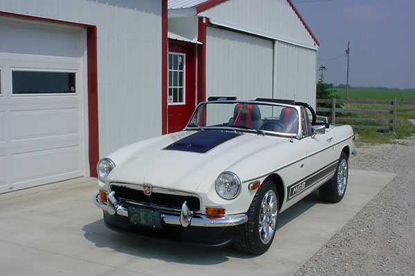

Jack Pease's Ford 302 powered 80 MGB with Tremec 5-speed transmission
Jack Pease's Ford 302 powered 1980 MGB with Tremec 5-speed
Owner: Jack and Judy Pease
City: Champaign, IL
Model: 1980 MGB

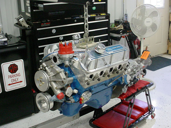

Engine: 1990 Ford 5.0 V8
Conversion by: Pete Mantell at Mantell Motorpsort

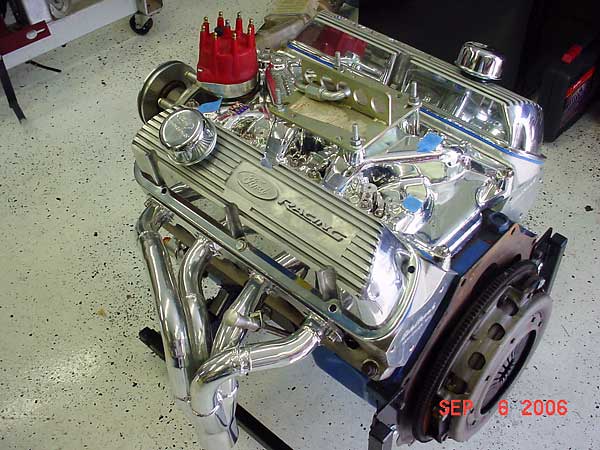

Engine Mods: Edelbrock Power Package 367hp, 340 ft/lb RPM heads. Edelbrock RPM 7122 cam. Comp Cams roller rockers. MSD 8579 distributor. MSD "6A" ignition box, and MSD "Blaster" coil.
Induction: Edelbrock "Performer RPM Air Gap" manifold and 600cfm Edelbrock carburetor (electric choke). Holley "Red Top" Fuel pump (fits perfectly in the stock location!)

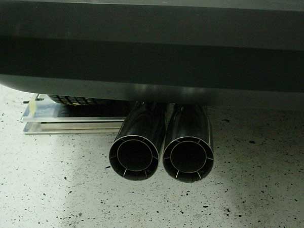

Exhaust: RV8 style headers from Coyote Conversions, with Jet Hot ceramic coating. Dual Mantell Motorsport exhaust system. Flowmaster mufflers, exiting through twin pipes at the rear on driver's side.

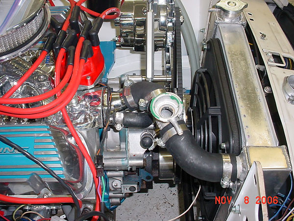

Cooling: Mantell Motorsport aluminum radiator, Ford Motorsport short-neck regular-flow water pump, and Flexlite low profile electric fan with shroud.

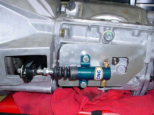

Transmission: Tremec T5 Super-Duty Z 5-speed. Custom driveshaft. Ford Motorsport clutch, aluminum flywheel, CNC slave cylinder, MGB master cylinder.

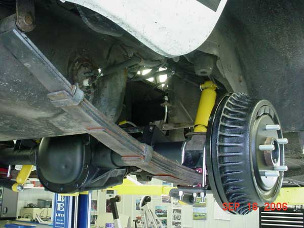

Rear Axle: Chevrolet S10 10-bolt (from D&D Fabrications).

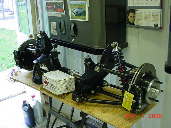

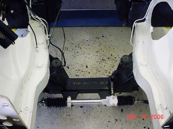

Front Susp.: Fast Cars Inc. front suspension. 7/8" sway-bar, and Energy Suspension polyurethane bushings.
Rear Susp.: lowered 1". Tube shock conversion. Energy Suspension polyurethane bushings.

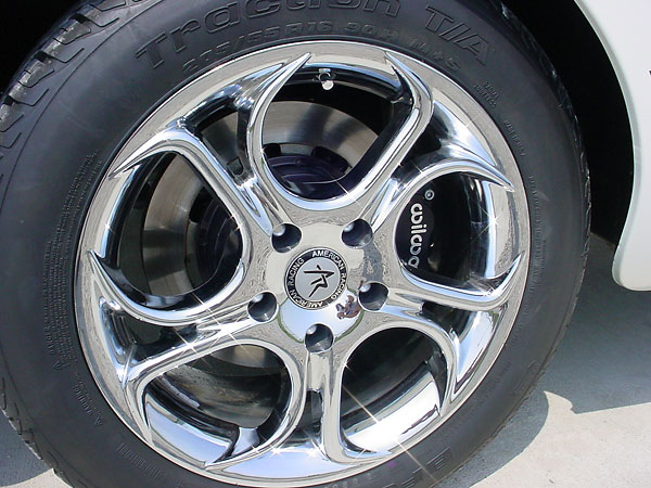

Brakes: Wilwood (from Fast Cars Inc.)
Wheels/Tires: American Racing 16x7 wheels, BF Goodrich 205/55R16 tires.

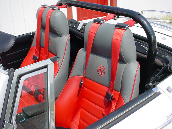

Interior mods: Fiero seats with Mr Mikes leather kit. Auto Square 4-point harnesses. Grant steering wheel.

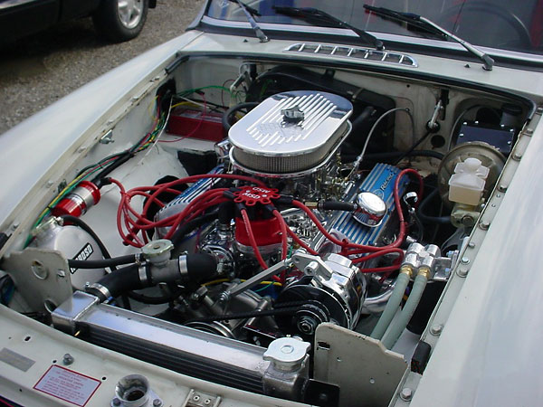

MSD distributor and ignition system (6A box and blaster coil)

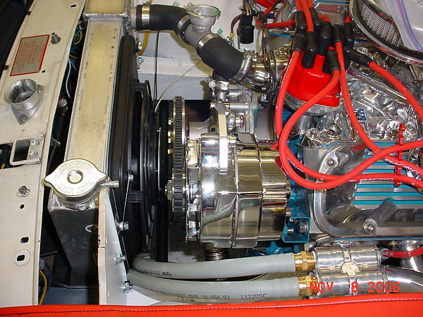

alternator and remote oil filter
cooling system
Edelbrock aluminum cylinder heads
Steve Carrick's Coyote through-the-fender headers

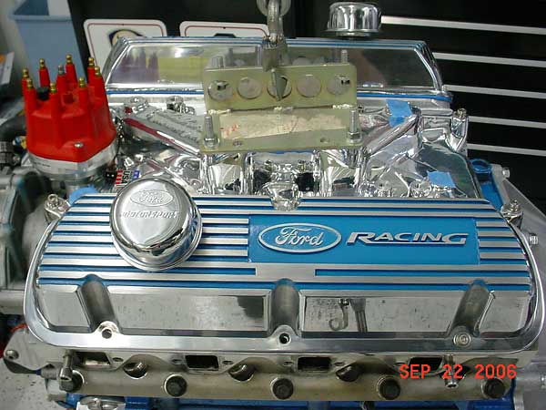

Ford 302 engine with aluminum heads
CNC pull-type slave cylinder
Fast Cars MGB suspension

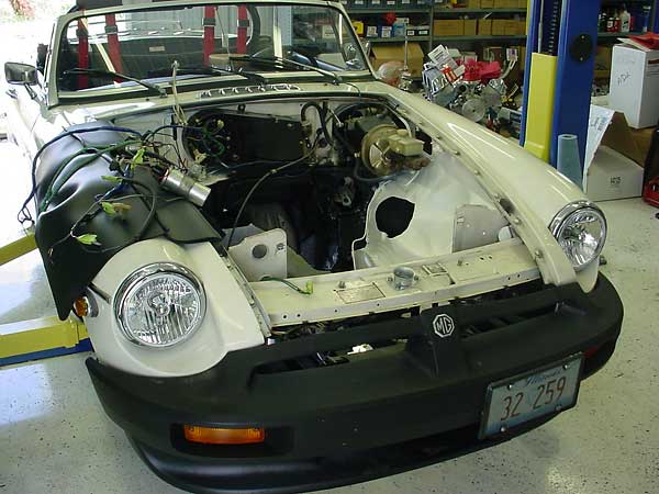

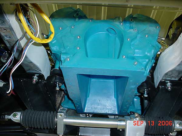

checking motor mounts and oil pan clearance
Fast Cars front suspension
Chevy 10-bolt rear axle (narrowed S10 axle)

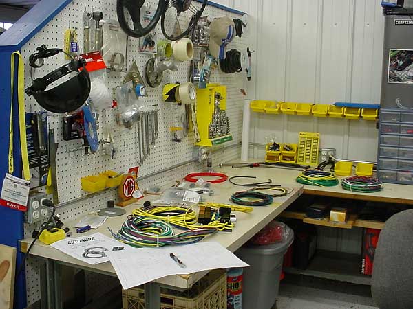

Advance Auto Wire wiring harness
wiring

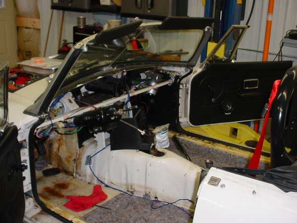

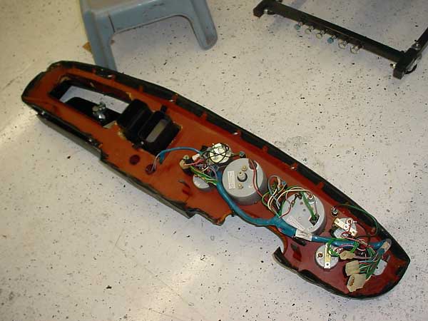

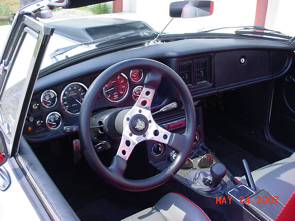

MGB dashboard
MGB interior
Fiero seats, with custom upholstery by Mr. Mike

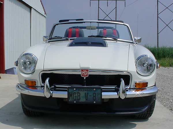

chrome bumper conversion, and spoiler

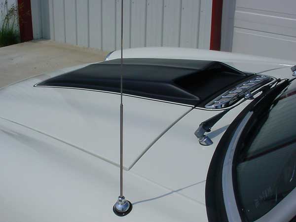

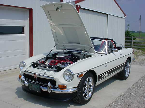

Ford style hood scoop

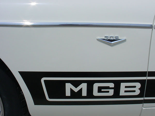

302 badge, and MGB LE stripes
exhaust pipes
American Racing wheels, BF Goodrich Traction T/A tires

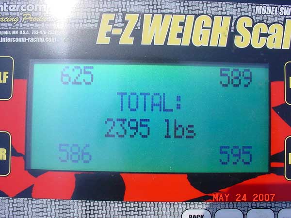

2395 pounds
