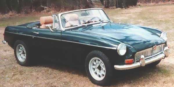

Total Restoration and V8 Conversion Completed April 1997 by "The MG Guys"
Car owned by Jack Emery, Glenburn, Maine
BODY
New sills, floors, fenders, with PPG DP series epoxy primer
PPG color and clearcoat Brooklands Green
Firewall and tunnel modified for V-8 installation
Late MGB seats with Biscuit interior

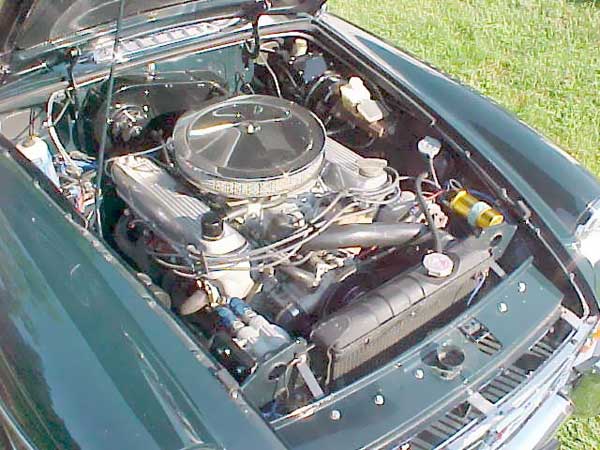

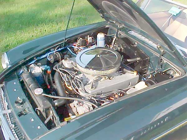

ENGINE
1963 Buick 215 Aluminum V-8
0.040 overbore with 9.6 to 1 compression
Crower cam and valvetrain
Heads port matched with Rover exhaust valves
GM intake with 500 cfm Carter 4 barrel carb
Pertronix ignition in GM distributor
High volume oil pump with remote filter
Gear Drive Starter
