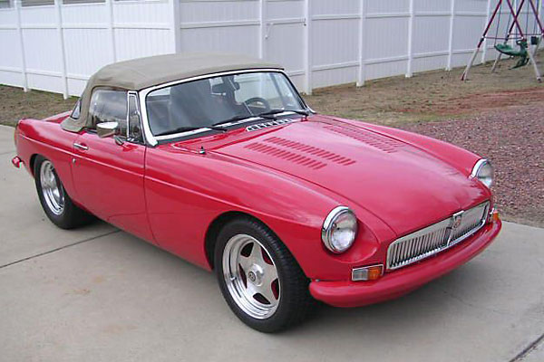

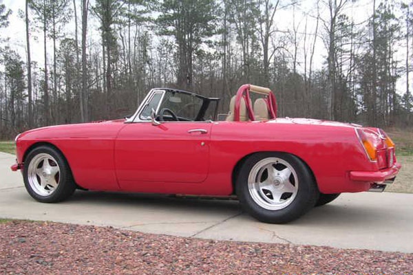

Henry Byrd's 1974.5 MGB with Chevy 350 V8 and TH-400 tranny
Henry Byrd and his MGB V8 at Atlanta Motor Speedway, May 18 2007
Henry Byrd's 1974 MGB with Chevy 350 V8

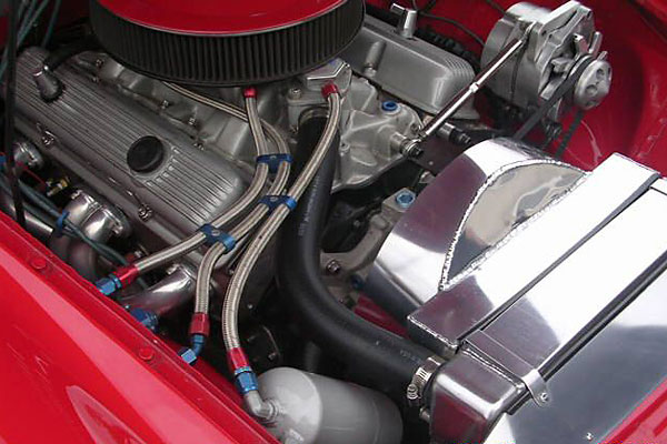

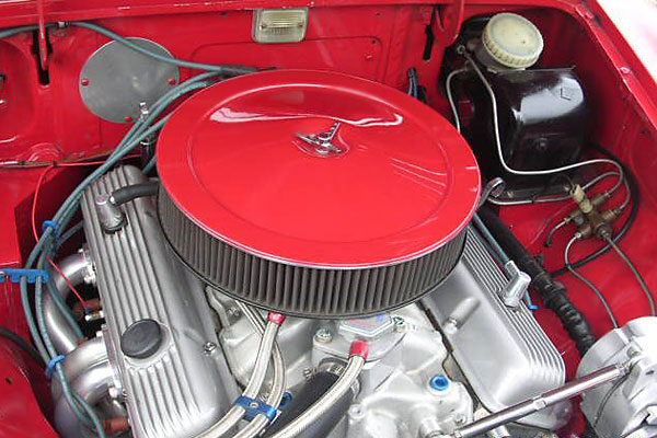

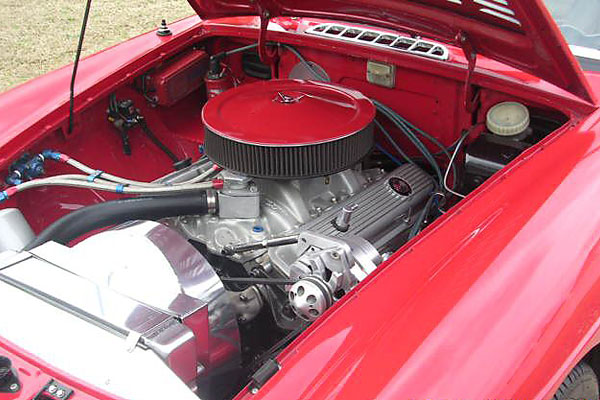

Engine: 1969 Chevy 350, bored 0.030" over, 4-bolt mains, steel crank, pink rods, Edelbrock "Performer RPM" heads, Crane roller rockers, and Pete Jackson gear drive. Edelbrock "Performer RPM" intake manifold and Holley 750 carburetor. Edelbrock "Performer RPM" cam (for hydraulic lifters. Lift: 0.488" int., 0.510" exh. Duration: 234 int., 244 exh.) Mallory "Unilite" distributor, MSD 6AL ignition, and MSD coil.
Cooling: Griffin aluminum radiator and aluminum water pump.
Exhaust: Hooker block huggers headers, 2.5" exhaust system, and stainless steel chambered mufflers.

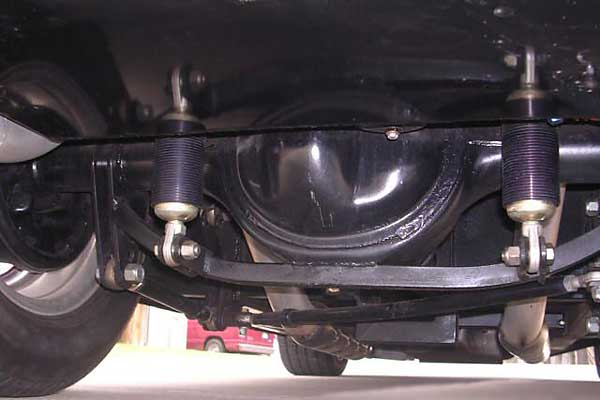

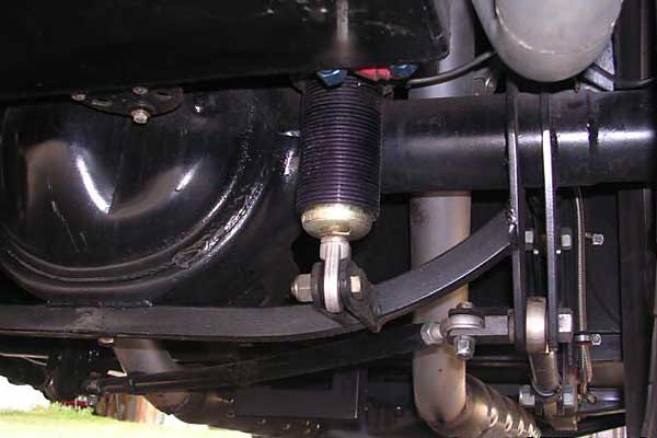

Rear Susp.: custom 4-link.

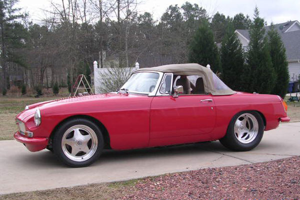

Wheels/Tires: Boyd wheels (15x7 front, 15x10 rear). BF Goodrich "T/A Euro" tires (205/50-15 front, 295/50-15 rear).

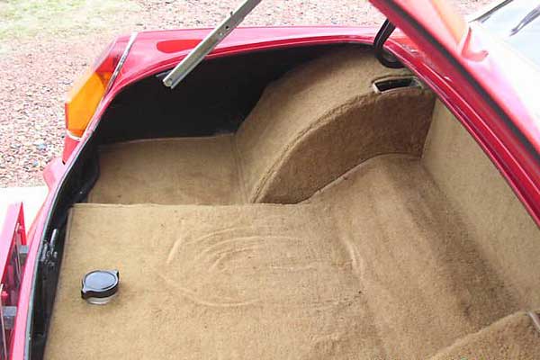

Chassis: 2" tube frame from the front sub frame rails to the back. Tubbed rear with custom sheet metal (26 gage, from firewall to back of car.) 12 gallon fuel cell.

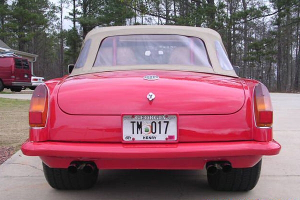

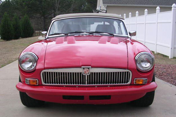

Body: chrome bumper conversion... except that the bumper bolt heads were ground off and smoothed, and the steel bumpers were painted body color! Louvered hood.

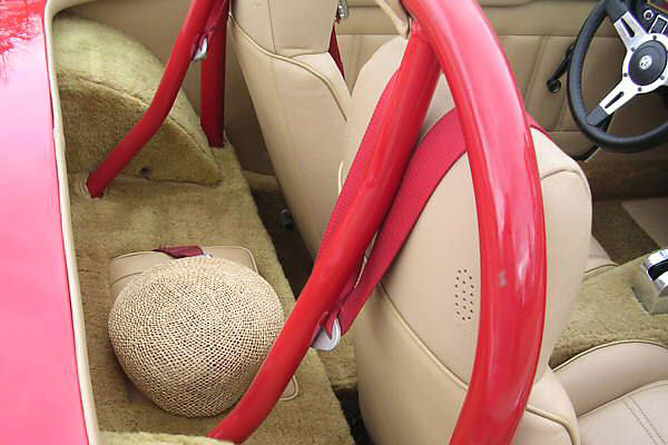

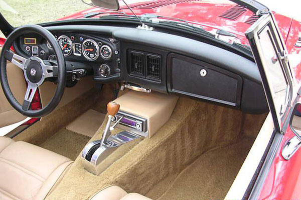

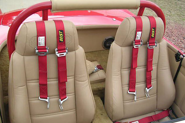

Interior: tan leather upholstery. Pontiac Fiero seats. Roll hoop with Diest 4-point safety harnesses. Auto Meter gages. AM/FM/CD stereo system with speakers in the head rests.

aluminum radiator and fan shroud
complete Edelbrock Performer RPM system
four link rear suspension
coilover shock absorbers
Hurst quarter stick shifter
Auto Meter gages
Fiero seats, and Diest four point safety harnesses
child seat

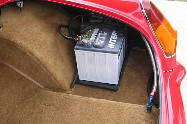

relocated battery
fuel filler moved inside trunk
MGB louvered hood
Boyd wheels
custom roll hoop
notice that the bumper bolt heads have been welded and smoothed over
MGB bumpers painted body color
