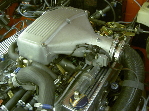

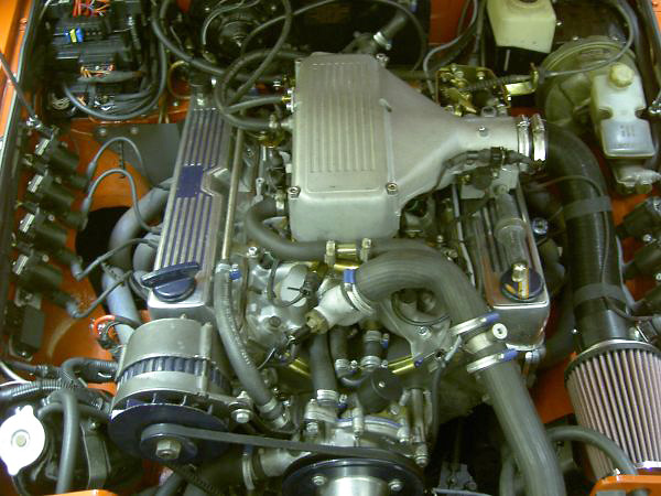

Engine: Rover 3500cc V8, with 9.35:1 compression ratio. Stock Rover 3.9 camshaft with Cloyes Duplex vernier timing chain/gears set. Rover 3.9 EFI intake manifold and throttle body. K&N air filter. Rover 3.9 "Green" fuel injectors. Lowered fuel rail. KdfI (Megasquirt based) ignition and fuel injection computer. Eight separate ignition coils, mounted near spark plugs. One Bosch wideband lambda (oxygen) sensor. RV8 low profile rubber motor mounts, with 5mm spacers added to provide clearance to the steering shaft.

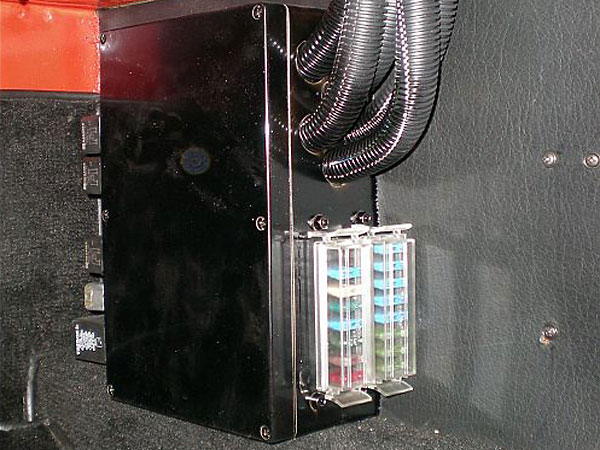

Interior: modified (narrowed) MGF seats in blue alcantara and black leather. Modified wiring with all high current circuits switched by relays, and separately fused.

Rover 3500cc V8 with crank-fired electronic ignition and electronic fuel injection.

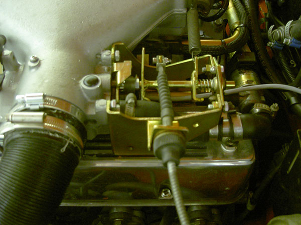

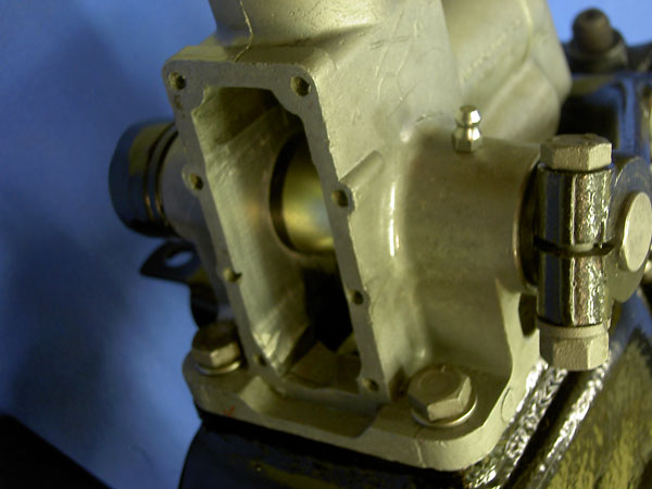

Throttle cable connection.
Throttle body plumbing and position sensor connections.

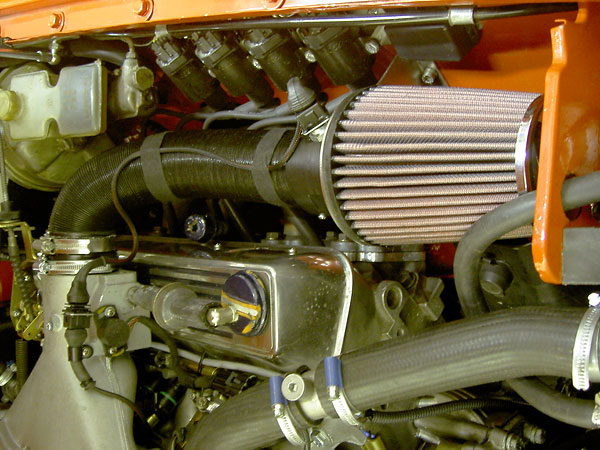

K&N air filter.
K&N air filter.

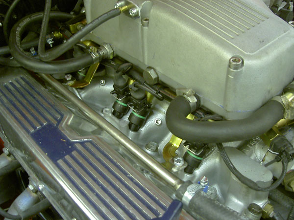

Rover 3.9 Green fuel injectors.

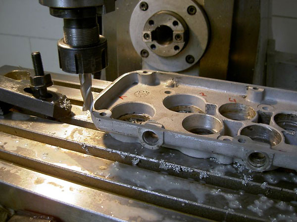

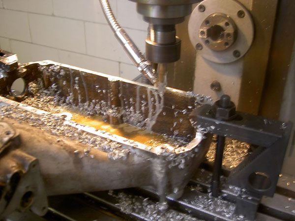

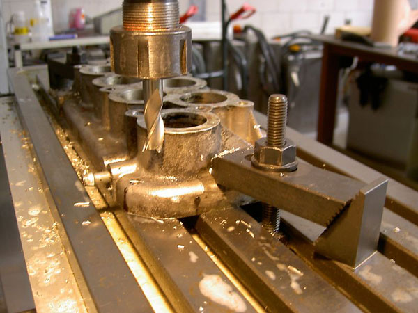

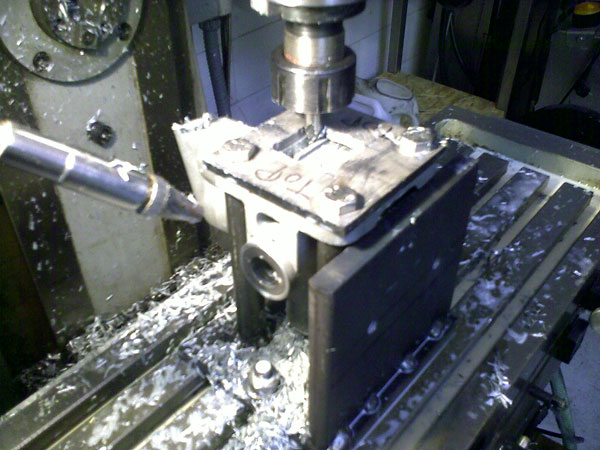

Preparing to mill 15mm off the bottom of the plenum base.
Next, preparing to mill 5mm off the top of the plenum base.
Thirdly, milling 7mm off the bottom surface of the plenum cover.
Of course the point of all that milling is to provide hood clearance, as shown here.

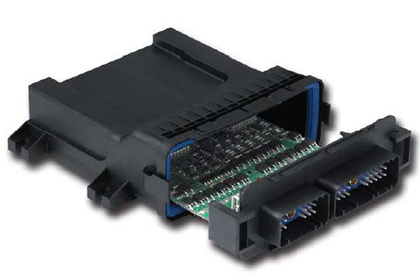

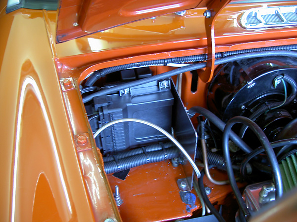

Electronic ignition / EFI computer mounting, wiring, and heat shield.

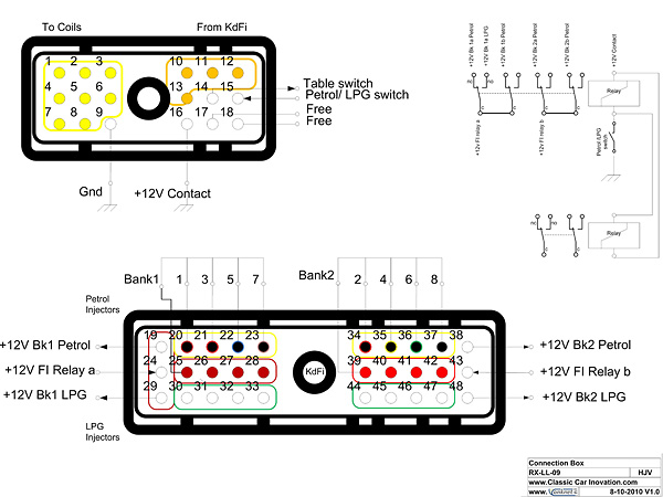

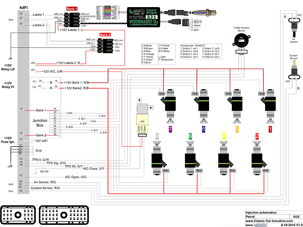

KdfI fuel injection schematic drawing.
KdfI fuel injection connector pin-outs.

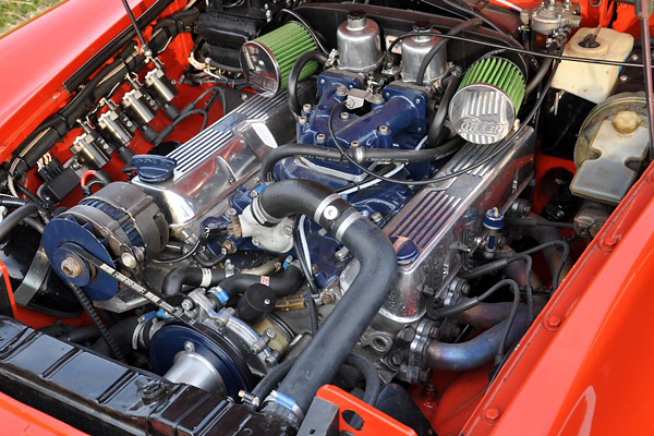

Henk-Jan's original V8 installation featured S.U. HIF carburetors.

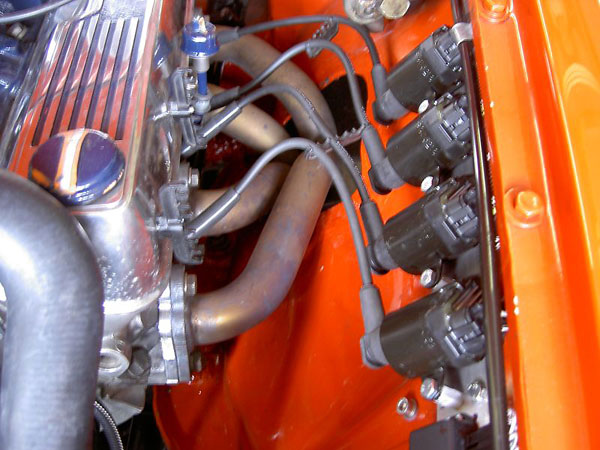

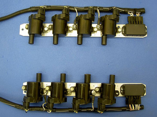

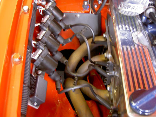

Crank-fired ignition system, featuring eight individual ignition coils.

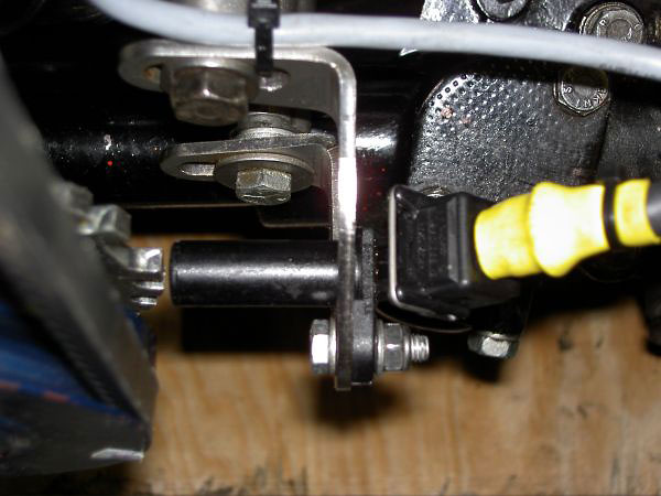

Crank position sensor and tone wheel.
The coils are located quite close to the spark plugs.

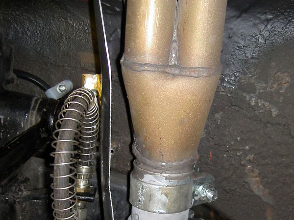

RV8-style headers.
RV8-style headers.

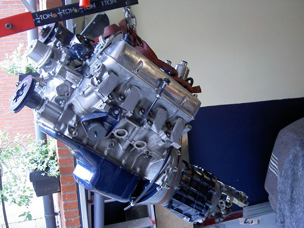

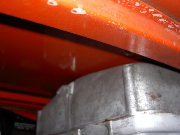

The engine on an engine hoist. Note the iron housing of the LT77 transmission.

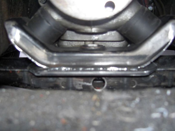

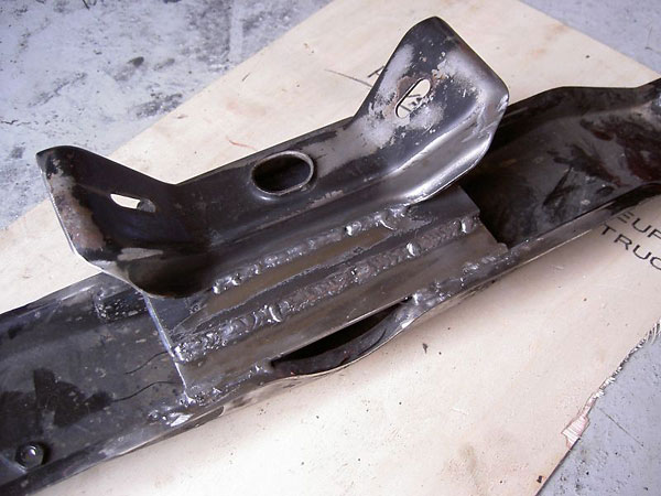

MGB transmission crossmember modified to support the Rover LT77 5-speed transmission.
Rubber vibration mounts for the transmission.

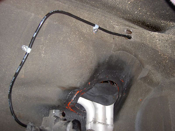

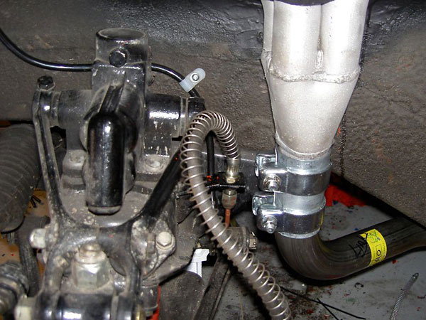

Front Brake Plumbing
Alternative brake tubing routing.
Brake tube routing.
Brake tube routing behind the upper control arm attachment.
A custom aluminum sheetmetal heatshield between exhaust headers and brake plumbing.

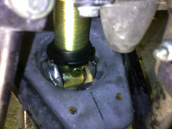

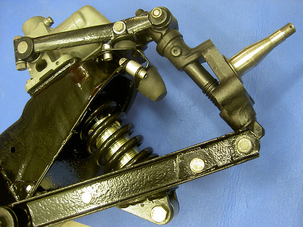

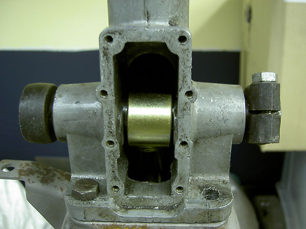

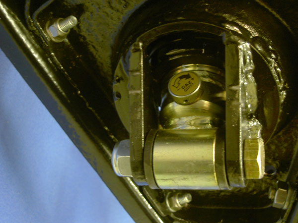

Front Suspension

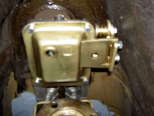

Henk-Jan came up with a very clever way to install coilover shock absorbers on an MGB.
He gutted the original Armstrong lever shocks, but left them to function as upper control arms.
The pivot rod has been machined and now the coilovers mount directly to it.
The coilovers come right up through the base of the old shocks, so some cutting was necessary.

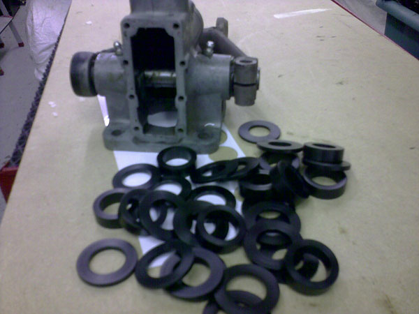

(A stash of spacers for centering the coilover shock absorber.)
The spring pan portion of the lower control arm also needed to be cut away for clearance.
Henk-Jan welded mounting ears on, and installed GAZ adjustable shocks.

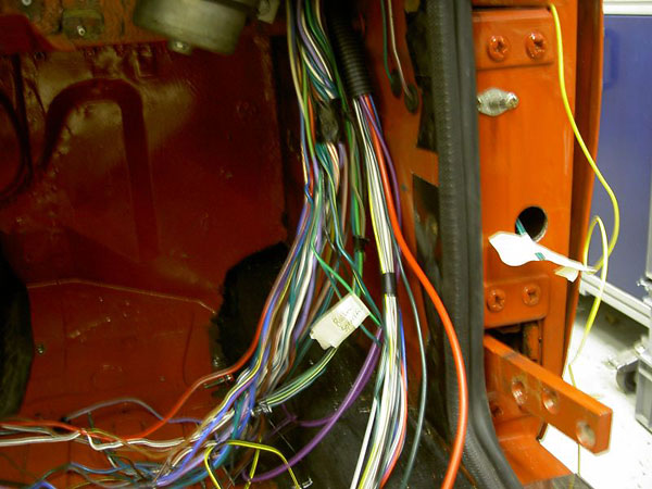

Passenger-side cable feed.

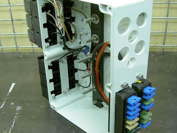

Fuse blocks.
Fuse blocks.

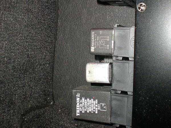

Relay banks.
Relay banks.
Buss bar.
Buss bar.

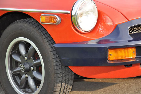

Minilite 14x5J aluminum wheels with Anthracite finish, and with 185/70R14 tires.
Minilite 14"x5J aluminum wheels with Anthracite finish, and with 185/70R14 tires.

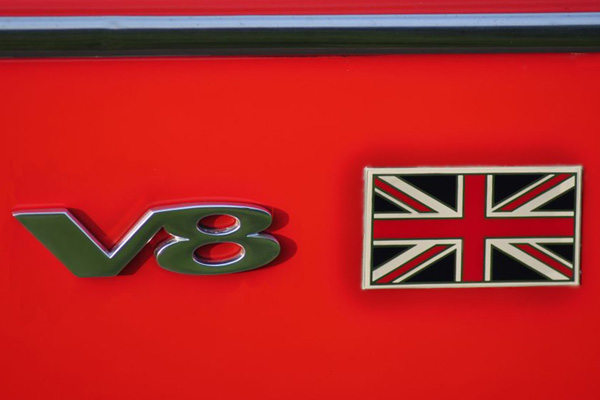

V8 and British flag badges.
