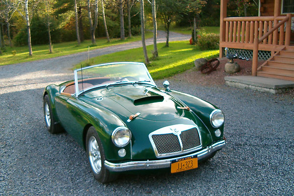

Harry Miller's 1961 MGA with Ford 289 V8 Engine
Owner: Harry Miller
City: Interlaken, NY
Model: 1961 MGA 1600
Engine: Ford 289 V8
Transmission: C4 automatic
Conversion performed by: Bill Parke in 1969-70
Restored by: Harry Miller

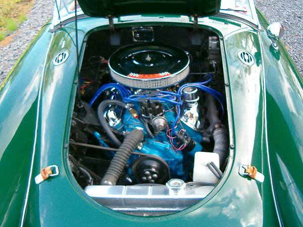

Engine: 1965 A-code 289cid Ford V8 rebuilt by Pike's Engine & Machine Shop in Watkins Glen, New York. Holley Street Avenger 670 carburetor.
Cooling: Griffin early-model Mustang aluminum radiator. Electric fan, pulling.
Exhaust: stock Ford iron exhaust manifolds. (The driver's side manifold is rotated 180 degrees to exit forward.) Dual glasspack mufflers.
Transmission: TCI C4 automatic. Shortened driveshaft.

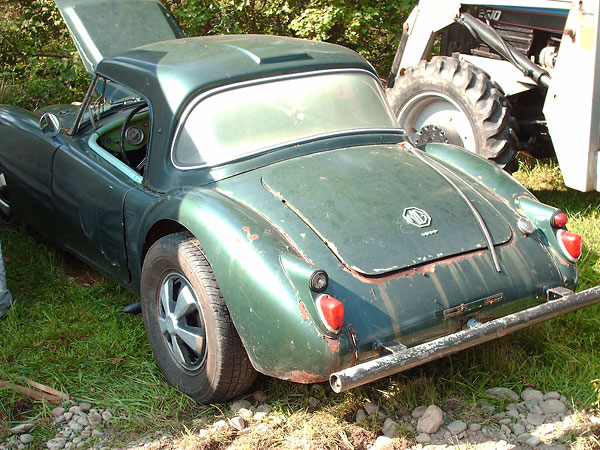

Through conversations with other car club members, I learned the MGA was in Spencer, New York. A CraigsList ad placed by my son didn't lead directly to the MGA's location, but it did bring information about the car's history. An inquiry at the local NAPA store in Spencer got us the location of the car.
As you can see from the pictures, we found it in rough shape. (My grandaughter Jill enjoyed finding the car, as you can tell in the interior shot.) The car had not been on the road since 1984. I started a complete rebuild in the fall of 2009 and completed the job by early summer of 2010. A fresh 289 took the place of the tired 260. Our restored MGA V8 is driven lots during the summer and enjoyed.
1965 A-code 289cid Ford V8, rebuilt by Pike's Engine & Machine Shop in Watkins Glen, New York.

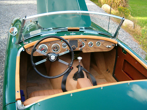

Harry Miller restored the paint and upholstery on this early MGA V8 conversion.
His wife Bonnie did a great job painting the dashboard: faux woodgrain!

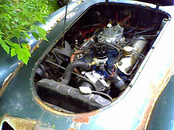

Original Ford 260 engine installation.
