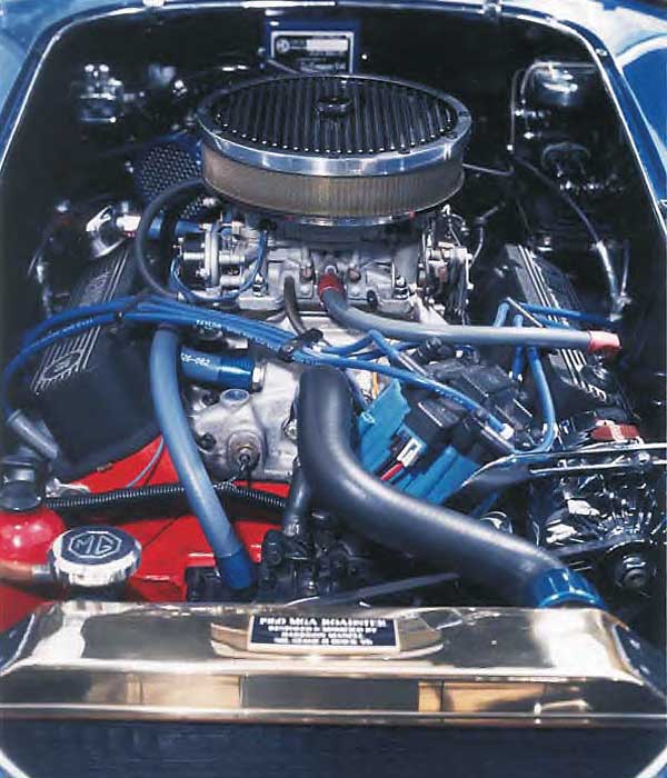

Engine: 1982 3.8 liter Buick Even-Fire V-6, bore=3.83" stroke=3.40". Kenne-Bell Mark 2X camshaft, with an intake lift of 0.478", exhaust lift of 0 .494" take duration is 260 degrees, exhaust is 280 degrees, with a lobe separation angle of 112 degrees. Cylinder heads are stock GM, part # 25506293, Rev. A, with 1.70" intake, 1.50" exhaust. Stock heads were ported & CC'd by Flow-Tech Engineering, Garden Grove Calif. (What they call street grind). They open them up and match the ports. The stock crankshaft has been ground 0.0010, balanced and case hardened by New Performance, Santa Ana, CA. Pistons are 9.5:1 CR Kenne-Bell cast hypereutectic 0.030" over, providing for a 3.83" bore, fitted with chrome-moly Speed-Pro rings. Stock connecting rods were machined, shot-peened, balanced & straightened by New Performance. Valves are operated by Kenne-Bell push rods and lifters, using Kenne-Bell springs and retainers, through T&D billet aluminum, roller bearing, 1.6:1 ratio, rocker arms, on T&D solid rocker shafts. Oil pump is stock w/ Kenne-Bell booster plate. Oil pressure @ 2500 rpm is 70 PSI. Timing chain & gears are Kenne-Bell double roller.

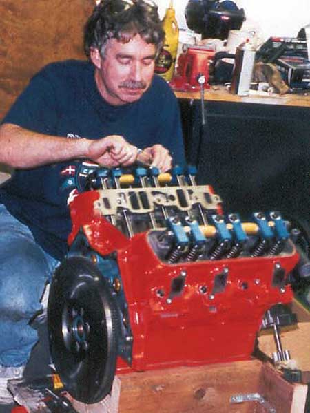

All engine machine work and balancing was done by New Performance. Engine assembly was by the owner, using ARP hardware and Fel-Pro gaskets.
Induction: Carter AFB 9410, 400 CFM 4bbl, with vacuum operated secondary, mounted on an Edelbrock Performer aluminum manifold, model# 5486, and fed by a Carter electric fuel pump mounted next to gas tank. Throttle linkage is cable operated, and was custom designed and fabricated by owner.
Ignition: HEI by Ignitioneering, Fullerton, CA.
Exhaust: Headers were custom made by Mark Weiss in Costa Mesa Calif, with a primary tube ID of 1-3/8". Exhaust pipes are 2" diameter, with a 2" cross over pipe. Mufflers are dual low profile glass packs.

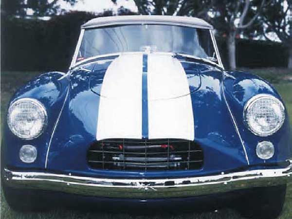

Cooling: Custom built brass crossflow radiator, 19"W X 18"H, four rows of 1/2 x 1/8 tubes, 11 cooling fins per inch. A High Performance Spal AirForce Swirl Model FS13AS-3.5 electric fan is mounted directly to rear of radiator core, in a puller Buick configuration, with no shroud, no mechanical fan. Fan provides 2000cfm, with a current draw of approximately 16 amps. Two small electric ducted fans, mounted under the hood side vents, provide additional heat removal from the engine compartment. Water pump is a stock Buick/GM, of aluminum, with a March billet aluminum pulley. Coolant is Evans NPG 370 degrees, with a boiling point at zero pressure of 370 degrees. The 370 degree boiling point is not a misprint. It is made from non-aqueous propylene glycol and contains NO water. This is a real problem solver for overheating in a conversion application. Because of its extremely high boiling point, it will not form vapor bubbles around the cylinder walls and will remain in contact with the metal far after a water based coolant has boiled away. Detailed information is available at Evans' website located at www.evanscooling.com. An automatic electric thermostat is mounted in the intake manifold, and turns on at 180 degrees F. A manual override fan switch is mounted on the dash.

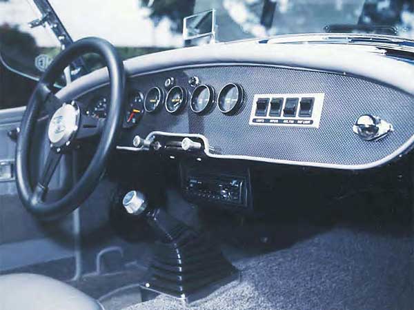

Interior: Seats are custom leather covered MGB. Remainder of the interior is totally custom. Quality leather used throughout. Extensive attention to details. Dashboard is custom made hardwood overlaid with carbon fiber cloth & resin. Billet machined custom rocker switch bezel. Billet machined rear view mirror. Moto-Lita leather covered steering wheel. Custom machined and engraved aluminum steering wheel center and heater control knobs. Custom leather upholstered door panels that contain 6" x 9" Speakers. Kenwood CD Receiver sound system with a 200 Watt sub-woofer amp driving two 8" subwoofers mounted behind the front kickpanels. Hand made custom bevel glass engraved wind wings. Custom billet machined shift lever bezel, shift knob and a Hurst competition plus shift linkage.
Electrical: Powermaster 100 Amp single wire Delco style alternator with internal regulator. Stock GM starter. Wiring harness is Stock MG, re-covered in exposed areas with corrugated nylon. Additional wiring added to accommodate sound system, electric fans, etc.
Gauges: VDO speedo and tachometer. Stewart-Warner "Stage III" water temperature, oil pressure, & fuel level.

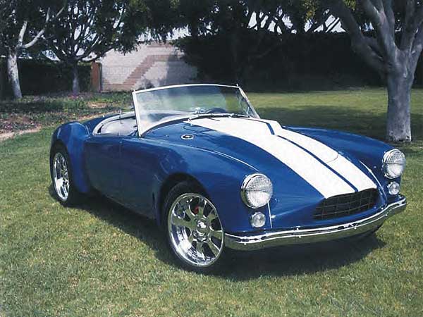

Bodywork: Extensively modified while keeping the basic lines of the car intact. All body modifications done with steel formed on an English wheel then heli-arc & MIG welded together. Widened front & rear fenders. Hood scoop made with hand formed aluminum and carefully heli-arc welded into original hood. Totally restyled front-end and grill opening provides a cobra-like front end appearance. Custom made polished stainless steel front grill.
