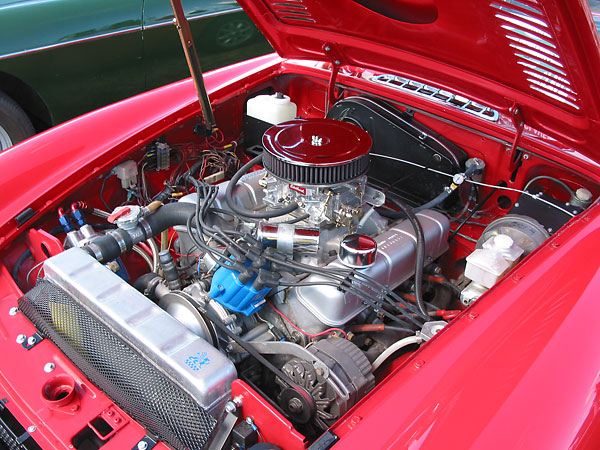

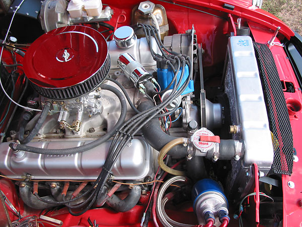

Engine: 1963 Buick Skylark 215cid 4bbl. Bored 0.040" over. 10:1 compression.
Induction: stock Buick manifold, with Edelbrock 550cfm carburetor.
Cam: Isky dual valve spring cam with 0.045" lift (intake and exhaust), although I will be switching to a Crower soon (see below).
Ignition: stock distributor, with Pertronix igniter and flame thrower coil.
Cooling: stock water pump, with a March small diameter pulley. Griffin four row aluminum radiator.

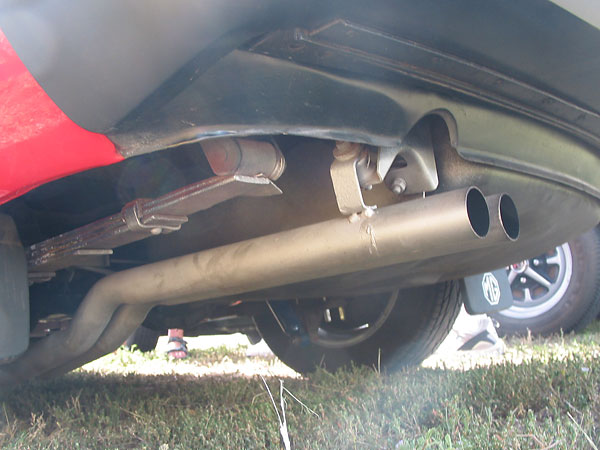

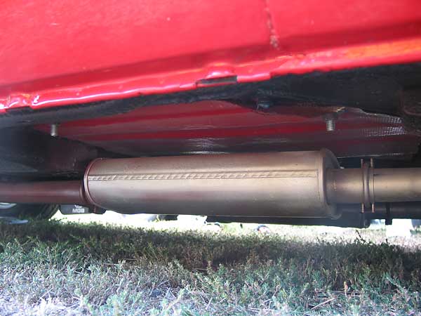

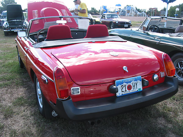

Exhaust: TE Industries headers, dual exhaust to the rear, with mini turbo mufflers.

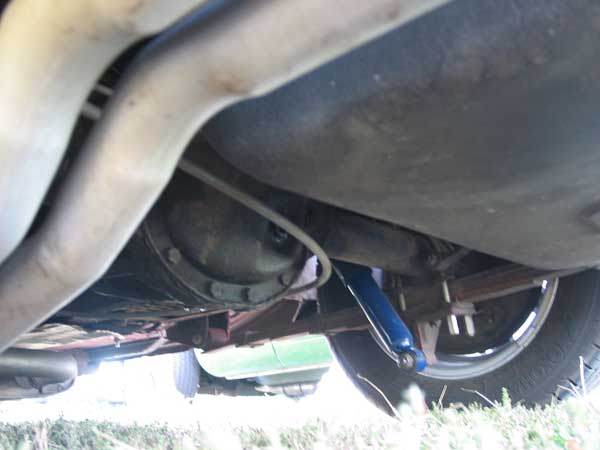

Rear Axle: stock MGB with original 3.909:1 gears and a limited slip that performs awesome.
Suspension: front - poly bushes and Monroe tube shocks. Sway bar removed for larger radiator.
rear - stock except for Monroe tube shocks. Need to add traction bars!

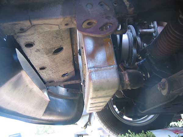

Brakes: front - TE Industries enlarged calipers to fit 20 percent larger XJS pads.
rear - TE Industries race-compound shoes.

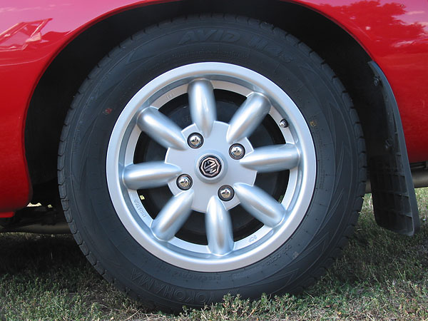

Wheels/Tires: Minilight replica wheels with Yokohama Avid tires.

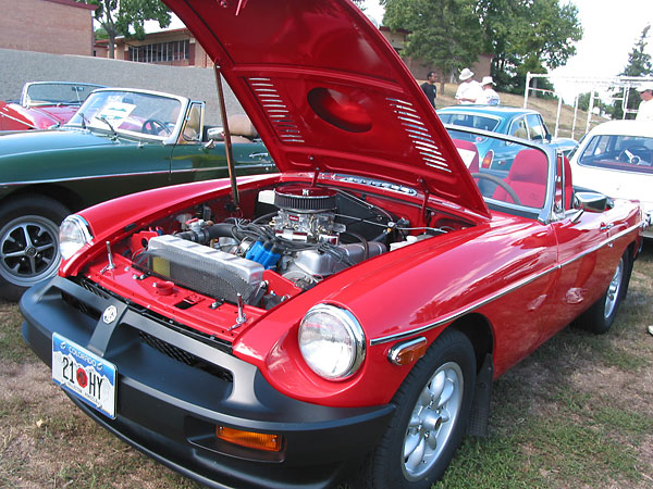

Body: basically stock, with an air dam added. The air dam really helps with airflow to the radiator and also with keeping the nose from lifting at high speeds. The car is very stable at high speeds and feels awesome. Red Mountain Pass is a blast!

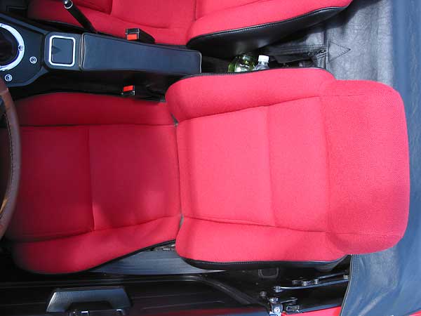

Interior: Eclipse CD1000 stereo head unit with 55W per channel. '85 Fiero seats, with Infinity speakers in the headrests. 2 10" Pioneer subwoofers powered by an Eclipse XA1000 640W amp. XM satelite radio. The stereo system can be heard at 100mph with no problem, even with the top down.

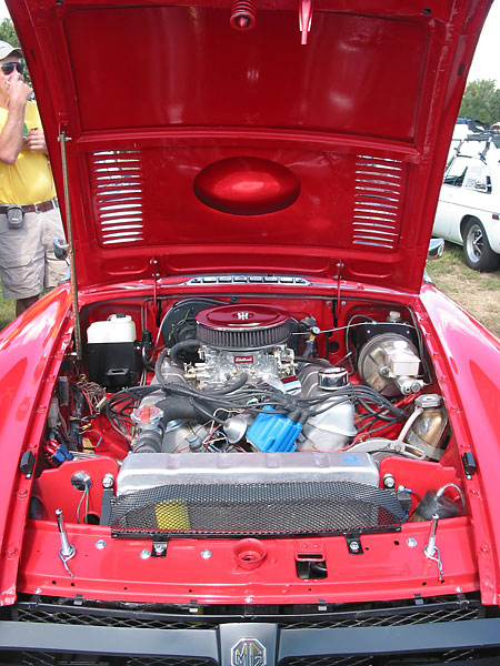

Comments: this car is the MG of my dreams. It is awesome to drive and getting even better. plans for fuel injection and cruise control are in the works after the new clutch and cam. If you are going to do an MGB conversion, get in touch with D&D Fabrications and use a Rover engine if possible. If not a Rover, consider the Olds 215 (to get eight more head bolts.) The biggest problem I've had has been overheating at slow speeds. The aluminum radiator works very well, but I hope the smaller water pump pulley will help even more. (I haven't installed it yet.) If you choose the TE Industries headers, the engine might sit high enough the hood may need a hole. We also needed to cut the transmission tunnel to fit the T5 because of the headers. I like the looks of the hood anyway so no biggy to me. The hood air induction was done by Bryce of Erie CO - very nice piece. Louvers were done by Just Louvers in Denver. The GM "Victory Red" paint was applied by Boyd Customs here in Montrose.

block hugger headers

aluminum radiator
turbo mufflers
dual exhaust
