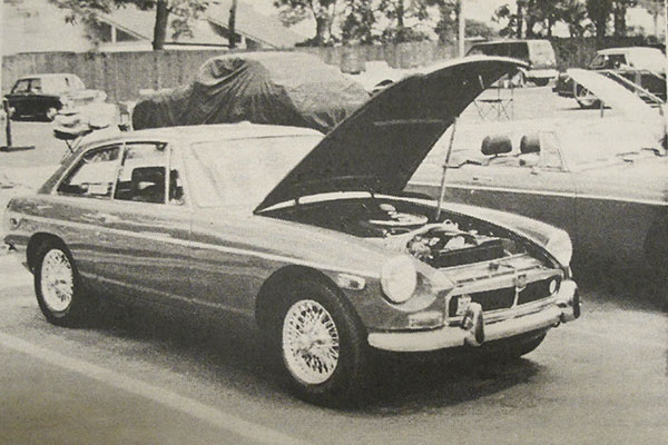

Fred Wastell's GT at the '96 University Motors Summer Party

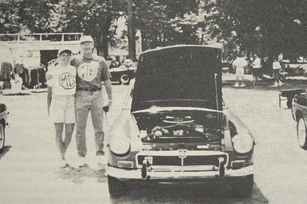

Fred and Diane Wastell with their MG V-8 at the Summer Party
