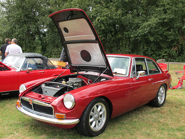

Fred Abel's 1973 MGB-GT with Chevrolet 3.4L V6
Owner: Fred Abel
City: Aberdeen, Washington
Model: 1973 MG MGB-GT
Engine: Chevrolet 3.4L V6
Conversion by: owner

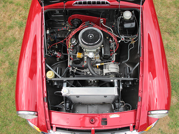

How It Was Done

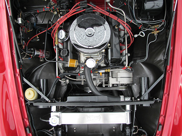

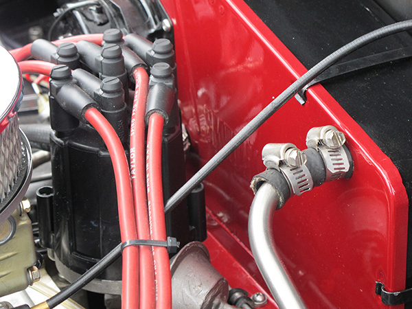

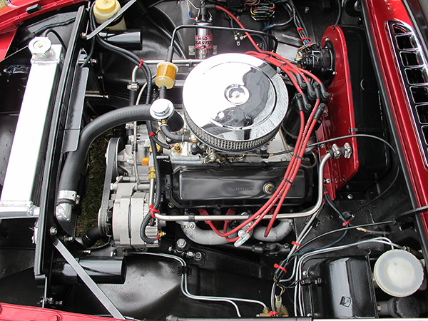

Engine: Chevrolet 3.4L V6 "crate" engine. Edelbrock lower intake manifold. Classic Conversions Engineering upper intake manifold. Holley 390cfm carburetor. Mr Gasket fuel pressure regulator. Delco Remy distributor. MSD Blaster 2 ignition coil. Taylor Spiro-Pro 8mm ignition wires. Classic Conversions Engineering accessory drive system.
Cooling: Wizard aluminum radiator. Electric fan.

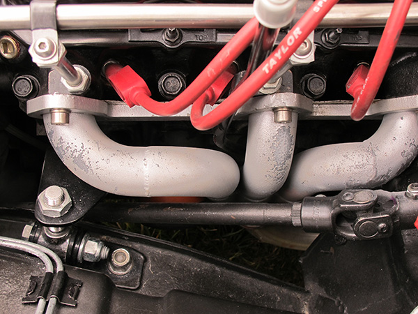

Exhaust: Classic Conversions Engineering headers. Custom 2-into-1 system.
Transmission: Borg-Warner T5 5-speed manual.
Rear End: MG Salisbury axle.
Front Suspension: Moss Motors coilover conversion. Uprated anti-sway bar. Borgeson steering universal joint.
Rear Suspension: stock MGB leaf springs. Converted to telecoping shock absorbers.

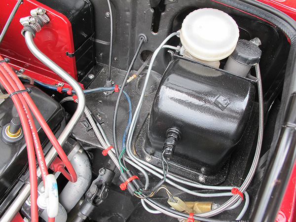

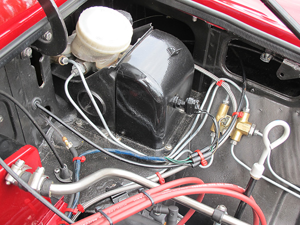

Brakes: (master) stock.

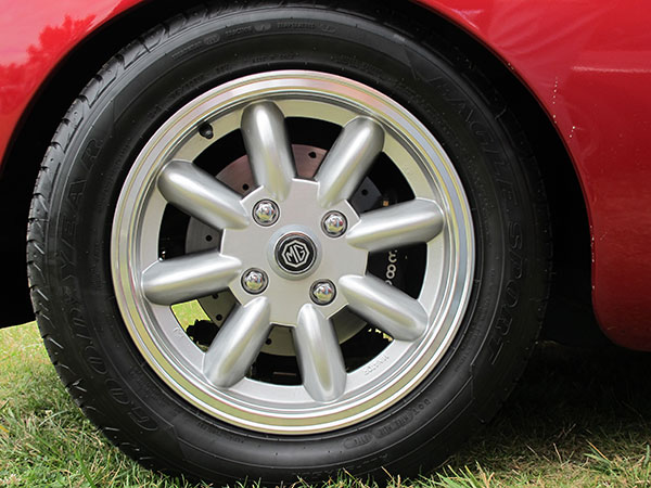

(front) Classic Conversions / Wilwood "Improved Touring" brake kit.
(rear) stock.
Wheels/Tires: Minator (KN Wheels Ltd.) eight spoke aluminum wheels, size 15x5.5J. Goodyear Eagle Sport 195/60R15 tires.
Body: bumper overriders omitted.

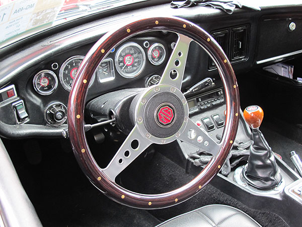

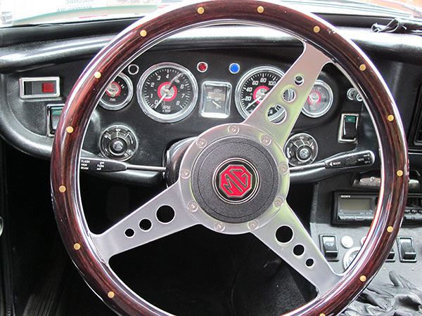

Interior: Tourist Trophy wood steering wheel. Sony AM/FM/cassette stereo radio. Custom upholstery on door caps.
Instruments: Stewart Warner "Power" gauges (left to right) fuel level (E to F), tachometer (0-8000rpm), speedometer (0-160mph), coolant temperature (100-240F). Smith's oil pressure (0-100psi).

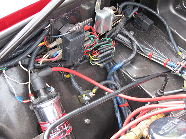

Electrical: Delco alternator. Dual batteries.
Note: 3330 miles on odometer as of the 2016 Portland All British Field Meet.
Chevrolet 3.4L V6 crate engine.
Edelbrock / Classic Conversions intake manifold set-up.
Stock MGB brake master cylinder.

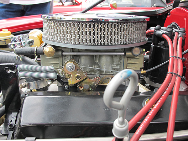

Classic Conversions Engineering headers and motor mounts.

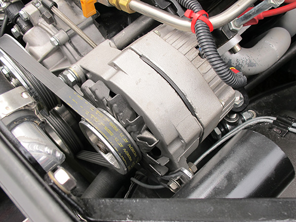

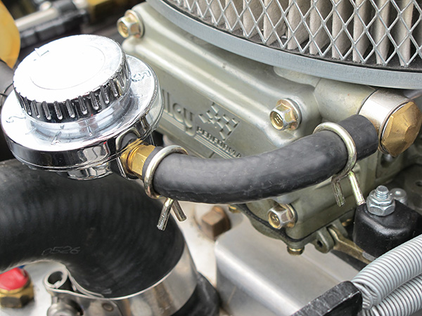

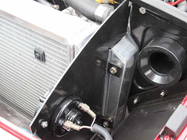

Electric horn mounted on radiator baffle.

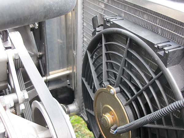

Electric cooling fan.

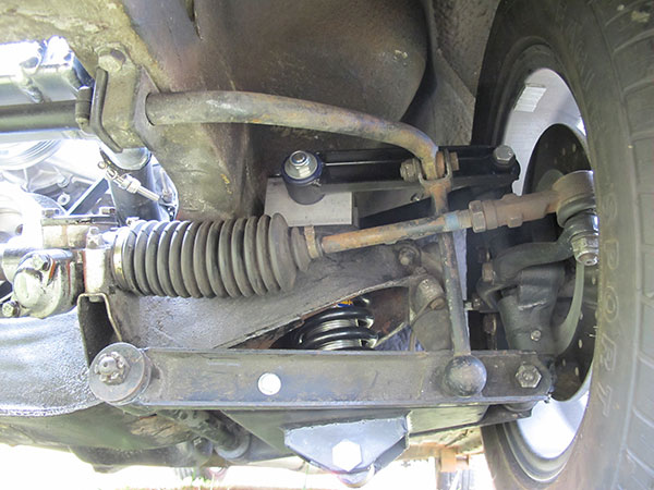

Front Suspension
Moss Motors coilover front suspension kit.

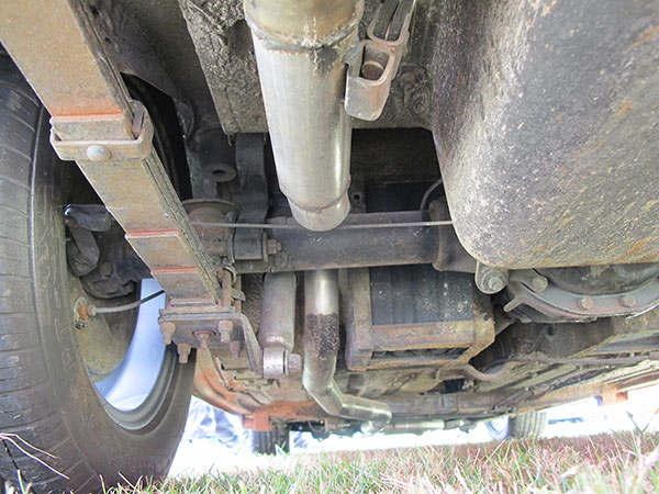

Rear Suspension
MG Salisbury axle.
MG (Dana) "Salisbury" axle.
Telecoping shock absorber conversion kit, installed.
Stewart Warner Power gauges.
Stewart Warner "Power" gauges.

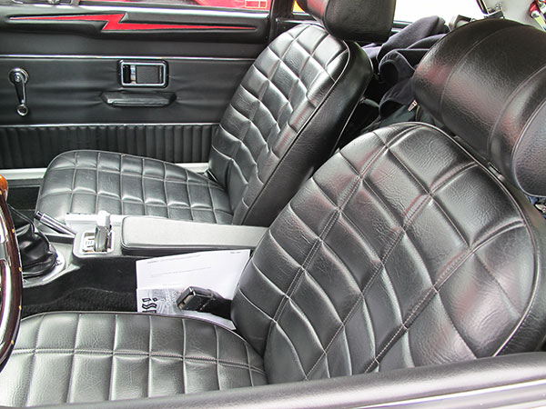

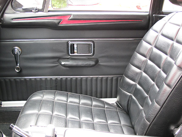

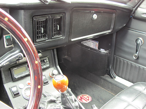

aftermarket seat upholstery

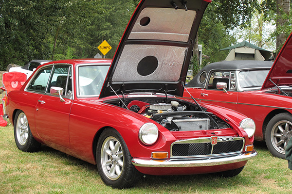

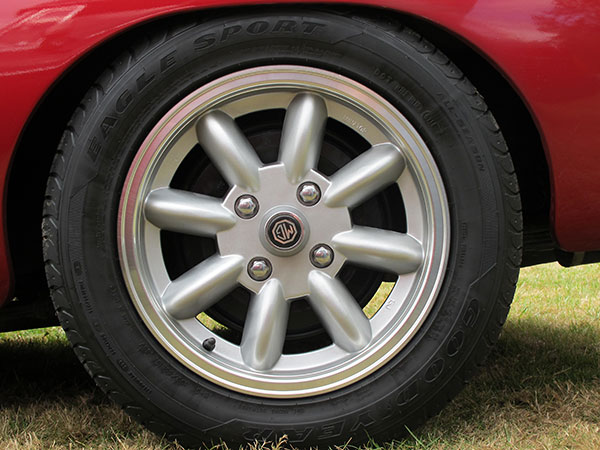

Under bonnet insulation.
