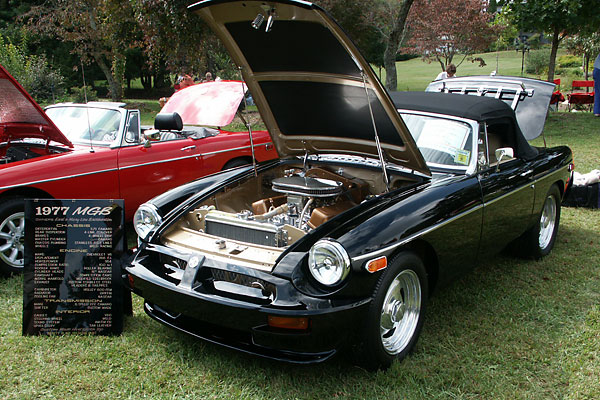

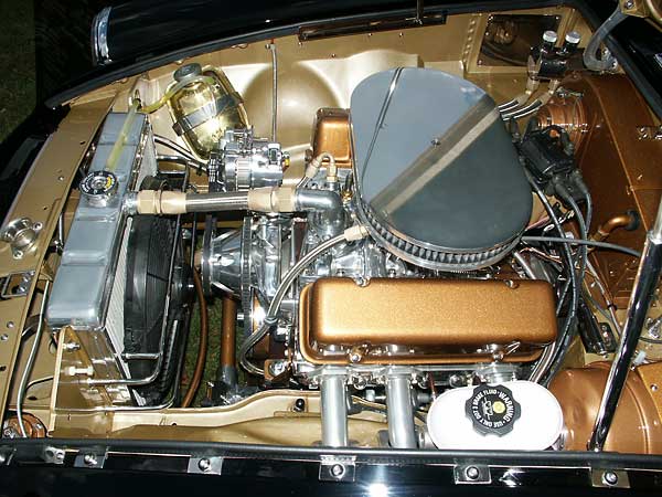

Engine: Chevy 4.3 (266cid) V6, rated at 364hp. 10:1 compression ratio. Eighteen degree NASCAR heads. Roller bearing rocker arms. Competition Cams camshaft.
Induction: Modified Edelbrock intake manifold. Holley 600cfm carburetor.
Cooling: Griffin aluminum radiator. NASCAR electric cooling fan.
Exhaust: Custom-made stainless steel headers and exhaust pipes.

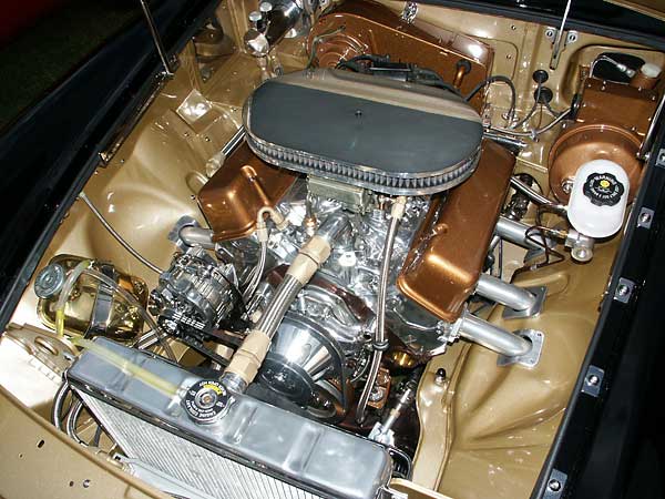

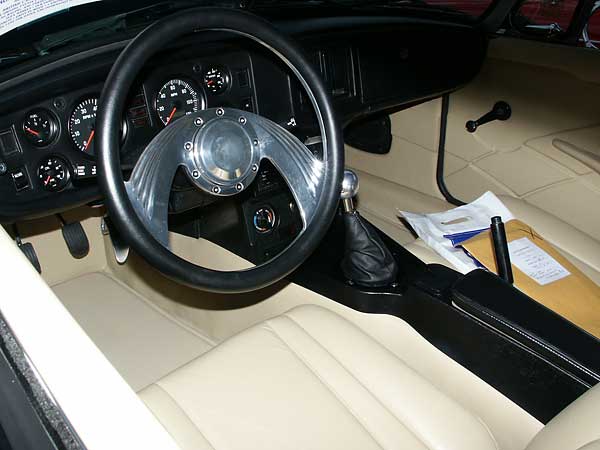

Weld steering wheel. Custom shifter.

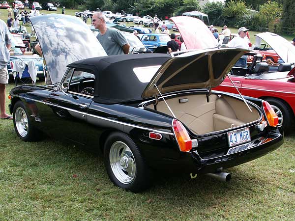

Custom Hartzcloth convertible top. Infinity Black urethane paint.

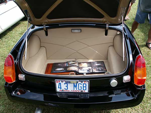

sculpted interior trim panels
