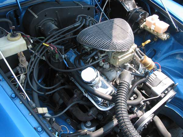

Engine: Chevrolet Camaro 3.4L V6
Conversion completed by: previous owner

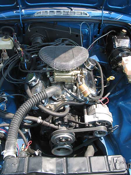

Engine: Chevrolet Camaro 3.4L V6 (installed with Classic Conversions Engineering pulleys, mounts, etc.)
Intake: Offenhauser intake manifold and Holley 390cfm carburetor.
Ignition: stock Chevrolet.
Cooling: stock MGB.
Exhaust: Classic Conversions Engineering 3-into-1 headers. Single muffler.
Transmission: Camaro T5 5-speed.
Clutch: MGB master cylinder. Camaro slave cylinder.
Rear Axle: stock MGB (3.909:1).

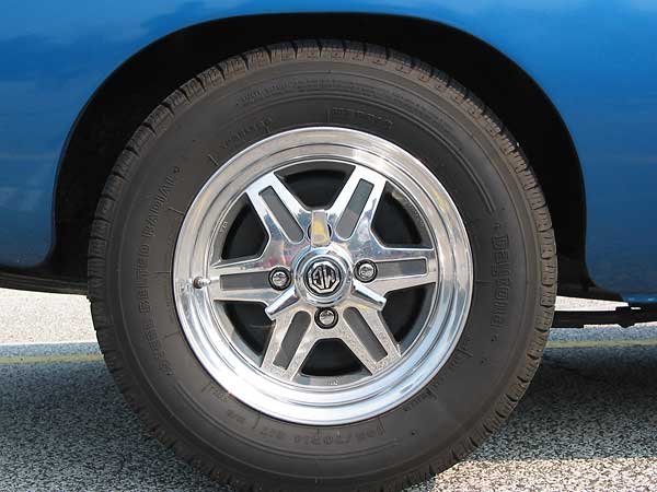

Wheels/Tires: polished Datsun 280Z wheels with 195/70R14 tires. The wheels are held on with modified Weld shouldered wheel nuts.

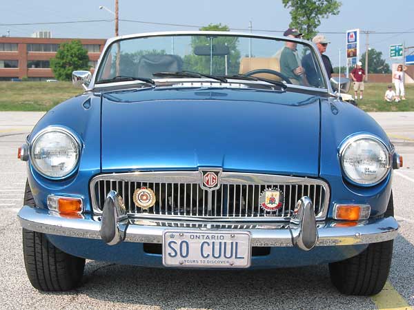

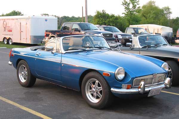

Body: rubber-to-chrome bumper conversion. (Note: The car has a set of Moss rubber-to-chrome-bumper conversion springs installed, but they haven't settled completely yet. They may have to be re-worked to get the car to sit a little lower.) The hood and trunk gas cylinders were supplied by LeBar Co, both work excellently.

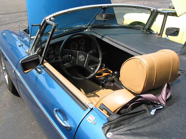

Interior: a Vintique heat/cool unit has been installed under the dash (behind the center console), although air conditioning hasn't been hooked up yet. And, of course, us Canadians have to have our Tim Horton's so I fabricated the dual coffee cup holder from a piece of oak and stained it.
Instruments: VDO gauges.

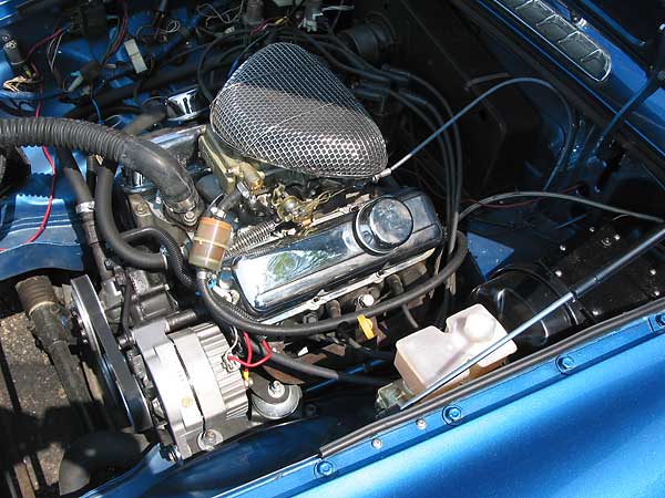

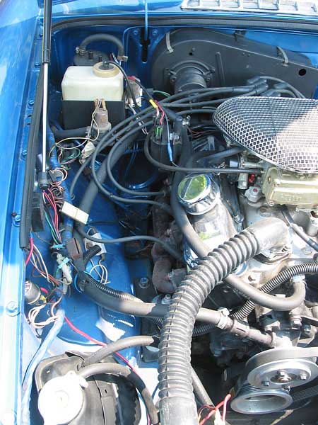

Classic Conversions multi-rib fan belt and pulleys

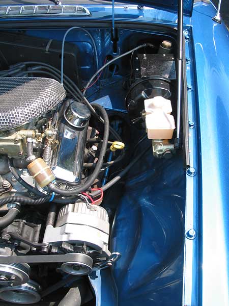

Delco-Remy alternator
Classic Conversions headers
MGB power brakes
Holley carburetor
MGB tonneau cover
Le Bar gas struts hold the hood way up

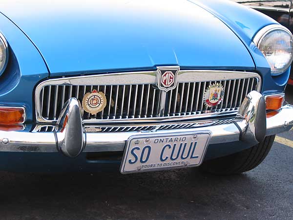

MGB grille

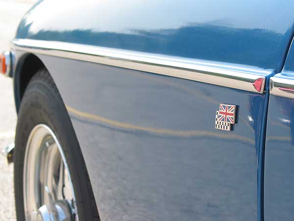

fender badge

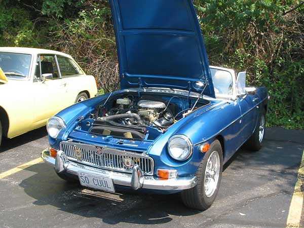

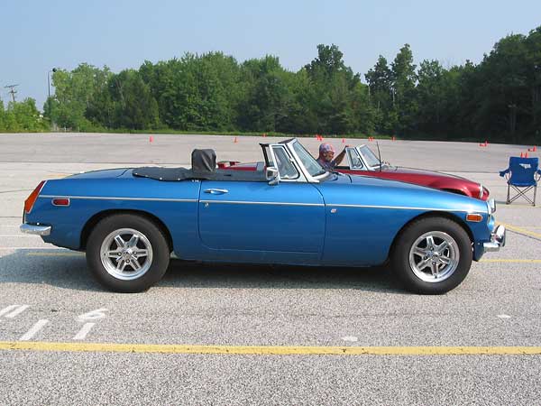

1977 MGB roadster in side view
