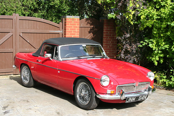

David Tetlow's 1975 MGB Tourer with Rover 3.5 V8 and Power Steering
David and Terry Tetlow, and their 1975 MGB Tourer with Rover 3.5 V8

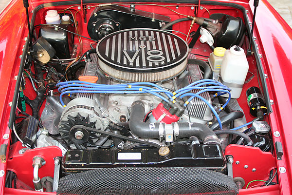

Engine: Rover 3.5L aluminum V8 engine with Edelbrock JWR dual-port intake manifold, Edelbrock/Weber 1404 500cfm carb, and Mallory distributor with Pertronix Ignitor II ignition system. 65A alternator. Approximately 170bhp.

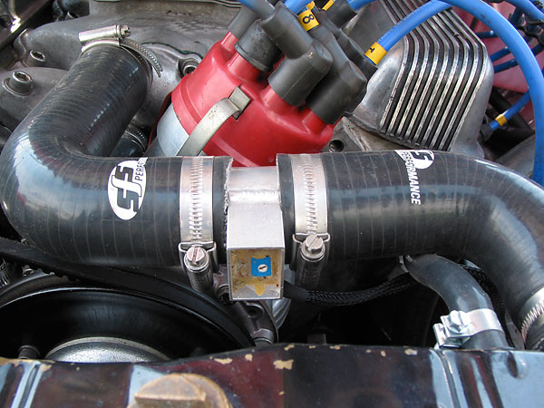

Cooling: standard MGB GT V8 radiator with silicon hoses. Twin electric fans, one pushing and one pulling. (One fan is thermostatically controlled and the other is manually switched.) Stock MGB oil cooler with thermostatic bypass valve.

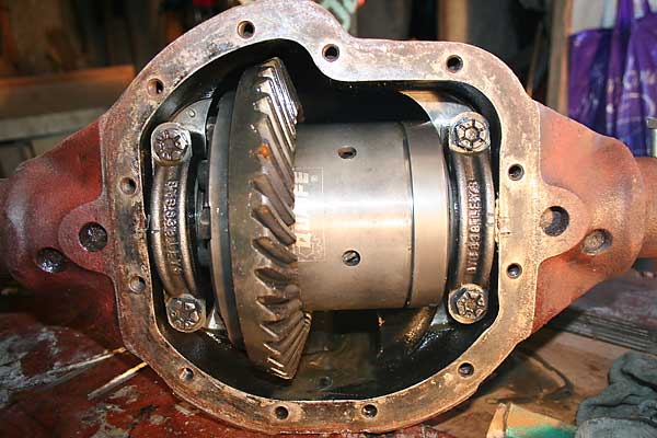

Rear Axle: MG (Salisbury) axle with 3.07:1 final drive ratio and Quaife limited slip differential.

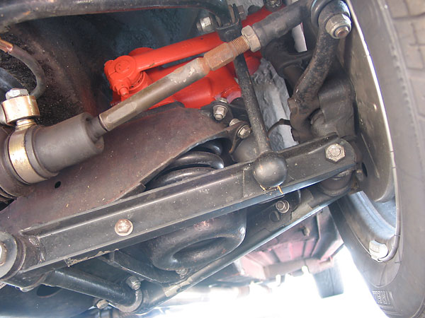

Front Susp.: uprated lever arm dampers with lowered springs. MGOC power steering.

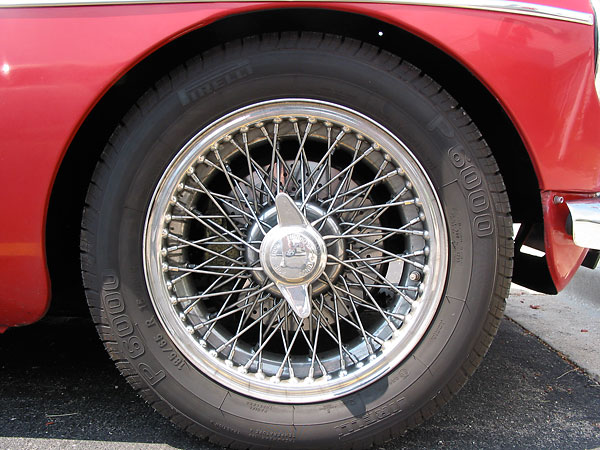

Wheels/Tires: 15" MGC 70-spoke wire wheels with Pirelli 185-65 tires.

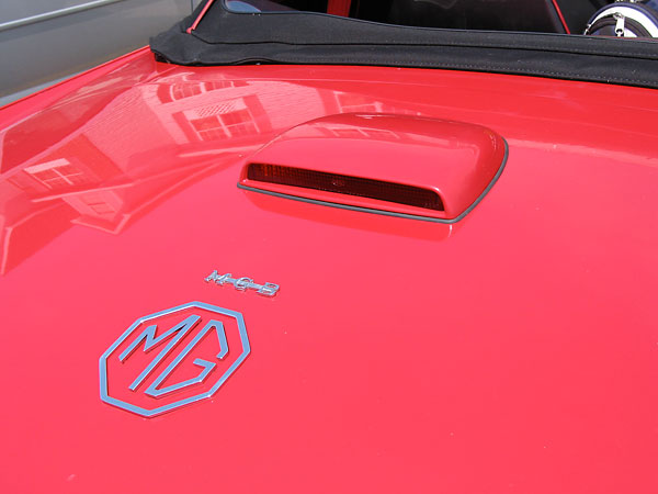

Body: body resprayed in MG Tartan Red (RD9). Hella's New Zealand division made the "Cabrio" cast-aluminum, high-mounted center brake light that's mounted on the boot lid. (It came with a polished aluminum finish.) Three windshield wiper system, per U.S. specification. Interior, boot, and bonnet insulated with Dynamat Extreme. Stainless fuel tank, centrally positioned to accomodate dual tailpipes.

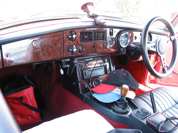

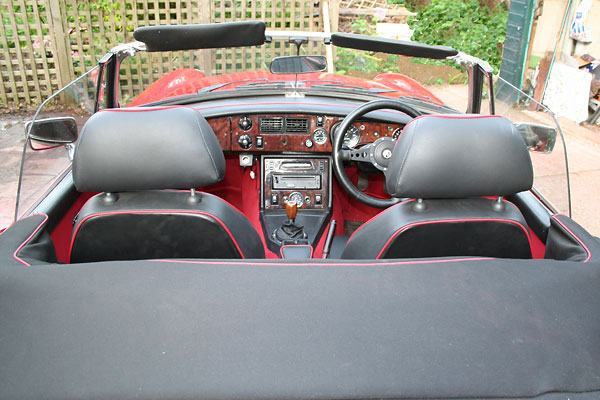

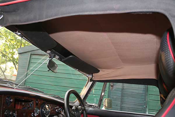

Interior: insulated and lined Happich soft top with zip down window. Heated leather seats. LED gauge lights. CD radio with internal aerial. Electric windows, central electric door locks, and a remotely controlled alarm system.

The cast aluminum air filter cover is one of only 35 made.
The cast aluminum "MGB V8" air filter cover is one of only 35 made.

adjustable thermostatic fan controller
Adjustable thermostatic fan control.

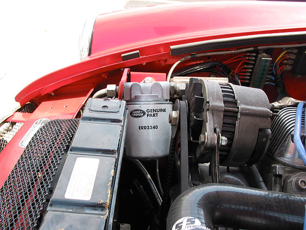

Land Rover Genuine Part ERR3340 oil filter
The remote oil filter is traditionally mounted here on British conversions.

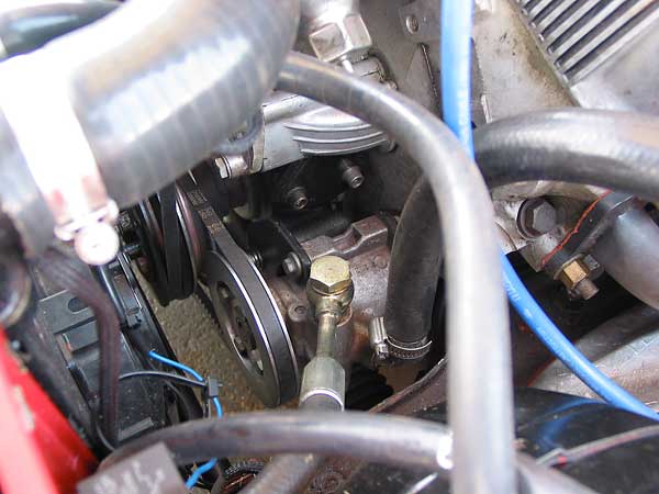

Power steering pump
Power steering pump.

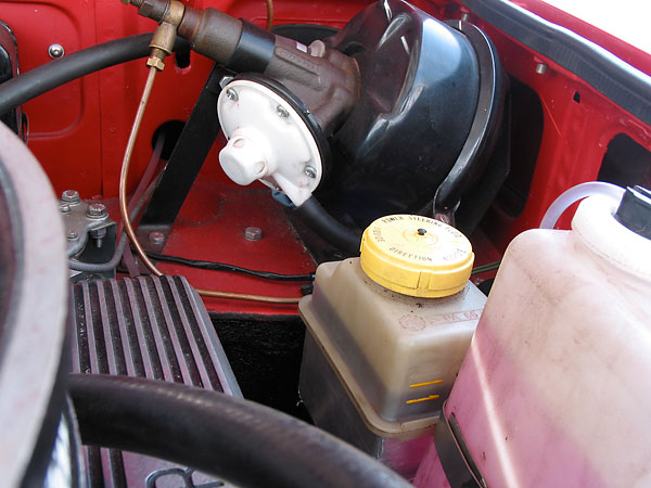

Power steering reservoir (and remote power brake servo)
Power steering reservoir (and remote power brake servo).

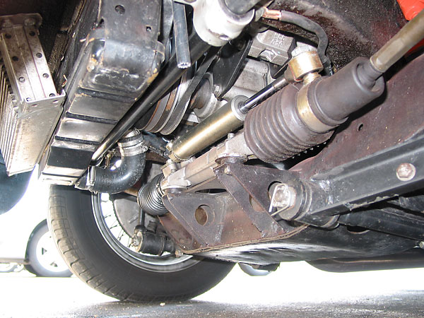

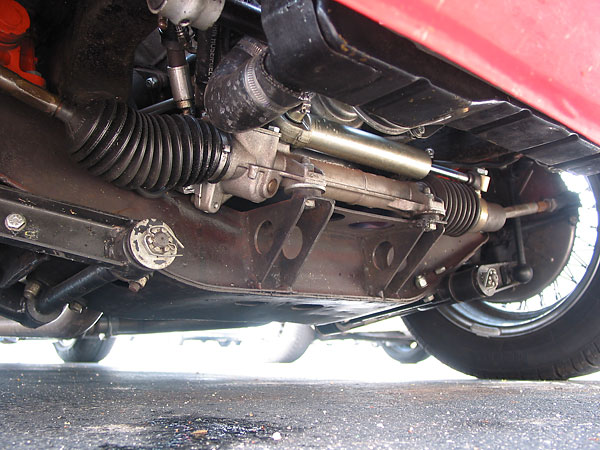

Hydraulically-assisted (power) steering rack
Hydraulically-assisted ("power") steering rack.
Notice that a modified front crossmember with different rack mounts is used.
wheel cut is somewhat reduced
David reports that the MGOC power steering system somewhat increases minimum turning radius.

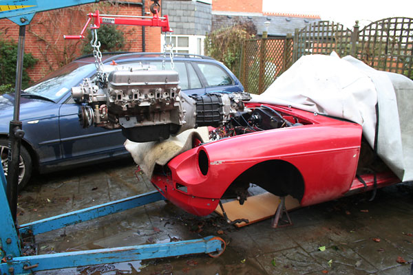

MGB 4-speed gearbox with adapter plate

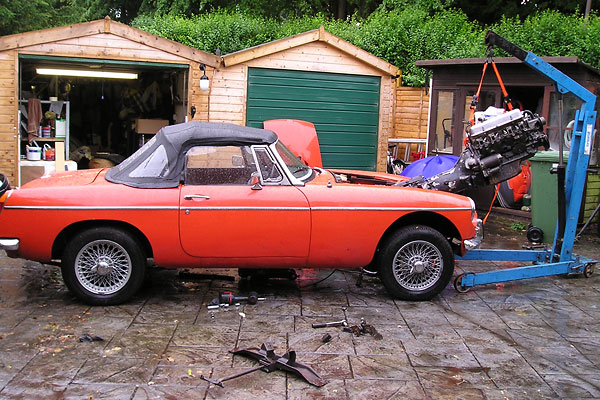

This in-process photo shows an earlier V8 installation being taken apart.
The earlier conversion featured an MGB 4-speed gearbox with adapter plate.

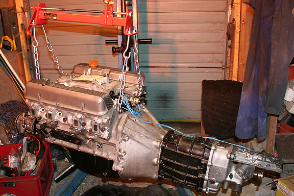

LT77 5-speed manual. Borg and Beck MG RV8 clutch. 3 inch driveshaft.
This photo shows the rebuilt Rover engine and the newer, stronger Rover LT77 5-speed.

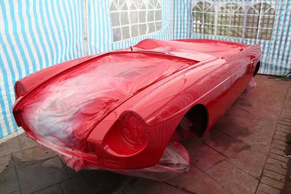

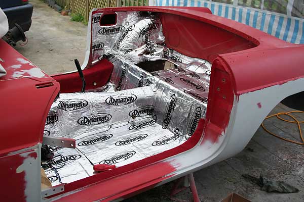

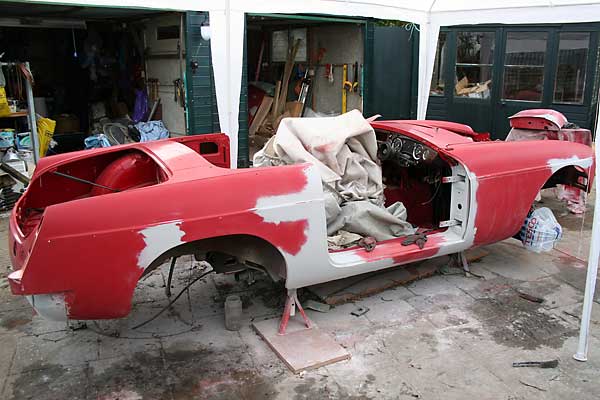

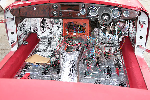

Preparing for painting.
Dynamat Extreme sound deadening material.
Dynamat Xtreme is a noise deadening material (elastomeric butyl) covered with a
protective layer of aluminum foil for protection and heat shielding properties.
Rewiring in process.

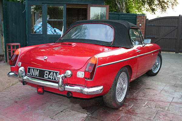

Body resprayed in MG Tartan Red

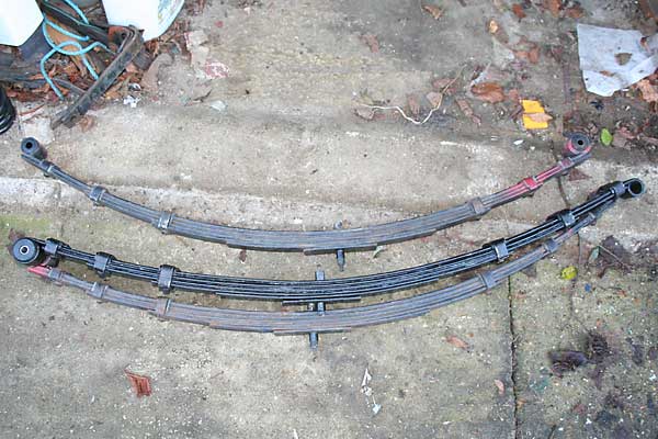

Reverse-eye leaf springs have been used to lower the car's ride height.
"Reverse-eye" leaf springs have been used to lower the car's ride height.
MG (Salisbury) axle, with 3.07:1 gears and Quaife limited slip differential substituted.

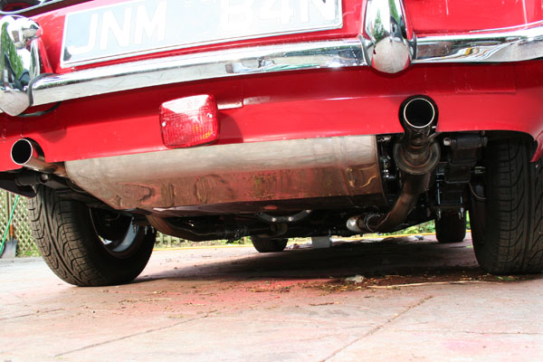

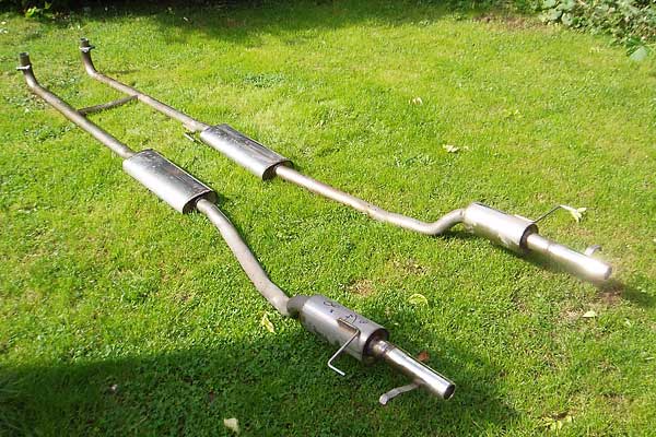

Stainless steel twin exhaust all the way back, with crossover pipe.
Stainless steel twin exhaust system, all the way back, with crossover pipe.

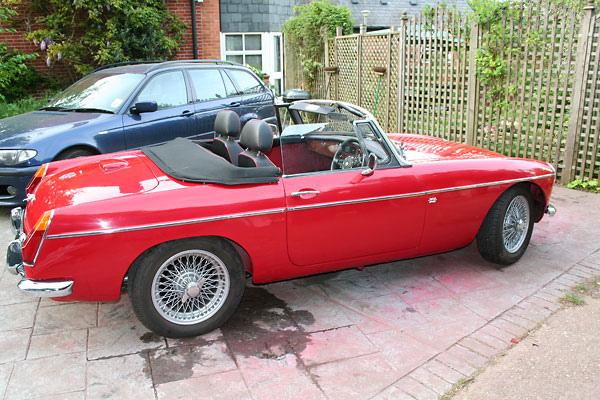

glamour shot
wood veneer dashboard trim

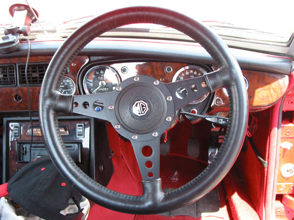

leather steering wheel
15 inch MGC 70-spoke wire wheels with Pirelli 185-65 tires.

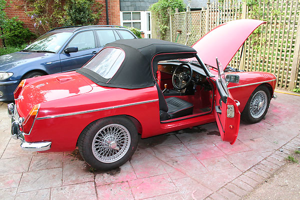

Insulated and lined Happich soft top with zip down window.
Insulated and lined Happich soft top with zip down rear window.
red piping on the Happich convertible top, to match the seats
The low-mounted center light is for foggy conditions.
Hella's New Zealand division made the Cabrio cast-aluminum, high-mounted center brake light.
Hella's New Zealand division made the "Cabrio" cast-aluminum, high-mounted center brake light.
Hella Cabrio third brake light

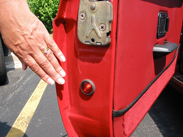

door jam safety lamps
Terry shows us a nice additional safety feature - and her brand new wedding ring!
MGC (15") 70-spoke wire wheels with Pirelli 185-65 tires.
