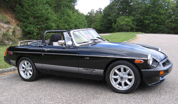

Dave Kirkman's 1980 MGB-LE with Ford 302/342 Stroker
Owner: David Kirkman
BritishV8 UserID: Kirkmanmgbv8
City: Indianapolis IN
Model: 1980 MGB-LE
Engine: Ford 302/342 Stroker
Conversion by: Mantell Motorsport

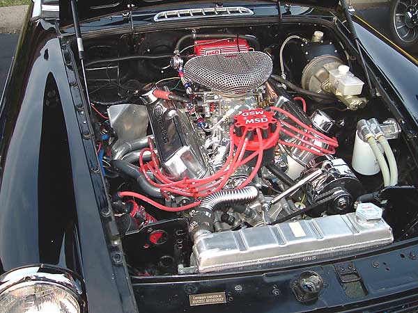

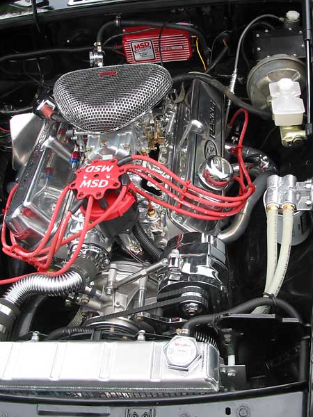

Engine: Ford 302/342 stroker (M-6007-A342 5.65 L). Edlebrock RPM Air Gap intake manifold and Holley Street Avenger 650cfm 4-barrel carburetor. Ford GTX40X heads. Ford Racing F303 camshaft. MSD ("Ford V8 302", model 8582) distributor, Blaster 2 coil, and multiple spark ignition controller.

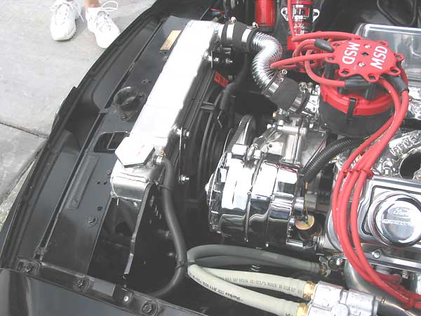

Cooling: Griffin aluminum radiator (turned on its side). Flexalite cooling fan and shroud.

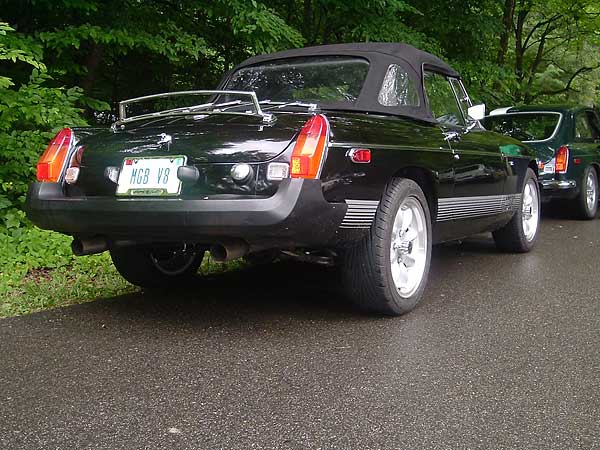

Exhaust: Coyote Engineering 4-into-1, through-the-fender, Jet Hot coated headers into custom dual exhaust system. (Note: Coyote Engineering's header business has now been purchased by Fast Cars Inc.) Glassback (2.5 inch) stainless steel mufflers from Summit Racing.
Transmission: Tremac T5 Ford Racing Super Duty 5-speed with 0.63:1 overdrive. Ford Racing heavy duty clutch. McLeod HTOB. Custom driveshaft.

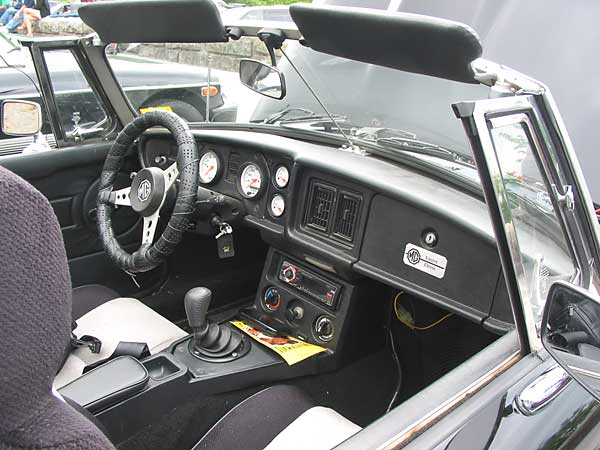

Electrical: AutoMeter gauges. Sony FM/CD stereo with 300 Watt amplifier.

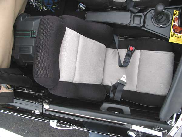

Other: roll bar from MGOC (M.G. Owners Club) in UK. Fiero seats with custom upholstery. (Would like a set of Mr Mike's seat covers for Christmas...) RCI shoulder harnesses. Moss Motors windbreaker. Tanks, Inc. fuel tank. Carter electric fuel pump.
Weight: 2287 pounds.
Performance: the speedometer goes to 160... Hold on!!!
Completed: April 2006. Driven over 6000 miles as of March 2009.

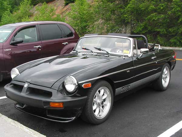

Comments: a plastic model of a 302 motor was helpful for working out engine installation details. I sold a V8 bushed front-end from Eric Jones and I replaced it with the Fast Cars front-end. I formed a radiator shroud from aluminum plating. Holes were cut in the fender wells to allow for exhaust header clearance. The original MGB bonnet was modified with a welded Mitsubishi Eclipse bubble. 20 louvres have been added (although these are a recent addition and aren't shown in the photos.)
Edlebrock RPM Air Gap intake manifold and Holley 4 barrel carburetor.

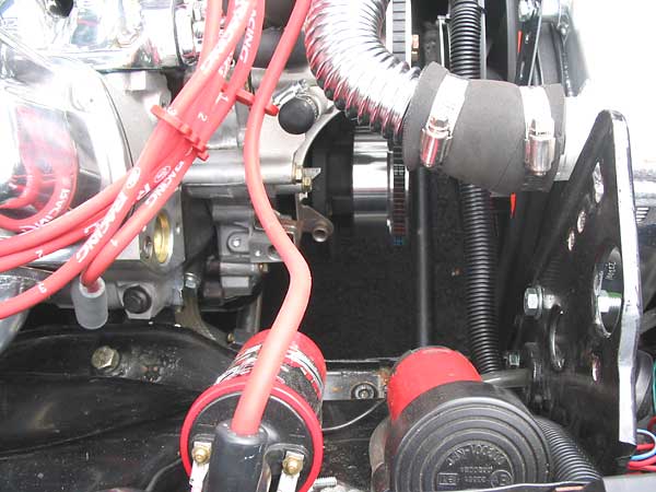

MSD Ford V8 302 (8582) distributor and multiple spark ignition controller
MSD Ford V8 302 (model 8582) distributor, and multiple spark ignition controller.
Griffin aluminum radiator.
MSD Blaster 2 coil
Autometer gauges
Fiero seats with custom upholstery. RCI Shoulder harnesses.
Panasport 16x7 wheels with Goodyear Eagle GT tires.
distinctive MGB-LE side-stripe decals
