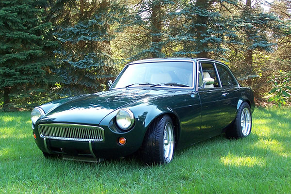

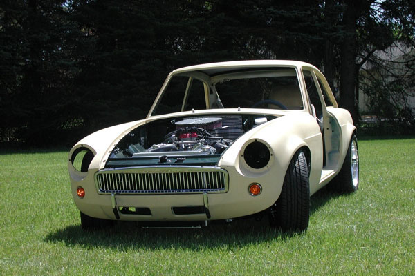

Dan Masters' 1974 MGB-GT with Ford 302 V8
Dan Masters' 1974 MGB-GT with Ford 302 V8, by Fast Cars Inc.
Owner: Dan Masters
BritishV8 UserID: danmas
City: Alcoa, TN
Model: 1974 MGB-GT
Engine: Ford 302 V8
Built by: Fast Cars Inc.
Paint and Body by: Don Marcott
Engine: Ford 302 crate motor (M-6007-B51), GT-40 aluminum cylinder heads, Ford hydraulic roller cam (M-6250-E303). Edelbrock Pro-Flo multiport fuel injection, Edelbrock/Magneti Marelli computerized EFI control, Power Master hi-torque starter (9503). Billet Specialties "TruTrac" pulley system.
Cooling: Fast Cars aluminum cross-flow radiator. Flex-a-lite 118 electric fan.
Exhaust: all stainless-steel system featuring Fast Cars block hugger headers, dual chambered mufflers, and a cross-over pipe.
Transmission: Tremec "Super T5", with 0.73:1 fifth gear ratio. Ford MotorSport clutch. Howe hydraulic throw-out bearing. Stock MGB master cylinder.
Rear Axle: Ford 8" with limited slip differential and 3.25:1 final drive ratio.

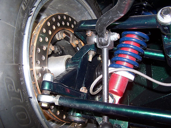

Front Susp.: Fast Cars IFS.
Rear Susp.: Fast Cars three-link.
Brakes: stock MGB master cylinder. Wilwood discs on all four corners.
Wheels/Tires: Billet Specialties "Street Lite" wheels (15x7 front and 15x8 rear) with Dunlop "G/T Qualifier" tires (195/60 front and 215/60 rear).
Electrical: custom wiring harness featuring Advance Auto-Wire components, 15 relays, and 20 fuses. Classic Instruments gauges. Kenwood stereo receiver. 6.25" round speakers and remote mount CD changer.
Body: All body seams filled. Recessed parking lamps in front from Factory Five Racing (#10621). Side marker and back up lights removed. Gas filler moved to right rear fender. Fenders flared using flares from a Dodge Omni. Underside and interior sprayed with "Lizard Skin" sound and heat insulation. Bumpers removed and replaced with chrome "nerf" bars. Door locks removed. Side chrome strips removed. Front and rear valances modified. Painted with 2003 Toyota Prius "Electric Green Mica" metallic paint.

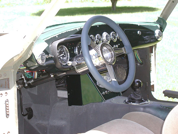

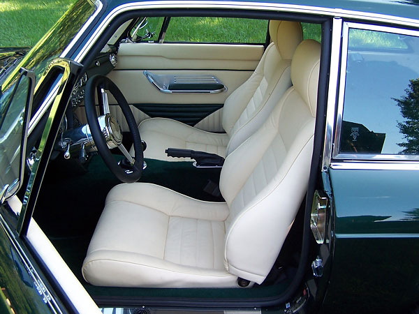

Interior: Fiero seats with Mr Mike "Italian Style" seat covers in "Lamborghini" (cream) colored leather. Electric seat heaters. Modified Mk1-MGB (steel) dashboard. Flaming River (GM style) tilt steering column. Power windows from Moss motors (#299-000). Power door locks. Cruise control. Air conditioning, featuring Vintage Air "Gen II Mini" under-dash unit. Rear seat removed and rear deck enlarged and flattened. Cherry wood floor hinged in the middle and fitted with custom removeable carpet covering. Big Al's Carponents "Marque" arm rests/door pulls on custom door panels.
Performance: Fast. VERY fast. No hard data yet, but it will definitely pin you back in the seat. Corners like the proverbial slot car. I couldn't believe how well it sticks to the road compared to stock (or anything else I've driven, for that matter). Stops just as well. On its maiden trip from Michigan (650 miles), I got over 25 mpg at 70-80 mph.
Completed: July 2008. (Approximately 1000 miles driven as of August 2008.)
Comments: I waited 52 years to get this, ever since I "discovered" cars at sixteen. Don't wait that long. At 68, it's a little bit harder to get into and out of now, but once behind the wheel it's every bit as much fun as I had ever hoped it would be.

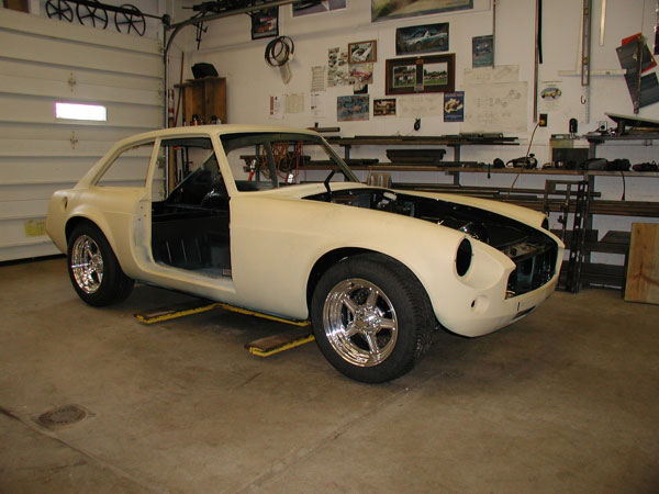

How It Was Done:

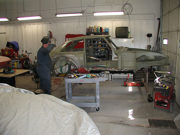

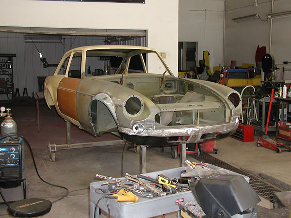

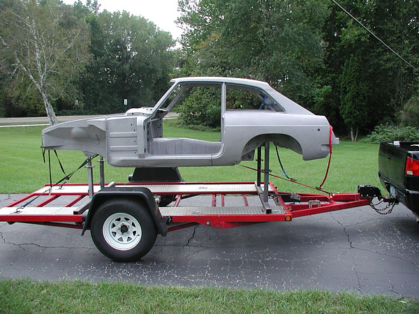

Preparing An MGB-GT Bodyshell
before picture
The "Before Picture"
stipped and primed
Stripped-down and ready for the process to get started.

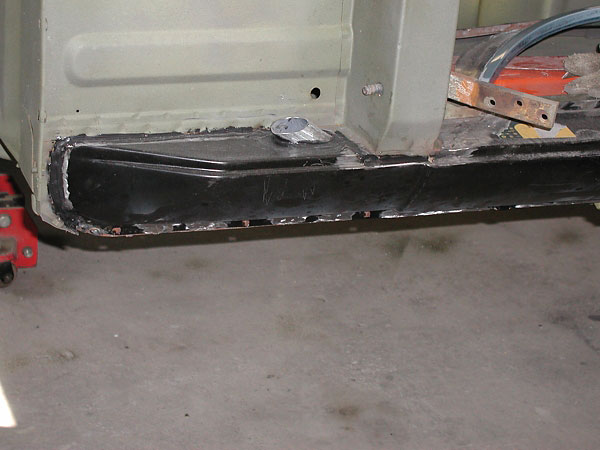

rust repairs
As is typical, various rust repairs were necessary. Wiring routing provisions were added too.

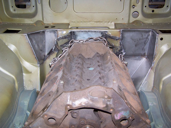

Making Room For a Small Block Ford V8

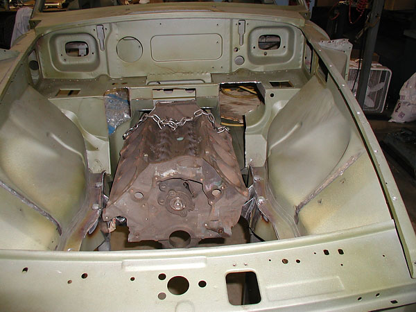

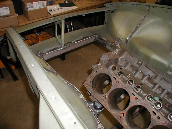

trial fitting a Ford engine block
Trial fitting a small block Ford engine block. (Note seam welding forward and aft of new motor mounts.)

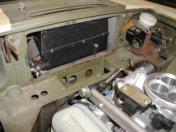

Firewall modifications to accomodate the small block Ford engine.
driver side footbox modification
passenger side footbox modification
firewall modifications for air conditioning
Firewall modifications for the air conditioning system.

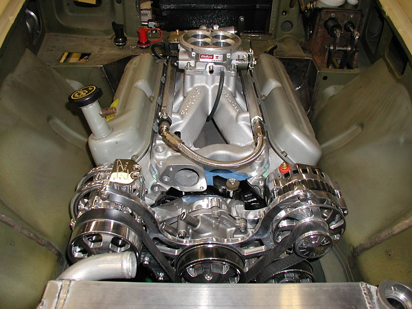

Developing the Engine Installation
Trial installation of engine driven accessories and their pulley system.

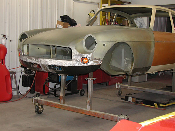

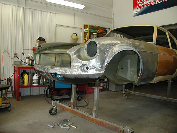

Bodywork: Continuing Where Pininfarina Stopped

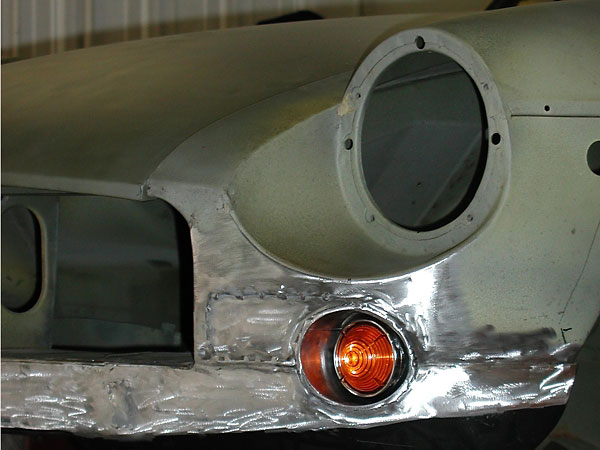

Cobra-style recessed parking lamps (Factory Five Racing part number 10621.)
Blended-in steel front valance.
Blended-in steel front valance. (Notice that it's been cut and widened in the middle.)

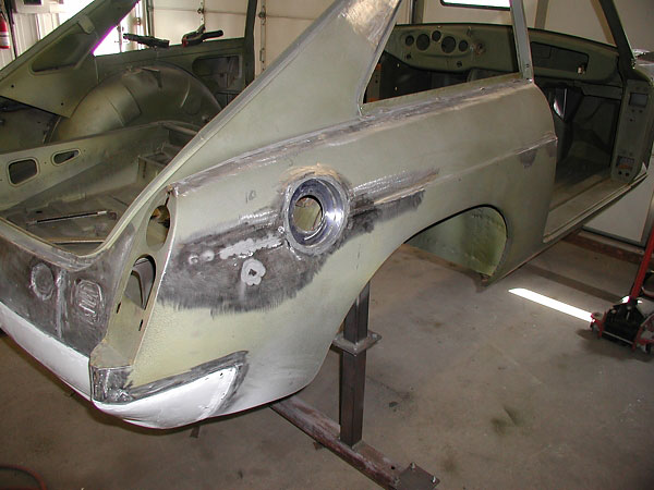

Fuel filler relocated and recessed into quarterpanel.

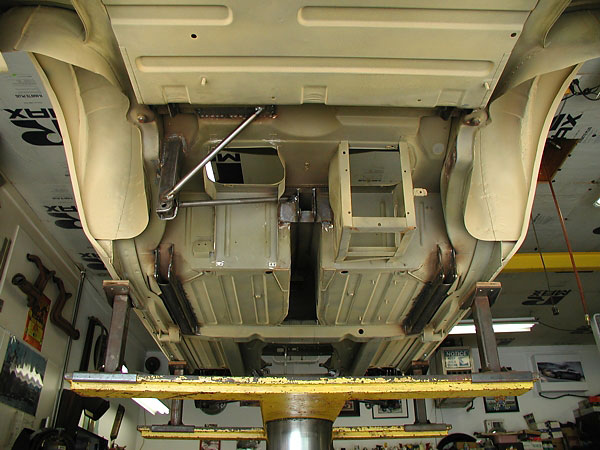

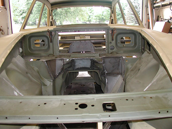

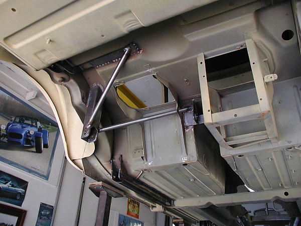

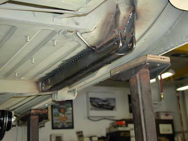

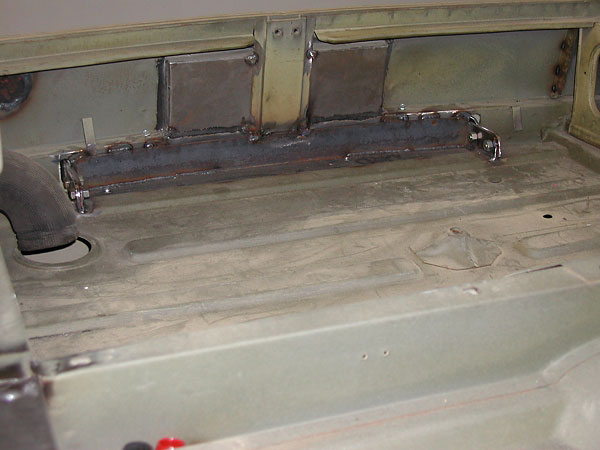

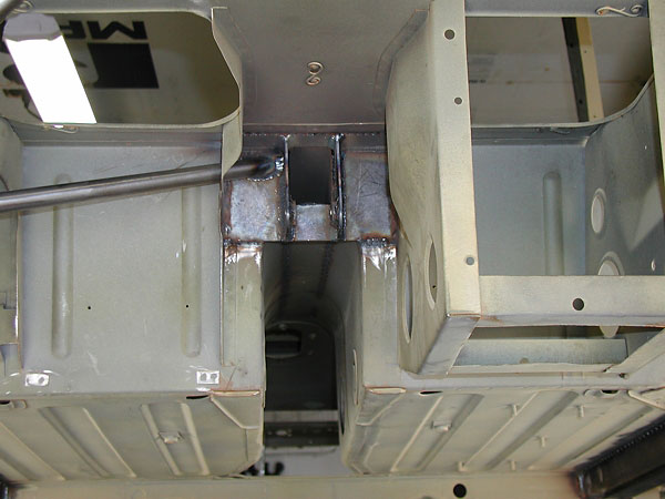

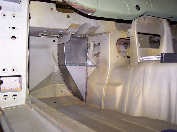

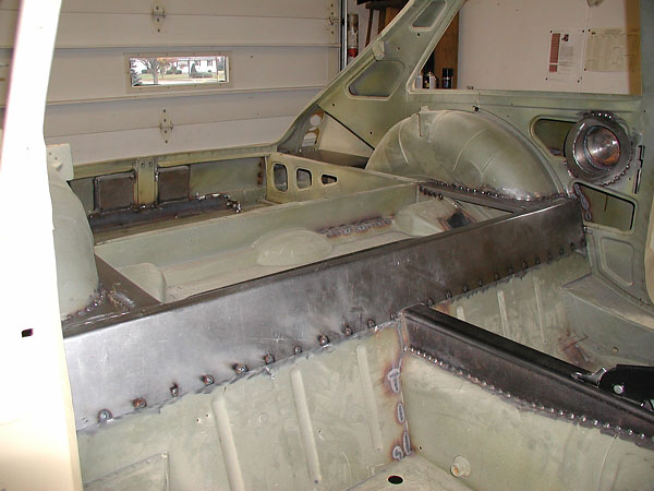

Bodyshell Modifications for the Rear Suspension
Reinforced rear suspension pick-ups.
Panhard rod bracket.
Panhard rod bracket. Note that the driver side battery box has been cut away.
The bracket for the third link of the Fast Cars three-link rear suspension.
Complete overview of all the bodyshell modifications required for the rear suspension.

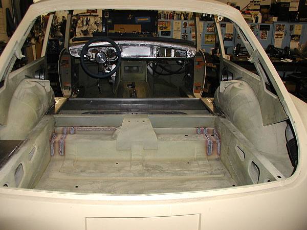

Bodyshell Modifications for the Interior

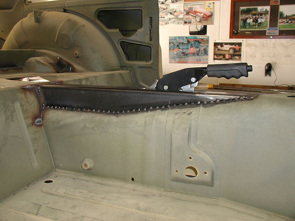

Parking brake lever.
Parking brake lever mounting structure. (Note: this also strengthens the rear suspension mount.)

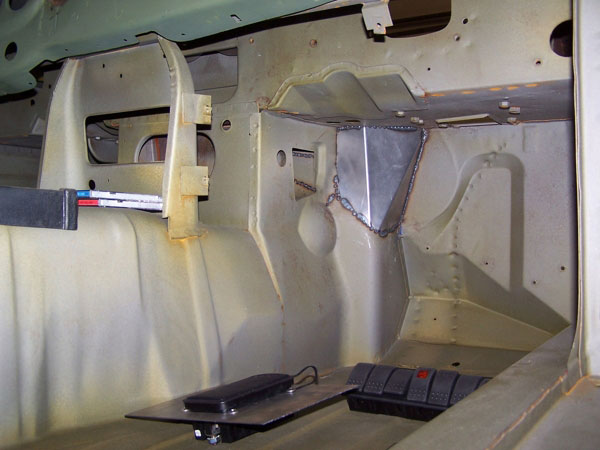

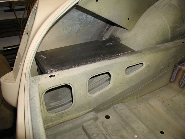

Rear storage compartment (above the battery box).
Rear storage compartment (above the battery box). Note also the driver-side speaker mount.

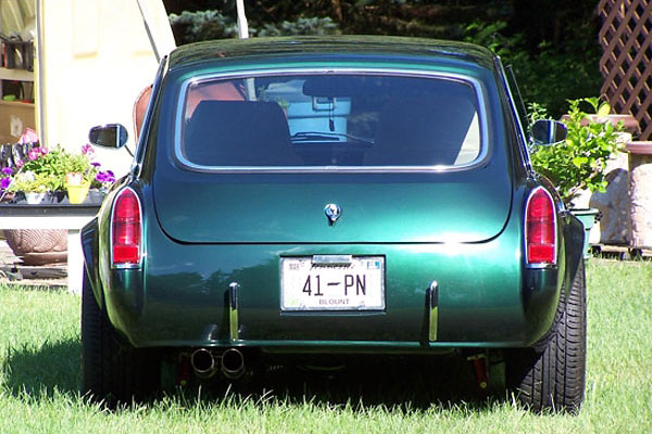

frenched-in license plate
New metal has been added where the frenched-in license plate goes.
Under the license plate, you can see nerf bar attachment details.

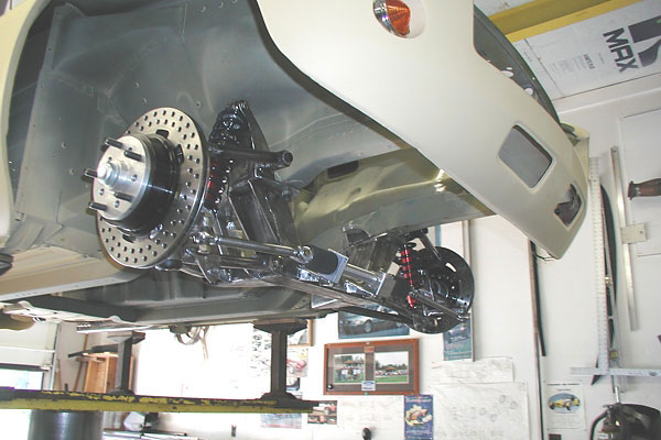

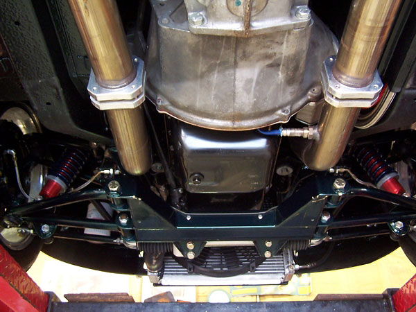

Suspension and Exhaust Trial Installations

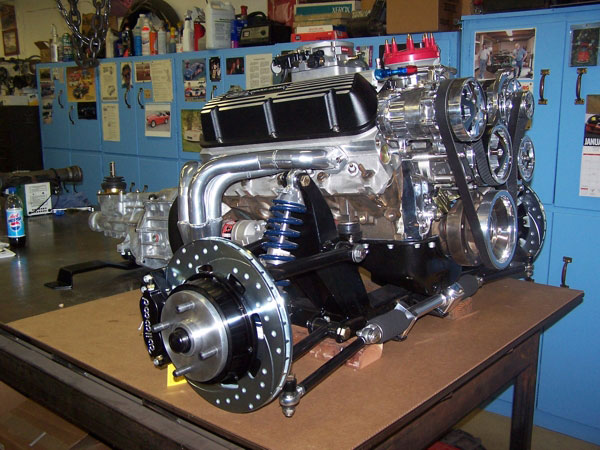

Trial installation of the Fast Cars front suspension.
Fast Cars MGB front suspension
(Skipping ahead for a moment... this is what the front suspension will ultimately look like.)

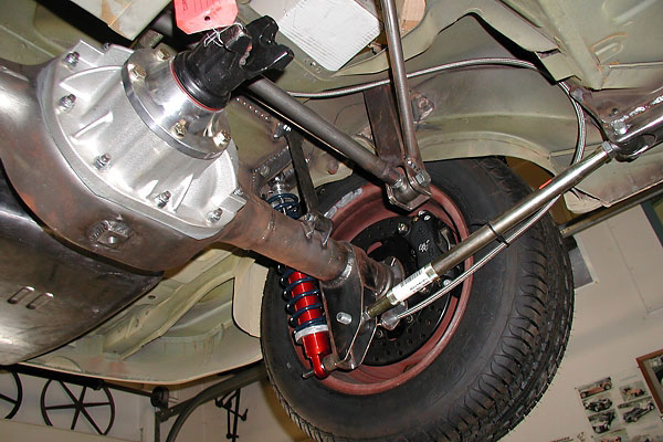

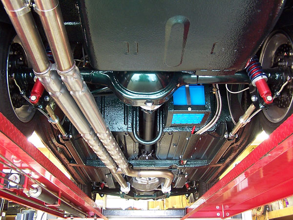

Trial installation of the Fast Cars 3-link rear suspension.

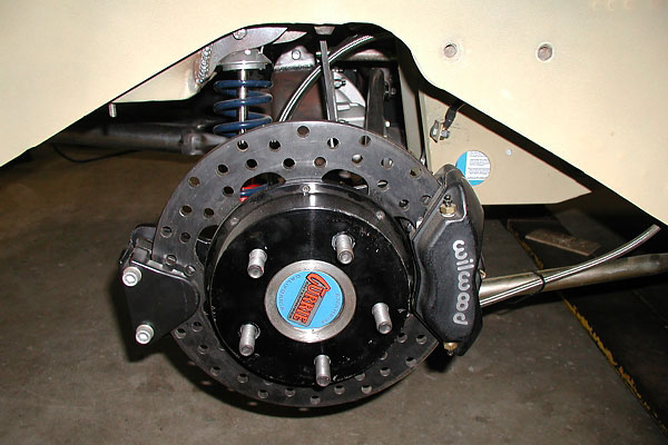

This view shows the Currie/Ford 8" rear axle with Wilwood brakes. (Second caliper is for parking.)

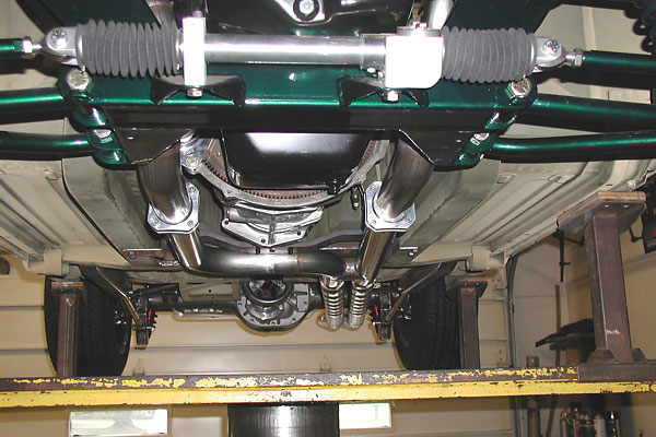

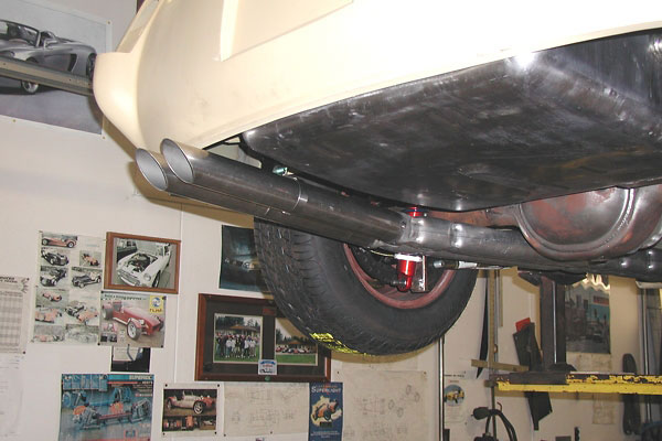

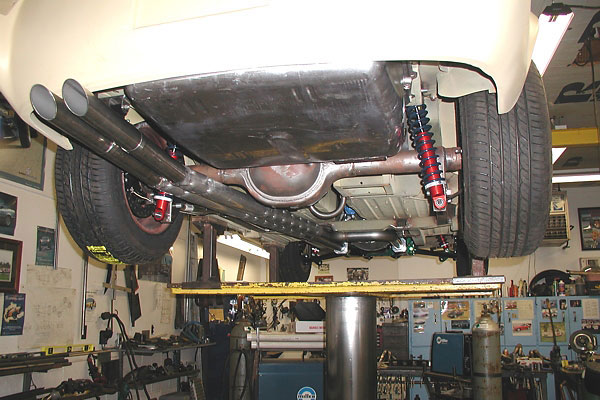

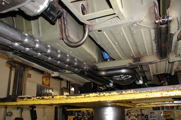

Overview of the custom stainless steel exhaust system.
Overview of the custom stainless steel exhaust system, viewed from the front.
dual exhaust system
It's a dual exhaust system with a crossover pipe (as shown in the foreground here.)

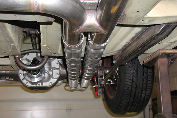

Chambered mufflers.
Chambered mufflers provide a throaty growl.
The tailpipes are routed straight across under the rear axle.
Both tailpipes exit on the driver side
Both tailpipes exit on the driver side, so the fuel tank sits in the stock location.
A look at the completed exhaust system...

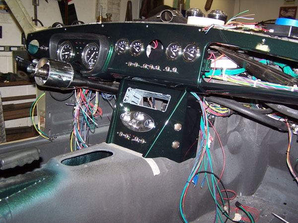

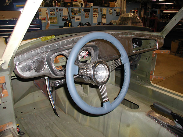

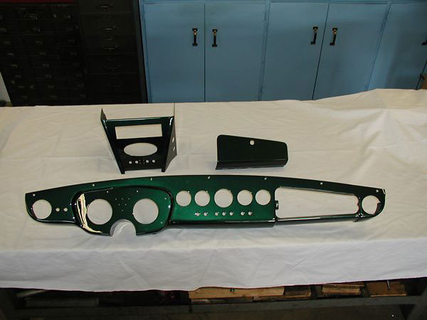

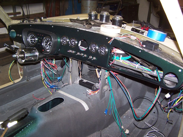

Electrical Wiring and Dashboard Assembly
stripped MGB steel dashboard
Stripped down, first generation (steel) MGB dashboard.

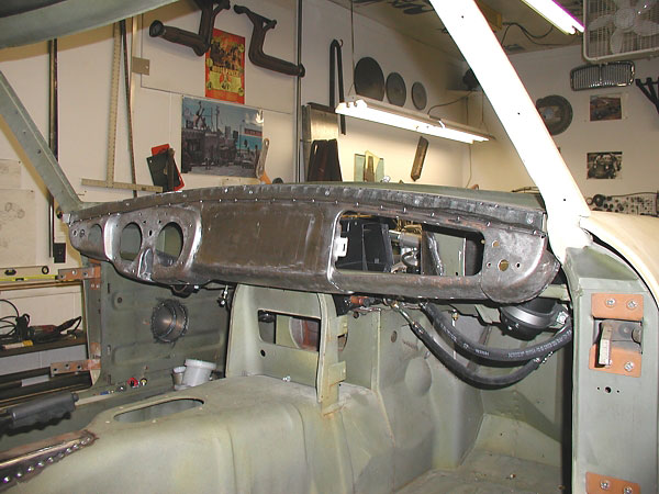

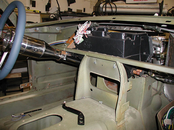

Vintage Air brand Generation II Mini under-dash air conditioning unit
Vintage Air brand Generation II Mini under-dash air conditioning unit.
Various holes in the original dash were filled-in to make room for air conditioning vents.

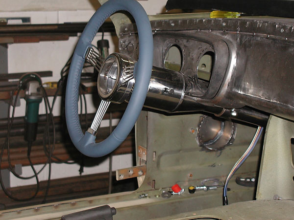

Flaming River brand (GM-style) tilt steering column.

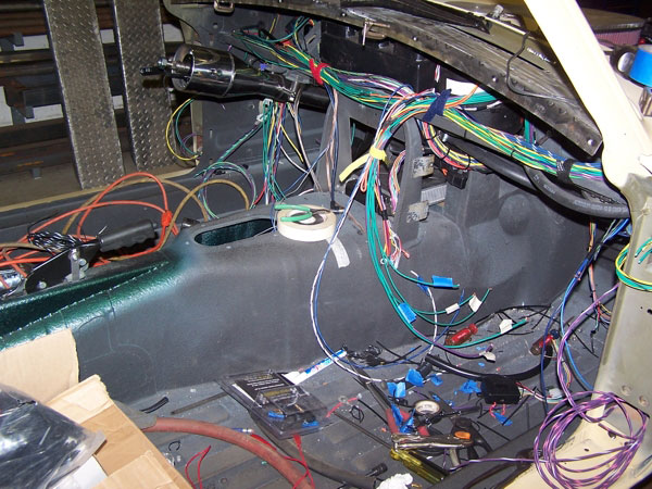

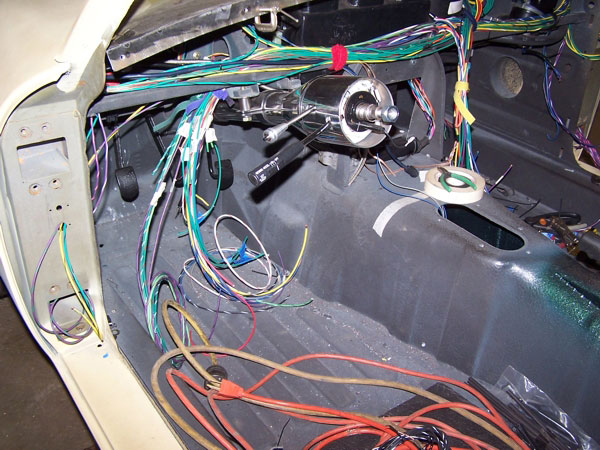

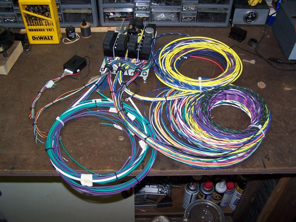

Advance Auto-Wire brand wiring system, with 15 relays and 20 fuses.
Advance Auto Wire produces excellent wiring systems
Laying in the Advance Auto-Wire wiring harness.
Laying in the Advance Auto-Wire wiring harness...

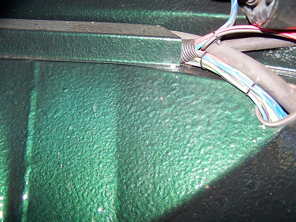

The car's underside and interior were sprayed with Lizard Skin sound and heat insulation.
The car's underside and interior were sprayed with "Lizard Skin" sound and heat insulation.

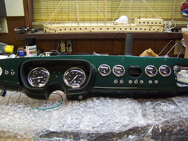

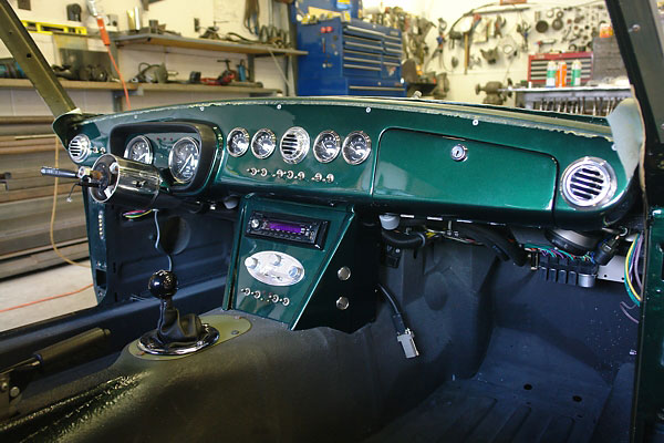

Dashboard and center control console were painted body color.

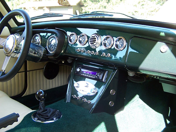

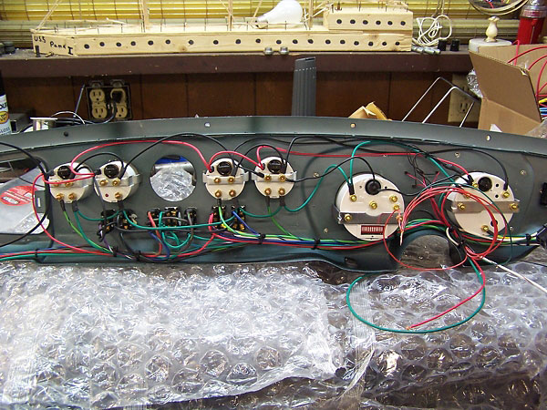

Classic Instruments brand gauges.
dashboard wiring

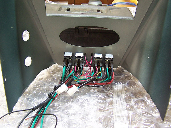

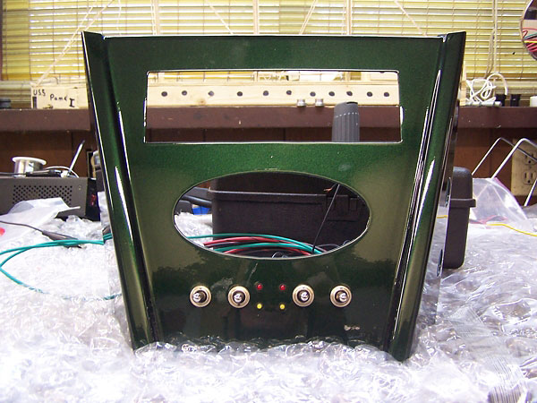

custom center control console
center control console wiring
three eyeball-style dashboard mounted air conditioning louvered vents
Vintage Air air conditioning contols
Spring-loaded electrical contacts on the door jams for power windows and door locks.
steel cover for wiring
Wiring and air conditioning lines are hidden under the passenger side fender, and this steel cover.

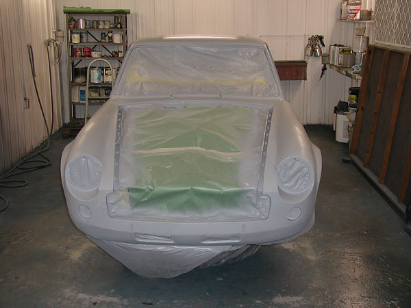

Paint
first the inside gets painted
First the inside gets painted...
test fitting the grille
Then the mechanical parts get installed, and exterior parts like the grille get "test fitted".
painting the outside
Final painting of the exterior requires a lot of careful masking!

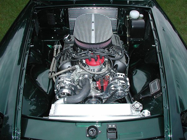

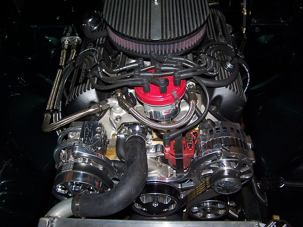

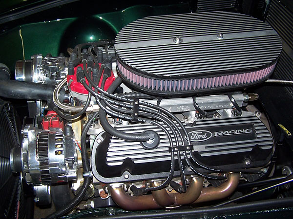

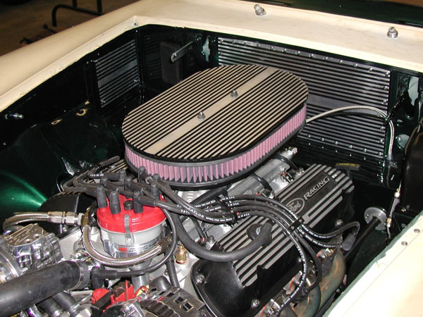

Ford crate engine dressed-up for installation.
Ford crate engine dressed-up for installation. (These headers weren't ultimately used.)
Custom milled aluminum air cleaner top and firewall filler panels.

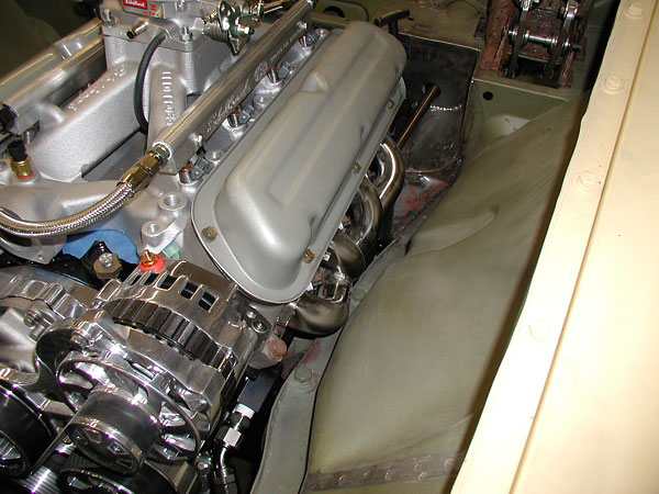

Fast Cars stainless steel block hugger headers
Fast Cars stainless steel block hugger headers.

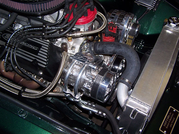

Billet Specialties Tru Trac serpentine pulley system.
Billet Specialties "Tru Trac" serpentine pulley system.
polished Sanden SD-7 a/c compressor came with the pulley system
A polished Sanden "SD-7" a/c compressor came with the pulley system.

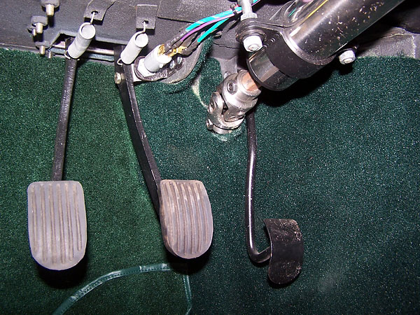

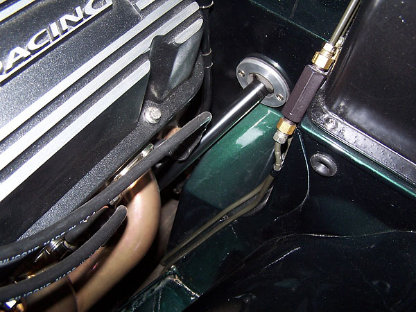

steering intermediate shaft and Wilwood residual pressure valve
The upper steering universal joint has been relocated out of the engine compartment...
upper steering universal joint and brake light switch
...and into the foot box area. The brake light switch has also been moved to the clean/dry/cool side.
Excellent oil pan clearance is an advantage of the Fast Cars front suspension.
This photo also shows where an oxygen sensor has been mounted on the exhaust.
Interior Trim

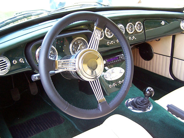

leather wrapped banjo-style steering wheel
Power windows and power door locks are all controled by dashboard mounted switches.
Fiero seats with Mr Mike brand Italian Style seat covers in Lamborghini (cream) colored leather.

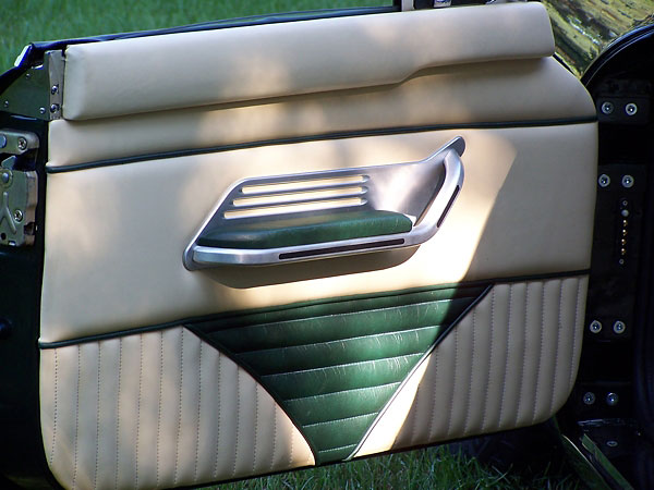

Big Al's Carponents brand Marque arm rests/door pulls on custom door panels.

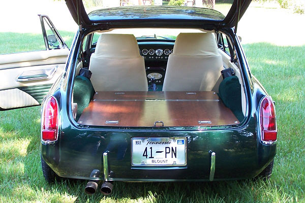

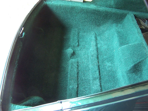

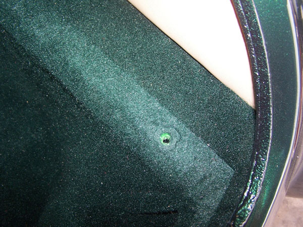

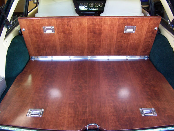

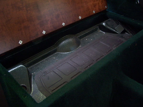

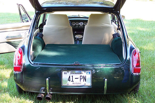

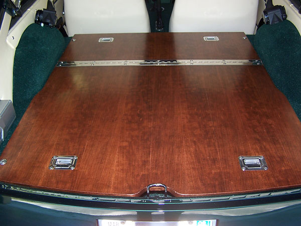

Cherry wood cargo floor is hinged in the middle
Cherry wood cargo floor is hinged in the middle...
custom removeable carpet covering on the cargo compartment lids
...and fitted with custom, removeable carpet covering.
chrome nerf bars in lieu of bumpers
Chrome nerf bars in lieu of bumpers.

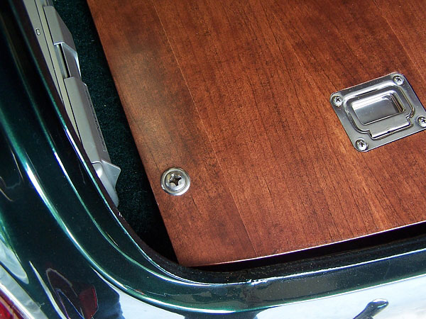

Detailed Look at the Cargo Area
cherry wood cargo deck is completely removeable
The cherry wood cargo deck is completely removeable, held in place by just four stainless steel pins.
piano hinge facilitates access to either front or rear compartment
Even without removing the cargo deck, a piano hinge facilitates access to either front or rear compartments.
Battery access remains in the usual place, under the new forward storage compartment.

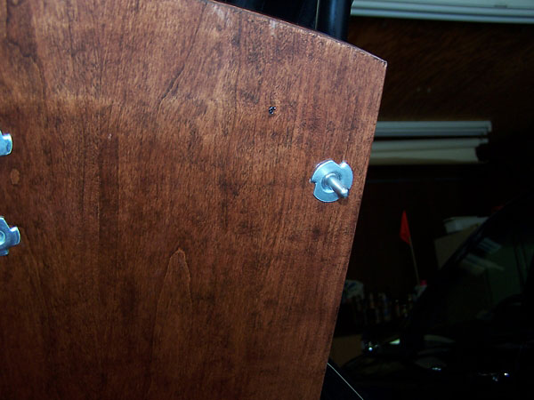

The bottom portion of stainless steel screws have been turned-down to make the pins.
However, their top portion is still threaded to mate with "nut-serts" in the lid.
stainless steel nut-serts
These aren't your usual nut-serts... they're stainless steel instead of zinc-plated.
alignment holes
Here's one of the holes the alignment pins plug into.
carpeted cargo area
The cargo area underneath is carpeted.
