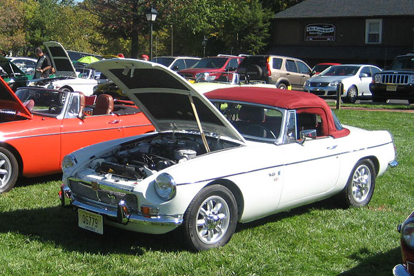

Dan Algarin's 1974 MGB with Rover 3.5L V8 engine
Owner: Dan Algarin
City: Hewitt, NJ
Model: 1974 MGB
Engine: 3.5L Rover V8
Built by: owner

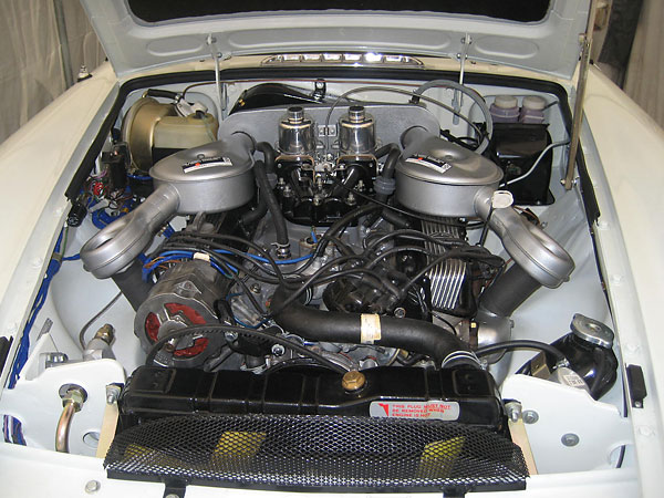

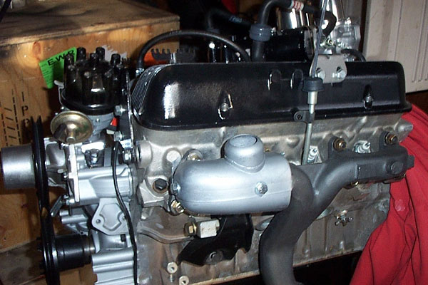

Engine: Rover 3.5L engine, fitted with "factory" MGB GT V8 model intake manifold, dual SU HIF6 carburetors, thermostatic air cleaner system, wiring, etc.
Cooling: MGB GT V8 spec radiator and cooling fans. MG oil cooler.

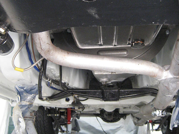

Exhaust: complete MGB GT V8 exhaust system (including factory cast iron manifolds).

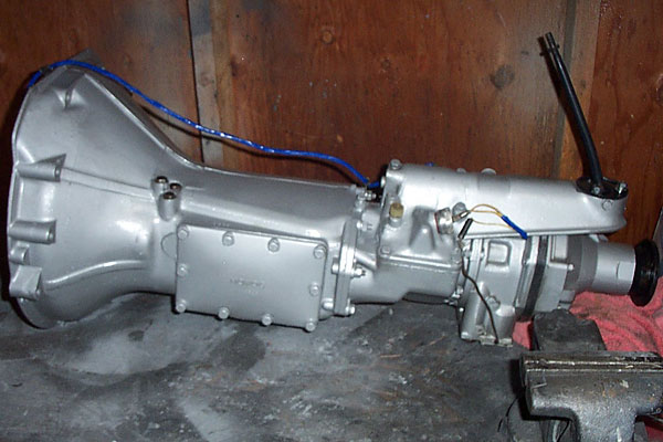

Transmission: stock MGB GT V8 four speed transmission, complete with its distinctive bellhousing, original gear ratios, and Laycock overdrive (on fourth gear only). Original spec flywheel, clutch system, and driveshaft.
Rear Axle: Salisbury axle with original MGB GT V8 gear set (3.03:1 ratio).

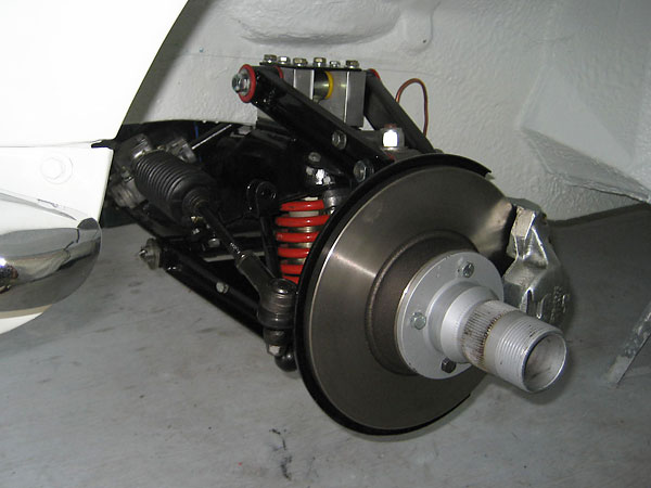

Front Susp.: Moss UK coil-over suspension.

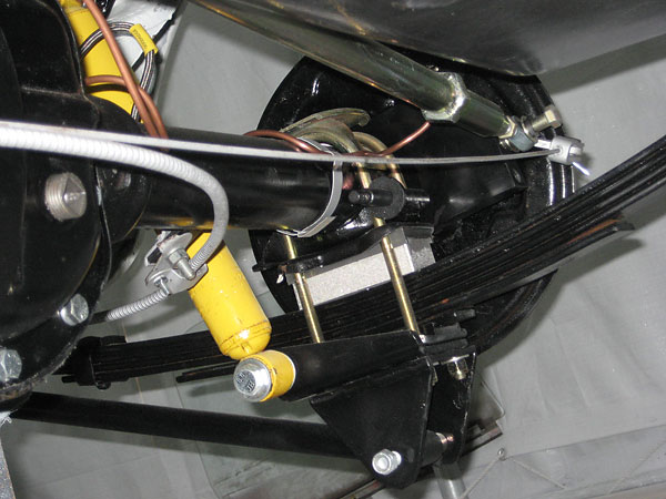

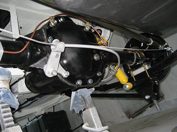

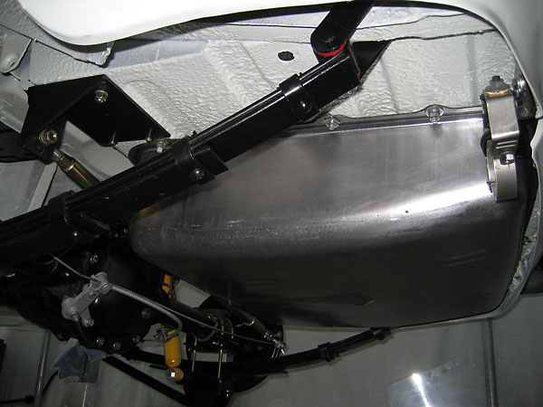

Rear Susp.: British Automotive tube-shock conversion and Panhard rod. Moss anti-tramp bars. Lowering blocks. Polyurethane bushings.

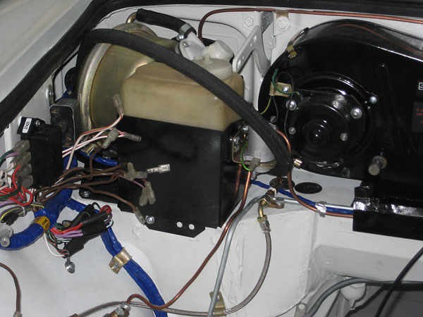

Brakes: servo assisted single-circuit brake system, similar to factory MGB GT V8,
(front) Rover SD1 brake calipers, operating on MGB GT V8 rotors, and
(rear) stock MGB.

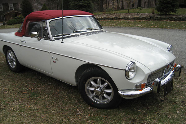

Wheels/Tires: 14x5.5 Minator knock-off wheels with Yokohama 165/70R14 tires.
Electrical: factory "V8" tachometer. MG factory spec Delco alternator, Rover starter, and Lucas points-type distributor with Lucas coil.

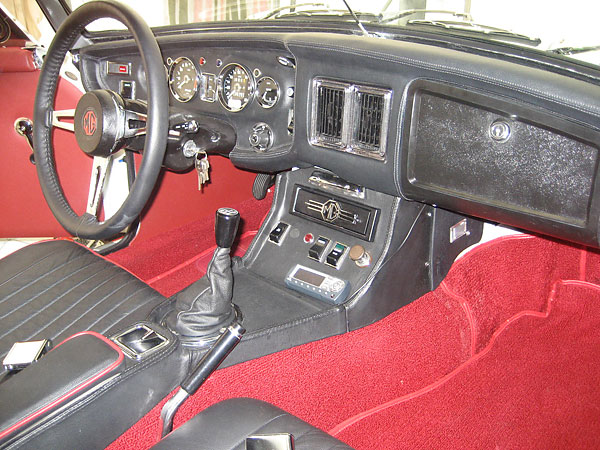

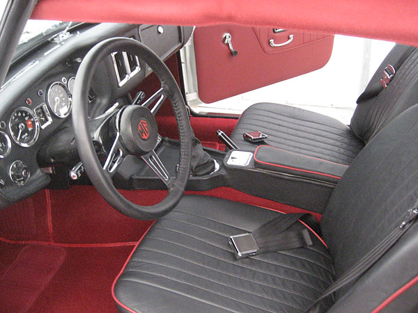

Interior: all leather interior, featuring leather seats (black with red piping) sourced from The MG Centre (aka "Elite MG") in the UK, door panels from Moss Motors, dash and middle console covered in leather by an upholstery shop in Guadalajara, Mexico. Chromed defroster vent bezels.

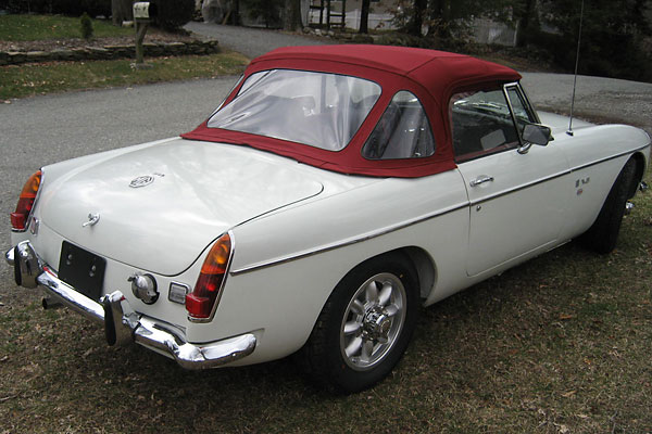

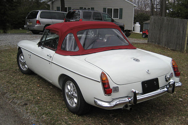

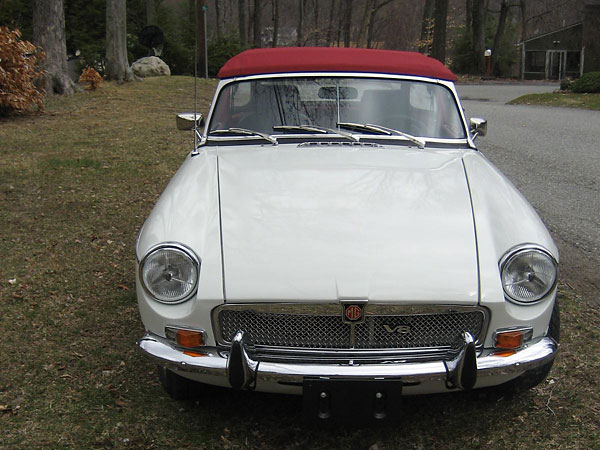

Exterior: stainless steel wire mesh grille. Aston fuel cap. Tripod headlamps. Mohair-fabric top (fully lined inside) supplied by Prestige Auto Trim UK. Painted MG "Glacier White", which was the original color of this particular MGB and also the most popular color for the MGB GT V8 model.
Completed: April 20, 2008.

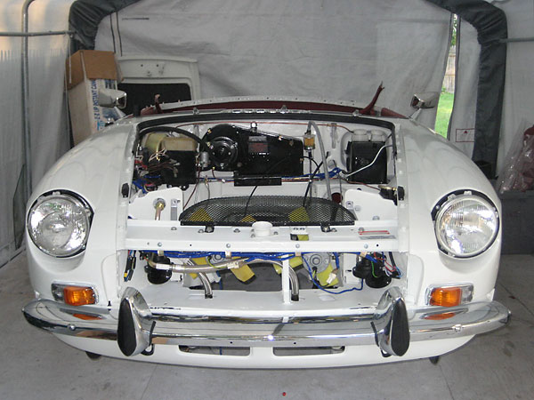

engine steady bar
Engine steady bar made from parts ordered from McMaster Carr, cost less than $20.

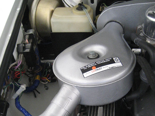

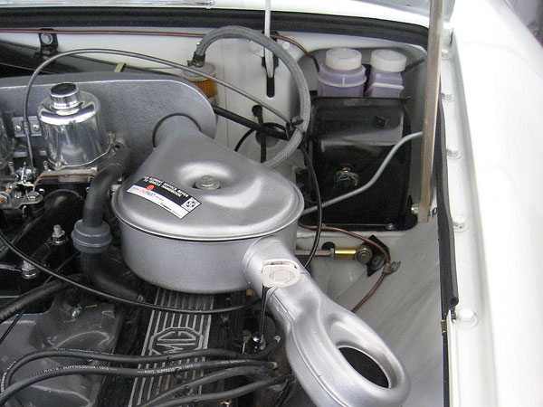

thermostatic induction system
Unipart decal
y-pipe

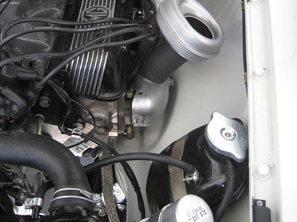

Rover 3.5L engine, fitted with MGB GT V8 cast iron exhaust manifolds.
MGB GT V8 4-speed transmission, with distinctive integral bellhousing and Laycock overdrive.

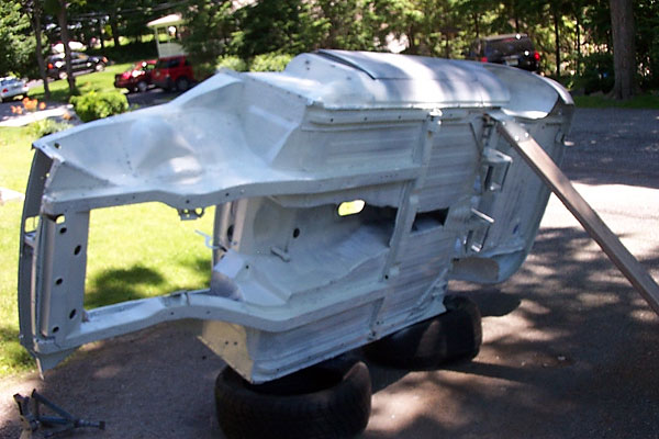

How It Was Done:

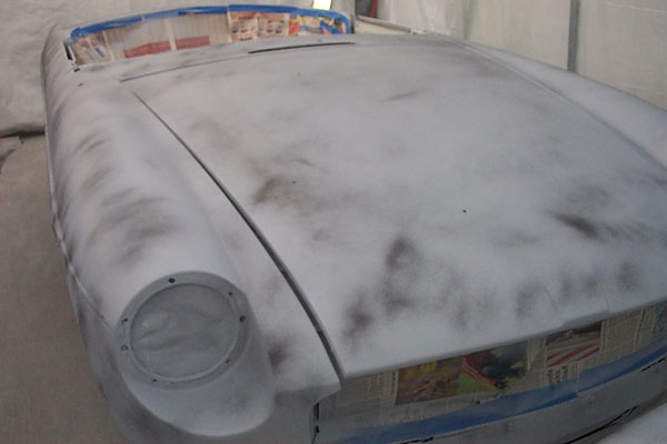

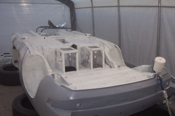

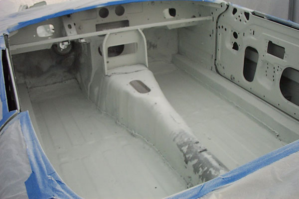

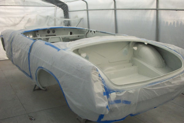

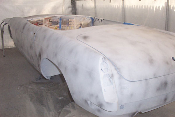

Paint
scary photo

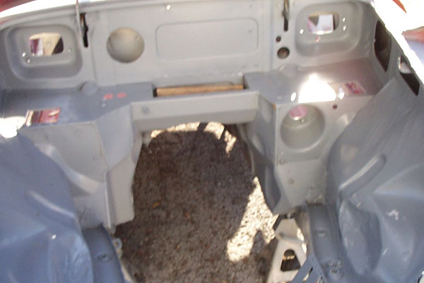

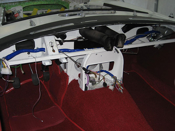

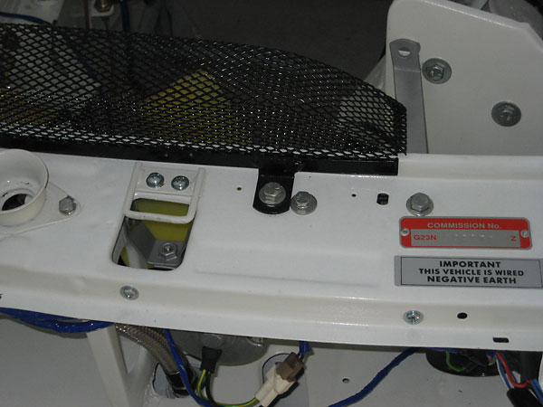

firewall
battery boxes
bonnet alignment
boot lid alignment

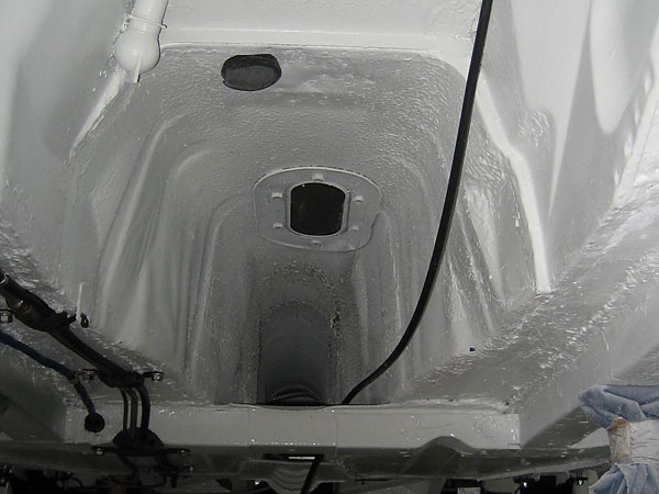

painting the interior (replaced floorboards)
masking... and painting the interior

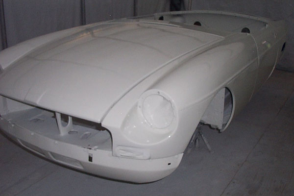

finish coat

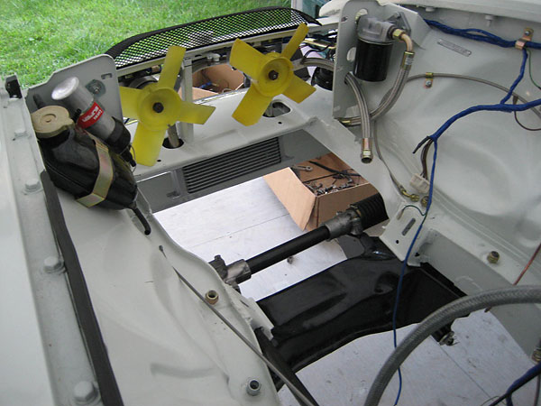

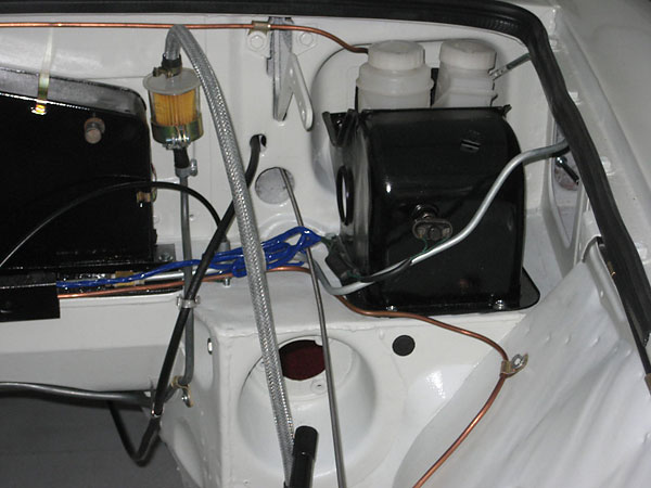

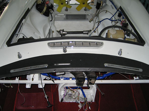

Re-Filling The Engine Bay
oil cooler... interestingly, mounted below the shelf
single circuit master cylinder for the brakes
dual electric cooling fans

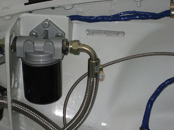

remote oil filter
Remote oil filter.
remote power brake servo
Remote power brake servo.
transmission tunnel

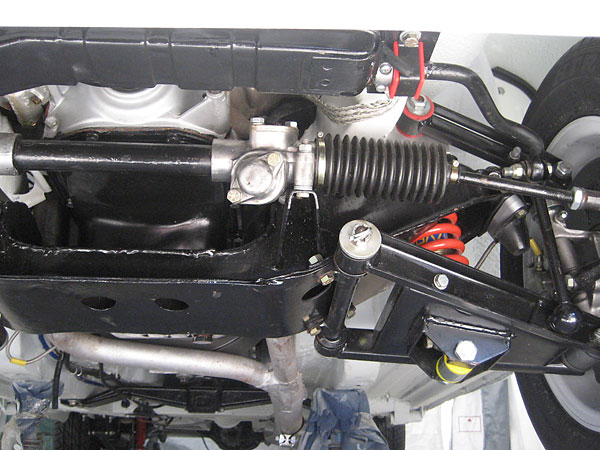

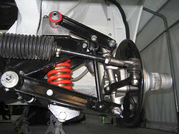

Installation of the Suspension and Brakes
in this view, the sway bar isn't installed yet
Rover SD1 brake calipers, operating on (extra thick) MGB GT V8 rotors
Rover SD1 brake calipers, operating on (extra thick) MGB GT V8 rotors.

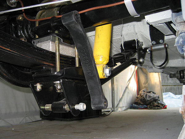

lowering blocks
Panhard rod bracket on the axle
anti-tramp bar
Anti-tramp bar.
MGB fuel tank, and Panhard rod bracket on the floorboard

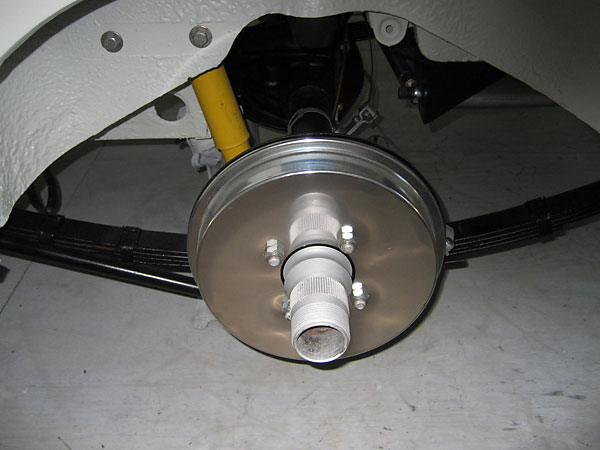

brake drum cover

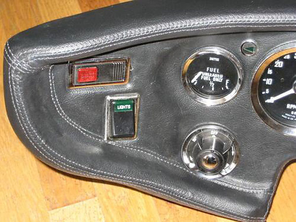

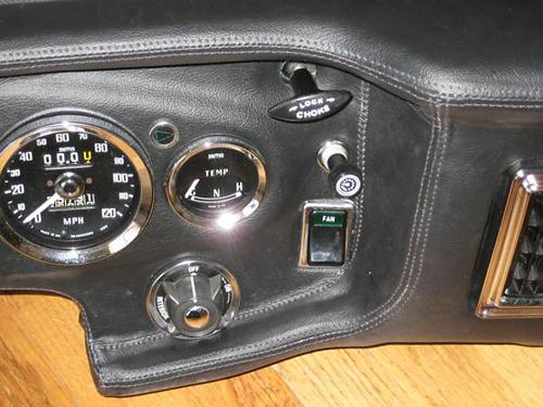

Interior and Dashboard
instrument panel wiring
Custom leather-covered MGB dashboard.
factory V8 tachometer
leather covered MGB steering wheel
leather seats from The MG Centre (Elite MG) in UK

Aston fuel cap
convertible top

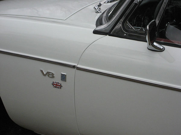

V8 badge
