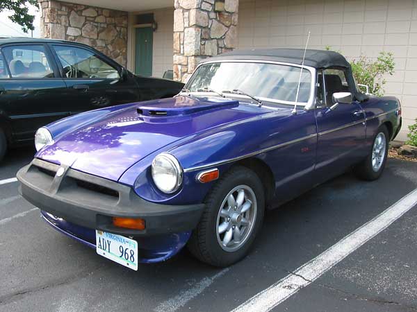

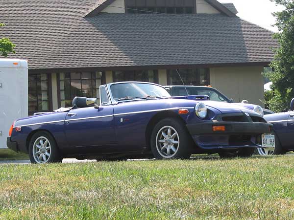

Dale Spooner's 1977 MGB with Ford 5.0L V8

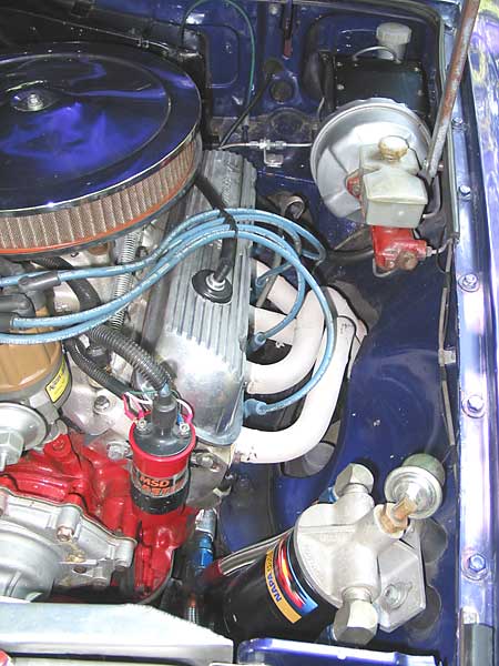

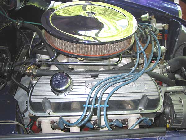

Engine:   9.6:1 compression, ported AL heads, Edelbrock intake/carb, 315hp (5,200rpm), 335lbft (4,400rpm)

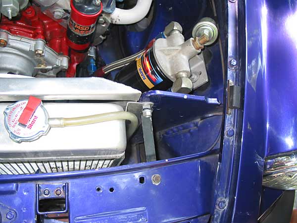

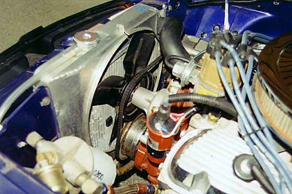

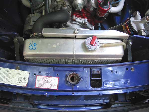

Cooling:   Griffith aluminum radiator, Moroso pump

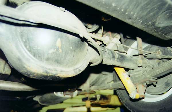

Rear Axle:   8" Ford (2.79:1) center with MGB ends
Front Suspension:   uprated springs, gas shocks
Rear Suspension:   gas shocks

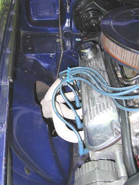

Exhaust:   home-made ceramic-coated headers, 2" dual stainless pipes

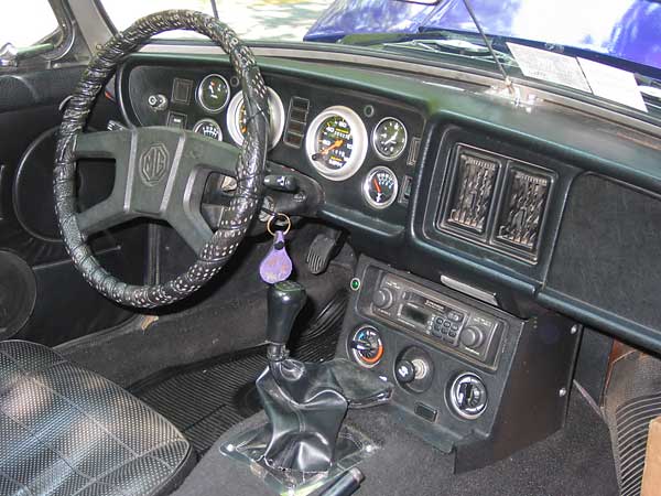

Instruments:   Autometer tach & speedo
This car also appeared in the MG-V8 Newsletter (Vol4/Iss1) but the specs above are somewhat more current.
Ford 5.0L V8 engine
home-made headers
ceramic coated headers
remote oil filter

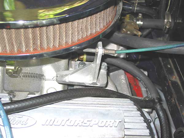

throttle cable
Dale Spooner's MGB: fan shroud improves idle and low speed cooling
Fan shroud improves idle and low speed cooling

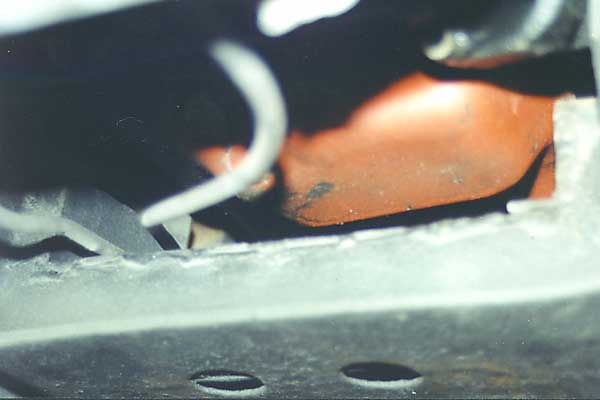

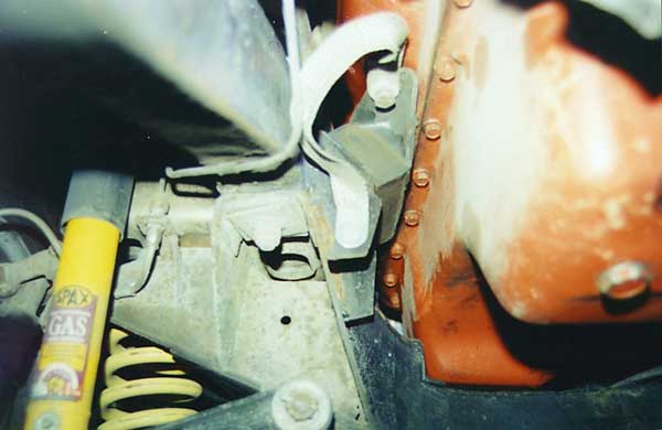

Dale Spooner's MGB: notched crossmember front view
Notched Crossmember Front View
Dale Spooner's MGB: notched crossmember rear view
Notched Crossmember Rear View
Dale Spooner's MGB: Ford 8 inch rear axle
Ford 8" Rear Axle
Autometer tach and speedo

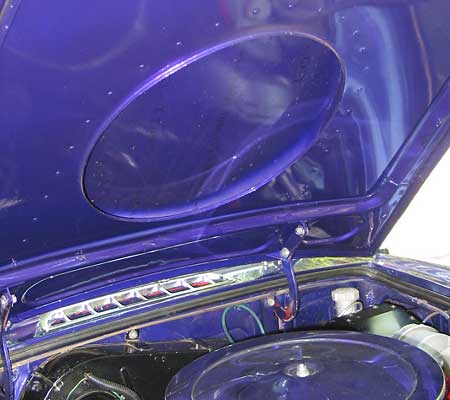

Dale Spooner's MGB hood scoop
