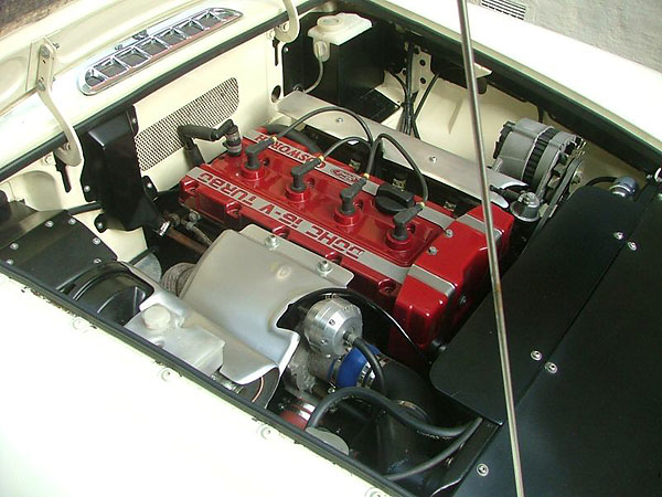

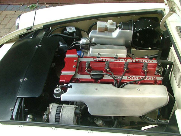

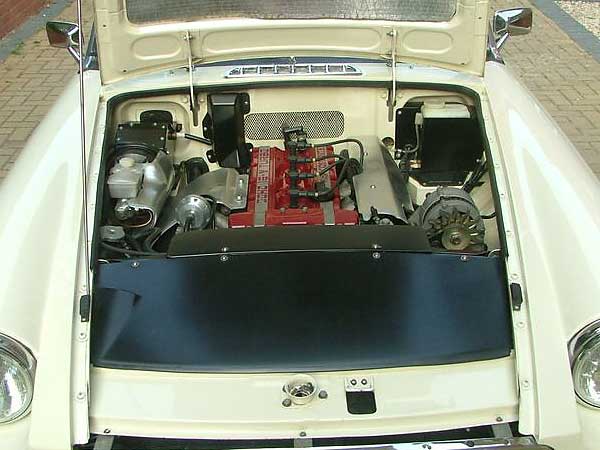

Engine: The Ford "Sierra Sapphire" Cosworth 2L 16-valve,dual overhead cam, turbocharged, fuel-injected four-cylinder engine was originally rated by Ford at 204bhp. It was rebuilt (with new cylinder liners) in 2001. The electronic fuel injection system was rechipped with a 330bhp rated program, and #803 "green" fuel injectors were fitted, along with a 3 bar MAP sensor. The Garrett turbocharger has been upgraded to a larger Ford Escort Cosworth compressor housing and impeller (to give better initial boost.) An intercooler is installed betweel radiator and slam panel.
Cooling: "MGB V8" radiator with heavy duty Kenlowe adjustable electric fan.

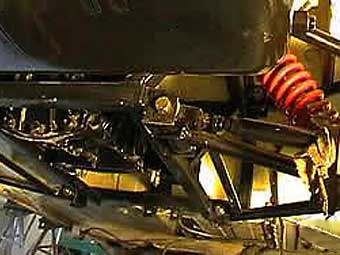

Front Susp.: Home-made double wishbone suspension with coil over shocks. The front suspension has been set up with 550 pound springs and 6 degrees of negative camber.

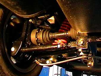

Rear Susp.: Home-made independent rear suspension. The Ford differential is mounted into a fabricated cage, which also includes double-wishbone and coilover-shock mounting points. The rear suspension is set up with CV jointed half shafts, 210 pounds springs, and 4 degrees of negative camber.

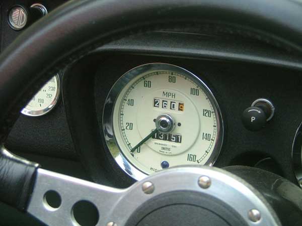

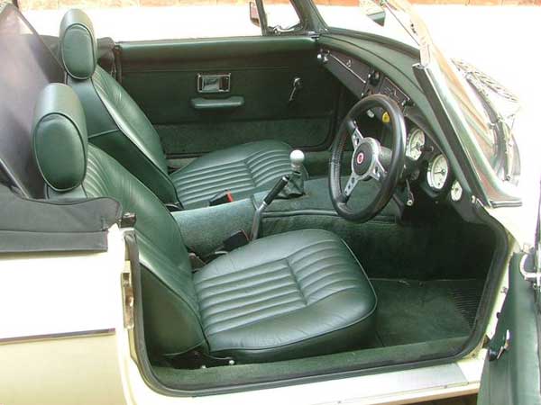

Other: The seats are leather upholstered in a Jaguar-spec color (custom built by Moss Darlington over up-rated reclining seats.) The carpets are Wilton green with soundproofing matting added. The dashboard is standard, complete with original-style crinkle finish paint, but the instruments have been color-matched to the car's overall scheme (e.g. Old English White faces with green markings). A "Caterham style" heater has been mounted behind the dashboard. The steering wheel is a 14" Mota-lita. A CD player with foldaway face has been fitted, plus there's a remote CD changer in the trunk.
2.0L Ford Sierra Sapphire RS Cosworth 16-V DOHC
removal of heater shelf facilitates moving engine rearward
MGB V8 radiator and intercooler are hidden
Home-made IRS using Ford Sierra components.   IRS with coil-over shocks, double wishbones, and CV joints.
Moss Darlington reclining leather seats
Smiths gauges with custom faces

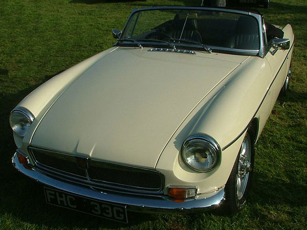

Old English White paint
