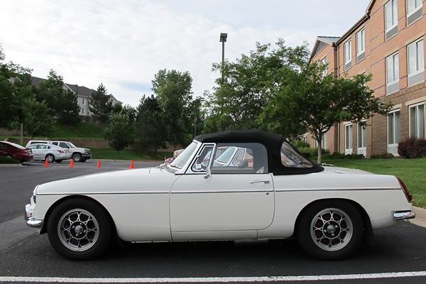

Perky and Charles Long's 1966 MGB with GM 3.4L V6

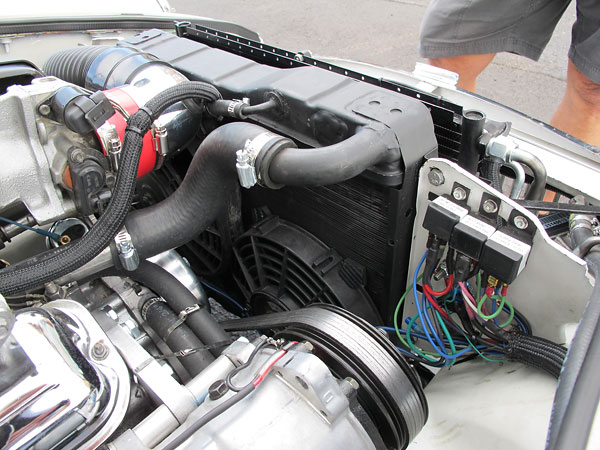

Engine: GM 3.4L 60-degree V6 engine with sequential fuel injection, from a 1995 Chevrolet Camaro. Machine work by Performance Race Engineering. Bored 0.060" over. Stock bearing sizes. Three angle valve job. ARP hardware throughout. Classic Conversions motor mounts. Classic Conversions accessory brackets and serpentine pulley kit. Ultima 81-1004 remanufactured alternator. Sanden air conditioning compressor. Edelbrock valve covers. 1995 Chevrolet Camaro ECM, reflashed with Tuner Cats cable and software. 1995 Chevrolet Camaro cruise control computer/actuator. Taylor Spiro-Pro 8mm spark plug wires. Oiled gauze air filter. Motorcraft FL-1A oil filter, remote mounted.
Cooling: late model MGB radiator, modified with short turn-up for bottom hose. Honda hose spacer. Two electric fans pulling, plus one electric fan for the AC condenser. Late model MGB surge tank. Stant 13psi radiator cap.

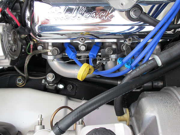

Exhaust: Classic Conversions headers, ceramic coated inside and out. Safety-wired header flange bolts.

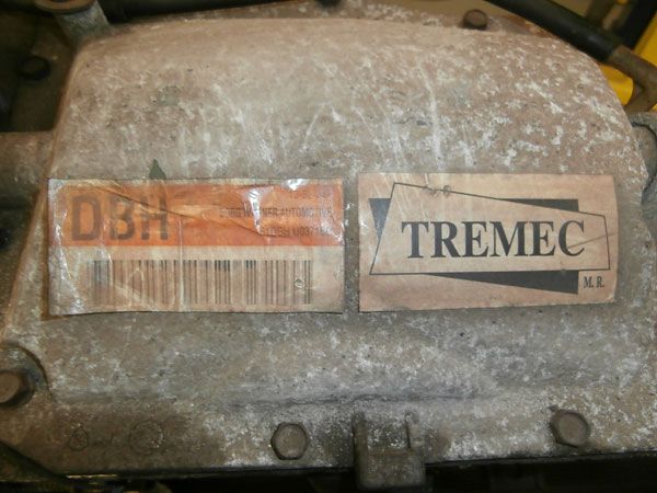

Transmission: Borg-Warner/TREMEC T5 5-speed (from 1998 Camaro). 0.72:1 fifth gear. Chevrolet S10 bellhousing. Diaphragm pressure plate. BMC British Automobile hydraulic throwout bearing kit. Wilwood master cylinder with modified Miata push rod.

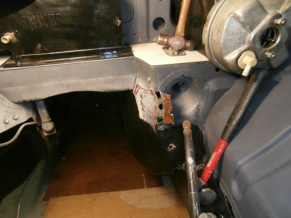

Brakes: later model MGB pedal assembly and power brake booster. Wilwood tandem master cylinder. DOT5 brake fluid. Summit bias valve, currently unconnected.

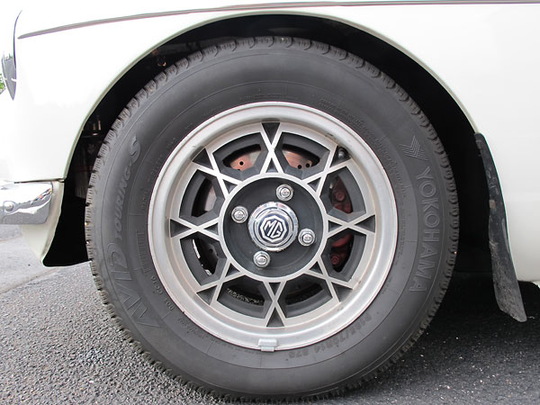

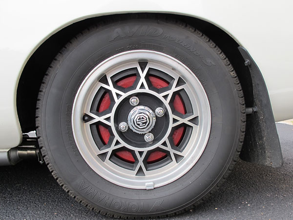

Wheels/Tires: Toyota Celica 14" aluminum wheels. (Not sure what year. They were laying in the wheel pile at my brother's salvage yard.) Yokohama Avid Touring S tires (P185/70R14).

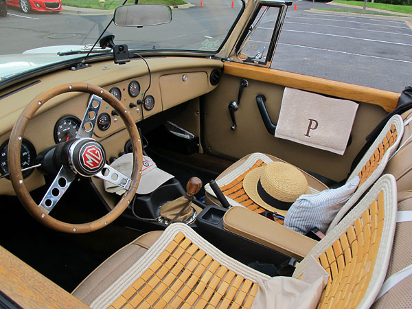

Interior: wood rimmed steering wheel. Custom dashboard and center console. Custom door cards and panels. Custom oak door caps. Mazda Miata armrests. New carpet. Zebrawood shifter knob? Two-cup cupholder.

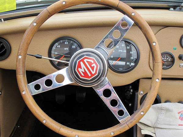

Instruments: VDO speedometer (0-120mph), tachometer (0-8000rpm), voltage gage (8-16V), water temperature gage (100-250F), oil pressure gage (0-80psi), fuel level gage (E-F). Summit fuel pressure gage (0-60psi, mounted in engine compartment.)

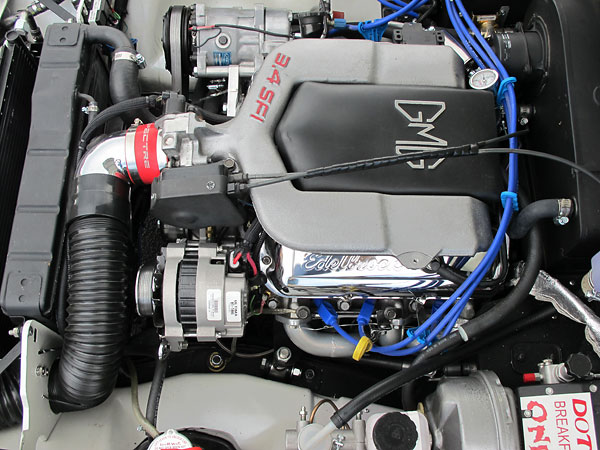

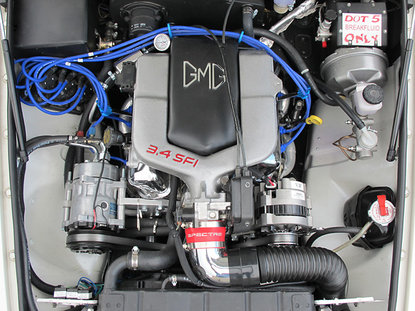

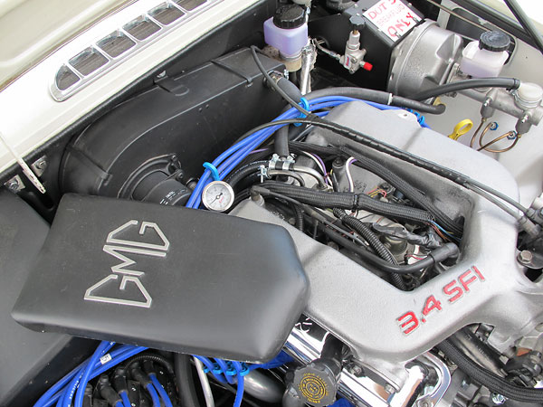

Charles fabricated this handsome cover for the fuel injector valley.

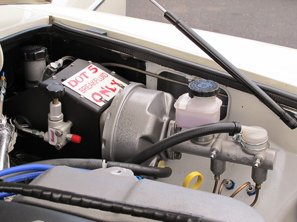

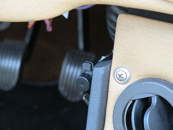

Later model MGB pedal assembly and power brake booster. Wilwood tandem master cylinder.

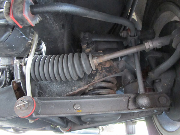

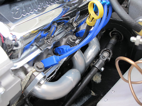

Borgeson steering universal joint, purchased from BMC, provides clearance to headers.
Borgeson steering universal joint, purchased from BMC British Automotive, provides clearance to headers.

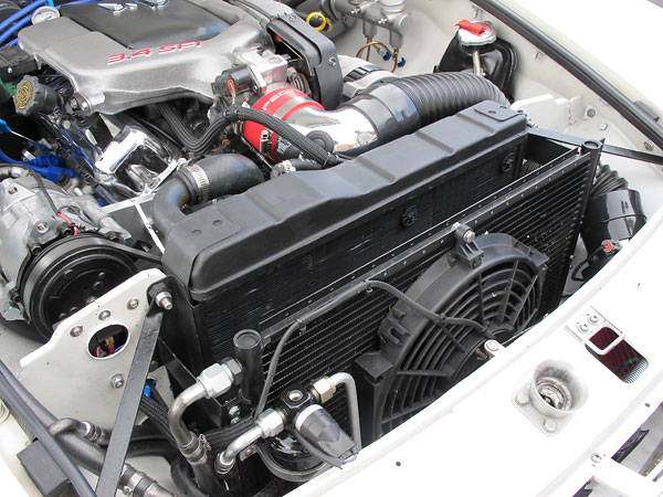

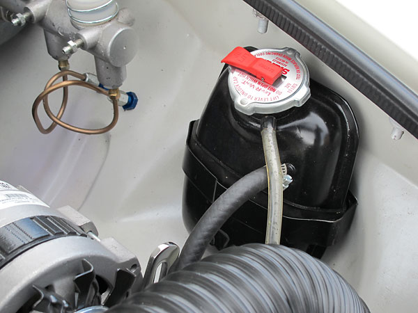

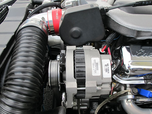

Alternator: Ultima 81-1004 73046402.
Remanufactured in Mexico. AR109062A 73 14046 I. 7340409495 02.

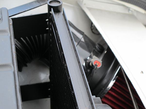

Air conditioning condenser and receiver drier.

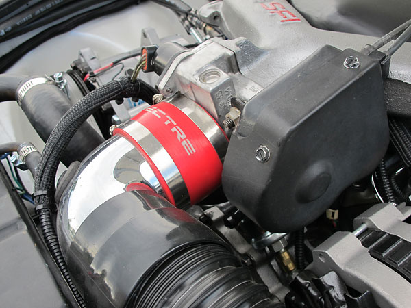

Intake air temperature sensor. Oiled gauze air filter.

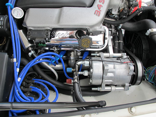

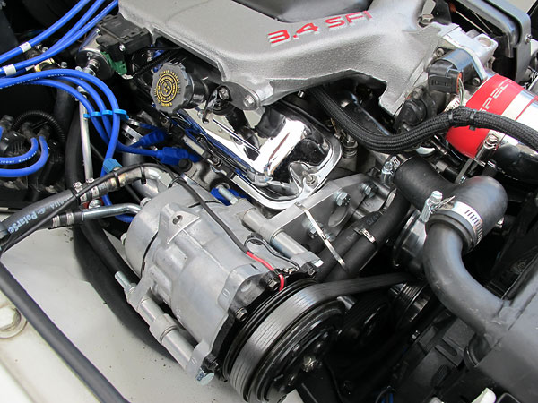

Sanden air conditioning ompressor on Classic Conversions Engineering bracket.
Sanden air conditioning compressor on Classic Conversions Engineering bracket.
(Note slight relief added by Charles for valve cover flange clearance.)

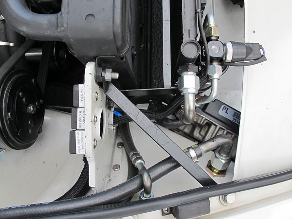

Relays for ECM cooling fan, AC evaporator and condensor fan, ECM cooling fans override.
Relays, left to right: ECM cooling fan, AC evaporator and condensor fan, ECM cooling fans override.
The header flange bolts gave all been safety-wired to prevent loosening.
These Classic Conversions headers have been ceramic coated both inside and out.

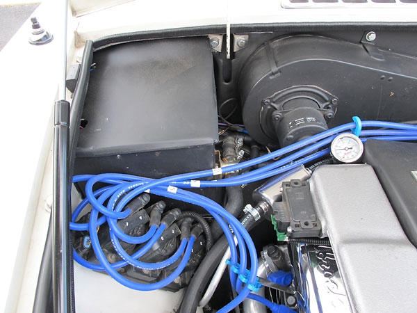

Stock coil packs and MAP sensor. Summit fuel pressure gage.
The engine computer is mounted inside this box. In the foreground:
stock ignition coil packs and MAP sensor. Summit fuel pressure gage.

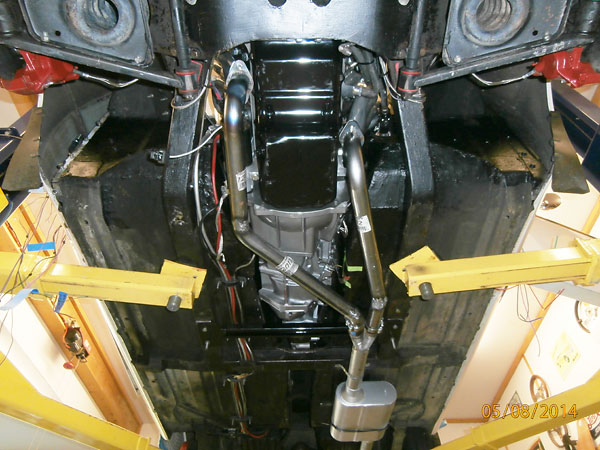

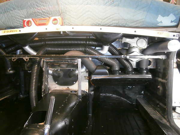

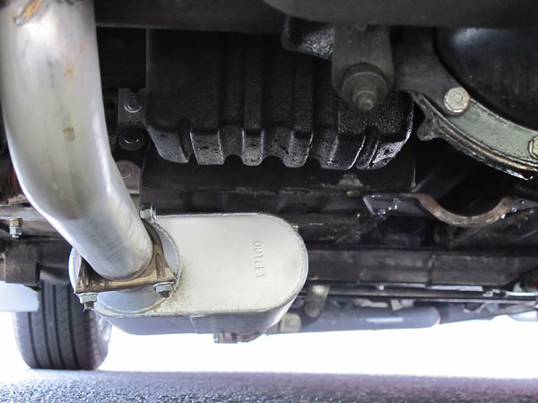

Charles modeled the exhaust routing with pipe flexible air duct and then ordered
mandrel bent steel tubing which he cut and welded as necessary.

Later model MGB radiators, as shown here, are significantly taller than earlier ones.

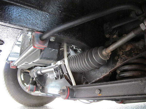

Stock MGB front suspension, although updated with red polyurethane bushings.

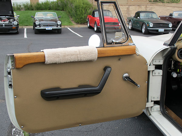

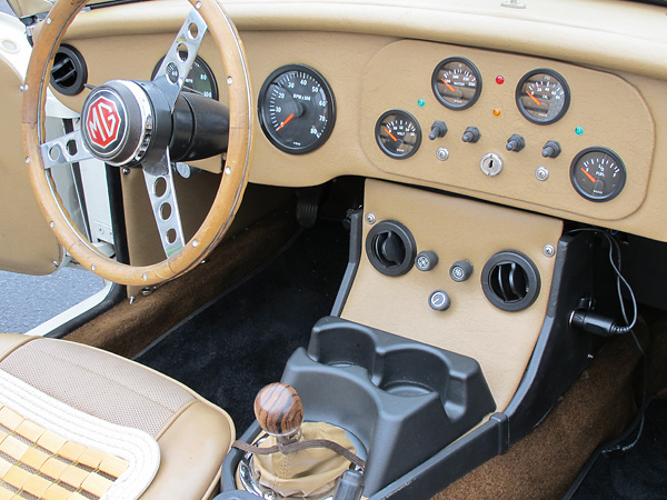

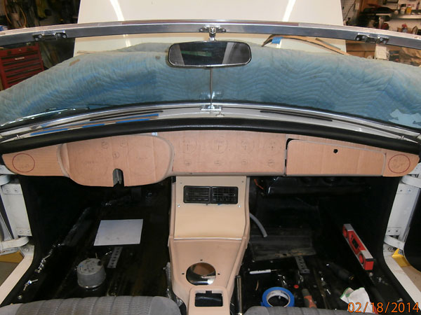

Custom dashboard and center console with air conditioning controls and vents.
Wood rimmed steering wheel.

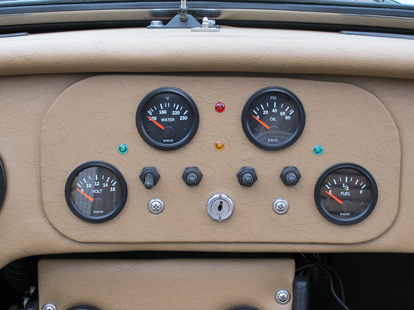

VDO voltage, water temperature, oil pressure, and fuel level gages.

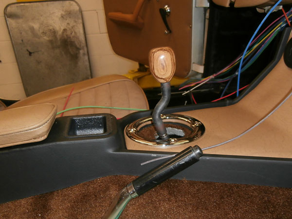

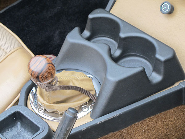

Zebrawood shifter knob and two-cup cupholder.
Zebrawood shifter knob and two-cup cupholder. "I was given this knob fifteen or
so years ago. All this time I kept saying, 'I'm going to use this thing some day.'
The day arrived, and the knob is what decided the color scheme of my interior."
Mazda Miata armrest.

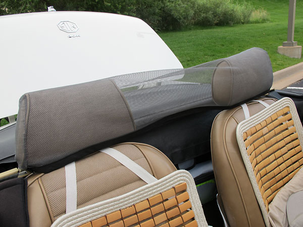

Sewn, removeable, mesh screen eliminates wind buffeting.

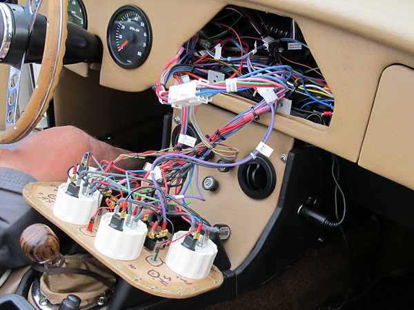

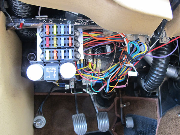

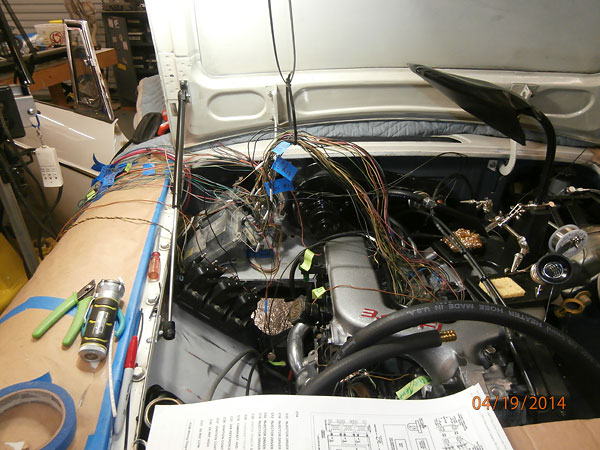

This MGB has been totally rewired, utilizing a kit from Rebel Wiring.
This MGB has been totally rewired, utilizing a kit from Rebel Wiring which is located
nearby Charles Long in Etowah, Tennessee. Charles hinged the fuse block so that it
folds down for easier access. It supports four more fused circuits than stock.
Dashboard construction and wiring conceived for ease of service.

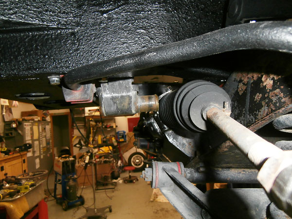

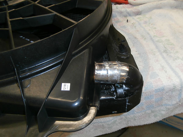

Late model MGB radiator in conflict with early model MGB steering rack.
Short turn-up provides radiator hose clearance.

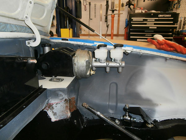

This brake master cylinder will fit, but only if its forward reservoir is mounted remotely.

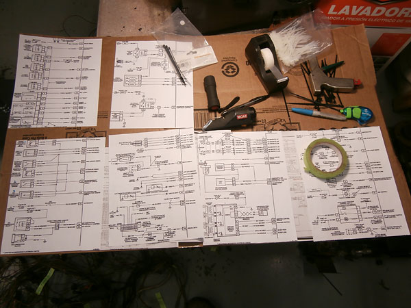

Electrical schematic drawings.

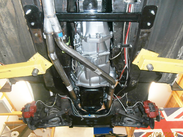

Exhaust Y-pipe.
Exhaust Y-pipe.

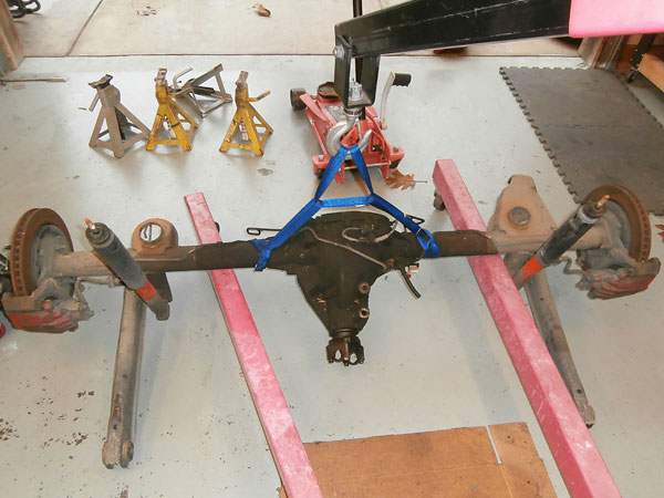

Chevrolet Camaro rear axle complete with disc brakes, ready to be narrowed.

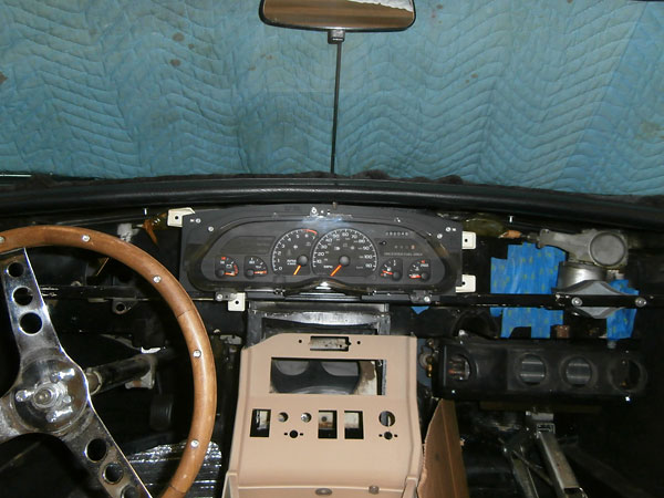

Trial installation of Chevrolet Camaro instrument cluster.
Another dashboard mock-up. Note also trial installation of Pontiac Fiero seats.

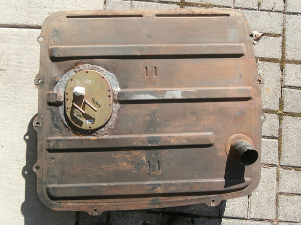

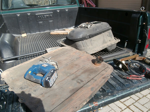

MGB fuel tank in foreground. Mazda Miata fuel tank in background.

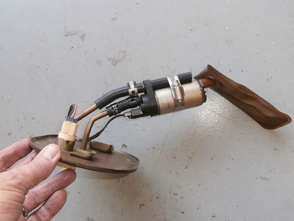

Mazda Miata in-tank fuel pump cut and bent to fit in a shallower tank.
Modified MGB fuel tank with in-tank pump for electronic fuel injection.

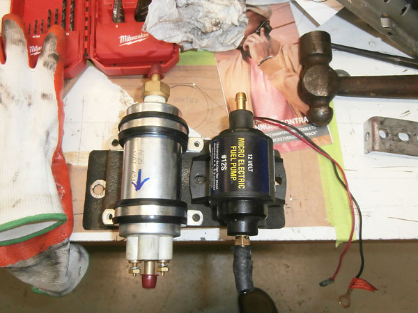

Time constraints got to me, so I'm using these for now. They're quiet above 20mph.
"Time constraints got to me, so I'm using these for now. They're quiet above 20mph."

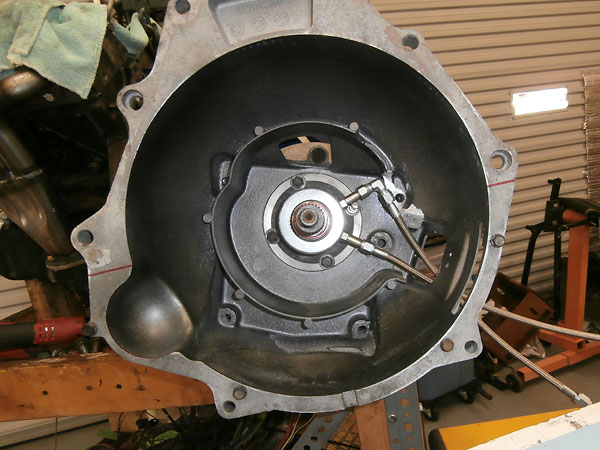

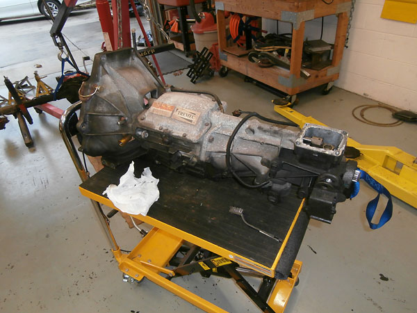

Transmission mated to 1998 Camaro bellhousing.
This photo shows the T5 transmission mated to a 1998 Camaro bellhousing, which puts the
starter motor on the driver side. For installation on an MGB, it's much better to move
the starter to the passenger side, so Charles substituted a Chevrolet S10 bellhousing.
Borg Warner Automotive developed and manufactured the T5 transmission.
Borg Warner Automotive developed and manufactured the T5 transmission for years before selling
production rights to TREMEC. This particular transmission was built in the transition.

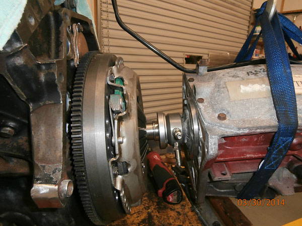

Test fitting the hydraulic throwout bearing, diaphragm pressure plate, etc.
BMC British Automobile hydraulic throwout bearing kit. One hose connects to the clutch
master cylinder. The second hose is required for bleeding the system after installation.

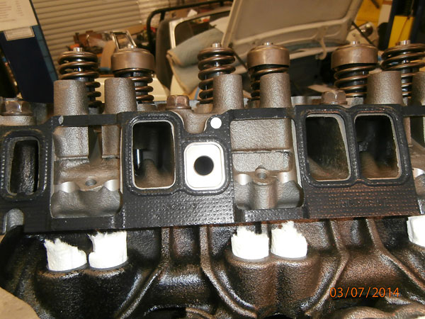

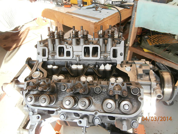

Installation of the cylinder heads.
Induction ports of the Chevrolet 3.4L V6 cylinder head.

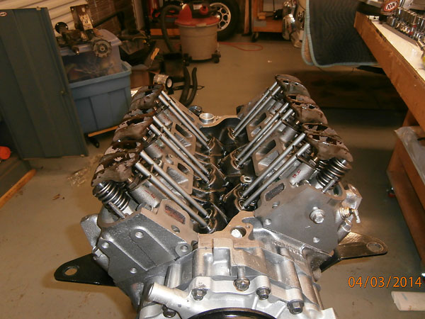

Pushrods and rockers.

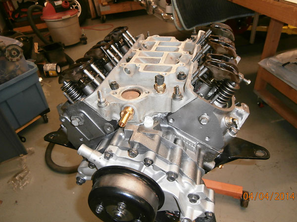

Installation of the intake manifold.

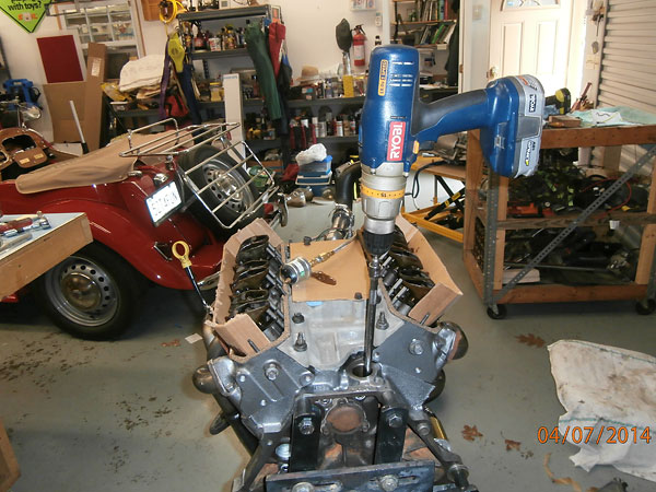

Priming the oil pump.

Side view mirrors were dealer-installed on early MGBs.
Side view mirrors were dealer-installed on early MGBs,
so placement and type have always varied widely.
Toyota Celica 14 inch aluminum wheels.
Toyota Celica 14" aluminum wheels. (I'm not sure what year. They
Yokohama Avid Touring S tires, size P185/70R14.
