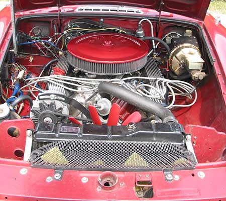

1963 Buick 215, 11:1 compresion ratio (JN block).
1963 Buick 215, 11:1 compresion ratio ("JN" block).

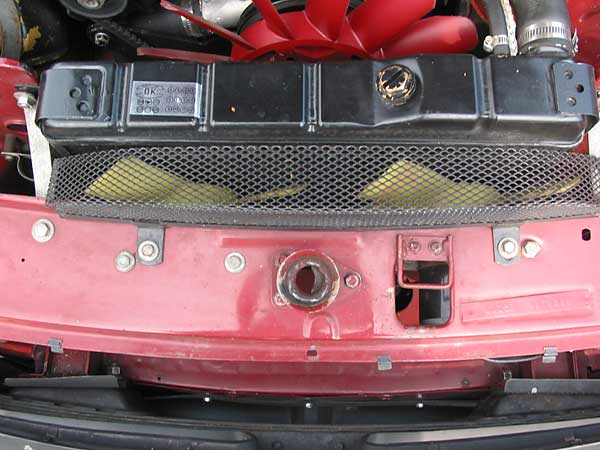

MGB V8 extra long core radiator
D&D swivel adapter, and off-the-shelf "MGB V8" (extra long core) radiator.

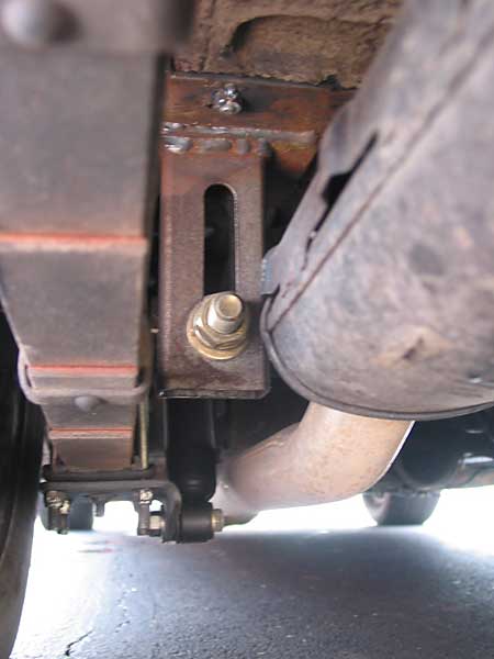

1.25" lowering blocks in the rear. The rear shackles were shortened about 0.75 inches.

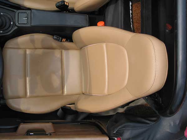

Mazda Miata seats
Mazda Miata seats

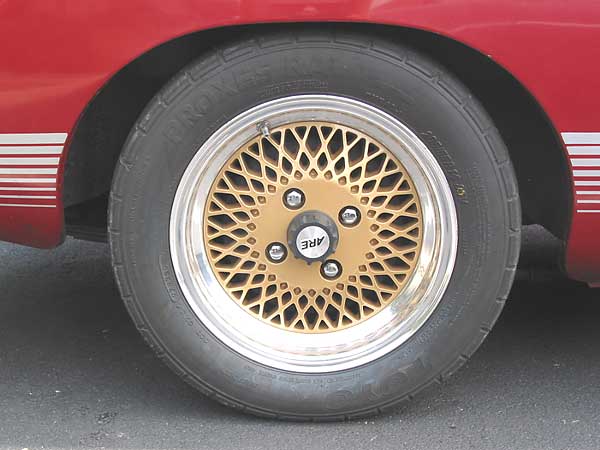

shaved Toyo RA1 205/55-14 tires
14X6 American Racing wheels and shaved Toyo RA1 205/55-14 tires.
(Combined wheel/tire weight is 31 pounds per corner.)
