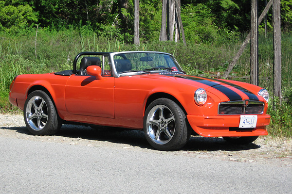

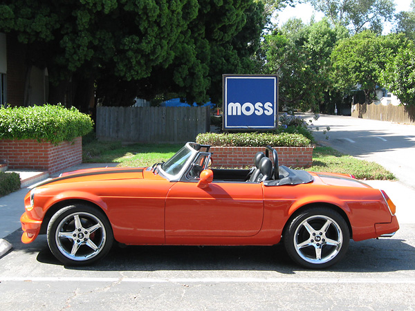

Bruce Mills' 1974.5 MGB roadster with Rover 3.5L V8

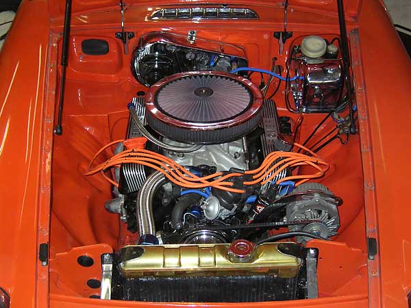

Engine: 1969 Rover 3500 V8

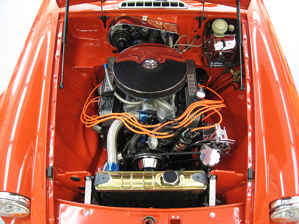

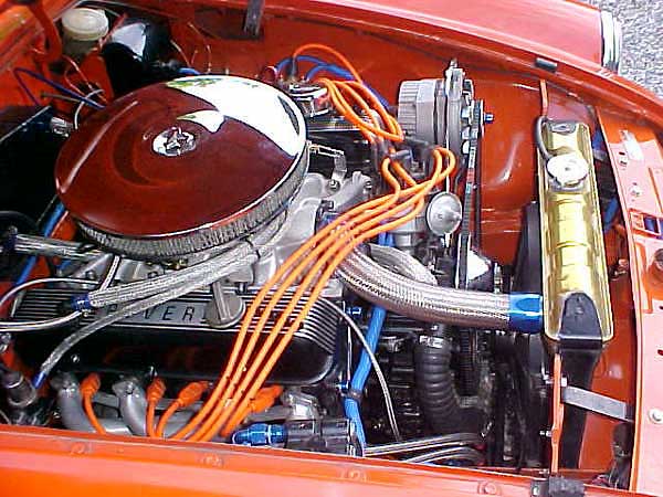

Engine: Totally rebuilt 1969 Rover 3.5L V8. 10.5:1 +0.020" pistons. Enlarged oil journals and up-rated oil pump. D&D oil filter adapter. Pertronics Ignitor LU-183 distributor. Pertronics Flame-Thrower coil. Taylor Vertex high performance spark plug wires. Weber Mini Hy Tork starter.
Intake: Edelbrock 2198 intake manifold. Edelbrock 1404 carburetor (jetting: 0.086" 1423 primaries, 0.095" 1425 secondaries, 0.067"x0.055" 1463 rods. K&N air filter. Holley fuel pressure regulator. Carter P4549 7psi fuel pump.
Exhaust: Ceramic coated block hugger headers. Dual exhaust with crossover pipe. (Centered gas tank.)
Cam: Isky 621270 Buick Special V8 215 270 duration.

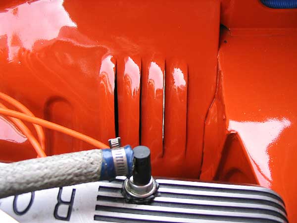

Cooling: Ford Falcon radiator. 3000CFM fan. Fabricated ductwork to force air through lower radiator. Louvers have been cut into the inner fenders to vent air into (lower pressure at speed) wheel wells. (See photo.)
Misc.: Chrome heater housing. Chromed master cylinder cover. Chromed radiator supports. Stainless steel braided hoses.

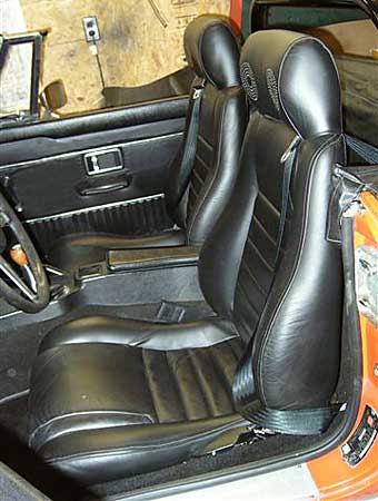

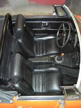

Interior: Fiero seats reupholstered in leather by a local shop feature speakers in the headrests. (The speakers did which required an extra amplifier.) Additional speakers are located in the footwells and behind the seats.

Comments: I had a few oil leaks. The block round the rear seal is quite sharp and I accidentally took a small slice off the neoprene seal which caused a leak. The up-rated oil pump required 2-3 extra pounds of torque to stop it from leaking. D&D's swivel oil filter adapter leaked until I applied about 60 pounds of torque.
The 1969 Rover engine has a pipe at the back of the block which vents the lifter gallery. This pipe actually spewed quite a bit of oil down the back of the motor ending up dripping from the bottom of the tranny looking like a rear seal problem. The solution was just to block this vent off.
I had cooling problems and installed ductwork to force air though the lower radiator. This helped, but it wasn't until I installed louvers up high on the inner fender into the low pressure wheel well (see photo) that my problems were totally solved. The car has no overheating issues now, even in city driving in 100 degree temperatures. You've got to get the heat out of the engine bay.

Updated engine compartment.
Louvers in the inner wings.

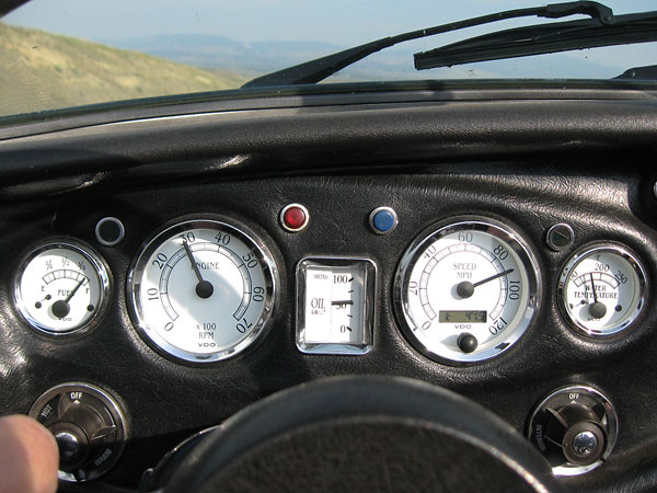

New VDO Cockpit Royale gauges, at cruising speed.
New VDO "Cockpit Royale" gauges, at cruising speed.
Pontiac Fiero seats in MGB   MGB leather upholstery
Pontiac Fiero seats with custom leather upholstery.

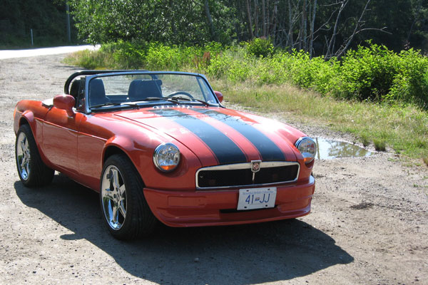

Fiberglass front bumper with integral air dam.
Dodge Omni fender flares.
Notice that front turn signals are incorporated into these aftermarket 7" round headlights.
Dodge Omni steel fender flares installed by Joe Terry. A stainless steel grille has also been installed.
Door handles have been shaved. Modern door mirrors have been installed and painted body color.

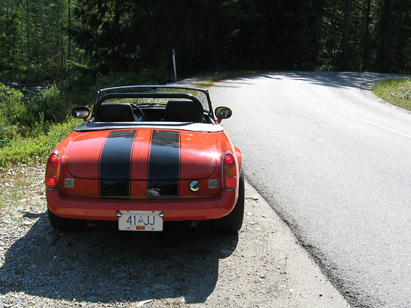

Fiberglass rear bumper. The trunk latch has been shaved.

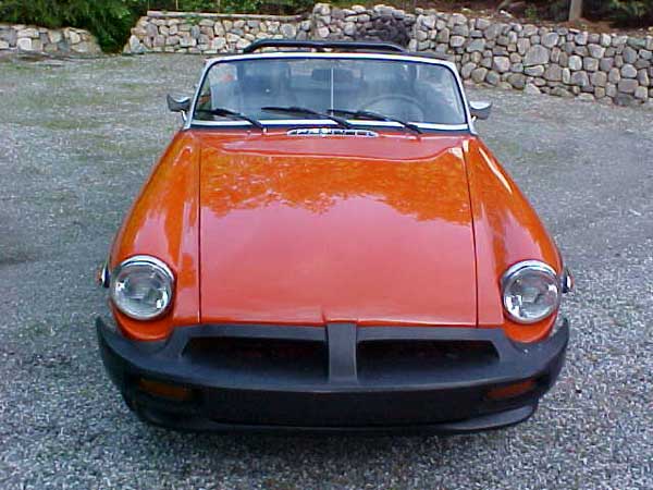

Original MGB rubber bumper.
Original MGB "rubber bumper".
