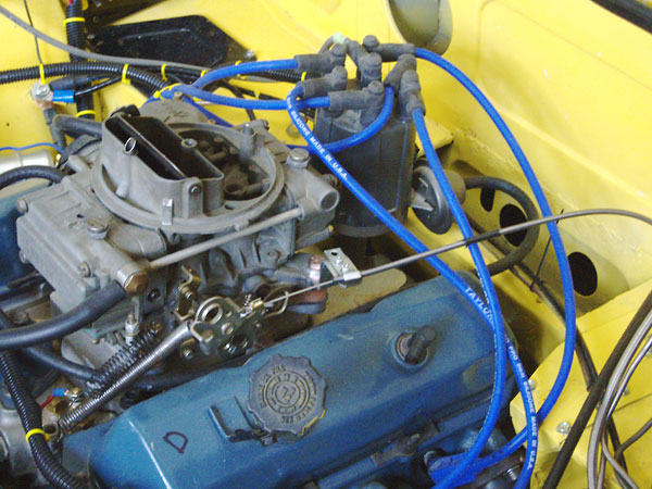

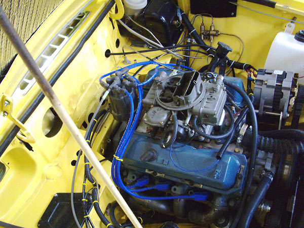

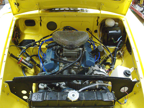

Engine: GM 3.4L 60-degree V6. Edelbrock intake manifold with the top-half milled down. Holley 8007 390cfm carburetor. Earlier model GM distributor (1982 Chevy S10 spec), with MSD-6T multiple spark ignition module in lieu of GM electronic ignition.

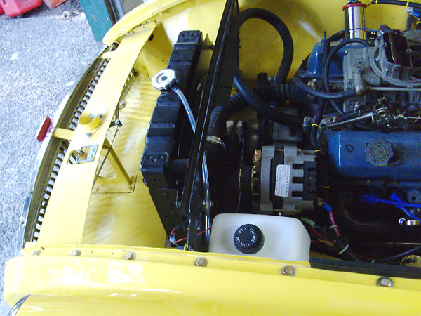

Cooling: stock MGB radiator from Moss. 14" electric "pull" fan with custom shroud by owner.

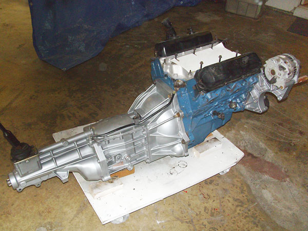

Transmission: Camaro T5 5-speed. McLeod hydraulic throw out bearing. Stock MG master cylinder.

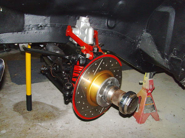

Brakes: (Front) new (stock) calipers and EBC slotted and dimpled rotors.

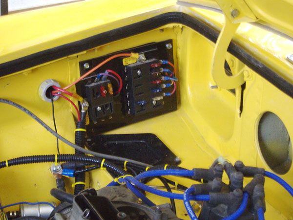

Electrical: new Autometer gauges. 12 volt battery. Custom wiring harness by owner.

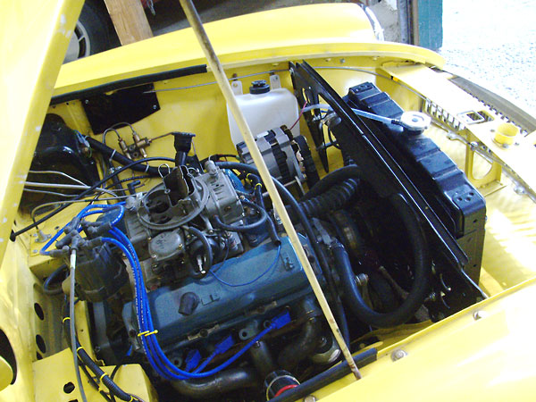

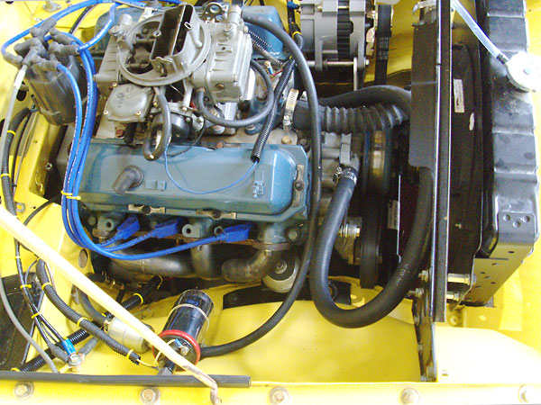

Completed engine installation (except that a heater hasn't been reinstalled yet).
Holley 8007 390cfm carburetor on a modified Edelbrock intake manifold.

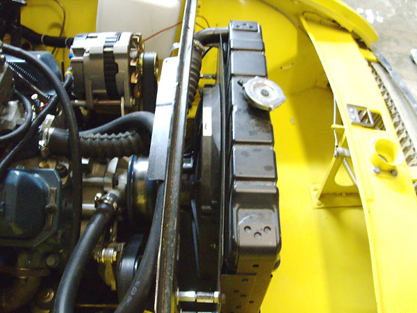

The radiator shelf was cut so that the radiator could be relocated forward about four inches.
Stock MG radiator with 14 inch fan and custom shroud.
Stock MG radiator with 14" fan and custom shroud. Radiator and fan shroud were bolted to radiator support.
Due to the slope of the hood, when the radiator was moved forward it also had to be mounted lower.

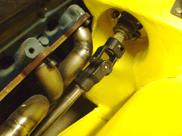

Headers from Classic Conversions Engineering.

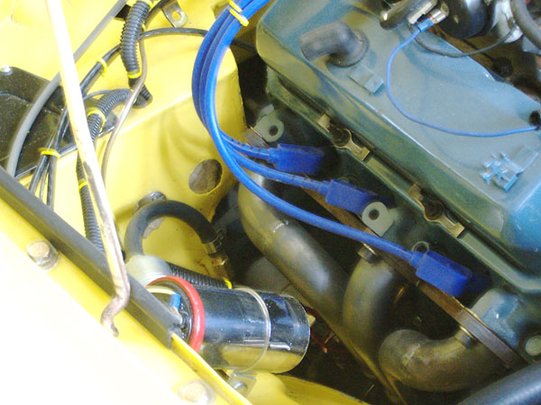

A 1982 Chevy S10 spec distributor triggers an MSD-6T multiple spark ignition module.
Fuse blocks.
Fuse blocks.

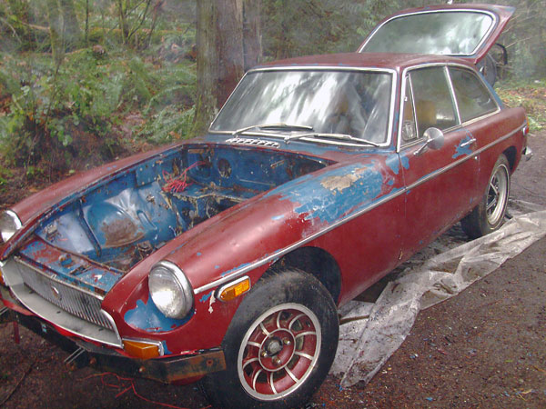

This is what the MGB GT looked like shortly after it was purchased, in December 2008.

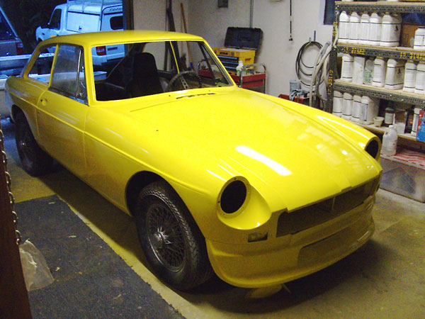

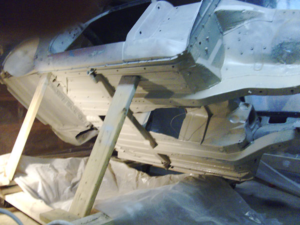

Stripped body was sandblasted and primed. Photo shows how car was hoisted and blocked to get to underside.

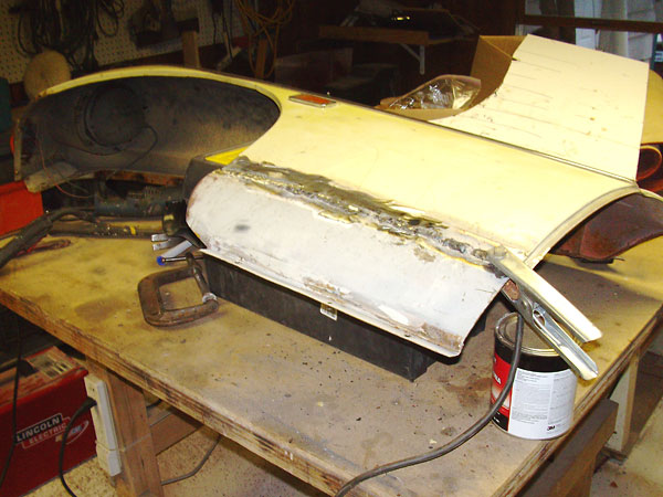

The lower part of both front fenders had rust, so they were repaired by welding on patch panels.

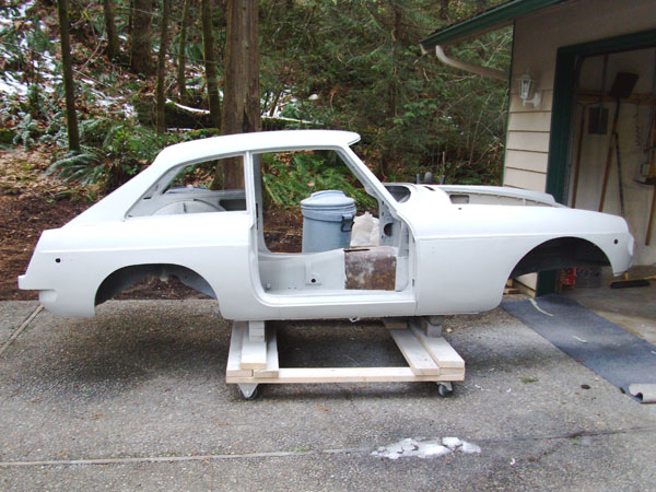

Primed bodyshell, ready for topcoats. A cart was constructed to move the bodyshell around in the garage.
Stock MGB front suspension, with new EBC slotted and dimpled brake rotors.
GM 3.4 V6 engine from a 1994 Camaro. The engine was cleaned and the fuel injection system was removed.

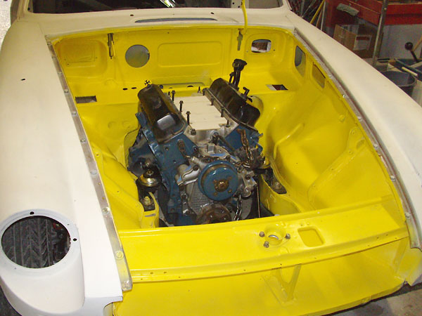

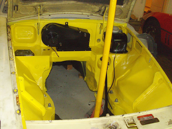

Engine compartment painted and reshaped for the V6.
Engine compartment painted and reshaped for the V6. The tunnel side next to steering column
was modified to provide clearance for the headers.
Engine and transmission in place. Engine was a very tight fit with motor mounts and steering shaft.
The distributor must be installed with vacuum advance facing forward for clearance to the heater.

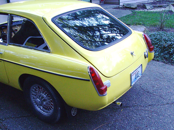

In Washington state, collector cars are only required to carry rear license plates.

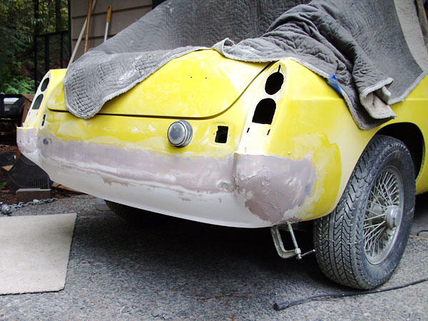

Rear valance fitted and glued on, then primed and painted. A chrome license plate holder was added.
In Washington state, "collector cars" are only required to carry rear license plates.

Exterior of car was primed, and then covered with Deltron base-coat and several coats of clear resin.
Finish was then fine sanded, buffed, and polished.
Steering shaft and header on driver's side.

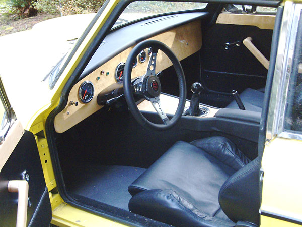

Dash and console made from half inch birds-eye maple. Leather Recaro seats. Autometer gauges.

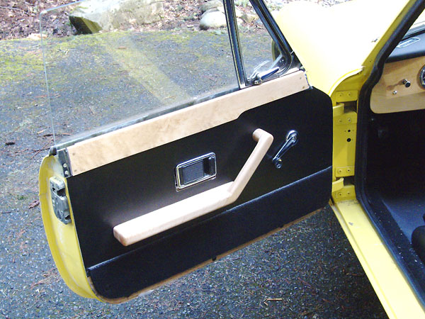

Custom door panels with birds-eye maple arm rests and caps.

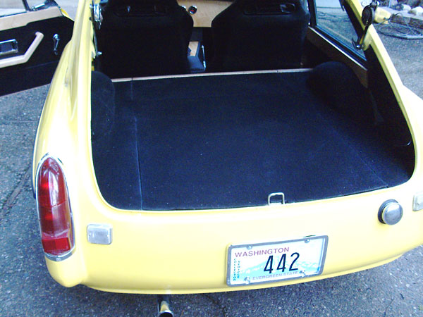

Rear seats were eliminated to provide a larger flat surface.
Rear cargo area with storage space for spare in rear, and battery in front.

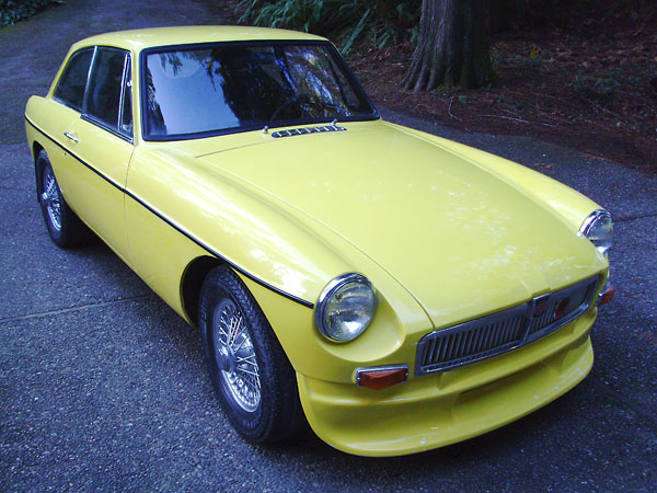

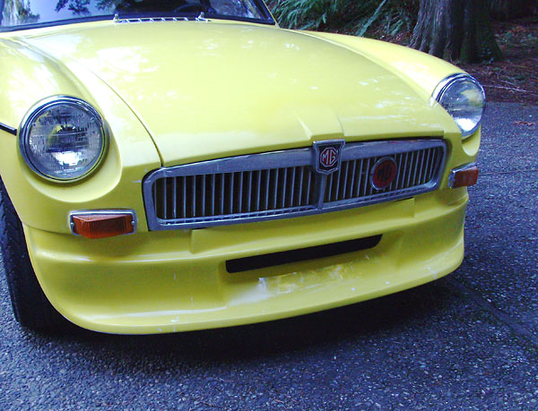

Front spoiler with stock grille.
Rear valance and license holder. Single exhaust on driver side.
