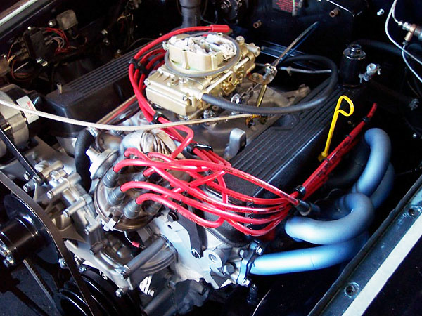

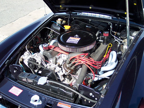

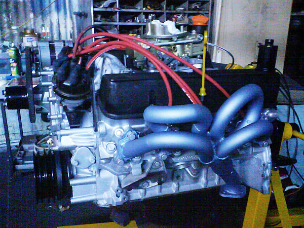

Engine: Rover 3.5L engine. Holley 600cfm with vacuum secondaries on an Offenhauser "360" (part number 5165) single-plane intake manifold. Pertronix Ignitor ignition module mounted inside the dizzy in lieu of breaker points. Rebuilt SD1 starter motor. Pre-facelift P6 alternator bracket.
Cooling: modified stock MGB (four cylinder) radiator with relocated ports.

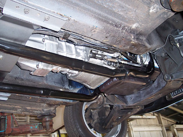

Exhaust: custom headers (purchased "used" from a racer.)

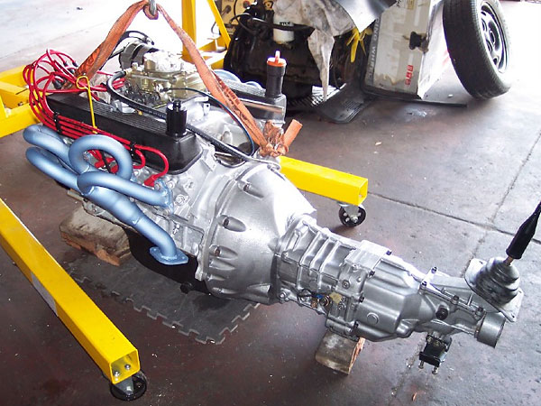

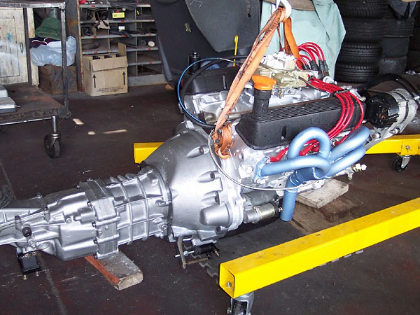

Transmission: Toyota Supra alloy case 5-speed manual transmission with Dellow bellhousing. Dellow clutch kit including transmission mounts, slave cylinder, throw-out fork and bearing, etc.

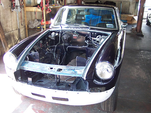

Comments: Where to start! I think the main areas of concern I had were the engine location and the selection of which gearbox to use. I purchased the engine mounts from the MGOC website. In hindsight, I believe I could've placed the motor slightly further back (e.g. maybe an inch or so.) However, the height is good and I have enough clearance to remove the sump pan with out lifting the engine. I decided to use a Toyota Supra gearbox. In Australia they're readily available with four different length casings (18, 19, 20, and 21 inch long respectively). I think the longest version is the most appropriate. I found that it located the gearstick very near the MGB's original location. The box I used is referred to as a "w55" box and has very similar gear ratios to the MG RV8 model. These boxes are good for about 500hp, so they're virtually break proof. The Dellow bellhousing was a easy install. It clears the tunnel by about 10-12mm either side, so I did not have to modify the tunnel at all. At the time of writing, I have not upgraded the differential yet but I intend to do that soon. (I'd like a limited slip differential.)
completed engine installation
Holley 600 (vacuum secondaries) on Offenhauser 360 single-plane intake manifold.
Holley 600 (vacuum secondaries) on Offenhauser "360" single-plane intake manifold.

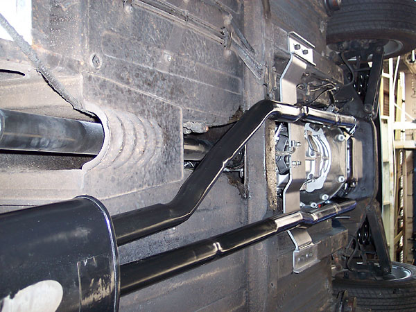

dual exhaust pipe routing
Dellow transmission crossmember

Custom four-into-one, block-hugger headers.
Toyota Supra W55 5-speed gearbox.
Dellow bellhousing.
Dellow bellhousing.

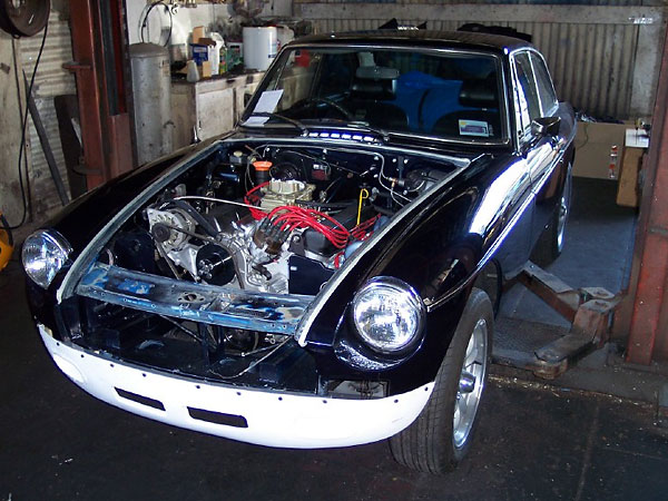

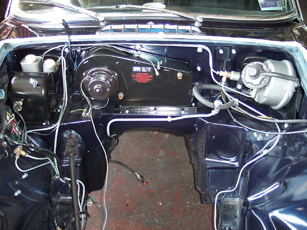

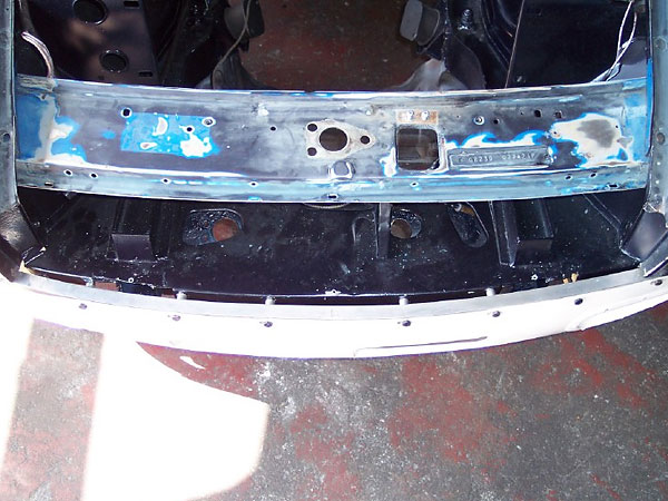

modified radiator shelf

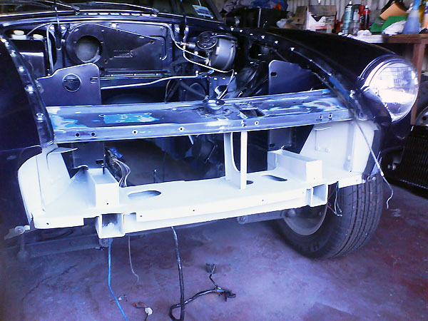

modified slam panel
modified turn signal mounting
single circuit, servo-assisted brake system

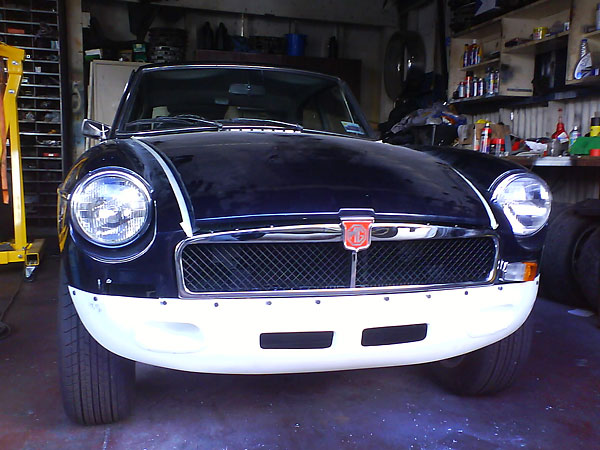

Installation of a Sebring front valance
Installation of a Sebring front valance.
Installation of a 1974 MGB grille
Installation of a 1974 MGB grille.

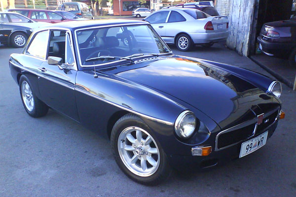

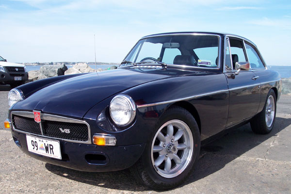

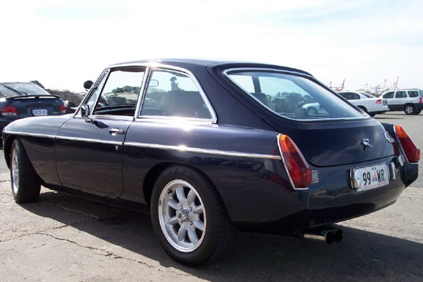

The Completed Conversion
very pretty new paint job
