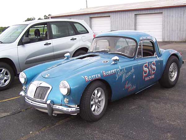

Owner: Bob Samyn
City: Essexville, MI
Model: 1959 MGA Coupe
Engine: Chevy 355 V8
Note: this MGA V-8 was originally built-up in 1966 by the owner and successfully campaigned at local dragstrips for five years. Best time was 10.68 seconds at 128mph! Built with the Shelby Cobra in mind, but Chevy powered. Restoration started in 1966 after being stored from 1972 until 1995. The goal was a street legal, stock looking, moderate performance driver with sports car handling.

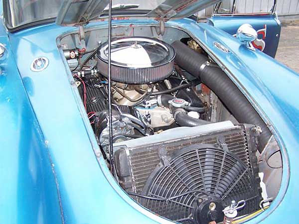

ENGINE
Year/Make: 1970 Chevrolet V-8.
Displacement: 355 c.i.
Block: 4-bolt #3970010 dated G199 (July 19, 1969)
Crankshaft: stock nodular.
Pistons: Sealed Power hypereutectic 9.4:1.
Rods: stock, shotpeened "pink" with ARP bolts.
Heads: World Products S/R Torquer 67cc.
Valves: Manley S/S swirl polished 2.02" intakes, 1.60" exhaust, Elgin springs.
Head Gaskets: Fel-Pro #1003 (0.039" compressed).
Camshaft: Speed Pro #CS-1013R hydraulic (duration 214/224 @ 0.050", lift .443"/.465").
Water Pump: Edelbrock aluminum long style #8811.
Cooling Fan: Perma-Cool 16" electric mounted behind radiator.
Alternator: chromed GM "CS" internal regulator.
Valve Covers: 1970 Corvette LT1 finned aluminum.
Induction: Edelbrock Performer #2101 with Quadrajet 750 CFM carb.
Ignition: GM points type distributor, converted with Pertronix Ignitor and Champion wires.
Headers: Hooker block huggers. 1.62" diameter. VHT paint.
Mufflers: custom aluminized steel dual 2.5 with Flow Tech Terminator mufflers.
Misc.: billet aluminum pulleys.

Radiator: custom 16" wide by 20" high 4-row high efficiency copper tilted back 30 degrees in stock location.

A radiator from a 1960 Comet was used. It was narrow enough to fit in the stock area. It was tilted back a little for clearance. The capacity was more than enough for 1/4 mile blasts. The lower port was relocated to run under the steering rack. An electric 12v water pump was used.

The coupe had innumerable weekly class wins, several Eliminator wins or runner-ups from 1968 through 1973. That year the MGA was retired. The owner/builder now had responsibilities. The coupe remained in storage from the middle of 1973 until 1995. In the spring of '95, the coupe was finally removed from storage. The plan was to make it a street legal driver and to replace all the stripped off parts which had been removed for racing. Then to restore it to close to original as possible, but to keep the Chevy drivetrain. (i.e. Chevy powered Cobra type, not a racer but a street legal DRIVER.
Today the project is almost complete and street legal. It has made it's first trip under it's own power, down the driveway and back. As soon as the snow melts, the MGA will see the highway for the first time since 1965! The next phase is some bodywork and a fresh paint job.
