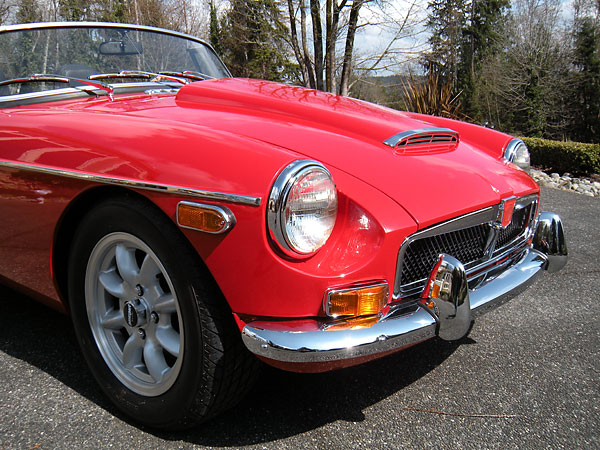

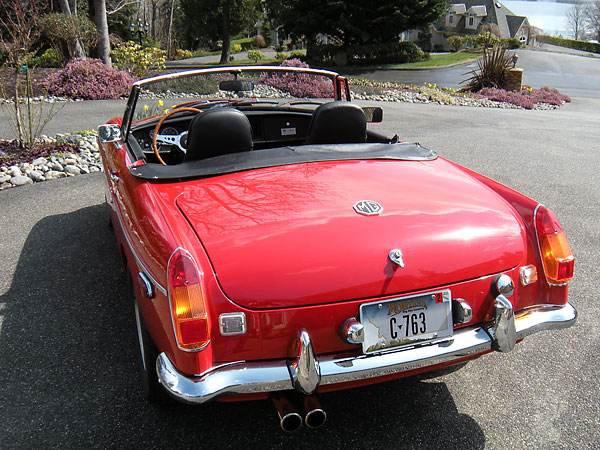

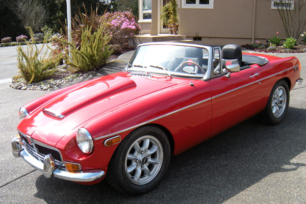

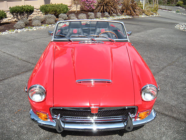

Bob Hertz's 1979 MGB with Ford 302 V8
Owner: Bob Hertz
City: Seattle, WA
Model: 1979 MGB
Engine: Ford 302 V8
Conversion by: Don Sasnett

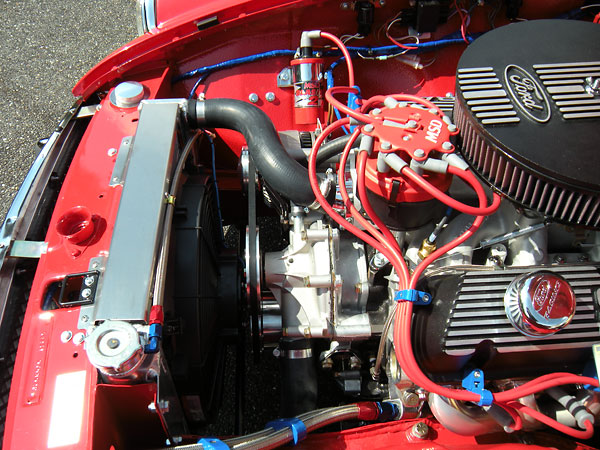

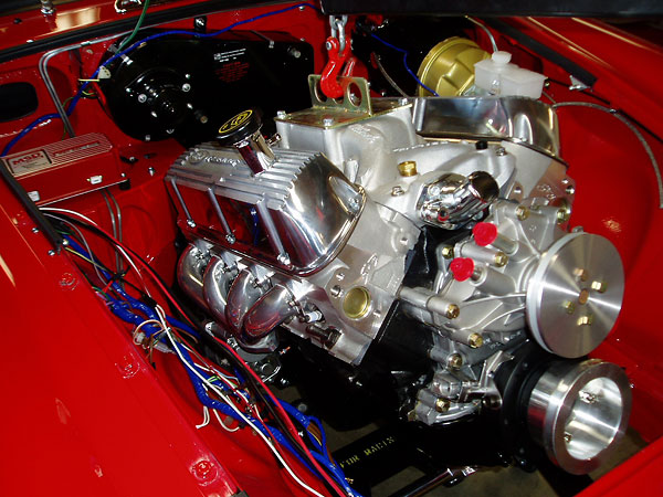

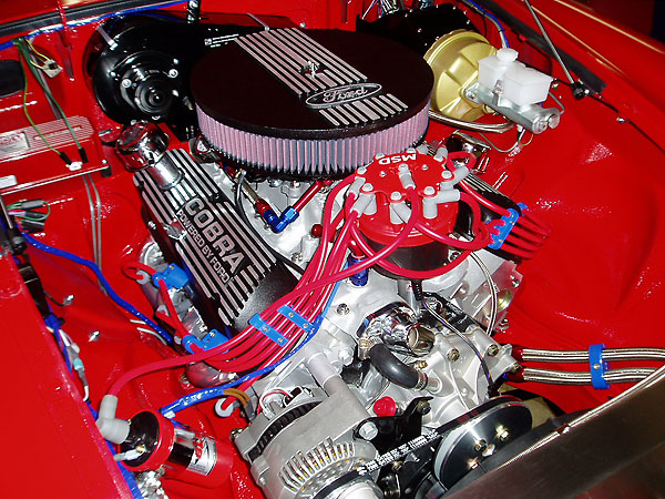

Engine: Ford 302/345hp GT40 crate engine from Ford Racing (part number M-6007-XE3M), Ford Racing GT 40 aluminum heads, B303 "hydraulic" camshaft with roller rockers, short water pump. Edelbrock RPM Air Gap manifold with Holley 4150 570cfm Street Avenger carburetor. Lokar throttle cable. K&N air filter. MSD 6AL (6420) ignition with MSD (8598) distributor and MSD Blaster 2 coil.
Cooling: Fast Cars/Howe aluminum radiator with 16" Tornado electric fan.

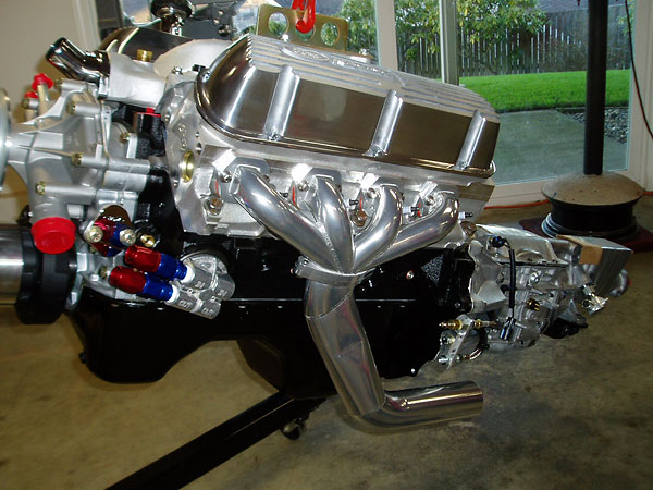

Exhaust: Fast Cars stainless steel block hugger headers with 2.5" stainless steel down pipes into 2" Flowmaster Hushpower mufflers. Dual tailpipes exiting together on driver's side.
Transmission: Tremec H.D. T5 5-speed, special ordered with a 0.073:1 overdrive fifth gear ratio. Ford Racing clutch with hydraulic throw-out bearing.

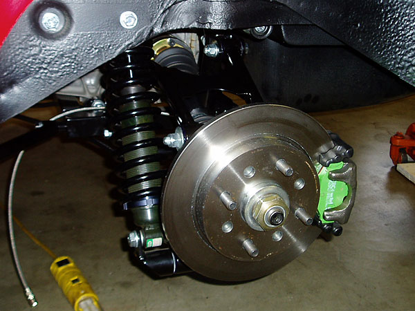

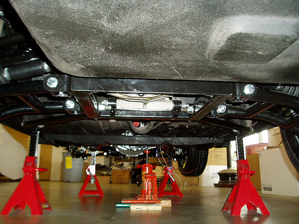

Front Susp.: Fast Cars coilover front suspension.
Rear Susp.: Hoyle Engineering independent rear suspension, with Ford (Granada) 7.5", 3.36:1 gear ratio and limited slip differential.
Brakes: all wheel disc brakes. MGB power brake servo.
Wheels/Tires: 15" X 6" Panasport wheels with 24mm positive offset.

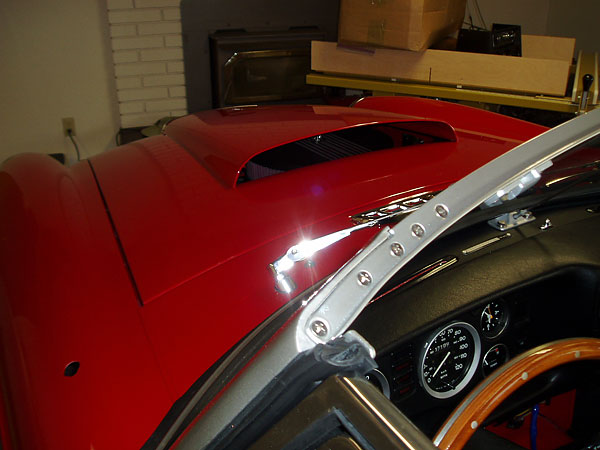

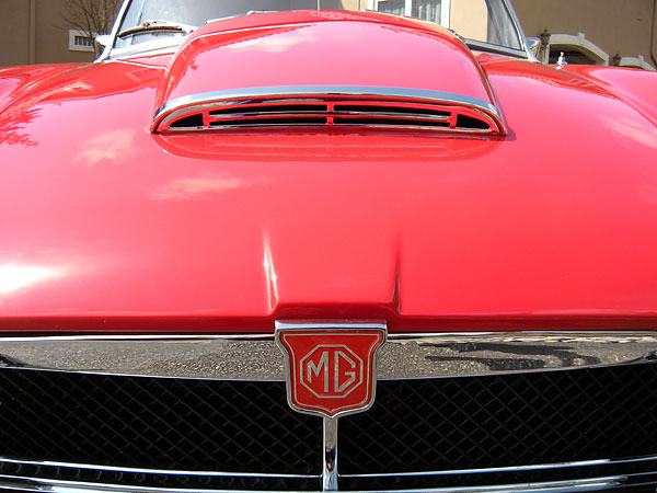

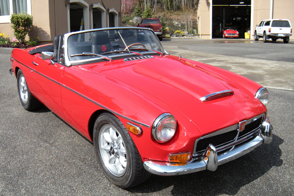

Body: a custom hood scoop was fabricated, using an Austin Healey 3000 trim piece at the front and open to the back to provide better airflow in engine compartment. Hood to engine clearance was not an issue with the exception of the hood cross brace, which was modified to fit around the distributor. Rubber bumpers were removed (because they were very heavy) and chrome bumpers installed along early style, all metal bumper overriders, a 1974 grille, and a vented (73-74.5) gravel pan.

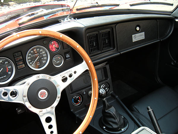

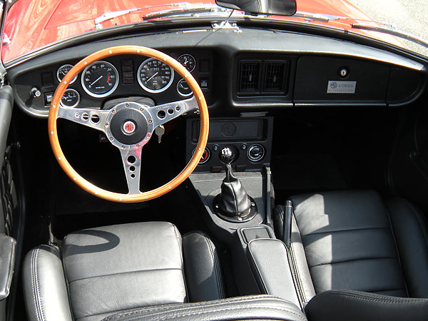

Interior: stock MGB gauges. Dakota Digital electronic tachometer signal converter. Mazda Miata seats with custom upholstery.
Completed: summer 2008. Driven approximately 200 miles as of April 2009.
Comments: this car was built from a stock 1979 MGB we purchased from Ted Lathrop of Fast Cars. It had suffered a minor engine fire with only 7000 miles on the odometer and had been parked (unrepaired) for all those years. Other than the engine compartment, the car was "as new" and it was a pleasure and also quite educational to take apart a car that was basically factory fresh.
Our project was somewhat unusual because it featured Fast Cars front suspension in combination with the Hoyle Engineering independent rear suspension. This is the second car I built with this combination. I find the handling to be excellent. The car is very fast and nimble, with light steering feel and excellent rear wheel hook-up.

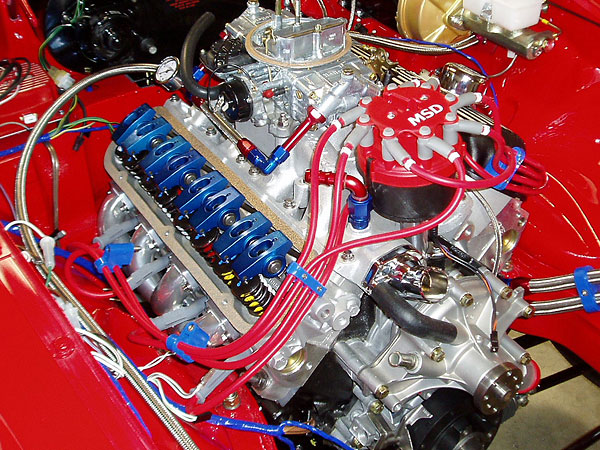

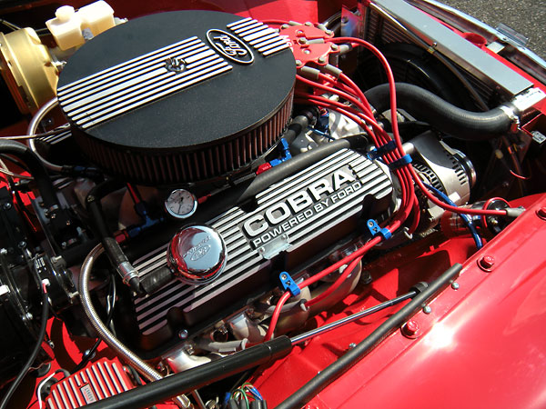

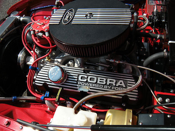

Ford 302/345hp GT40 crate engine from Ford Racing (part number M-6007-XE3M).
PCV system and fuel pressure gauge
PCV system and fuel pressure gauge.

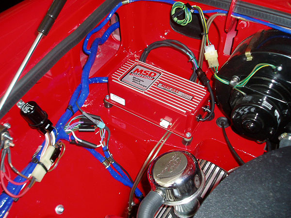

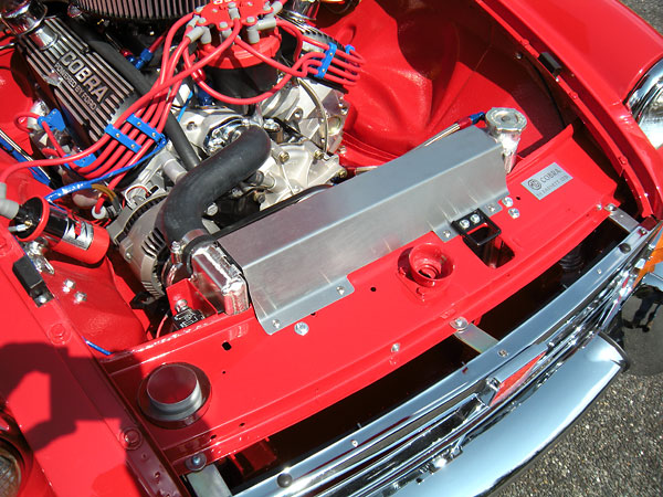

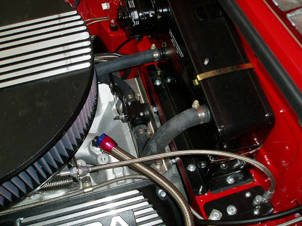

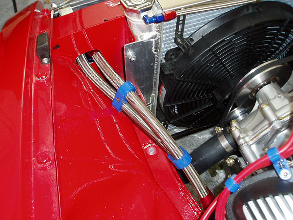

remote oil filter plumbing and 16 inch Tornado electric fan
Remote oil filter plumbing, and 16 inch Tornado electric fan.
Fast Cars / Howe aluminum radiator
Fast Cars (Howe) aluminum radiator.

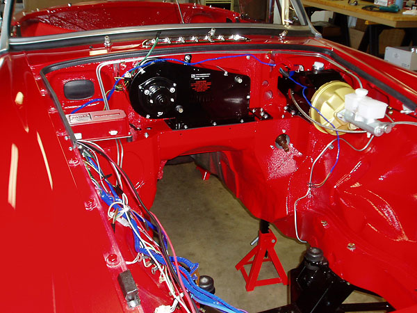

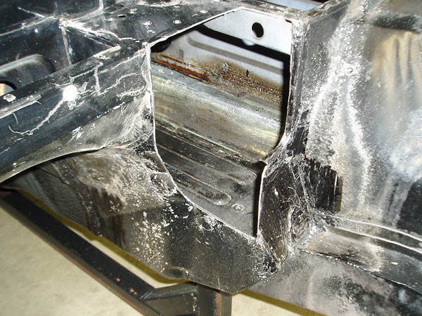

"How It Was Done"

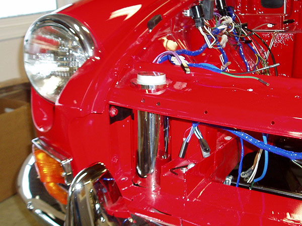

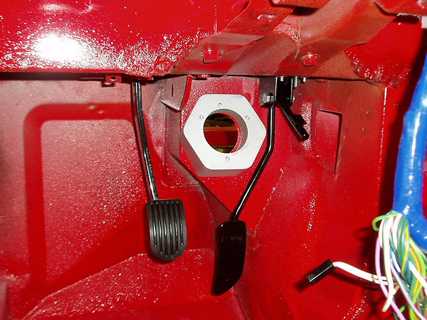

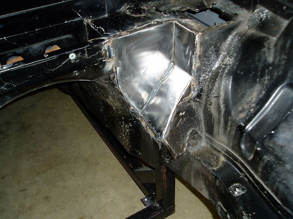

firewall cut-out for engine clearance
fabricated filler panel
aluminum plinth for steering pass-thru
Aluminum plinth for steering pass-thru, and custom throttle pedal.
coolant overflow tank
Coolant overflow tank.
brake line and wiring harness routing
Brake line and wiring harness routing.
Fast Cars shortie headers into custom downpipes
Fast Cars shortie headers.

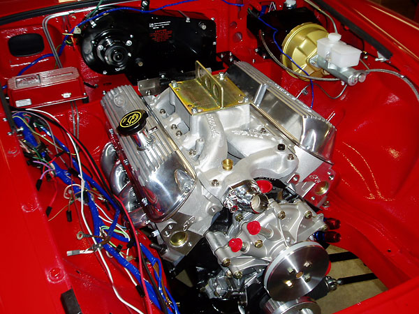

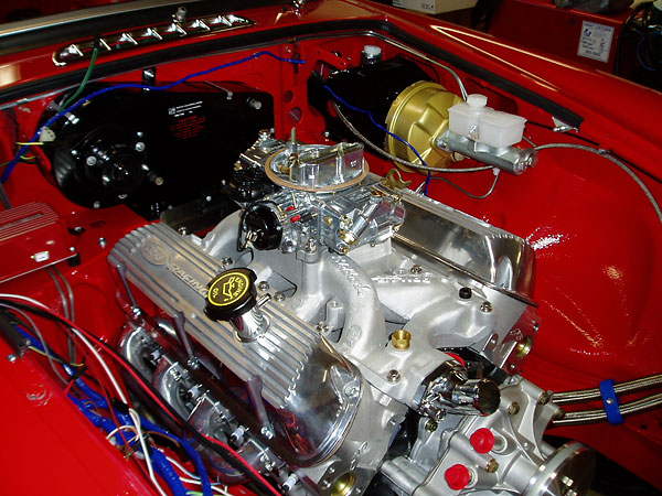

Ford Racing GT 40 aluminum heads... and much better looking valve covers
Edelbrock RPM Air Gap manifold.
Holley 4150 570cfm Street Avenger carburetor. (Note the electric choke.)
B303 hydraulic camshaft pushes roller rockers.
B303 "hydraulic" camshaft pushes roller rockers.
Short water pump.
Short water pump.
Motorcraft alternator.
Heater valve and throttle cable.
MSD Ignition multiple spark discharge MSD 6AL controller.
MSD Ignition (multiple spark discharge) "MSD 6AL" controller.

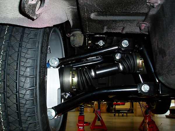

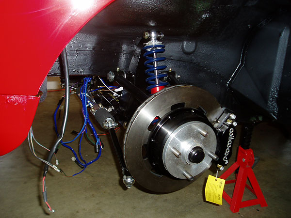

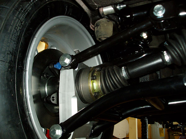

Fast Cars front suspension, featuring Wilwood brakes.

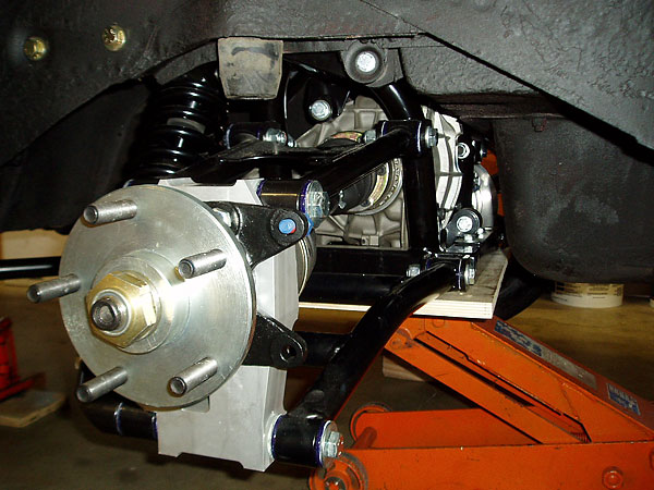

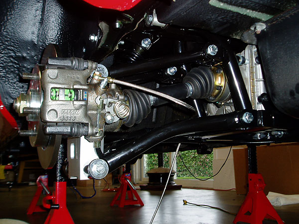

Hoyle independent rear suspension
Hoyle independent rear suspension.
halfshaft
upright
brake caliper
rotor, and shock absorber
fuel tank
carrier for Ford Granada (U.K.) differential
dashboard
steering wheel

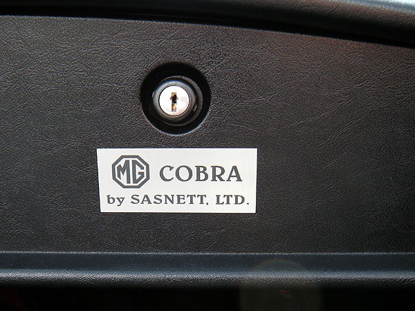

Cobra by Sasnett Ltd.

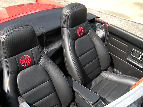

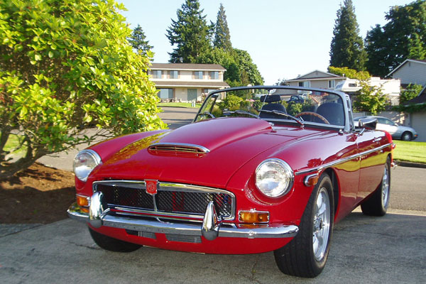

Austin Healey 3000 inspired hood scoop
Austin Healey 3000 inspired hood scoop.

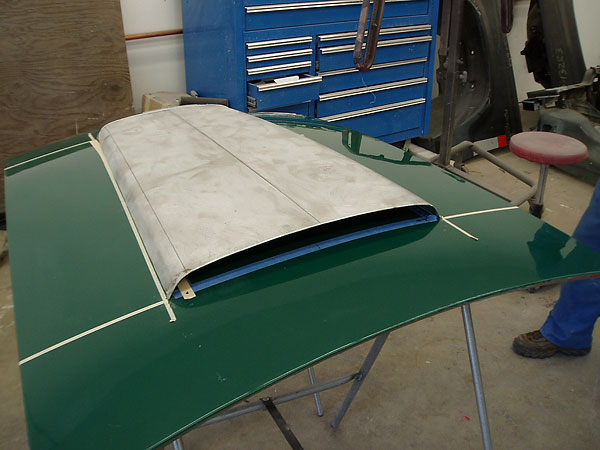

Fabrication of the custom hood scoop.
The scoop actually opens at the rear for cowl induction.
Austin Healey 3000 trim piece.
Austin Healey 3000 trim piece, and 1974 MGB grille.

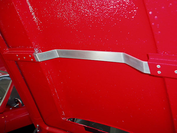

Hood cross brace (with raised profile to clear distributor.)
Vented (73-74.5) gravel pan.
Chrome bumpers with early style (62-69, all metal) overriders.
Panasport wheels (15x6).

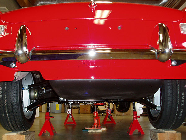

subtle dual exhaust pipe tips
