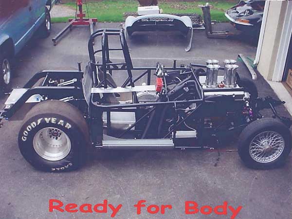

Engine: 406cid Small Block Chevy V8
Conversion performed by: English Brothers

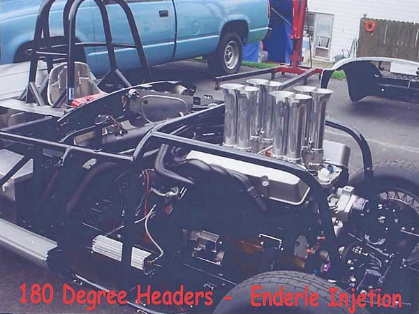

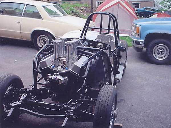

Intake: Enderle Mechanical Stack Injection
Engine Electrical: MSD
Cooling: Speedway motors aluminum "Dirt Grabber"
Cam: Comp Cams mechanical roller
Exhaust: Schoefield 180 degree headers
Transmission: Chevy PowerGlide
Driveshaft: 1350 Series U-Joints
Clutch System: 8" ATI Converter

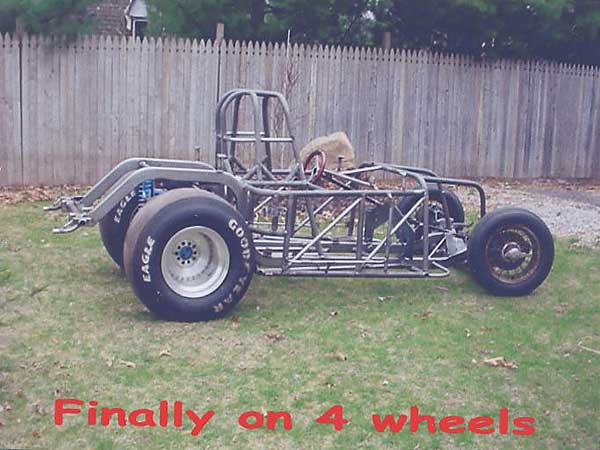

Rear Axle: 9" Ford with Moser 35 spline axles. 4.56:1 gears with spool.
Front Suspension: MGA modified to accept standard automotive shocks.

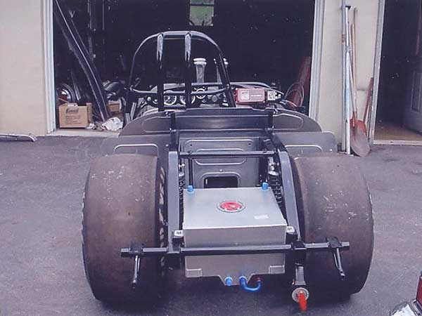

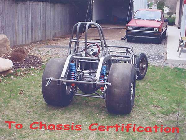

Rear Suspension: 4-link with coil over shocks.
Brakes: MGA disc fronts. Wilwood disc rears.
Wheels/Tires: 24" tall front tires mounted on 60 spoke knock-off wheels.
Weight: 2350 pounds.
Electrical: Autometer

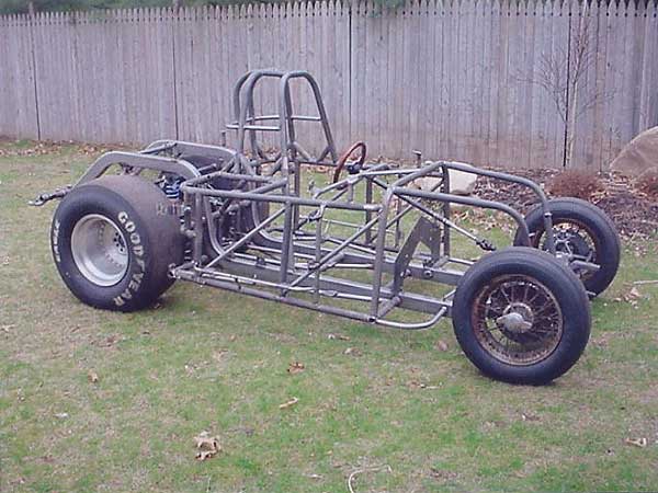

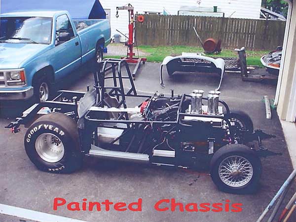

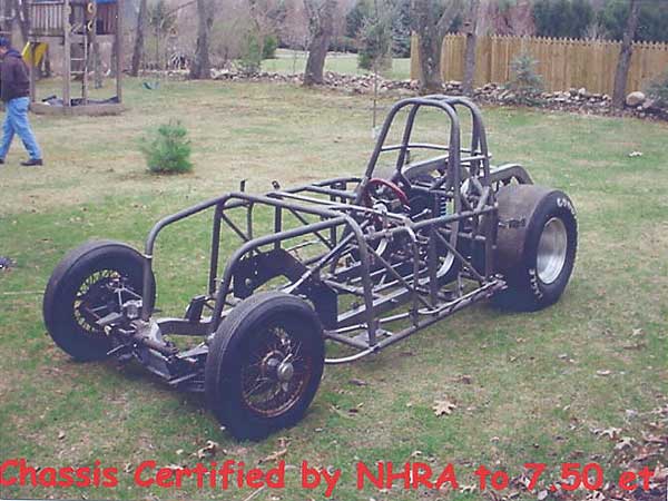

Other Chassis Mods: Main frame rails are 2x3 tubing. Rest of chassis is 1 1/2" and 1" D.O.M. tubing. Chassis is built to SFI specifications for a side-steer roadster. Certified by NHRA to 7.50 e.t.

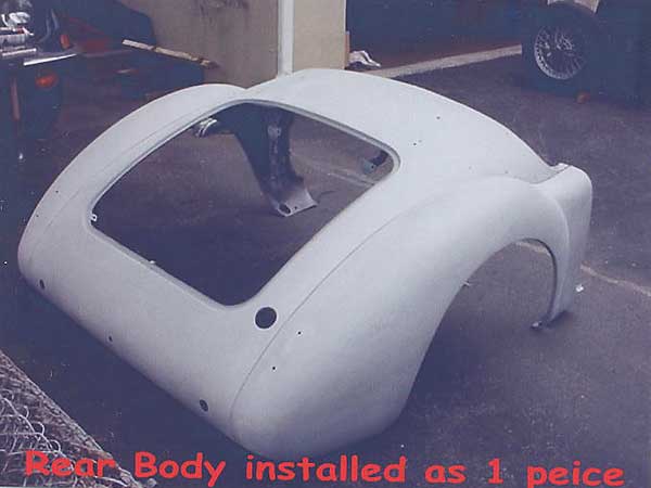

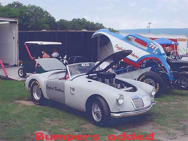

Body & Interior: Exterior is mostly original MGA. Interior has no original MGA parts.

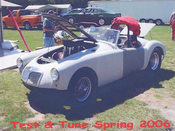

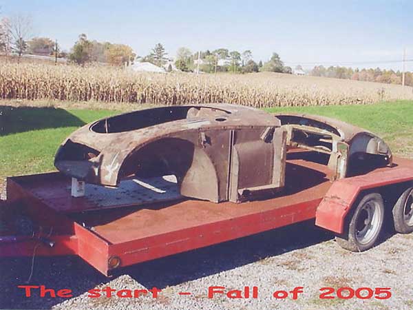

Date Completed: Car built winter of 2005. Raced during 2006 season. Currently being painted.

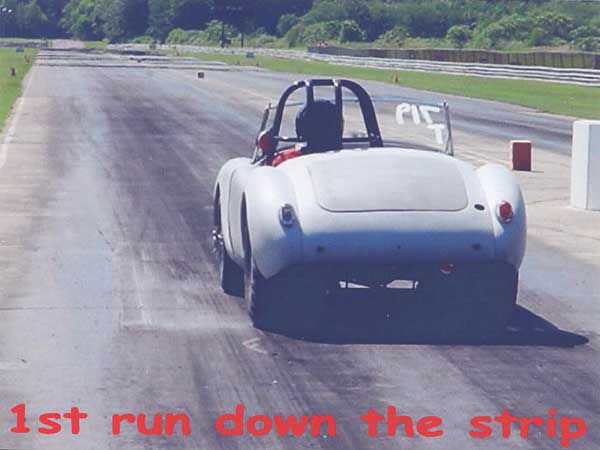

Miles Since Completion: Approximately 20, one quarter mile at a time!

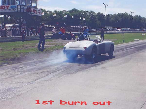

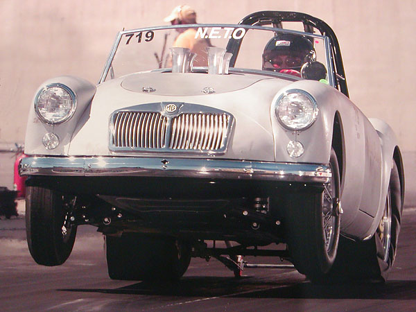

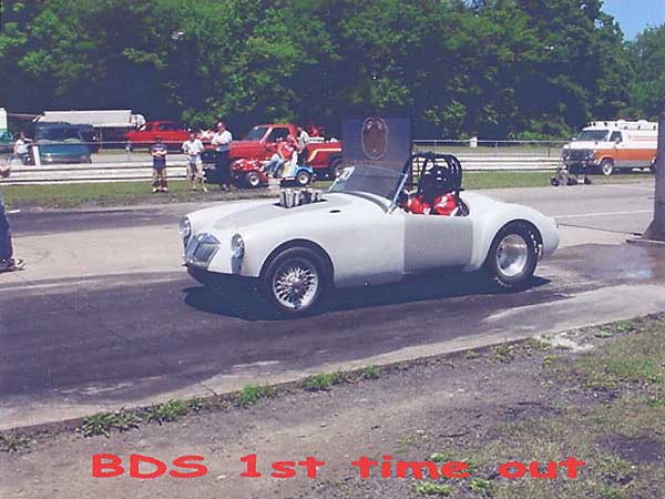

Performance Data: Best quarter mile to date is 9.65 seconds at 135mph

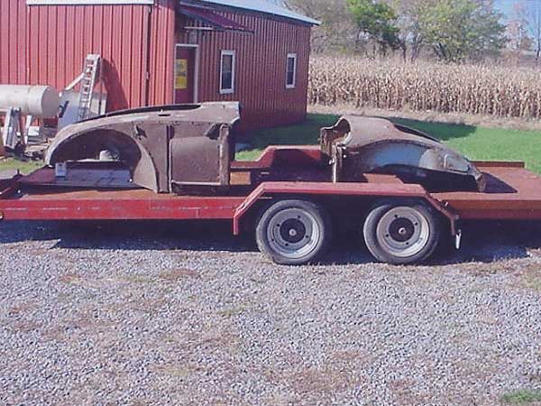

MGA shell
Barn Find
Side-steer Roadster Chassis
Built to SFI Specifications
Ready for NHRA certification
Fuel Cell

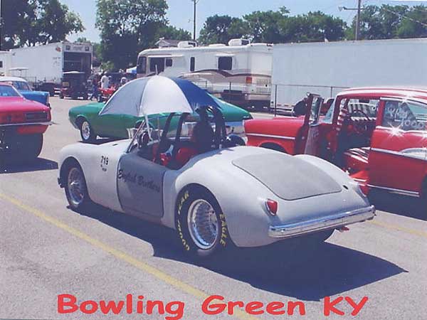

Goodyear Eagle drag racing slicks
MGA rear body

Trial Run
Testing and Tuning
Racing at Bowling Green KY
