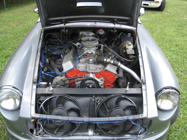

Engine: currently, 1986 IROC Camaro 305 Cid V8. A 350cid Chevy engine with LT1 aluminum heads is being built to replace it. Edelbrock manifold. Holley carburetor.
Cooling: late model Chevy Impala radiator, with Cadillac dual electric fans.
Exhaust: block hugger headers, modified to dump out behind front wheels.
Transmission: Saginaw 4 speed with Hurst shifter. 11" clutch. Stock MG master cylinder, with Howe hydraulic throw out bearing. Custom driveshaft.
Rear Axle: Jaguar, with open differential.

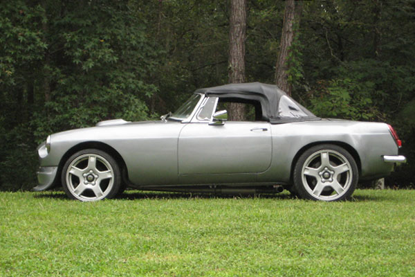

Wheels/Tires: Corvette wheels.

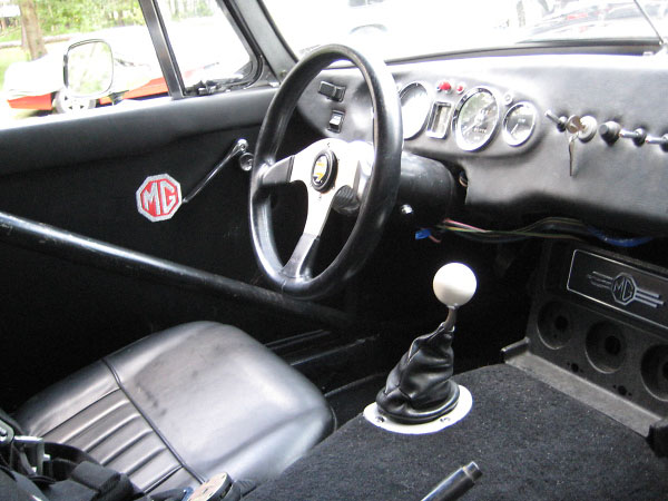

Instruments: stock, except for Sun tachometer, fuel pressure gauge, and manifold pressure gauge.

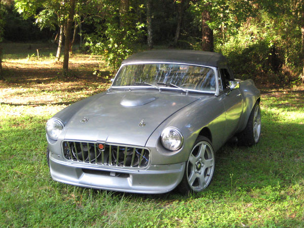

Other: Roll bar tied into extra frame member from tranny mount crossover to mount for Jag IRS. Flared rear wheel wells. Filled in all holes in body including cowl vent.
