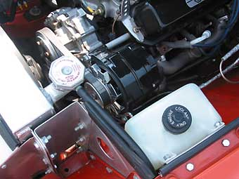

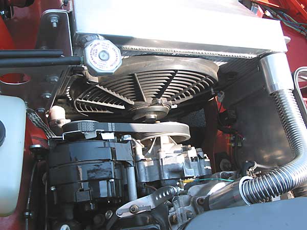

Cooling: Custom aluminum radiator.

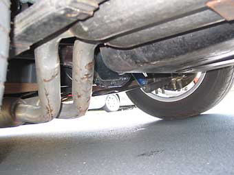

Exhaust: Custom dual exhaust (headers by Classic Conversions Engineering, into dual exhaust exiting driver's-side.)

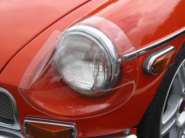

Body: Air dam, Sebring headlight covers, and rear spoiler fitted.

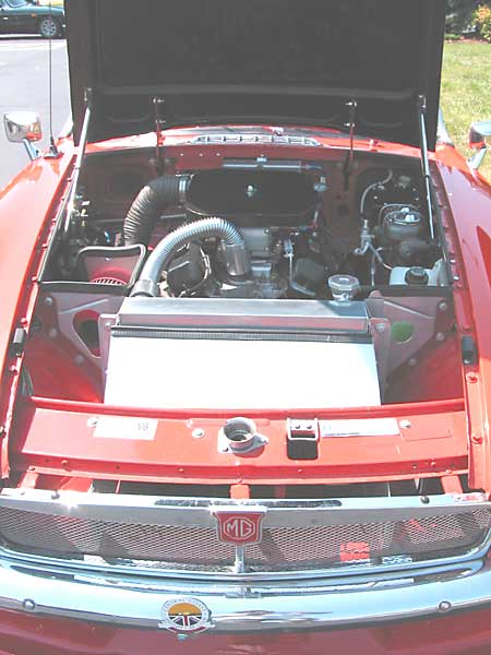

engine bay
The engine is way back, for excellent weight distribution and generous room for the cooling system.

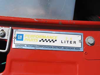

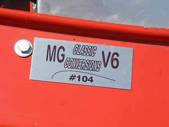

this is how professional artists like Bill Guzman sign their work   V6 engine plaque

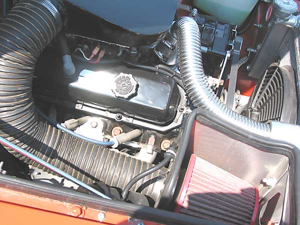

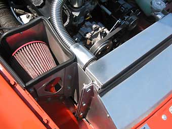

air cleaner
Ducting to the radiator eliminates re-circulation. Engine air is cooler because it doesn't pass through the radiator.
cold air intake, and filtration   coolant overflow

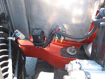

engine cooling fan

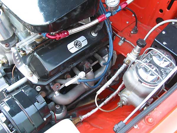

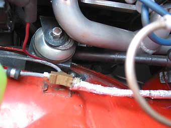

fan relay and circuit breaker   V6 engine mounts / V6 headers by Classic Conversions Engineering
V6 headers by Bill Guzman

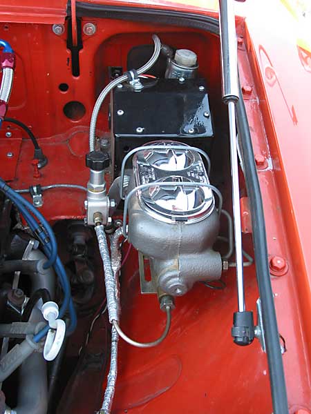

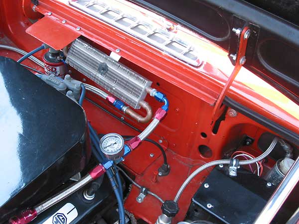

master cylinder
fuel cooler

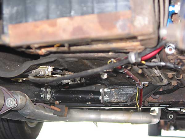

tranny crossmember and exhaust crossover
Notice the removable tubular brace under Bill's transmission. It facilitates quick and easy clutch service!

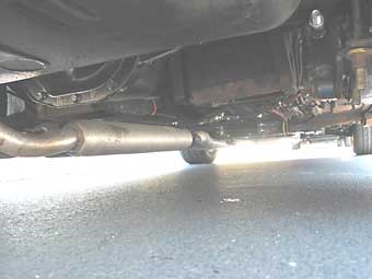

Also, since both exhaust pipes are routed on driver's-side, the fuel system and battery stay cooler.

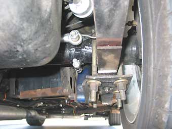

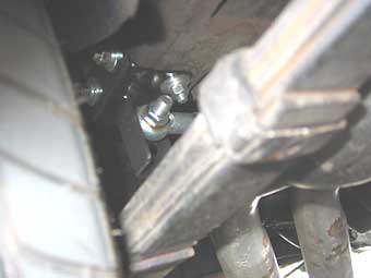

dual mufflers... both on driver's side   Monroe shock and mystery bolt on axle

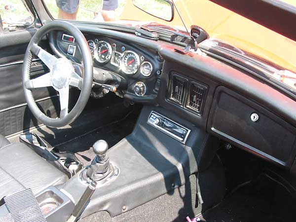

dashboard

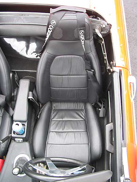

miata seat
Classic Conversions Engineering offers Sebring headlight covers.

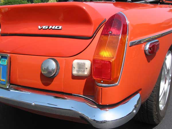

taillight and spoiler / V6 badge
Panhard rod from Classic Conversions Engineering   traction bars by Bill Guzman, Classic Conversions Engineering
