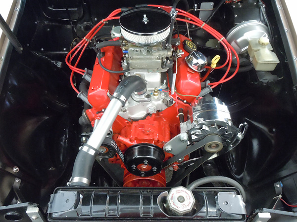

Engine: 1995 Chevrolet 3.4L V6
How It Was Done

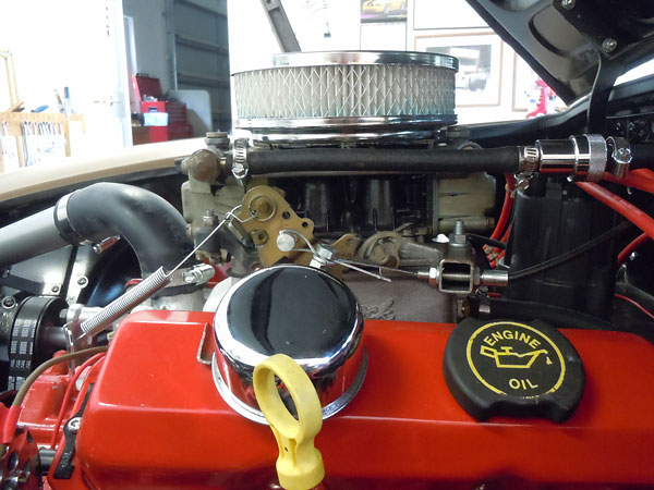

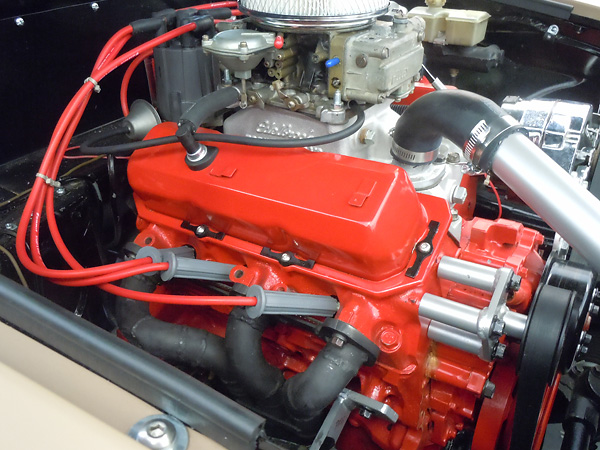

Engine: 1995 Chevrolet 3.4L V6. Two piece Edelbrock intake manifold. Holley 390cfm four barrel carburetor.

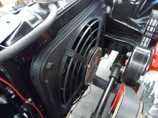

Cooling: 1965 Ford Mustang (289cid) radiator. Flex-a-Lite electric cooling fan with integral shroud.

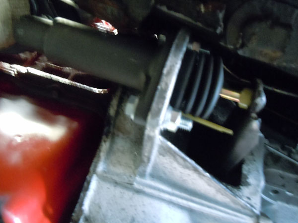

Transmission: Borg Warner T5 5-speed. Stock Chevy clutch. External slave cylinder. Custom driveshaft, sourced locally.

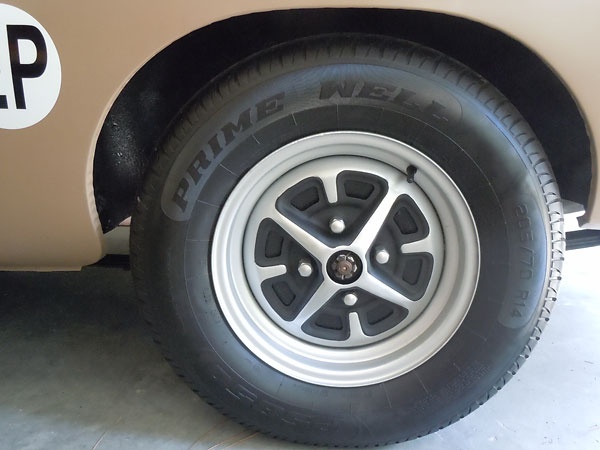

Wheels/Tires: stock MGB "Rostyle" 14" steel wheels. Prime Well 205/70R14 tires.

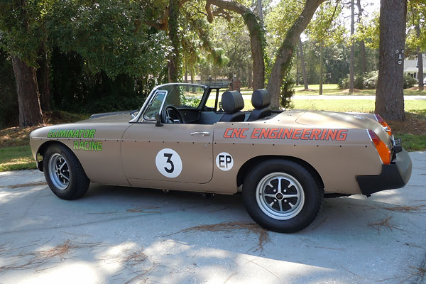

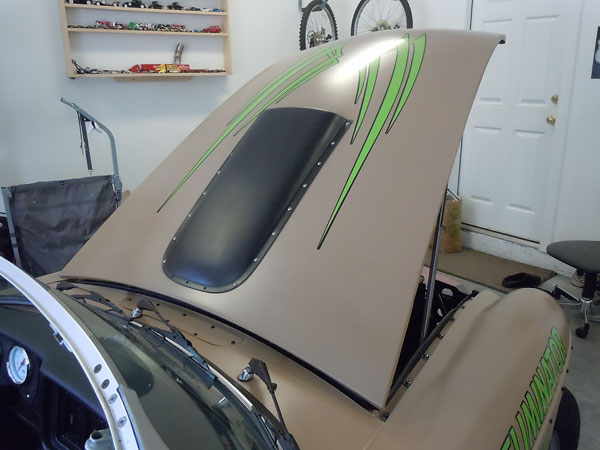

Body Mods: omitted front bumper and grille. Shaved turn signals and marker lights. Cobra style hood scoop. Stainless steel side trim removed and replaced with buttonhead scews. Replaced all rubber, lenses, lights, and lamps. Flat beige paint applied by owner.

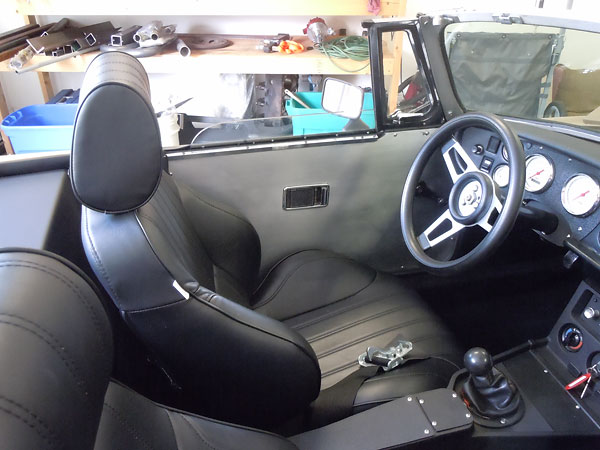

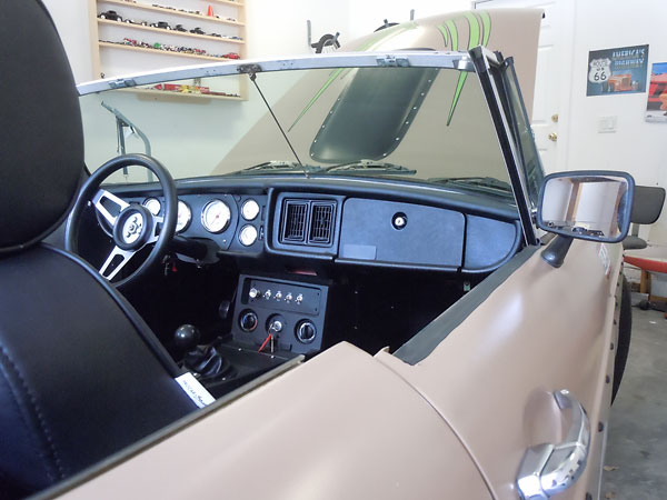

Interior: TPI instruments. Procar Racing seats. Grant steering wheel. Aluminum door panels. Custom-fabricated paneled storage bin behind seats. Toggle switches for all functions. Stock MGB shifter (rethreaded).

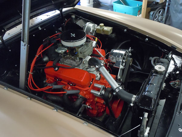

1995 Chevrolet 3.4L sixty-degree V6.

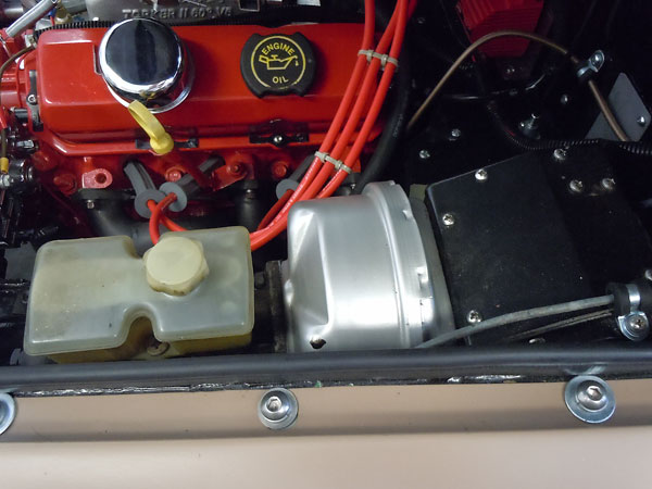

Stock late-model MGB brake booster and master cylinder.

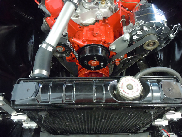

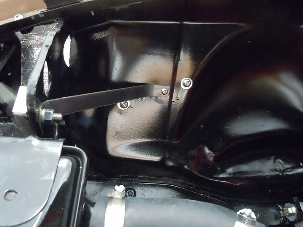

Black engine bay paint.

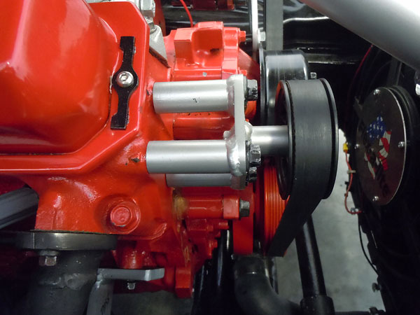

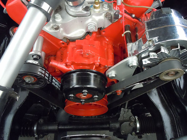

Serpentine fan belt.
Homemade idler pulley mounting bracket.

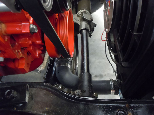

Lower radiator hose routing... facilitated by the rubber bumper style crossmember.
Edelbrock two-piece intake manifold.
Homemade exhaust headers.

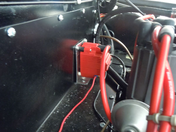

Ignition coil.

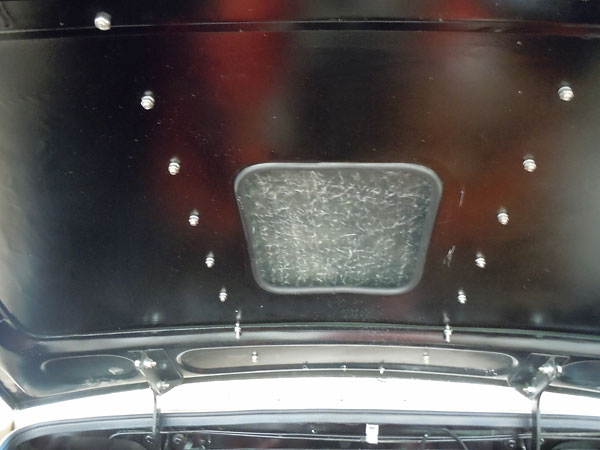

Bottom of hood.
Bottom of hood.

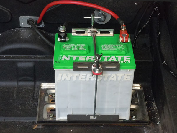

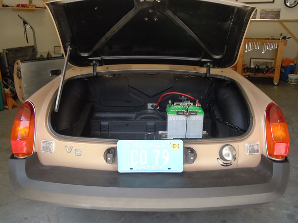

Interstate battery, has been relocated to trunk.
External clutch slave cylinder.

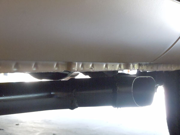

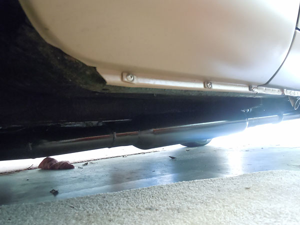

Glasspack mufflers.
Glasspack mufflers.
Exhaust is routed to in front of the rear tires.

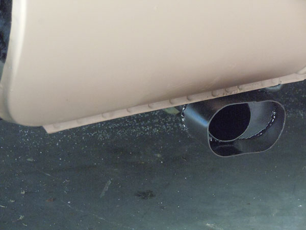

Custom exhaust tips.
Grant steering wheel. TPI instruments.

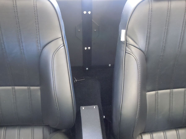

Paneled storage bins behind seats.

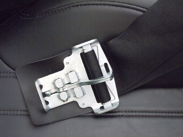

Seatbelt buckle.
Seatbelt buckle.

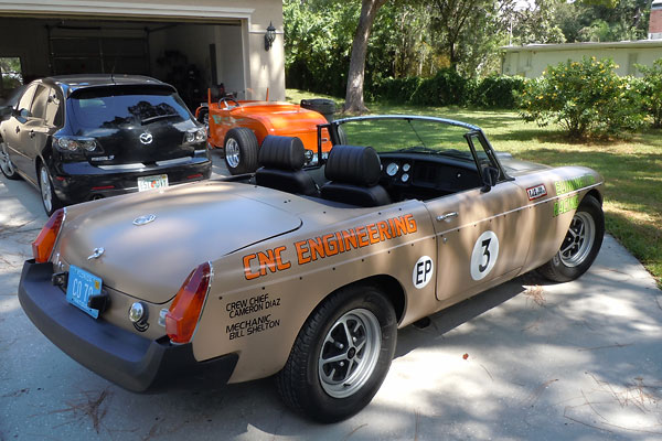

CNC Engineering - Crew Chief: Cameron Diaz - Mechanic: Bill Shelton

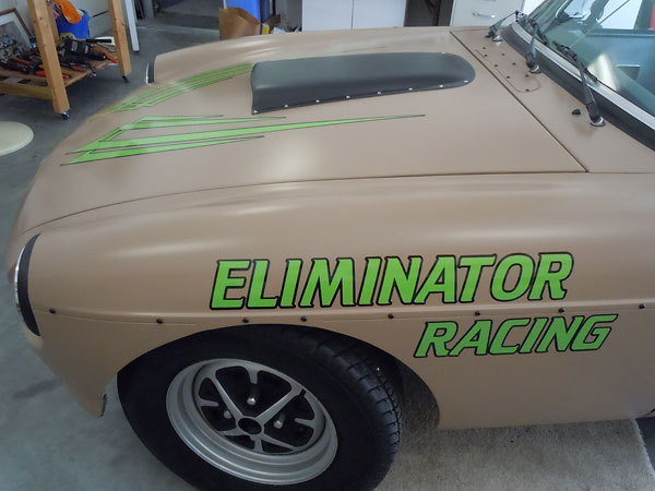

Flat beige paint on an MGB.
Cobra style fiberglass hood scoop.

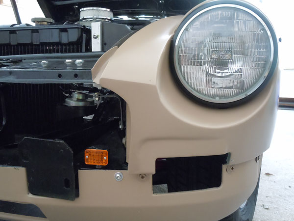

Omitted front bumper. Omitted grille.
Omitted front bumper. Omitted grille. Open turn signal holes. Small turn signals in grille area.

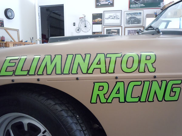

Eliminator Racing decal.

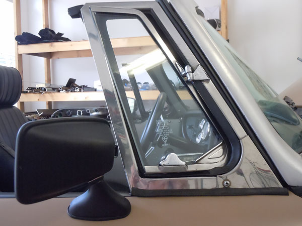

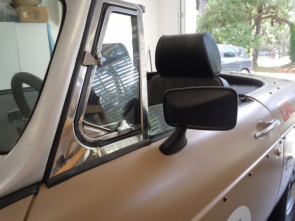

Late model MGB side view mirrors are available in flat black or bright metal.

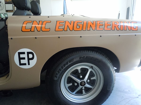

CNC Engineering decal. E Production racing class decal.

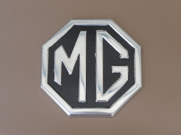

MG boot badge.
MG boot badge.

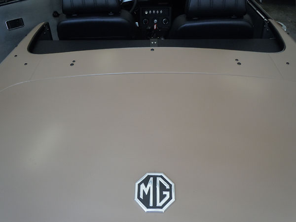

MG boot badge in context.

Prime Well 205/70R14 tires on stock MGB Rostyle steel wheels.
