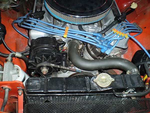

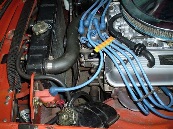

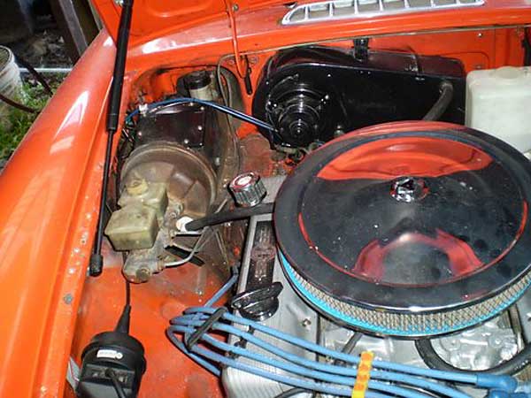

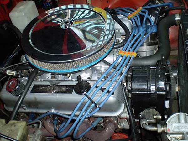

Engine: 1976 Rover 3.5L from a Rover P6B. Luminition electronic ignition, high volume oil pump, cam reground 70/30, 30/70, Rover inlet manifold modified to accept Holley 2300 350cfm 2-bbl carburetor. Home made air cleaner using Mazda 323 air filter (the thinnest I could find), remote oil filter.

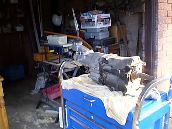

Transmission: Toyota Celica 5-speed manual. Gearshift shortened, driveshaft is the Rover P6B unit, modified for the Toyota gearbox. Dellow Automotive bellhousing and transmission adapter kit (includes everything from the pilot bushing to the tailshaft/driveshaft yoke). Toyota Celica slave cylinder. Range Rover flywheel machined to MGB V8 specs as per maintenance manual.
Cooling: MGB radiator, re-cored and turned 180 degrees with inlet and outlet changed. Twin electric fans (with motors from Mazda 323).

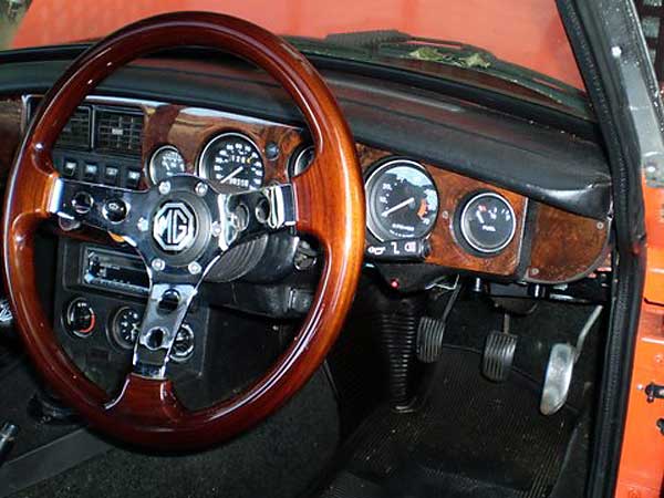

Instruments: recalibrated tachometer.

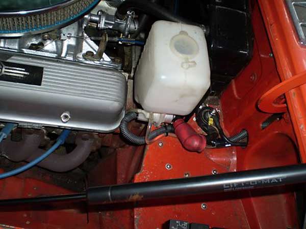

modified MGB radiator
modified Rover intake manifold

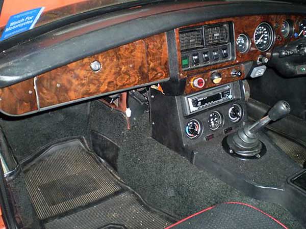

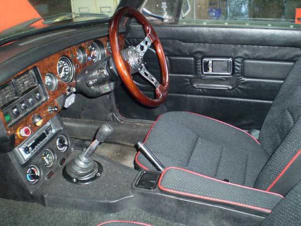

wood steering wheel
shifter location
glove box lid

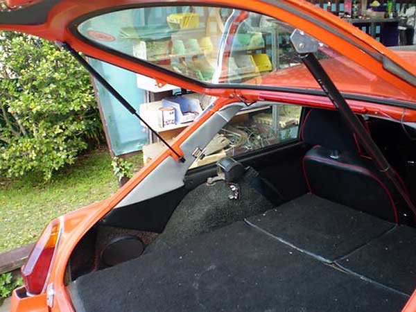

GT rear hatch
Toyota Supra transmission
